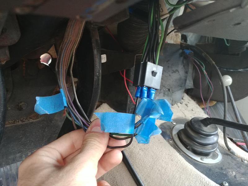

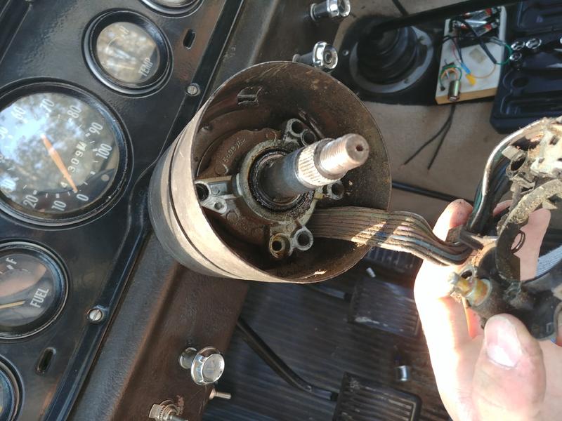

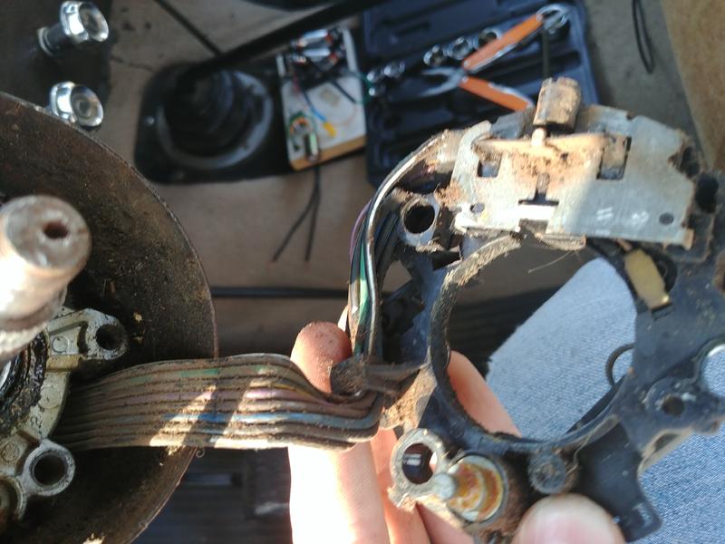

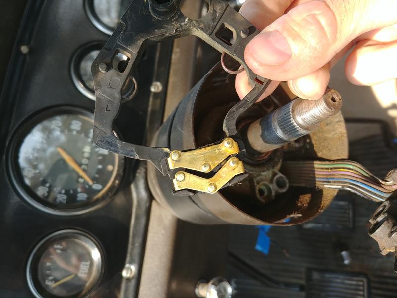

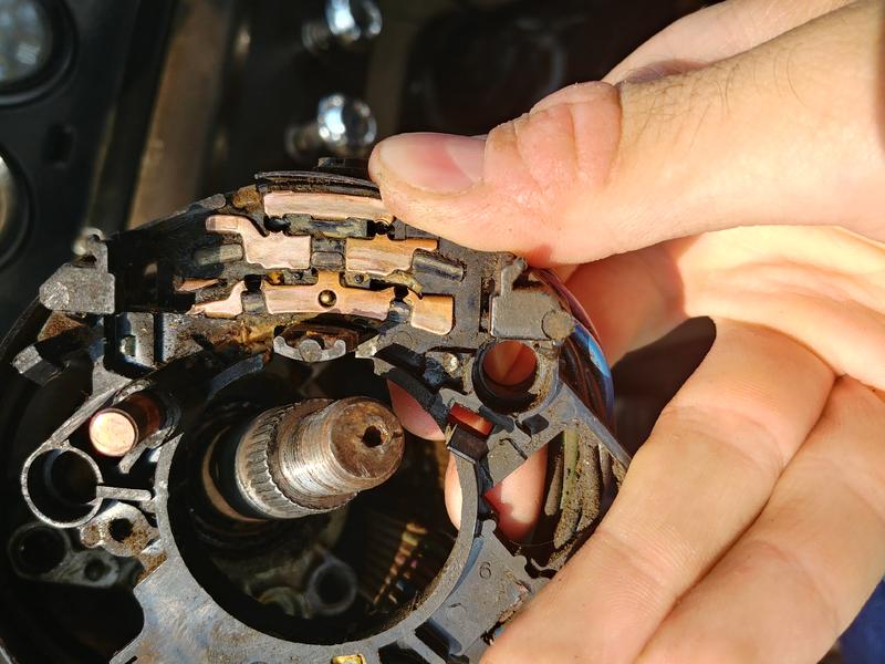

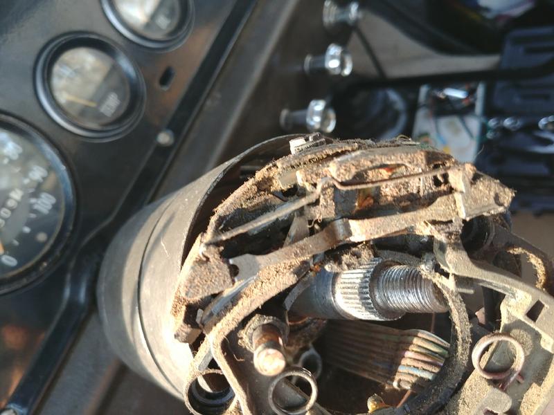

If you've ever fixed something electrical on your IH and didn't test it till later, only to find you hooked it up backwards and had to take three or more things apart to fix it, go ahead and subscribe to this thread :lol: :lol: :lol:

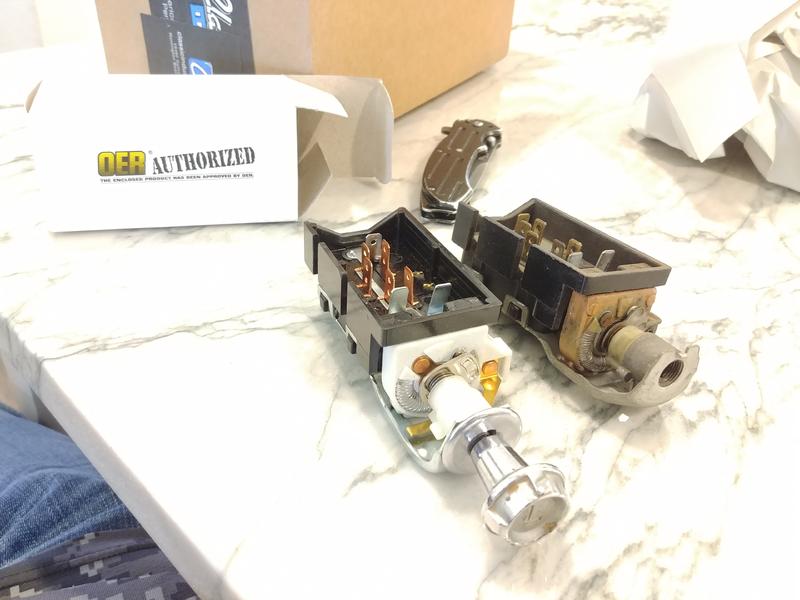

Right, the beast is back now with 99.9999(thats four 9s!)% working electrics! :icon_up: On to other things(thank God). I've managed to jimmy the signal switch fully working, what was happening was the contacts moved too far when signalling right and disconected both bright filament lines from the stop circuit instead of just the right. I put a ziptie around part of the switch to act as a shim and it corrected the problem. Unfortunately I'm a moron and didn't think to take a picture untill after I wrastled the steering wheel back on. Next note, I put in five gallons of gas from a can and the fuel gauge didn't move, however swapping in the gauge from the truck I stripped at the salvage yard showed just above empty. Am I correct in thinking something else may be wrong with this circuit(would think it would read atleast 1/4)? I have a home made continuity tester that I conected to the gauge and got the needle to come up on the gauge I removed so I'm unsure what may be happening. I'm celebrating the electric's completion (ironically with the 100th reply) via photo op. Really just a reality check on all the stuff I still need to do. Pics are of a couple areas I opened up/inspected for the first time out of curiosity, some of the non original components, some of things that I tried not to breath on for fear of breakage/turning to dust or lung disease, a couple of things I have no clue what to make of, and a small detail in the mounts of my winch bumper.
On another topic I want to become more familiar with the anatomy of the SV series engines, does anybody have cutaway pictures, or diagrams/exploded veiws? Am I right in my understanding that the cam drive in these engines is gear driven?(ie no "timing chain"?) I looked for play earlier today in the timing by rotating the engine slightly and watching for movement in the distributor rotor and found NO observable play whatsoever. Being that the previous owner said this engine had high hours thats great. I'm not familiar with this particular carb either, does the JB weld pictured apear to be over anything important? I kind of ignore that because inches away is the rustiest clutch slave cylinder I've ever seen. I will either be replacing this or ignoring it and hoping it goes away. My next set of fixes will be to run some rislone in the oil before changing to try and get the lifters of the two cylinders in the middle of the passenger bank to quiet down(also can somebody tell me how to reference cylinder # thanks in advance), VC gaskets, pan gasket, new filter and new oil. I may do a tuneup depending on if somebody out there with more experience thinks this distributor looks like it may need it inside (looks very clean/good to me)or maybe how to tell if it needs one? Also another question, is it worth buying a full engine gasket set rather than just the pan and VC gaskets? I may well go through the whole engine eventually.
A small detail I thought was quite cool was the IH logo on the bolts that mount the winch bumper to the frame(tells me it has been on there for a long @$$ time and also makes me want to rebuild the old winch). I noticed grooves worn into the front of the bumper where the winch spool looks like it may have cut into it. I hadn't tried to reinstall one of the winches I have for it, is there some kind if shim that needs to be infront and behind the winch? Hard rubber or just steel plate?
On the note of "tells me its been in there a long @$$ time" factory original parts, I removed.... Ehhemm, exhumed the mumified remains of my dash speaker (viewer discretion advised on those pics). Also I'm trying to determine the purpose of the plate steel inlay in the passenger side of the bed, its screws/nuts have been painted over so it hasnt been off for a long time... Any thoughts? Its on there so tight that I couldn't remove any screws when I tried last. (And yes I took the one picture with my head upside down)
Between big jobs I will tackle a bunch of smaller jobs like loostening up frozen cables and what not. Then just update in the next big post with a list to keep my thoughts collected.
Of all the real noticeable problems with this truck almost half were electrical, so its come a long way.
Credit to the forum for the library of info I used while wrenching, and special thanks to Scoutboy74 for his knowledge contributions. So enjoy an imaginary cold one and medium rare steak for now, this thing is off to a great start on its journey back to relatively good condition :gringrin:

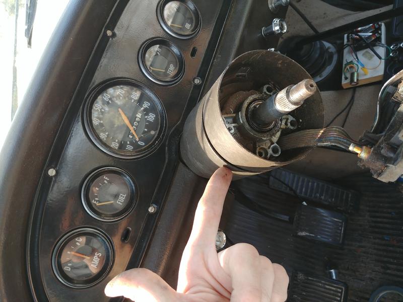

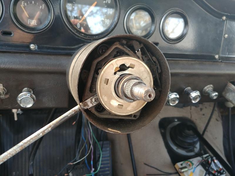

Your steering column is from a D-line and not a SII. Pics confirm. Probably the same organ donor that supplied the axles.
