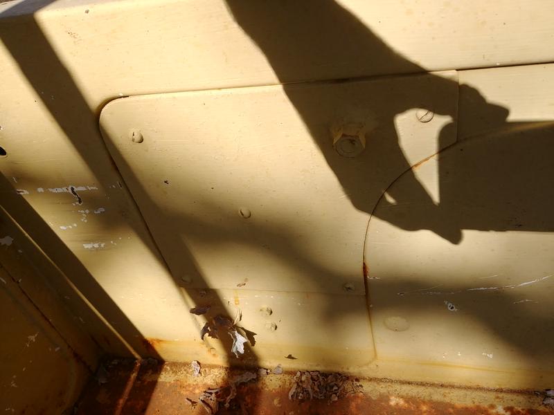

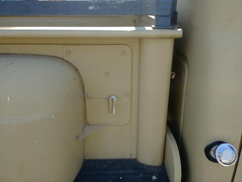

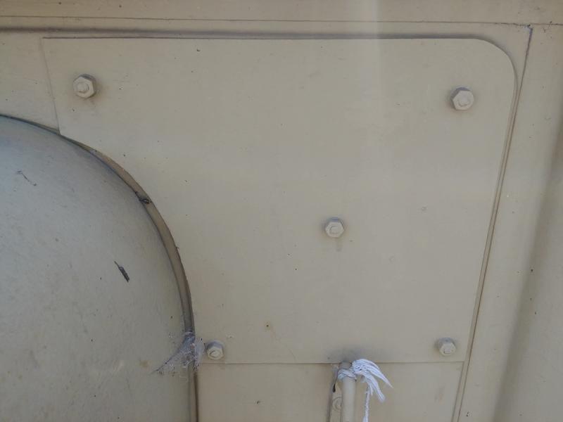

Well, I just found something weird. See pics. Looks like a filler neck mount patched off on my passenger side fender??? Wouldnt be weird if it was on the other side like for dual tanks... Idk....
Ewww. That is some nazdee lukin koolint. There will be some coolant and plenty of shmootz lingering inside the block. There are square head drain plugs on either side of the block, but they are generally rusted in super tight. The best way to get the hoogy and spoogy flushed out of the block is to punch out the freeze plugs, and force highly pressurized streams of water through from every possible angle, along with chucking a strategically bent coat hanger into power drill to ream the innards out in medieval fashion. The engine needs to be out of the truck for this. You can drive new freeze plugs into an installed engine, but you'll drive yourself positively bat shit crazy in the process.
