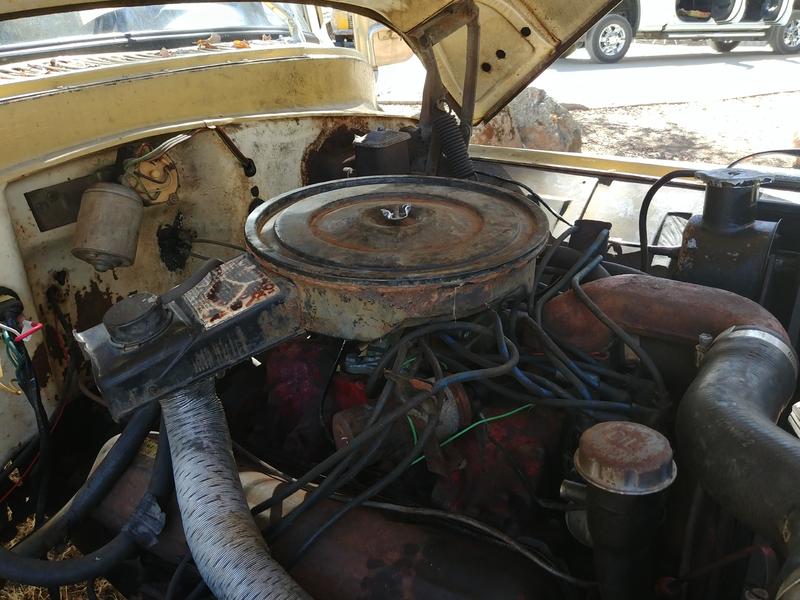

Unfortunately, both my block drains are fubared. :cryin: I can try to get the driver side out but have a feeling I'll end up rounding it. Will have to drill/tap the other side for sure, no clue how I'm going to clear the chips out unless the hole is at the ABSOLUTE bottom of the water jacket. Then they may rinse out with a hose from up top. I was looking through the service manual, is there a map for water flow? Like there is for oil? And any tips on not further fubaring the existing drain plug? Anyways, the heater is out, will tear into that tomorrow, as well as open up the t-stat housing/water pump. If things arent too rusty I will run a hose till the juice coming out is clear, then flush with a gallon of distilled since my water has alot of mineral content. If it looks semi clean in there I will install the new rad with new coolant. I ran it up to temp yesterday with a gallon of simple green in, coolant that came out today looked terrible compared to the near clear stuff that I got before I put the simple green in. Hopefully that worked all there was in there loose. Its getting all new hoses, t-stat, a few gaskets, heater valve repair kit, and a tune up while I have the rad tube off. Shiny new things to come, after I hack my way through 50 years of bandaids.... So yea business as usual :icon_eek:

WHY? WHY DID THE PO HAVE TO FIX EVERYTHING?!? :mad2: Uuhhhg. Heaters out, aparently the bright red valve spliced into my heater wasnt the only splice, someone thought it would be a good idea to saw off the outlet tube from the valve and use that to rout a straight tube through the fire wall to the heater core.

On the rad swap, this is what I've gotten off today, fortunately, it doesnt seem real sediment-ey, so what I think I will do is rinse like I planned, and run a extra does of flush for about 50 miles or so then flush and refill again. I'm also open to advice on what to do, I want to do the best I can for it, however budget will be the limiting factor.
