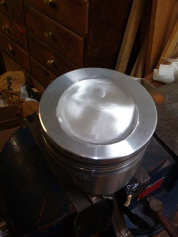

Ooops. Pic didn't load first time.
Good reason to do one's own measurements.

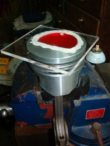

I don't mind at all. If I am off, then I am off. I am not using a medical syringe (I used them when in the clinical setting in a previous life, and don't always consider them as accurate as lab equipment). My graduated cylinder is simply one from a kit from summit, so it May be "good enough".
Technique:
filled cylinder to 50 cc line (lining up meniscus), using 50/50 water/alcohol, and a drop of red dye.
Using a light smear of white grease (see picture), placed plate onto top of piston, pressed down tight and got a good seal. Carefully poured liquid into teeny hole without spilling any (I have a steady hand) and filled it and tapped it to get air bubbles to come out of hole (was able to tilt piston and it worked out better than expected). When all air was out, and filled just to the hole, the cylinder read 38 cc (again, meniscus against line like the 50 cc line for consistency). Two cc's is actually quite a bit. Only sources of error are a cylinder that's inaccurate (possible), a plate that bowed (it isn't), or possibly an uneven piston top (it's flat), or something leaked out (it didn't), or I spilled some (I didn't). Occam's razor tells me the real possibility is that for whatever reason, the heels in my pistons are actually 12 cc. So I think my results are good. :icon_mrgreen: please let me know what you think.

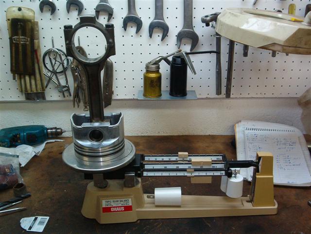

1 cc water = 1 gram. Since dense aluminum has a specific gravity of 2.8, 2.8 grams = 1 cc. So I needed to remove around 5.6 grams aluminum from the top of the piston. Consulting with silvolite catalogue's cross section of the piston, it was obvious the crown was thinnest at the bottom of the bootheel. So I would polish out the bootheel and extend the "d" to roughly complete the circle. Again, the machine shop would have done just this except with using an end mill, my guess was that careful grinding would be the same thing.
I have a triple-beam scale accurate to 0.1 gram. I first weighed each complete assembly (minus rings and bearings). The four piston/rod assemblies were within 0.4 grams of each other. My goal was to maintain this spread, and possibly improve upon it.
I selected the lightest assembly (1,961.0 grams) and using wide masking tape, taped it all up to keep out the grit. I weighed that assembly (adds about 9 grams!), and then began lightly grinding away at the heel's arc with a 3/4" drum sander mounted in the drill press, then switched to a 2" rotoloc disc (180 grit, iirc). Since the top of each piston has very fine concentric lines, it was easy to follow the desired contour. What resulted was actually a very nicely polished surface, much better than what was in the heel to begin with. Of course I'd grind, weigh, grind, weigh, grind, weigh, then do another, compare, weigh, compare, etc. Until I got them all down to about the same weights (within 0.3 gram), and paying particular attention to the pairs that would go up and down together. Got those to 0.2 g or better. When I finished, I cc'd the reliefs and confirmed they were now 14cc instead of the original 12cc. I now calculate a c.r. Of about 8.03:1. Close enough, no? This was a very time consuming process and took a whole day.

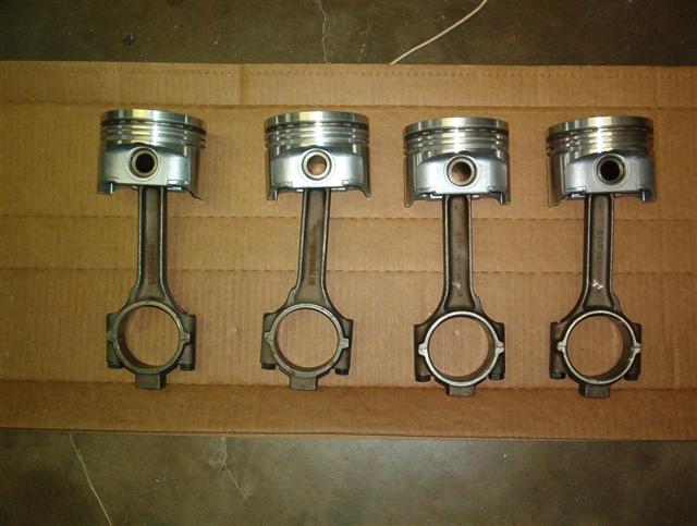

Trying to add pictures again!
