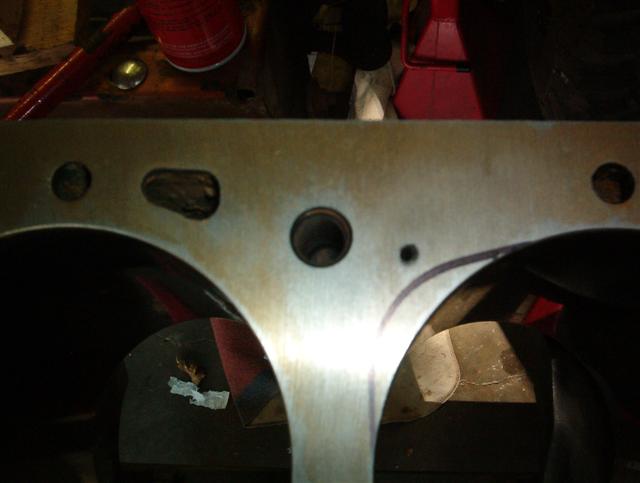

Got the felpro head gasket. It appears that that little hole is about 0.025-0.030" from the edge of the fire ring. :eek6: wow that's close, but good enough?

Reality time. I fit up that felpro pt gasket with the head dowels in place. That hole is not under the fire ring but is just about to it. Conceivably I can judiciously trim the locating dowel hole without adverse shifts to the ring rings themselves to shift it a tad more favorably.

It either is under the fire ring or it is not. Having more or less distance between the two does not not change things. If combustion gasses get past the ring it is over. I could only offer the possibility of peaning in some raught copper and stoning off the surface till smooth. Or fill the hole with your favorite sealant and clean the deck.

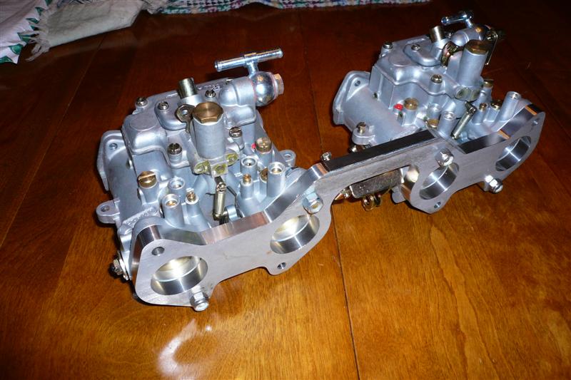

Im setting mine up blow through and using dhla 40h delortos speced for the lotus esprit turbo. Seen below

I'm looking at that hole and getting a sinking feeling, as it isn't really a clean hole. Looks like this was a small, corroded void uncovered when the block was surfaced. I'll fret about it tomorrow. In the meantime, I've put a "wanted" on the forum for a ic196 block as I May have to go down that road. Life's handed me worse setbacks. :rolleyes5:
edit: to try to put it to rest. My previous technique for measuring May have been defective. I now laid gasket on block with locating dowels. Used marker to blacken deck inside fire ring. Lightly scraped black w/metal edge to establish inside edge of ring. Remove gasket. Micrometer to measure gap (line of inside edge to edge of hole. 0.140"). Best measurement of width of fire ring on gasket (uncompressed - does that thing spread out once torqued down??) seems about 0.110" in that area. So it would seem 0.030" is "huge". Only concern would be edge erosion, but is that happening with the coolant holes? Probably not.

Hole in deck with felt marker showing gasket contour. Since finer measurement indicates around 0.025-0.030" to fire ring, I think I'll plug the hole with jb weld. Sole purpose is to seal coolant from fibrous portion of gasket.
