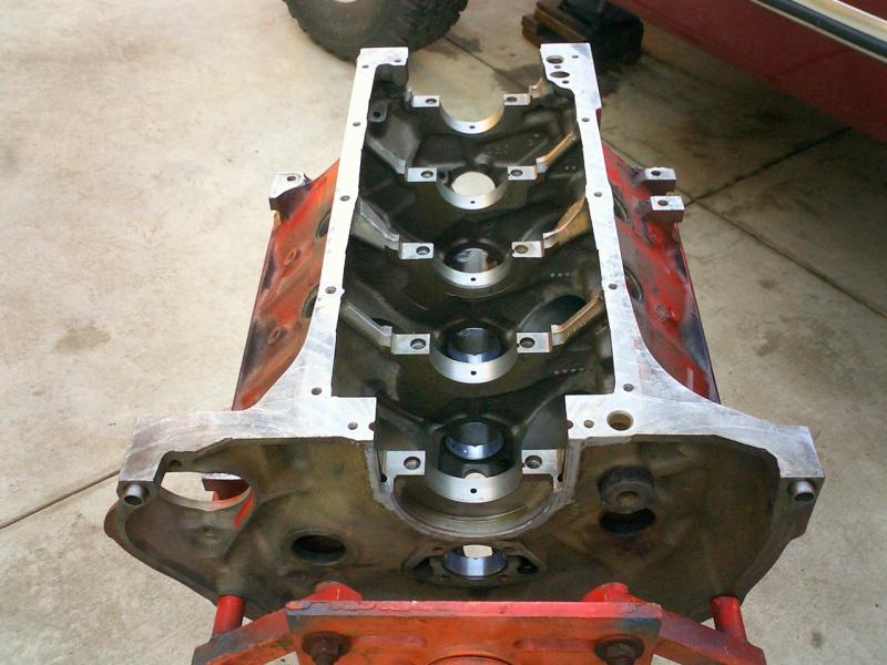

some advice on this situation. I have the engine block turned over and the main caps removed. The machine shop lined up the holes in all the cam bearings perfectly. That's the great news. But the very odd thing is this. The holes in the webs that feed oil to the mains and cam bearings are slightly larger than 7/32". The oil holes in the cam bearings for 1, 2, 3 and 5 are likewise this diameter as I can pass a drill bit this size completely through. What caught my eye was the hole in the cam bearing for #4. It was visibly smaller, so I sized it. A 9/64" bit just passes through it. #4 also ultimately feeds the rocker shaft. Why would the hole in #4 be smaller than the rest? It's actually just as wide as that arc/groove on the inside of the bearing surface it intercepts. Should I drill this one out to match the rest?
Opinions vary but I leave the bearing hole diameters alone so long as they are not overlapping and partially blocked.. Never had a problem with rocker assembly oiling.
On another note, only 2, 4 and 5 do more than oil the cam bearing 2 and 4 also supply oil to the valve train as you know. Drilling it to match #2 is your call. Suppose it can't hurt to match the two. Just make sure you deburr the drilling trash and don't let the drill jab the other side of the bearing. :icon_xp:

Washed the block yesterday. I don't care how great they say those machine shop washers work or how many times through they ran it. I brushed crud out of the oil galleries that would have gone straight to my bearings.
