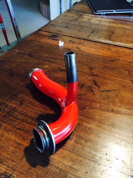

Got the pipe back from Jeff's, and now all painted and purdy. Put it in tomorrow.

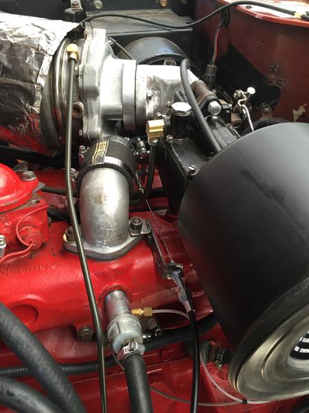

All hooked up. The routing around the return fitting on the pump is busy but will be cleaned up later on. So I took it for a run. It's 85 degrees now, cooler than the other day when I flogged it, but the results are still worth noting. Instead of the oil running 210 degrees, it runs around 185 degrees, or about 25 degrees difference. I would like to run it over the same course on a 100 degree day for a true comparison. In any case, it now has a lot of capacity to pull heat out of the oil.

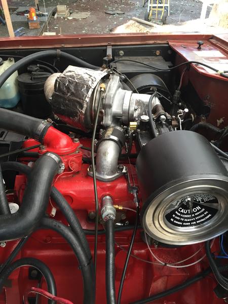

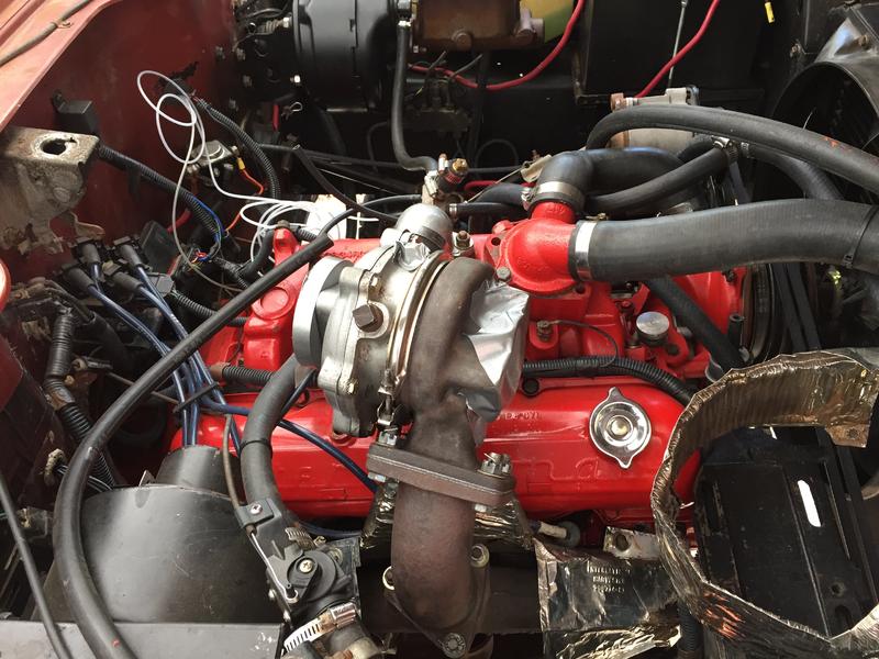

Took the day off to begin reinstalling the turbo. Up on stands, removed old exhaust system, carb and linkage, installed 3-bolt manifold and wedge, and then the turbo. Took four hours. There is a sequence to how seemingly simple bolts and bits and pieces go on. These manifolds, etc. Must have been a pain for the IH mechanics to service in the field. Tomorrow bolt on the carb, fuel and oil lines. Hoping to have it running by Monday!
I had forgotten how many little bits and pieces and contortions were required to reinstall this stuff. Breathing a sigh of relief that my adaptor-to-the-adaptor seems to line up right and that the carb can be set level and the turbo's outlet goes into the intake elbow fairly straight. Plan is still to fab a new one-piece adaptor for the corvair f-flow compressor housing.

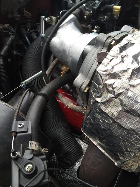

Coming in for a landing, but still to do: bend up a new oil line; hook up the carb linkage and install air cleaner; hook up line for pcv valve and a few other vacuum lines. I was very unsatisfied with the throttle linkage, meaning the cable. Length and lack of flexibility make adaptation marginal. Real tempted this week to go to Jeff's and pick up a lokar cable.

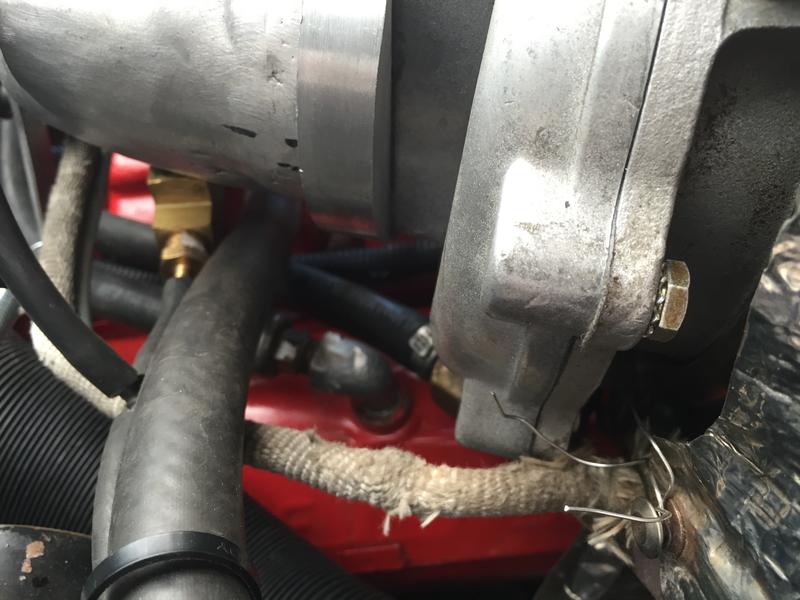

Btw, that's an IH oem turbine housing heat shield. You tuck the ends around and wrap bailing wire around little metal buttons to secure. Simple.
The last two pictures are the beginnings of a modification I plan on adding additional bracing. I always felt that IH should have added some type of additional bracing and heard the stories of broken exhaust manifold parts. My plan is to have a plate of 3/16" plate 11 inches long by 5 inches wide (sort of a trapezoid, actually - see cardboard template) and sandwich one end between the coolant outlet and the t-stat housing. Measurements show a 2 1/4" hole will flow the coolant and I can add two additional bolts to the t-stat housing's unused holes. Today I tapped those for heli-coils for 3/8" bolts. The plate will slant along the t-stat's surface plane and end up right next to the bottom edge of the turbine housing. Fabbing a couple of little brackets to bolt the housing to the plate should provide additional support for peace of mind.
Coming in for a landing. The last few steps are like pulling teeth if you want to do things right. I was never happy with the throttle cable adaptation I did for the first iteration, which used the original (and very stiff) throttle cable and welding up a bracket to hold the end of the cable housing. So I went to Jeff's and bought a lokar universal unit. Omg. Why did I not think to do this in the first place. So I ditched the other home made bracket and welded up a simpler one that was so....right. The lokar's flexibility was also key to this. And I discovered a 30" 1/4" brake line is exactly the right length to go from the turbo to the oil gallery pick-off point which is where the oil pressure sending unit normally sits.
Still need to route the gas line and vapor canister line out of the way of the exhaust down-pipe. Melted one of them last time; now need to do a proper fix. Still puzzling that out. Am thinking of routing them inside the frame rail forward of the back of the wheel well.

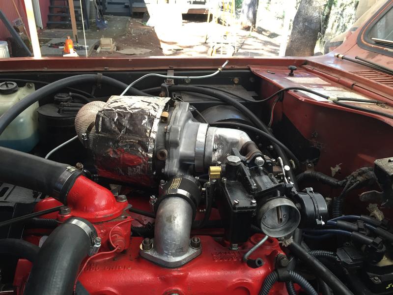

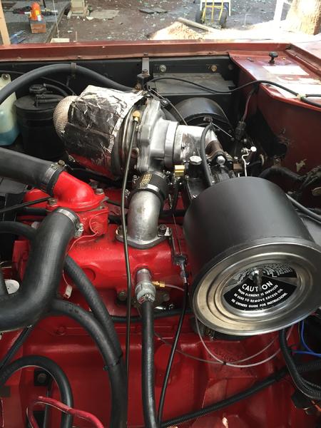

It's ready for the test ride. I've tidied up as many details as I can think of. Fired it up yesterday...no leaks! Nothing fell off! With no smog pump :winky: , and three-bolt flange connections before and after the turbo, this engine is noticeably quieter. The extra mass of the exhaust manifolding and turbo soak up a lot of normal exhaust sound. I figured out how to clean up the mess of hoses and things that are just different. Last time, I didn't believe there was clearance between the valve cover mounted backfire fitting and bought a oil filler cap w/nipple and ran a long hose from it to the air cleaner. I now realize there was enough room and have added a pipe elbow and run the fitting horizontally, removing a lot of excess hose in the area under the turbo that is quite busy. This helps with running the heat stove hose from the cast iron elbow to the snorkel I grafted onto the corvair spyder air cleaner. I also added the snorkel thermostat and guess what - the hot air choke and snorkel actually work. I also pinched the check valve from the power brake booster of a volvo turbo brick and these are identical to what we use except it will withstand boost pressure going the other direction without blowing out. I'd hate to think what an air/fuel mixture would do to my brake booster. I added a metal bracket to keep the valve in place. In working on this thing I keep bumping the hose and dislodging the valve. Anyway, paying attention to these sorts of details, in my opinion, makes the difference between a fairly decent looking conversion vs. A hack-job where things haven't been thought through. I want everything on this to work and make it have good manners.

Test ride. It's running better than it was, but the carb isn't giving a decent idle. Without smog junk on this you forget how Rich things ran. I think that this thing May run best with a stock needle/jet, but I have a +1 Rich rod in it now just so I don't run lean. I really need to slap an a/f meter on it to see where it is.
In this hilly area, boost comes on quick. Begins to pull in 2nd gear, 3rd is effortless with throttle. I can pull 5 lbs. In a blink. I haven't gone higher although I know it will. I put about 1/3 tank of premium in it (all it would handle) and will wait until I get a full tank of it before I press it more.

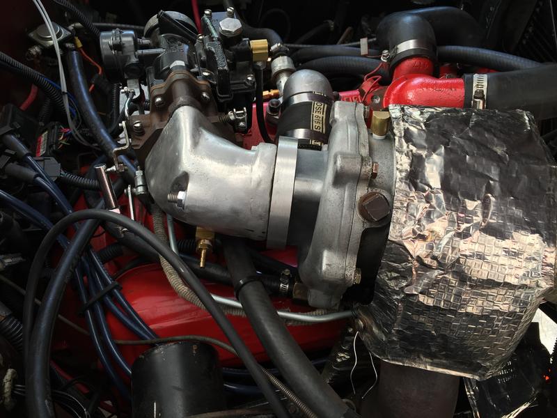

edit: the carb is now "surfaced". I knew there was a vacuum leak between the interface of the two adaptors and have discovered that one of the three threaded rod studs between them isn't aligned good enough and prevents them mating up flat. I need to hog out one of the holes passing through the original adaptor, unfortunately it's the longest passage. Fabbing a new, one piece adaptor will have to wait until after the gv meet. I'll have two triangular flanges made if I can't find an off-the-shelf flange at the specialty shop I go to for such things, and use heavy wall exhaust tubing in between.
Spent the morning reassembling the turbo with a new, modern carbon seal assembly, and bolting everything together. I pre-lubed the turbo until oil came out the drain line and it fired right up. The carb has a goofy fast idle mechanism and it's set a little fast, but once everything warmed up and the choke came off, it settled down to a half-way decent idle. I'm pulling 17-18" hg, which is great. Sprayed starting fluid around the previously troublesome locations without noticeable effect, so hopefully my vacuum leaks have been fixed. Hoping to mount the a/f meter tomorrow, and then take it for a ride.
