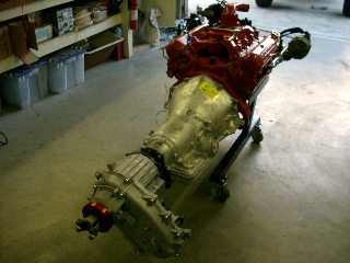

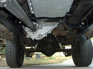

Its still an option down the road. This truck started with the 727/d-20 combo. Just add the motor plate from ihon, and you're in business. Ihc motivation and od too.

What kind of help to your fuel guage does that overdrive offer? Lower bottom gears would be nice since I want to put on 35's but don't wanna mess with re-building the axles...

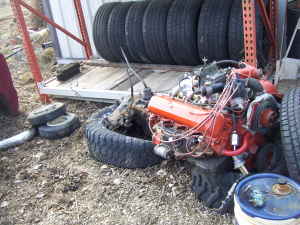

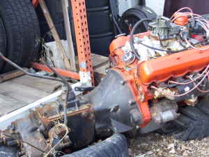

Daggum man. U speek beter rednik then evin me... Anyhoot, here's a couple pics of the motor that I just bought. It was out of a show Scout. The mechanic switched this motor for a chitvy 454... It wound up sitting in the yard since March of last year... About three months ago (at least he was honest... I hope?) he said the cover blew off and they didn't put it back on... Unfortunately the carb is uncovered. Ie, no air cleaner, soooo... Hopefully it was out of the rain enough that the manifold didn't fill up with water and rust. We'll see when I break it down. The motor looks like a show motor, but then again I consider anything not covered in oil and grime a show motor! He's gonna send me better pics tomorrow. So ya, I'm feelin' pretty good about it all. I'll get on Maybens post now and see what he thinks I should do. Thanks for the insight. Hopefully all of this will alow me enough extra cash that I can do my spring over and get some 35's on so I can actually trail it this summer! We'll see eh??

Pics? Where they be? Yawl kaint teez us lyk that! Rust in the intake isn't the primary concern. Rust in the cylinder bores that welds the pistons in place is. Lotsa praktiss deevelupin this here my-t-fyne kumand uh the inglish langwij I got, startin' with my rurul upbringin' in south dugluss kowntee folload by my kontinyoowin post secundaree edjumukashun at the binder u.
Now I see pics. They didn't show up at first. Looks real purdy on the outside. I hope the inside's just as purdy.
Whatta deal ya got there! And a whole lot cheeeper and ez'er than any motor swap!!
But...since I'm always the pessimist arount here, please take time to verify that motor is free to turn and does not have any issues since it's internals have been exposed to the atmosphere! Moisture condensation will do as much or more damage to this stuff as sticking a garden hose down the gullet or settin' in tha rain.

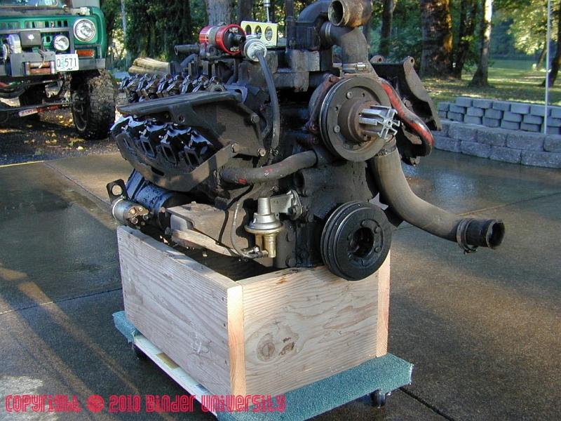

With the motor onna stand or onna pallet, you can do the entire pre-lube process before you install it! If ya fab up a "box" to mount it on of say 2x12 lumber, ya can actually start and run the motor off a fuel can and a water hose. This pic issa 345 inna box, I later rigged up some more secure "mounts so I could use it for a redneck run stand. It's also had a built Ford fe motor running on it with headers mounted. That harbor freight dolly is rated for 1,000lbs., I've got several of those in both sizes I use for storing transmissions, engines, etc., buy when in the sale paper and they are almost free!

Thanks for the idea mayben. I think since I'm going to be going through the 392 for a bit, and then I'll have the 345 to go through as well, I'm just gonna invest in a cheap engine stand. I have tractors, so I don't need a cherry picker, so this all should go pretty well.
