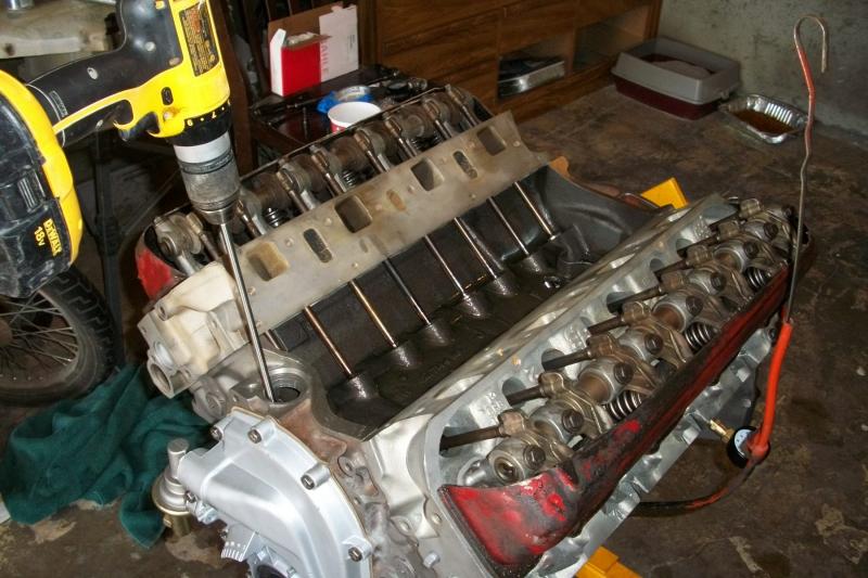

So I assembled everything and got to where I'm priming the oil galleries, lifters and rockers. The problem is that the rockers on the passenger side are not oiling. I have 52 psi constant on 10w30 oil. I went ahead and took off the head to see if I installed the head gasket wrong and it's fine. With the head off I still have no oil coming from the gallery. I can stick stuff down the hole and there's oil in the bottom of the hole, but nothing when I use the pump. After reviewing the lubrication chart in my manual all that I can figure is that my mechanic installed the forth cam bearing wrong and the oil holes were not lined up. I will take the blame for not double checking if this is the case but it will also piss me off to no end. So please help, tell me there's another really easy solution to this problem... I can't think of anything else to do but take it all the way down to the cam again.
Thanks
The head oil passages through the cam bearings only supply oil to their respective head during a limited rotation angle of the cam.
To make a long story short, rotate the engine 10 degrees at a time and re-commence pre oiling for 30 seconds at each point. You should get oil at some index. If not the cam bearing is wrong.
Robert! You are awesome. I had tried rotating it before but I only ran the drill about 5 seconds each time... I did it all again and rotated it 10 degrees at a time running the drill for a minimum of 30 seconds, and by the 5th rotation it must have lined up because it came out in force. Thank you bro, I was about to start taking sh*t apart!

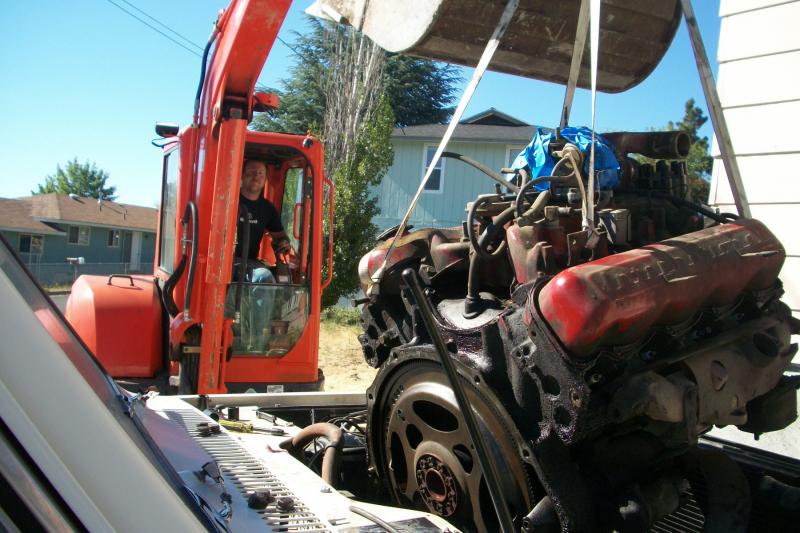

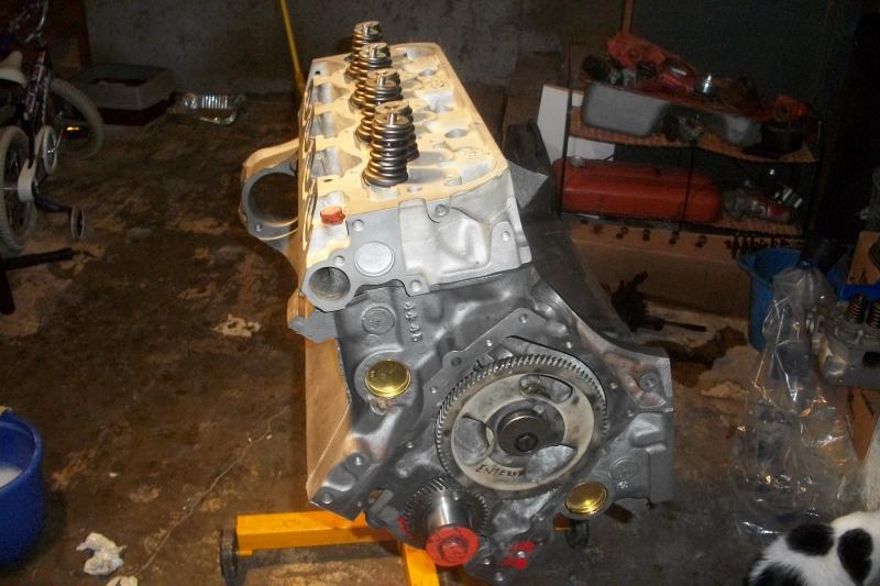

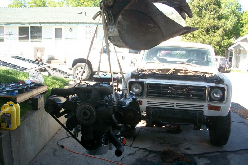

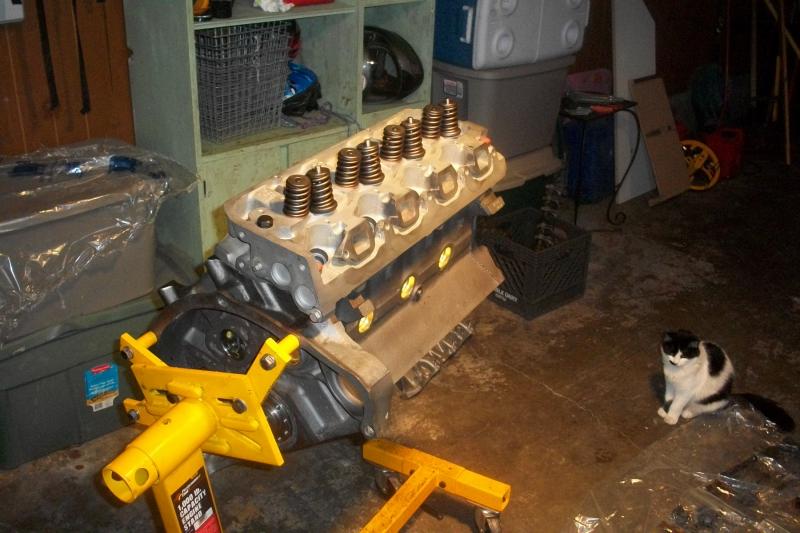

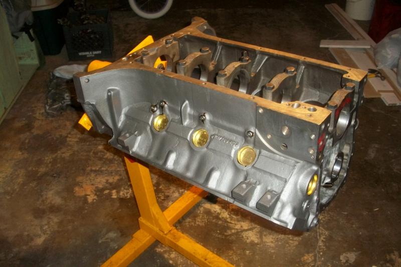

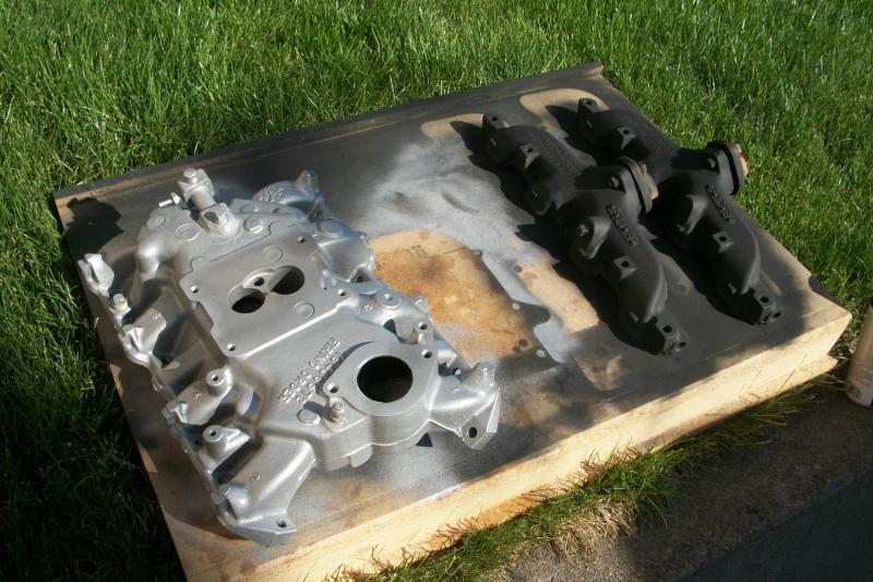

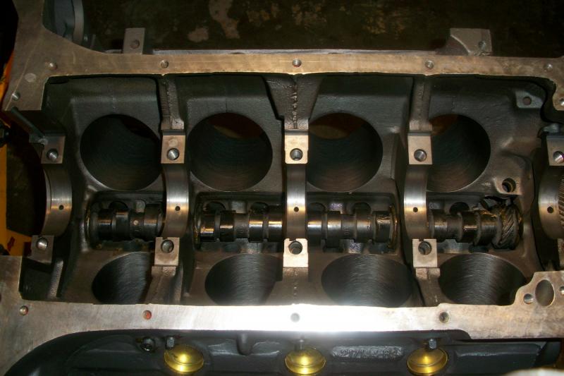

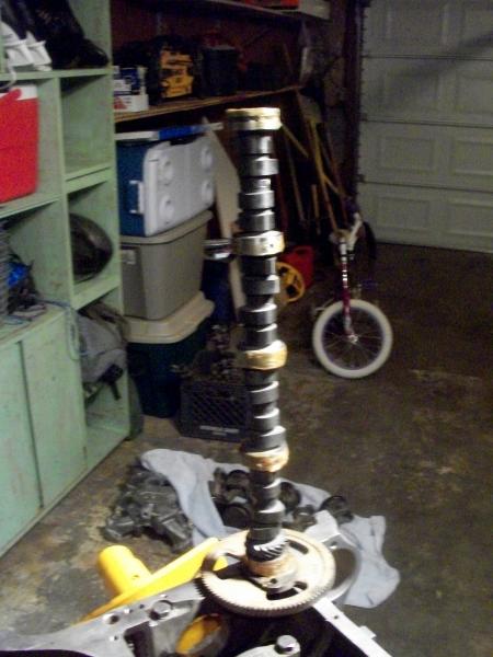

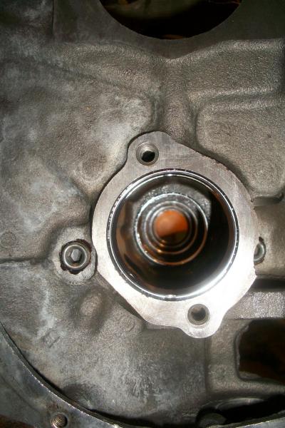

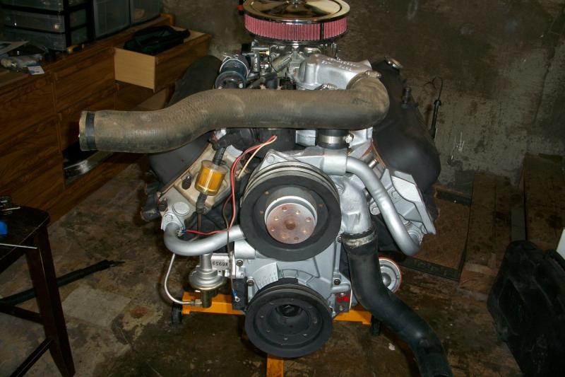

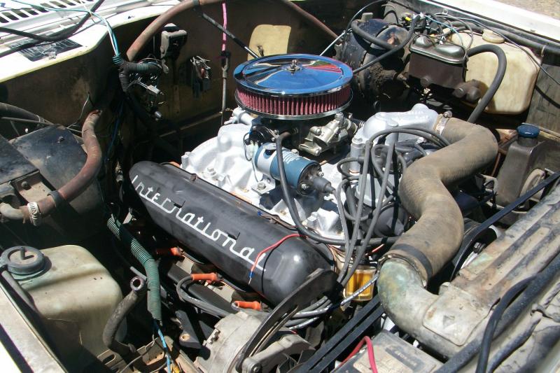

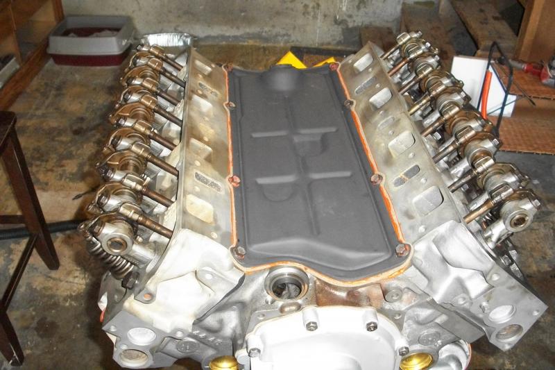

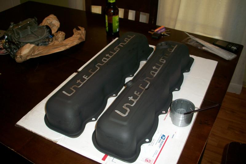

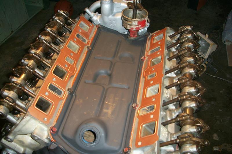

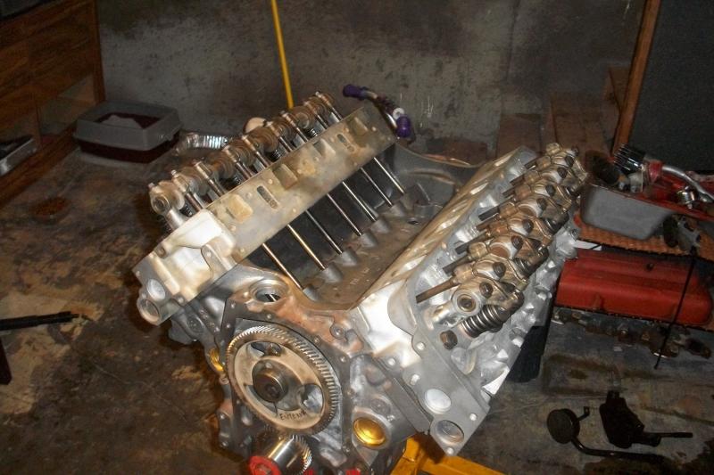

We have lift off! Engine's in and runs good. Got it broken in when I ran out of gas (literally) at 9:30. Here's some pictures of the build up. It came out pretty good for my first rebuild. All said and done this is what was done:
new oregon cam grinders rv cam
new johnson lifters
three angle valve job/ground valves/new valve seats (inserts)
block was tanked and blasted
heads were magged
crank was miked
new bearings throughout
bores were deglazed and honed
new rings
rebuilt oil pump
mayben built me a carb for it *props*
I dropped in the engine yesterday and it's running today so I'm stoked. I'm really happy since this is my first real rebuild.
I want to thank all of you who helped me with this project, there's no way I would have attempted this on my own and I couldn't have done it without all of your expertise.
I'll post links of how it sounds when I have time, but for now here's some pics to gander at.
Mayben and trever, check out my sweet cherry picker. :out:
