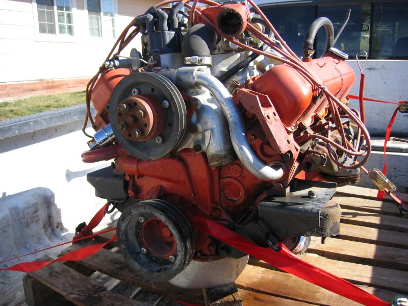

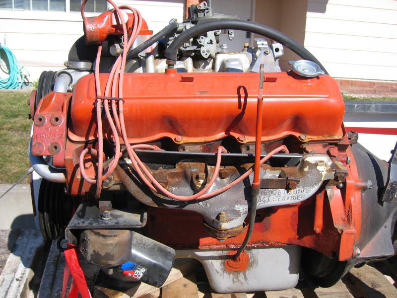

As long as that rust hasn't migrated down into the cylinder bores, no biggie. Ya got a donor 2v manny on the clank motor if this'n here is beyond redemption.

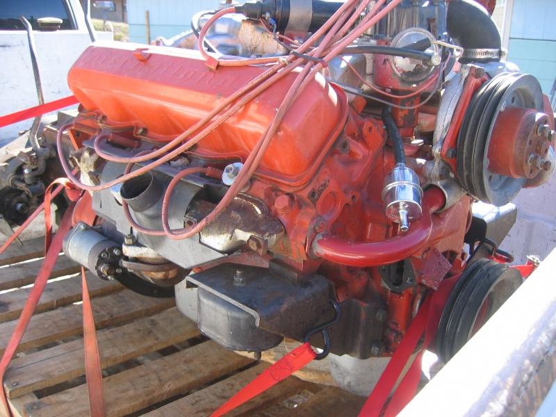

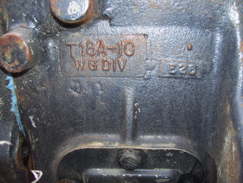

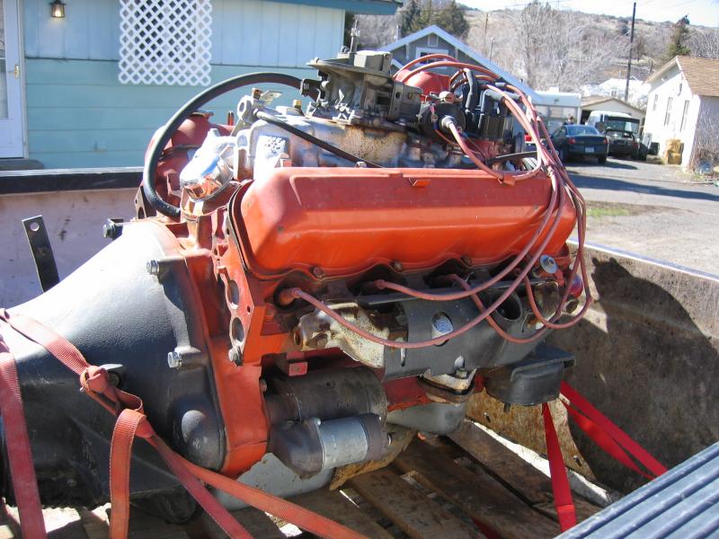

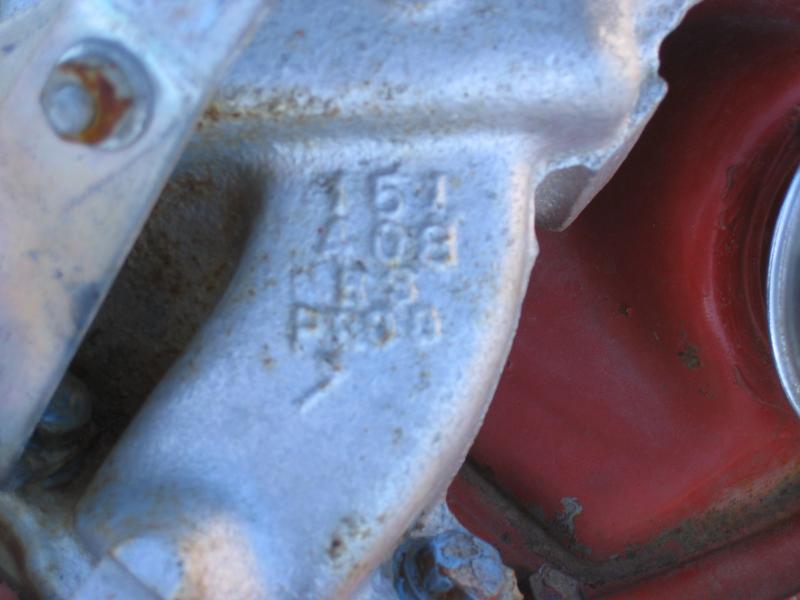

once again, I prove my ignorance. I was looking at what I thot was the mount, but it was part of the head. Ya. It's a 304. What does this mean for me?
Are you looking at the machined surface on the passenger side close to where the fuel pump is located? And it says something like a304? Pic please. If this is a 304, then you got storied by sumbudy, maybe not intentionally. It happens all the time. Person a mistakenly tells person b that it's 345 or a 392. When in fact it's something else. Bad info gets passed along to the next guy. If this is a 304, then my intake swap suggestion from just a couple minutes ago doesn't apply. In the end it means you've got a 304, not something else. Dissapointing, yes, but not the end of the world so long as it's a good 304.
Ya, just above the pass side motor mount. It was black (like the motor mount, so I thot it was the motor mount, but after re-examination it's deffinitely stamped on the head, above the motor mount by 1" and next to the exhaust. 304a I'll pic it later when I'm not working.
I've always been a "bigger is better" kinda guy... But I don't really know the dif between the 304, 345, and 392 regarding power, fuel economy, ease of service, etc, etc...
Bummer dude. You just learned another lesson. That surface is actually part of the block, not the head. The 304 is a very good motor. Service is about the same for each as they belong to the same family. It revs a little higher a little faster than it's big brothers. In proper state of tune you can expect slightly better fuel economy also. Yes there is a drop off in power, mainly torque as none of these engines generate eye-popping horsepower without significant modification. But it will still scoot your Scout along with no trouble.

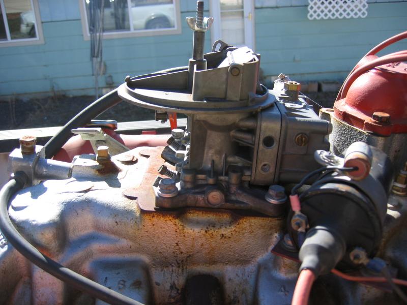

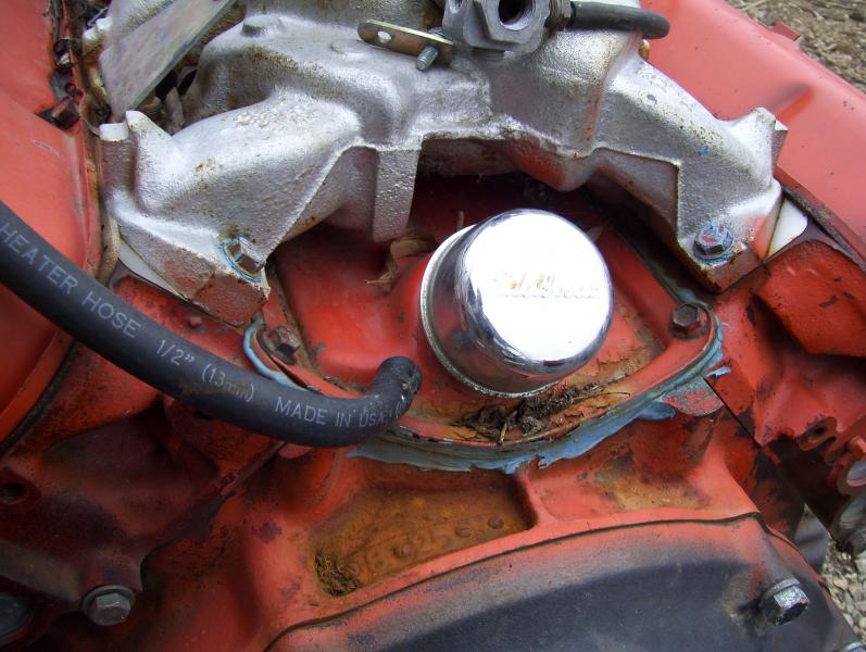

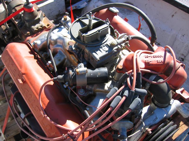

Wellp, got the heads off. Not as bad as I thought it was gonna be, but not as good as I'd like either. Here's the pics, tell me what ya think.
The rusty one on top is #2, the one that has a bit of rust in the cylinder #7. It seems like it's just a little bit of rust, maybe I can hone it out? All the rust on #2 is pretty nasty, but the cylinder is at tdc so it's not too bad on the cylinder walls. After I oil everything good with the pump (I still haven't drained the oil and changed it yet), I will turn it over a bit and see if there's any rust lower in the cylinders. Hope not! On the bright side none of the oil passages are clogged (the rockers I mean).

And that my friend is just what I'd expect to see in an engine left exposed to the elements!
And how many times have others been in this exact same sitch and followed the advice of others to "just run it!" with resulting catastrophic failure of yet one more sv engine!!! You certainly made the right choice to pull inspection on this one!
I know this is not technically correct...but since this rig is basically a "toy" as I understand it and not a dd/life, I'd do a basic clean-up as you are prolly doing right now! Pull those two rod/pistons and use a brush hone in the holes. I know it looks bad, but you will be surprised at how well it cleans up.
Same for the head with the water in the combustion chamber, pull both valves and clean well. If any water etching is noted on the valve face/seats, then do a light hand-lapping process and clean/re-assemble. Then carefully pour some rubbing alcohol into each port and watch for liquid leak. If it does not leak or leakage is barely a seep, then the valve/seat seal will be fine. Alcohol will actually seep though voids that gasoline or parts washer solvent will not. I always liquid test all my valve work after the head(s) is re-assembled before installing.

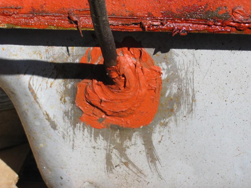

And with all that rtv slathered everywhere, I bet yore gonna find some on the oil pump pickup screen!
I've gone through this same thing with many marine genset motors that got "wet" inadvertently. Those had to be redneck overhauled with 'em installed in the hull as removal was simply not practical due to the situations.
This will give ya a runner motor now, then ya can put your future resources in building the pullout in a correct fashion!
