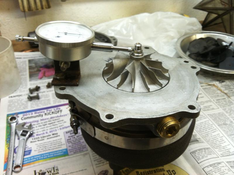

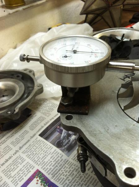

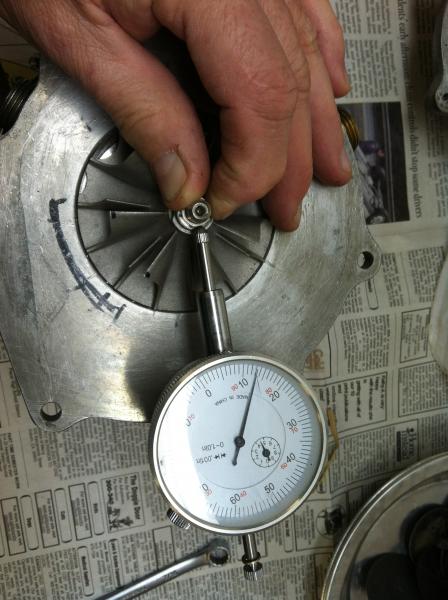

Shifting gears here a bit. I wanted to include these pics of how the radial play is measured, because I did have some difficulty with the new (reproduced) bearing not being right and having to have the vendor spec one out for me and compare it to an oem reference piece. Radial play is the total side-to-side play taken at the compressor nut after reassembling the rotating assembly. It is a "combination" measurement and infers adequate tightness of the bearing's od to the housing bore, and the turbine shaft clearance to the bearing's id. It should not be more than 0.022". I was getting readings all over the map and found I didn't have my dial indicator mounted correctly. After fixing that situation, I zero the tip to one of the nut's "flats", then press away from the indicator, then pull it backwards on the same axis. Here I had 0.013" one way, and 0.004" the other, then did a cross-reading 90 degrees to this. No total measurement came in worse than 0.019". End play of the assembly was also within spec, what, 0.008". Also, impeller blade-to-housing clearance (blade at the inlet) when pushed to its worst position was 0.005". There's no spec for this other than "you either hit or don't", so I believe my running clearances will be okay. So I'm calling it all good. IMG_0497.jpg

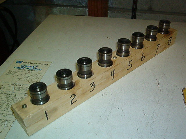

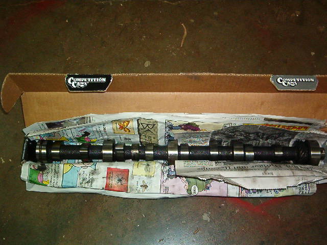

edit: Sunday afternoon. Pulled the camshaft. It's easier to do when an engine is on a stand, you know. :) but not too bad after you get the grille and radiator out. Hopefully will have an opportunity to take this shaft down to sac to the folks that ground it, to see what's going on (week after this coming week).
Edit/update: this past week took the shaft and lifters to the shop that did the work. These folks were super helpful (I think I must have been dealing with the owner). He took the time and went over everything about the shaft, how it was ground, and the lifters, and took the time to explain all the issues involved. We don't know why that one pushrod stopped spinning, but there was no evidence that the lifter itself actually had stopped; he showed me how the surfaces told him so. The bottoms of the lifters were crowned and not scuffed, you could see where it had bedded and rode in the right location. Lobes weren't scuffed. One thought is that the lifter body itself kept turning around the lifter plunger, which stopped for some reason. Can happen and hurts nothing. In any case there was no reason to do otherwise than "put it back in and drive it". The ring on the bottom of the lifter appears to be just a circular scratch from a bit of trash but does not justify replacement. Couple others had similar marks. With all that, I'm content to clean it all up, coat the lobes and lifter bottoms again with break-in lube and go for it. It's been pouring here this week so this will have to wait till the weather clears! Just to be clear, no evidence anyone or anything had been done wrong; this May be just one of those things but I'm gratified that those involved took the time to look into things. Better safe than sorry, you know.

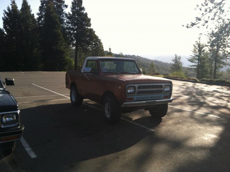

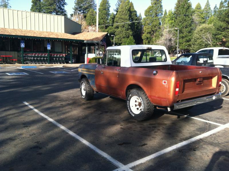

Finally on the road! Got the paperwork almost Done - I have it insured and a temporary plate, pending smog and the vin verification. So this morning drove it up to the little market for a tank of gas. Yesterday I drained out the last few gallons to make way for fresh gasoline. Tahoe is in the mountain range behind the truck. Note the multi-color paint. I think the original color was that tahitian red, and russett interior (per line setting ticket), but I had to replace a previously damaged left front that had been badly repaired, and also the lower valence. The right rear quarter is also smashed in, and right door dented. Like someone was drunk and sideswiped something. That's why this is my long-term project. But otherwise everything is now fairly straight.
What is good: the thing is a rattletrap but has no padding, carpet, door panels, etc. And the mud tires howl @ 55 mph. Suspension works great (for a Scout II) with all new spring eye and frame bushings, and the t19n I rebuilt shifts very nicely, but the detent spring that keeps you out of the reverse gate when shifting from 2nd to 3rd is soft. Usual weird sounds like a ringing (rattle) that I think is linkage or some such, but anyway, driving it several times down the foresthill road the seven miles to driver's flat and back reminded my why I love driving a Scout instead of my '85 jimmy. It's the relative coziness of the interior where you feel closer "to being one with the machine".
What is bad: it runs like crap. In all the years I've driven a cars and trucks, most with carbs, I don't believe I've encountered what I think Is a "lean surge" or roughness like this. Timing is set 5 btdc (instead of 0 per sticker) so that shouldn't be the problem. All the smog stuff is hooked up and working. Coming back up the grade from driver's flat (a sweeping curve about one mile or so long that goes from roughly 1200 feet to 2000 feet elevation, and the uphill grades subsequent to that, under moderate load the engine does pull, but misses like it's coughing - those brief, momentary losses of power. Does this with or without the egr. So….here's what I think, and welcome additional conjecture:
1) the carb is a 1940 but had been beaten up. I think I've got it back to where it should be working okay, but apparently not. Has the stock jet called for (#712) and since this was the last year of the smog motors, probably very lean, and without egr, too lean. Maybe I have a vacuum leak somewhere, but honestly, the only place I think left to leak is the intake manifold underneath - I don't find anything around the carb by using starting fluid. Or somewhere else! This is one thought.
2) the other is that I put in a brass float instead of the nitrophyl job, which sunk. Although they are interchangeable, could the brass float sit higher and has made my fuel level too low, giving a lean running condition? I'm going to pull the carb and add a bit more "level" to it. (thinking here from running tqs and the brass replacements had instructions to set them slightly different this way).
3) ignition is breaking down? It has the presolite w/internal module, but do those hard fail or can they go soft fail? There's a red mallory coil from the p.o. But I don't know if that's just chasing my tail to replace. Plug wires are new, running autolite 85s. How would I rule this out?
:mad2::mad2::mad2:
and a final reflection: I drove a '75 xlc w/345 up and down this road a thousand times. A 196 is not A 345! :lol:but I knew that going into this. So….when I get this all sorted out and smogged and my "plates", then I can set about improving the little engine's breathing. That was the whole point of this.

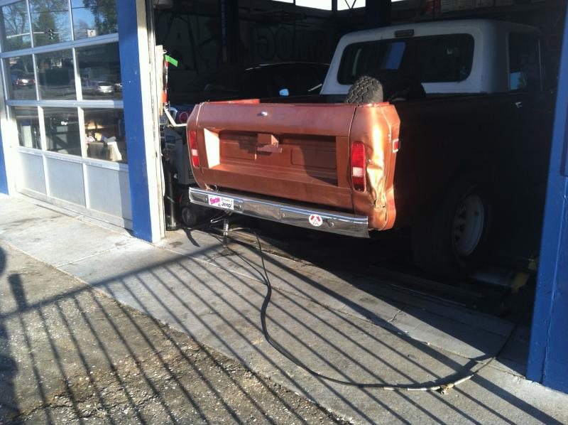

Got smogged today and passed with amazing numbers. I posted the ordeal over on the bp site, but regarding the engine, I'm pleased how clean it was. Of course, a rebuilt should be clean! I'm thinking that the quench (0.043") has something to do with it as well as the cat, but these numbers were about as good as my recently smogged 2003 camry! And this was done on the treadmill, not idling or run fast while stationary.
15 mph was co2: 13.0, o2: 2.5; max hc is 192, mine: 1 (not a typo); max co 1.36, mine: 0.00; max nox 1456, mind 575.
25 mph was co2: 13.3; o2: 1.7; max hc 115, mine 13; max co 1.16, mine 0.00; max nox 1316, mine 303. These numbers tell you the overall state of an engine and I think mine's good.
Now I get to put some of my upgrades on, until the next smog cycle in two years. Then that will be the last time it will need to pass California smog.

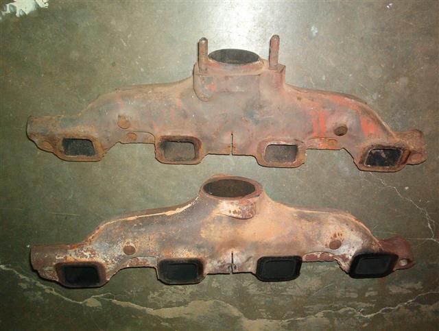

Update: preparing the turbo exhaust hardware for installation. This includes the unique upward-dumping 3-bolt manifold and "the wedge". These items use two of the shim-style gaskets (one between the head and wedge, the other between the other side of the wedge and the manifold). Because this assembly must mount solidly to the head and cantilevers the weight of the turbo back to the head, I need to ensure the mating surfaces are flat and bolt up solidly. I detected obvious warpage so today took the items down to moore's machine shop in Auburn for surfacing. It turns out the wedge is within something like <0.004" flat, either side, so we'll pass on surfacing that for now. However, the exhaust manifold, like its 2-bolt brethren, is found to be severely warped. Moore will need to take 0.020" off the four exhaust port pads and the two buttons to flatten things. Since the shim gaskets are only 0.015" thick, not counting the raised embossing, leakage would soon ensue after bolting up. Right now I'm running the 2-bolt unit pictured, but am using a thick composition exhaust gasket to prevent leakage. I know it is warped to at least this degree. If you look closely at the picture of the manifolds, you'll notice evidence of leakage to the ports just left of center. This tells me that these manifolds warp in the same manner, I.e., the end ports bolt down tight and seal, and the center ports - the center casting - bows out somewhat and leak.
Here are pics of the parts I'm talking about.Turbo man with head spacer (Small).jpg
