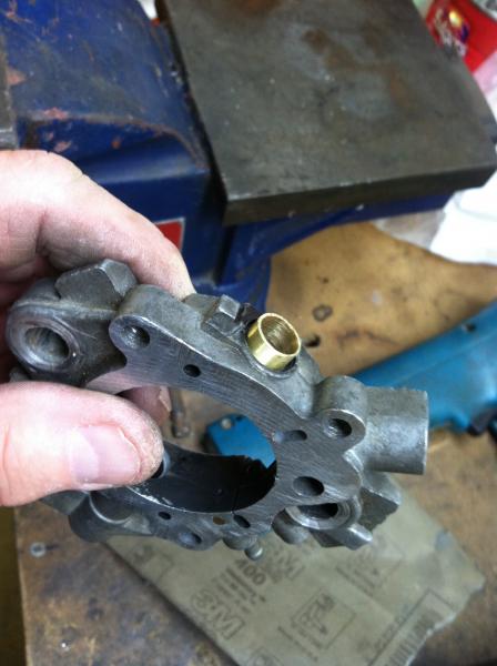

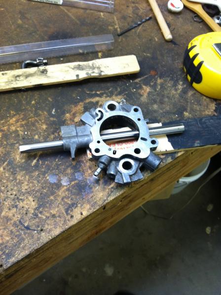

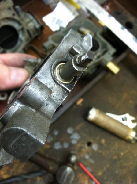

Finally got around to repairing the loose throttle shaft on the Holley 1940 carb. Bought a reamer (0.413 w/0.370 shank), used a dremel to back-cut "teeth" on the backside of the flutes, inserted the reamer and backwards-cut the hole. Shank serves as pilot. Machined a brass bushing to press fit into the hole (0.420" od into 0.417" id). Now there is, say, 0.001" play on that side. I chose to not press my luck and ream the linkage side, as it only has 0.006" play, within what is considered spec (<0.008"). Before it was over 0.020". I filed flat the slightly warped throttle plate, now will reassemble and fix the stripped screw holes. Hoping it will now maintain a stable idle.
Addendum: put all back together. Any idling below about 750 rpm is rough, no matter what I do. I can't see for the life of me how the book can say set idle to 550 rpm (not that I want to), as I don't see how that's possible. Any ideas, anyone?

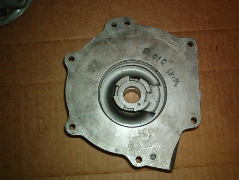

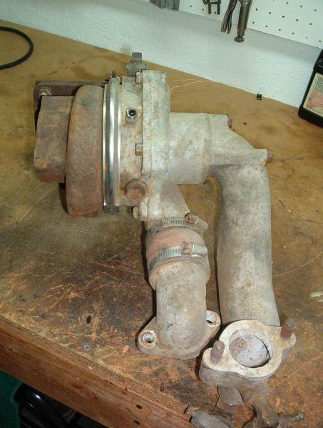

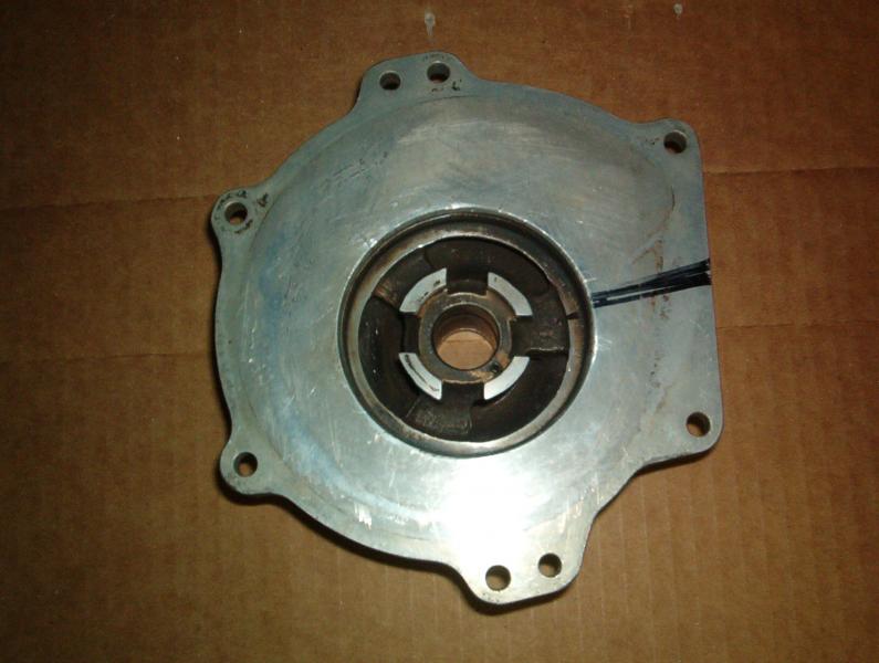

Towards this end. A few days ago I sent off the stock IH trw "b" flow turbocharger compressor housing to be machined to accept an "e" flow compressor wheel. It should be back in a week or so, but there will not be time (vacation) for me to assemble it before, say, late August.

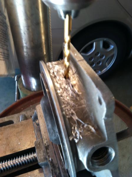

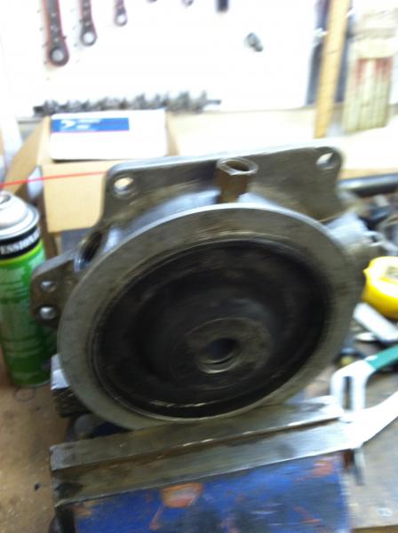

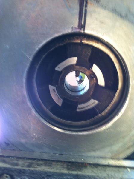

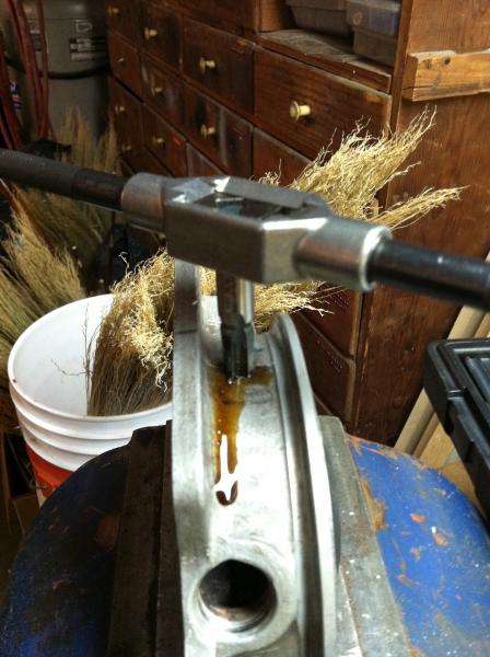

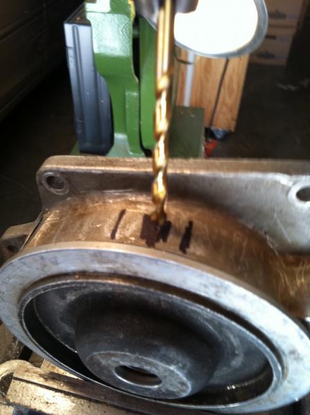

Today I performed another modification to the disassembled turbo. In the original 152t installation, oil is supplied to the turbo with a fitting that enters the center section, at about the 11 o'clock position. Due to the fittings, I am a bit nervous that I May not have underhood clearance for this. So I drilled a new oil feed, which will allow oil to enter the center section at about the 5 o'clock position. How can I do this? Easy. The IH turbo is the generic trw b flow, whose center section was cast with three webs supporting the bearing support (web every 120 degrees, interspaced with a drain boss every 120 degrees as well). Any of these can/were drilled according to application needs. So I chucked it into my drill press and did a pretty good job of lining it up and drilling it through. The old passage will be plugged with a 1/8" pipe plug. I broke through a little off center, but I have an extra center housing here where the factory machinist did little better. :icon_mrgreen:
with the corvair turbo, GM spec'd only one supporting web, and a drain in a particular orientation, which met their need, but limits its use for other operational needs. That's why these turbos don't readily lend themselves for fodder as an option to the 152t unit.

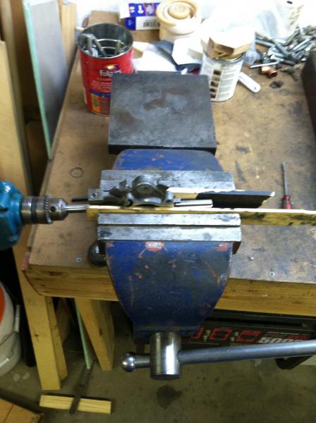

For some reason, there is a glitch preventing me from adding more pics to my post. So I am adding here the center housing mounted in a drill press vise, so I can use a 3/16" bit to tip the housing to the correct angle prior to drilling, using the existing hole. Then a pic of centering it after rotating it 120 degrees to the location of the next web. Then drilling, then tapping it for a 1/8" pipe fitting (will take a flare adaptor).
In the previous post there is a pic of the original 152t setup showing how the oil feed comes into the top near the 11 o'clock position.

And this completes it. This fitting will end up being clocked at about 5 o'clock.

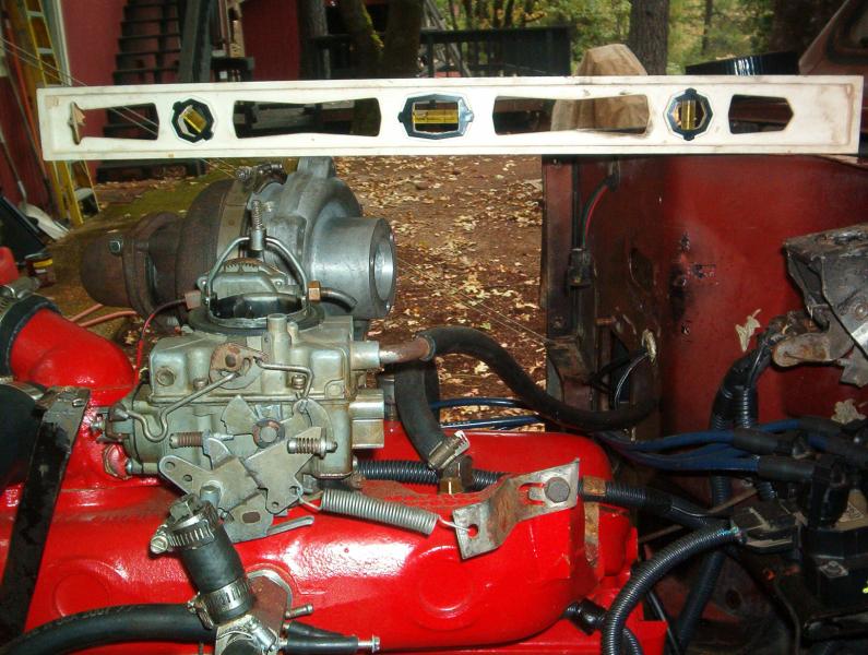

Update: in my drive to get this truck on the road, new engine broken in, plus a needed spare vehicle - before I can get to my ultimate turbo conversion - I'm going to have to smog this thing per kalifornia smog rules. The original owner(s) stripped the 49-state emissions equipment (it came from Nevada) and now putting that stuff back on is a pain. I have the smog rail, smog pump, will buy a new cat (original was still in place but major fubar), and am seeking the elusive 1979-80 "gulp valve". This truck will have to go to the referee station in sacramento for their "blessing". No way around it.

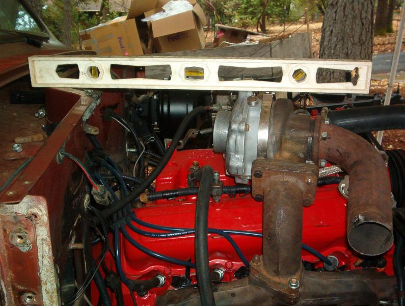

Since the front clip is still off and I need to remove pieces of the exhaust system to get a cat in there, I thought I'd take the opportunity to bolt up the turbo manifolding to gauge a few things that were mysteries to me. 1st was to verify that the 3-bolt manifold and wedge would not prevent the use of the ubiquitous a/c mounts found on most later engines. I had concerns as the front end of the manifolding comes out from the side of the block several inches more. The alternator does clear, but will require the use of much longer belts. This will swing the alternator way out and close the the inner fender, but it will work.
The second is to gauge how much of the original exhaust piping stub will need to be cut off to weld on a new 2.5" elbow and continue downward with a sloping piece that will tuck in between the frame and starter. Should clear. Then get it under the bell housing/trans to transition to where the new cat will go. Afterwards I won't remove the cat, I'll just plumb the turbo into it. It has 2.5" inlet/outlets and has a carb # (most importantly) and seems to be universal for the 79-80 IH 196, 304 and 345. I doubt the newer style cats are all that restrictive. Then when I convert to this, I'll have the exhaust ready to go.
Another thing was to see how much under hood clearance exists for the turbo's central bearing housing. I put a level on the top of the 1-bbl air cleaner, and found it is at the same level as the top of the turbo. I have new motor mounts but sagged body mounts, and am thinking that I will cut the new rubbers to 0.75" (plus the funny washer) which will get me to 7/8". Present mounts are 1/2".
So here are some pictures of what this is beginning to look like.
