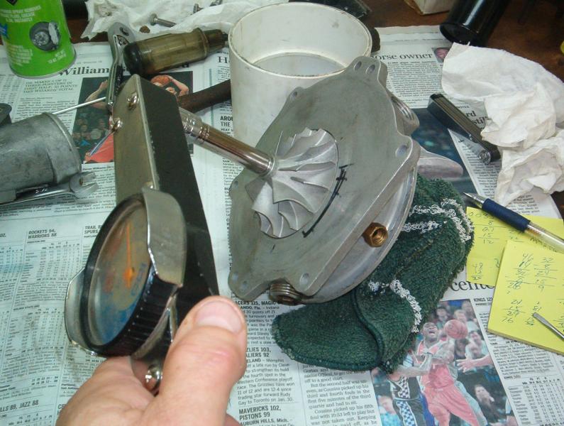

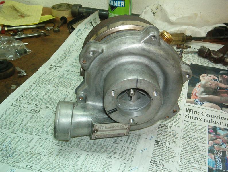

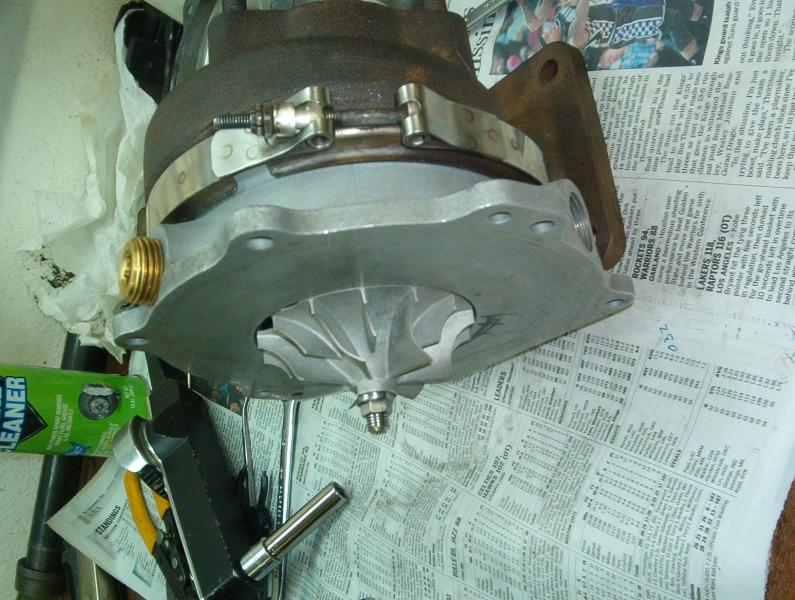

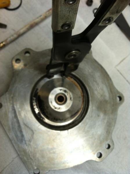

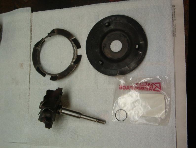

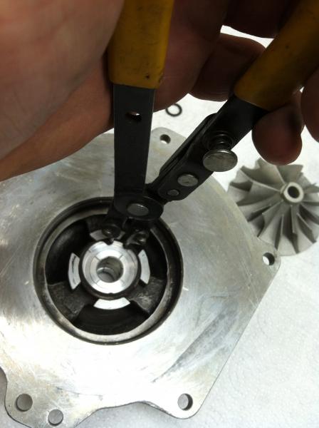

IM002213.jpgalthough putting the turbo on is still a ways off, I thought I'd take the opportunity to actually put the turbo together. Admittedly, this is old technology, but it is simple technology and it is not difficult to rebuild a trw 300 series turbocharger. I have previously posted about the need to increase the flow of the original "b" flow to better match the increased cubes of the 196. The next size up trw was an "f" flow, but my graphing doesn't show it to be adequate either. So I am going to "mix and match" the "f" flow turbine with a rayjay "e" flow impeller. Without rehashing the logic of this (maybe later), an e flow compressor will give me the flow, while the f flow turbine will give quicker spooling and the e flow turbine, this to hopefully bring it on sooner with the relatively slowly turning IH engine. Towards this end, I had the original IH b flow housing machined to accept the e flow wheel, which is an accepted practice. So here are pics of a disassembled and thoroughly cleaned 300 series. I'll refer to what's going on in these steps relative to the procedures found in the GM corvair manual. No real special tools needed other than snap ring tools, a dial indicator, and a 0.001" resolution caliper, and oh - get an inch-pound torque wrench. The one in the picture I got off ebay for $25. Reads up to 300 inch-pounds.

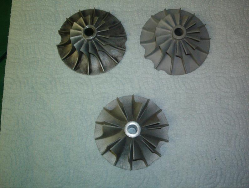

First pic - comparing b, f and e flow wheels (top left, top right, and bottom, respectively). Second - backside of machined compressor housing. Third is center housing that holds the guts - I've already drilled and tapped for a new oil feed - and various shims and snap rings, fourth is the new bearing, the dish holding the carbon seal, and more bits, and fifth is the f flow turbine and heat shield and spacing spring. In the baggie is the new "piston ring" seal for the turbine and a special plastic ring to compress it so it can slip into the center housing when the time comes. While this all looks confusing, it is really quite simple. The whole process is simply setting clearance for the bearing and then spacing for the impeller.

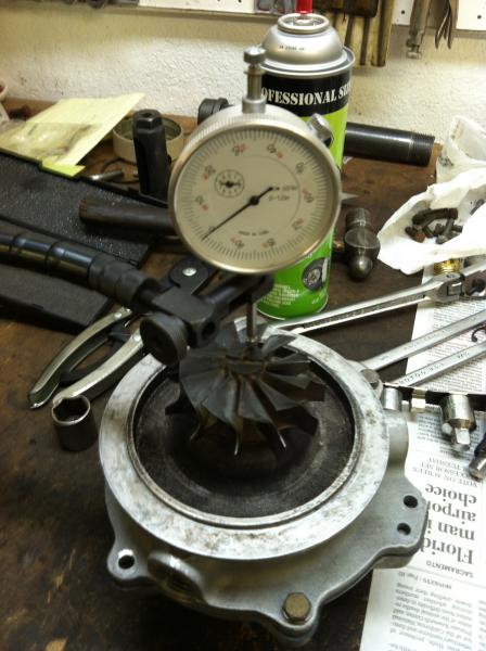

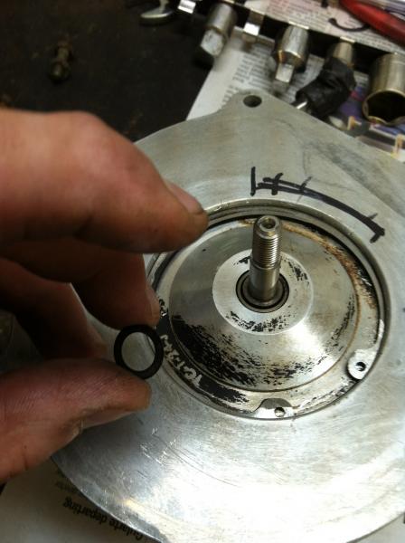

]next step is determining the end play of the new bearing upon the turbine shaft. In my case, it came in around 0.005", where it should be. You put the bearing on the shaft and install the mating ring on top of it, which "traps" it as when installed. Endplay measured by sliding a feeler gauge between the bearing and turbine shaft shoulder.

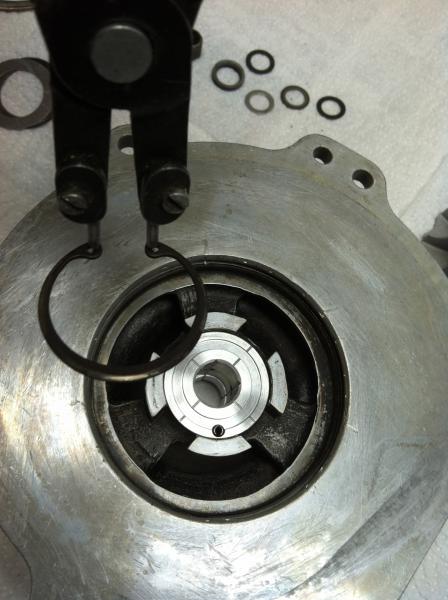

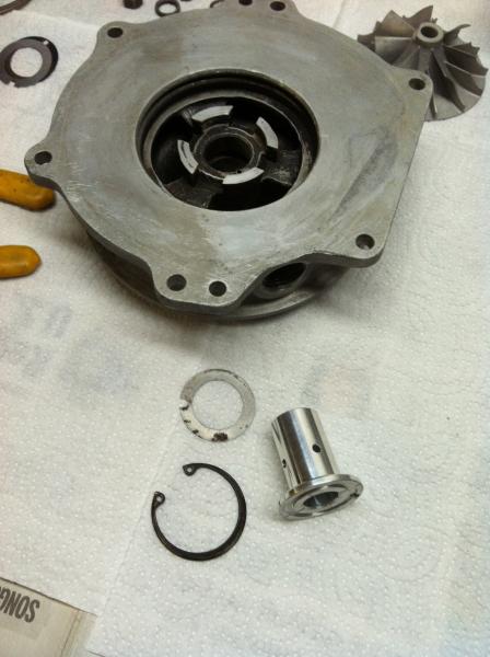

Next you determine the end play of the bearing in the housing itself. You use shims between the large diameter of the bearing and the housing. You want 0.001-0.002"; I got around 0.0025", which is still okay. I determined this by putting in a shim, then bearing, and then installing the small snap ring, and sliding various feeler gauges in between the snap ring and the bearing to see how much play there was.
So now total end play - bearing on shaft, and bearing in housing - is around 0.008" so far so good.

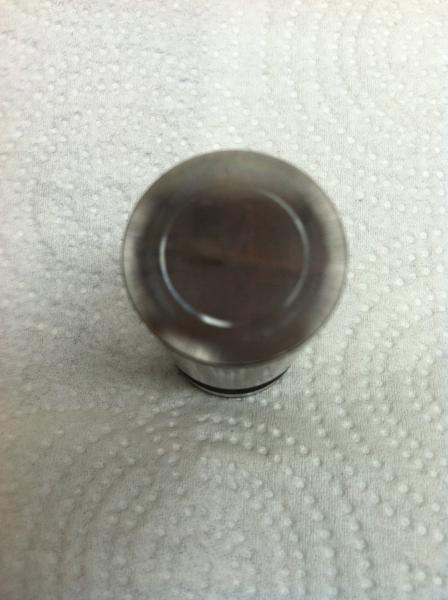

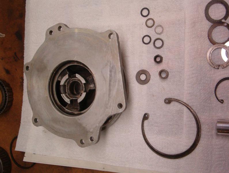

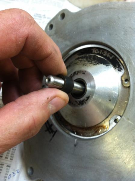

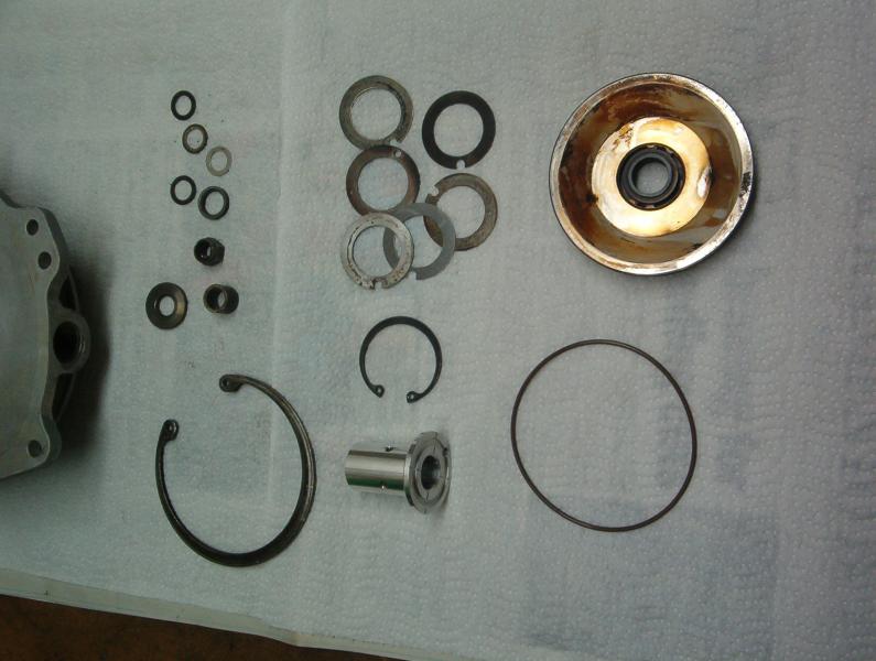

The mating ring is oiled and placed on the bearing thrust surface, and then the carbon seal "dish", and seal, is pressed into place after putting a large, thin o-ring onto it. Then the big snap ring. A spacer is placed into the hole in the middle of it all, then the e wheel, housing gasket and three bolts snugged to 80 inch-lbs. Then the turbine shaft, without piston ring, is carefully put into position without securing it with the left-hand nut. The whole point of this is to use a dial indicator to determine the distance the impeller has between the center housing and the compressor housing. I had 0.033" this time.
What the IH turbo "manual" leaves out - and the corvair GM manual includes - is a simple example of how to determine the shim required for proper spacing of the impeller. In my case, you take 0.033" and subtract 0.008", which gives 0.025". Then you subtract 0.015" and 0.020" separately from 0.025". Then you get 0.010" and 0.005", respectively, which is a range. The answer is a shim between these two numbers. Since there are only two shim possibilities - 0.010" and 0.015", I select 0.010", which is the outside limit. I'll have a clearance of 0.015", which is the minimum. It's really not that complicated once you have the parts in hand and look at how it goes together. So I placed a 0.010" shim on top of the spacer and underneath the impeller.IM002217.jpg

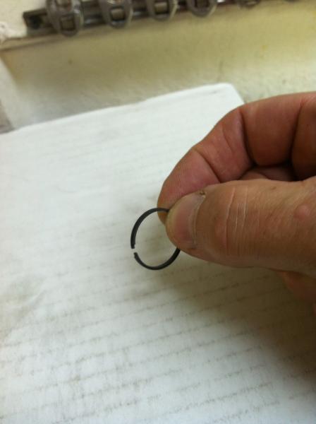

The piston ring is placed into the groove on the turbine shaft and the special plastic sleeve slipped over it so that the expanded ring won't snag (and ruin) itself and gouge the tight bore it rides in. In use, it does not rotate, but the shaft's groove rotates around it. It keeps oil out of the hot side. When you slide the turbine shaft "home", the plastic is forced off but isn't otherwise removed. When the turbo first operates, it will melt and blow away. I am not including pics of how the thick iron heat shield and special spacing spring is compressed so the turbine shaft can slide home, but one must be very careful with this step. I used a combination of 6" vice and a big c-clamp. Then the impeller is slid on....
The 5/16 - 24 nut that holds the impeller to the shaft is left hand, and torqued to 80 inch-lbs. The compressor housing's six bolts are likewise torqued to the same amount.

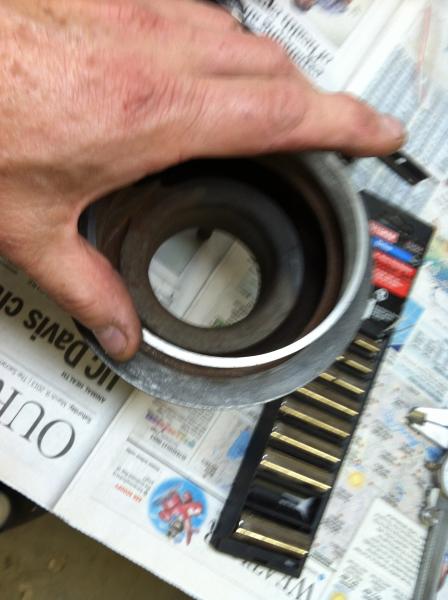

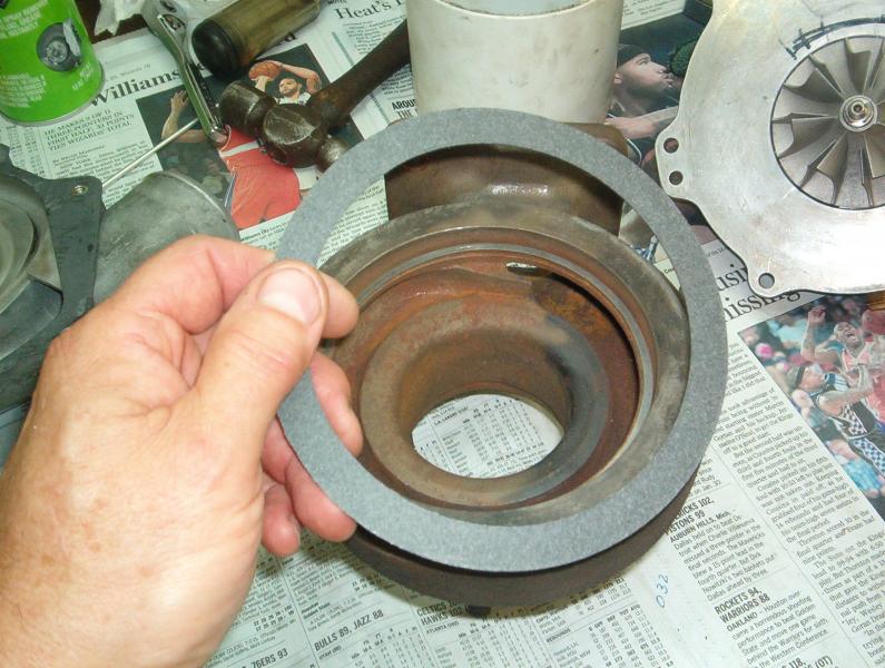

Most of these old turbo's turbine housings have been sand blasted, and that keeps the heat shield from compressing enough and it will then ride against the back of the turbine, which isn't a good thing. A special stainless steel ring is made to bring back the needed spacing, and is placed between the heat shield and the turbine housing. Then a special fiber gasket goes between the central housing and turbine housing, and the stylish v-clamp is torqued to 10 inch-lbs. I say stylish because this was the first clamp offered and shows in the parts books. Later production went "cheap" and a simpler band was devised. This happened to the corvair as well. Both IH turbos I acquired had the cheapie band, but I had an early style on hand. :thumbsup:
this is the gist of how a trw 300 series turbo goes together, and isn't a complete tutorial. But if you actually do this yourself, follow the manual. I left out some pics and steps.

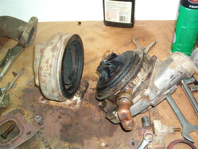

If I can do this, any one can. I'm also including some pics of what I started with in the next posting....

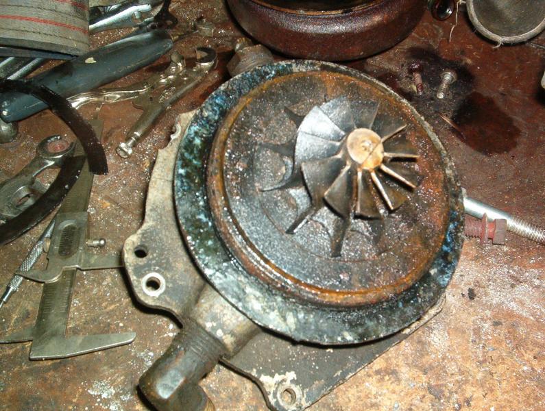

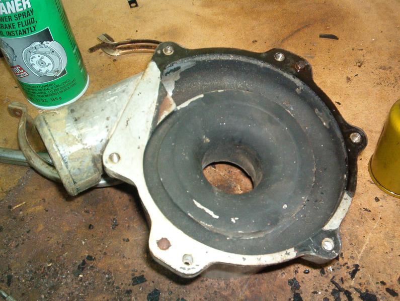

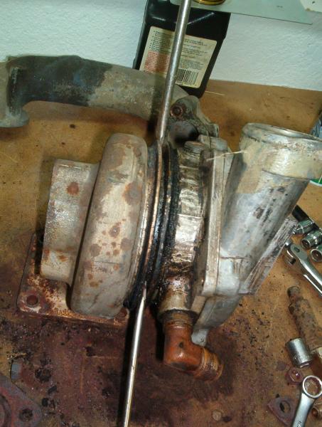

Getting these things apart in the first place puts you in one of two situations - lucking out where the turbine housing separates fairly easily - as mine did here after soaking the turbine cavity with penerating oil for many days and carefully applying heat with a propane torch, then - against all recommendations - carefully using large screwdrivers in strategic locations. Or...drastic measures. On one I actually had to use a sledge hammer and block of wood to get them apart, and it didn't ruin anything, but I was sweating bullets on that one.:eek6: this on the advise of a pro.... You'll note lots of heavy carbon and varnish on some of these parts, which is in large part the result of what must have been bad valve guides and rings, as well as the natural result of having a 'wet', draw-through system.
A heat gun will sufficiently expand the impeller so a drill press can be used to press out the turbine shaft - gee, just like in the pictures. Then it is a matter of getting the snap rings out and cleaning the parts in the usual manner.

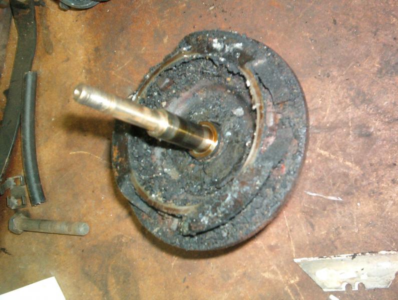

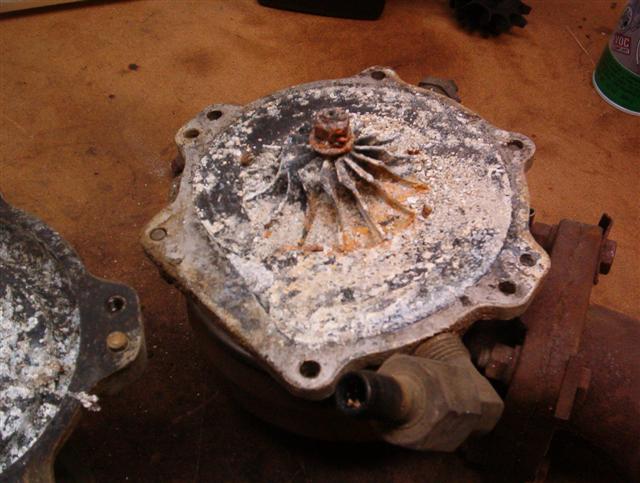

I included a pic of one I got that had gotten a lot of water in it. The insult to injury is that the p.o. Had rebuilt the thing and used a regular 5/16" right hand coarse nut to assemble it. It apparently lived a long time this way, but at the end of the day, few parts were salvageable on this turbo. A shame, as the b flow turbine shaft is popular in some quarters.

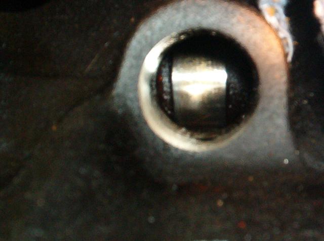

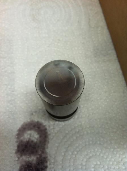

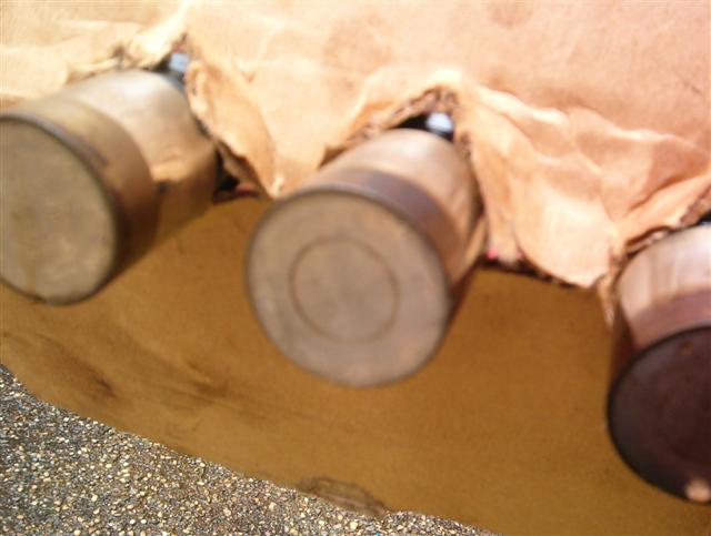

Here's a pic of the #6 lifter from the front, and a shot down the hole (crummy camera) during the initial tear-down a few years ago. This was the only lifter/lobe that looked out of the ordinary upon disassembly. Doesn't help now, but anyway…
I'll try to get to pulling that lifter today.

Thanks! Let's hold off till we know what needs to be done! I just now pulled the rocker arm shaft, pushrods, and that lifter. I pulled the one next to it also for comparison, since if there's something subtle I don't see, then there's that one. Here's what I see. There is a concentric ring on the bottom of the lifter #5 (fifth from the front). It is still like glass and does not catch a nail. I pulled the one next to it, #4. The appearance is otherwise identical save for that ring. Both bottoms have a very faint outer band to the edge (about 3/16" wide) that looks like exceedingly fine radial marks, almost like scuffs. Looking down the holes they look okay from two feet away but that doesn't mean anything. Can't get any closer. I wiped the bottoms of the lifters dry and put them together and there is the slightest rocking, so I'm guessing at least one of them had that arc ground into them.
Right before I pulled this apart I warmed it up and again watched the pushrod action. #1 and 2 actually spun backwards from the other six! (ccw) so the tilt on those was ground opposite the others (cw), for some reason, or perhaps by intent, I wouldn't know. A couple turned slowly, but I'd say still okay, some others somewhat faster (this at a slow idle). At around, say, 1500 rpm the rotations were what I'd say were okay, not spinning like tops but turning well enough. Except for #5, nada. Just stuck there. I suppose (wishful thinking?) that it is possible that the lifter was turning beneath the pushrod end, but that's wishful thinking. I don't believe it happens that way.
Here's the pic. Can't get a better shot.
