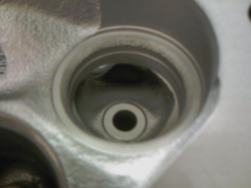

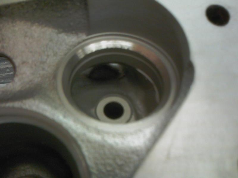

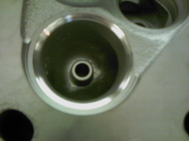

I have a question for you guys. My mechanic is saying I need to put inserts into my exhaust valve ports and grind them to spec. He's saying the existing valve seat is too porous to get a good seat. Here's some pictures of what I'm talking about. It's hard to tell but if you compare the larger opening (air intake) with the smaller (the exhaust) that has been ground already you can see on the one that's ground slight chips along the rim. I included a pic of a seat that hasn't been ground to show how porous they are. Hopefully you can tell. My question here is what do you guys think? My mechanic isn't telling me I have to do this, he's just recomending it. I want this thing strong so I'll do it if it's gonna really improve the life of the engine... But if all IH's exhaust seats look like this then is there a point? You guys know, I don't! Tell me what you think. :confused5:
let me clarify: the first picture is of a ground exhaust seat. You can see the rough edges where it should be solid metal but appears to be chipped.
The second picture is of an unground exhaust seat... Totally rough. You could file your fingernails on them.
The third picture is of a ground air intake seat. You can see solid metal and no chips.

The porousity is not normal on an IH. More likely errosion/corrosion from sitting that can be removed by further cutting. The seat face needs to have a 30* and 60* angles added to narrow the contact patch to about.08 and center it on the valve face at the correct location. The outer edge of the patch seen after light lapping should be no closer than .020 from the outer edge of the valve's face. That extra angle cut and a bit more 45* cutting will remove the rough edges.
Stem height will need to be adjusted by removing some from the valve stem. All valves need to be close to the same like with in .015 of each other. Not all shops are so critical as me but that is what I expect at a minimum.
So you think his wanting to install inserts is bunk? Just keep grinding it down and shorten the stems? Would stronger/longer springs need to be installed since there would be less spring travel? He's quoting me 18 bucks per valve and with 8 valves I'd be looking at an extra 144 to the already 175 valve job... Now my heads will be up over 300 without new springs... Add new springs and I'm at 400. I want it done right, but if I can save a few then that's ideal!

Ya, you are more or less right. He would bore out the old valve seat and pres in a thick metal ring (not sure what the material is), he would then grind that ring down to spec. As far as having to do the job again some day I'm not overly concerned... What I really don't want to deal with is the process of dealing with all of the symptoms leading up to needing a valve job... Number one being poor fuel ecconomy/bad compression.
The thick metal ring is what I would call a valve seat.
After replacement, you would grind the seat "to spec" just like you would grind the seat when a valve job is done.
If you have the seats replaced (I probably would - never seen a valve seat "eroded" like that), I would make sure that the guy used a replacement seat (ring) made of the same material as the stock seats (stellite, I think).

so you think his wanting to install inserts is bunk? Just keep grinding it down and shorten the stems? Would stronger/longer springs need to be installed since there would be less spring travel? He's quoting me 18 bucks per valve and with 8 valves I'd be looking at an extra 144 to the already 175 valve job... Now my heads will be up over 300 without new springs... Add new springs and I'm at 400. I want it done right, but if I can save a few then that's ideal!

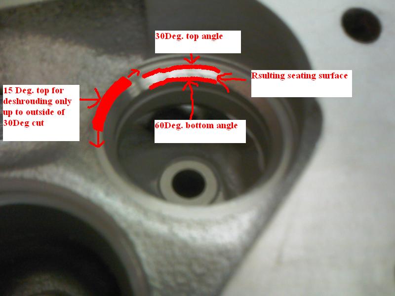

I marked up yout photo for more detail. And what I am talking about on the seal cuts. You can see how the cuts remove the erosion and make the 45 cut need to be less deep.
I don't feel you need to inserted your heads by any means. A normal seat takes maybe a .005 face cut to clean up, the eroded one will probably take .015-.020. Not an issue.
Any time a seat and valve are refinished the stem tip height needs to be comped for the increased height as a result of the cutting. A 2 second deal for the shop.
On your deal I would simply add a 15 on top to remove the pocket resulting from the relatively large face cut. The valve will likely sit down a bit below the surface and that will act to shroud the valve restricting flow. A normal deal an any machine shop..
I don't want to piss of your machine shop either so you are kinda caught between a rock and a hard place. If he is adamant on inserting the head you May have no choice.

IH cylinder heads were never plagued by seat erosion/recession/etc. Created by the industry conversion to low-lead/unleaded fuels circa 1975. Your machinists is drawing parallels with typical chryfordrolet shit and ya simply cannot do that, I say this over and over! No doubt he has not much/no experience in doing IH stuff which are truck/industrial engines.
But what you are seeing with the eroded seats is due to neglect (acidic erosion) and water having been in that engine.
Also...some sv engine variations used "inserted" valve seats on the exhaust side oem, as well as positive exhaust valve rotation (such as a roto-cap). Again, these engines are not "all the same".
A three angle valve job simply is a methodology to properly locate the valve face/seat contact patch in the proper location when seats and valves have been re-faced. That procedure is how the seat location is manipulated during final inspection/assembly and is the difference in a correct cylinder head reconditioning vs. Simply having the "valves ground".
That process can also be enhanced by doing an "interference" cut also. The interference cut is determined by the type of valve seat/valve face equipment is being used, whether it's a "grinding" process (stone dressing) or a "cut" process (such as using a neway system).
If the existing seat(s) have not been previously cut all to shit, then they have an indefinite life-span on IH stuff. Installing a hard seat insert is a method of repairing (reclaiming) a head and is not needed on any IH head except to reclaim a non-func head that no longer has a seat area that can be reconditioned. And ya don't need to do all of 'em, only the one that needs it! But normally we never get into this kinda mess because the heads are cracked which is a whole other deal! Cracked heads in the combustion chamber are definitely an issue with IH shit.
Regarding any valve/head reconditioning process, the most important aspect is correcting the "installed valve height" after the seat and valve cuts are completed. Other wise, what ya end up with is too little/no pre-load on the lifter, or a lifter that is collapsed. Much of the "lifter click" noise that folks piss about is caused by a "valve job" that was simply not done correctly. And IH motors are no different in that respect compared to any engine which uses a non-adjustable valve train.
When valve seat inserts are used in the machine shop in repair work, they May be in many forms and alloys of material and the material has to be compatible with the oem valve if it's being re-used, or with the replacement valve material. That is dependent upon the seat insert process the shop uses on a routine basis. The tooling and procedures for installing will vary with the type/design of the seat being used.
All this valve work is covered in surprisingly accurate detail in all versions of the IH shop manuals, including the process for repairing a head using valve seat inserts.
Has your machine shop dude addressed the valve guides yet??? That is the first thing that must be done, if a guide needs attention, it must be done before any other machine process is performed as the guide is the centerline reference for all other work.
Also...many machinists overlook the fact that the 196 and 392 motors use 30* intake valve face angles (as opposed to a nominal 45* angle)! So they jump right in and fuck everything up by cutting before they realize that!
