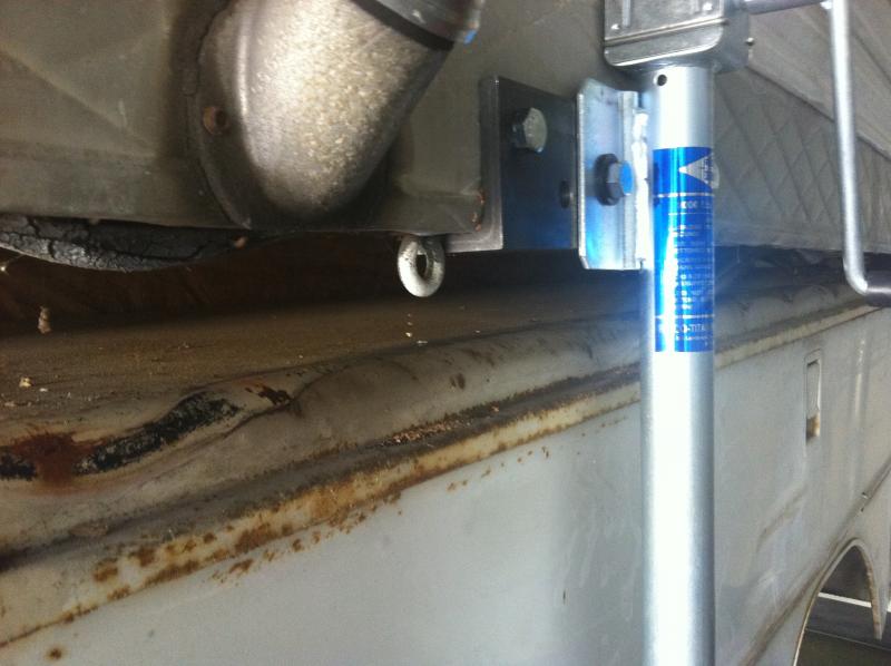

Have camper jacks and am making mounts to attach to under edge of camper. ($500.00 set of 4 new).

Mounted the jack adapters/mounts and we have lift off..

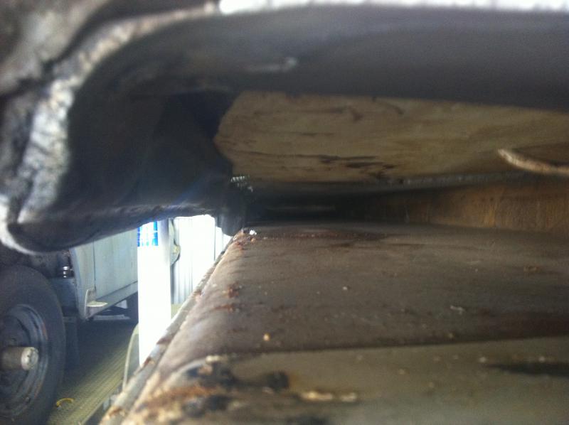

Didn't know that there were 4 bolts through the floor that held the camper in. :out:

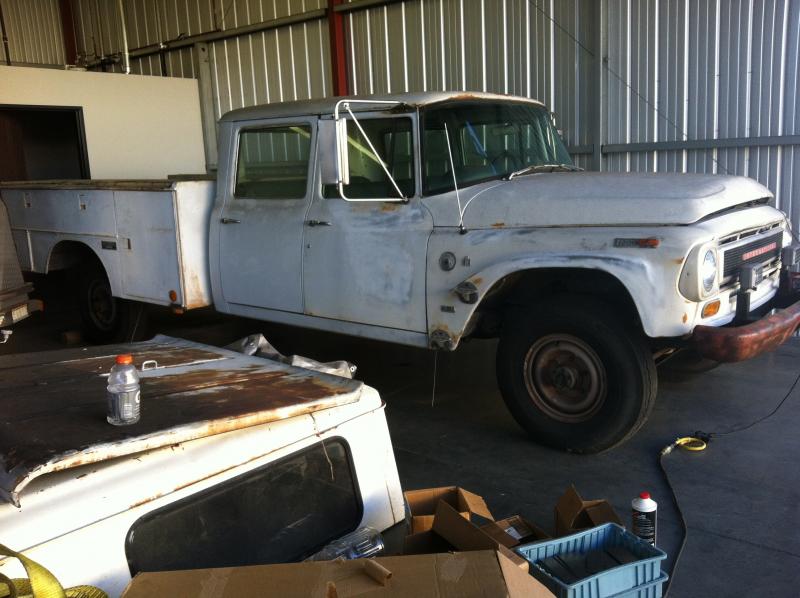

The t-ette looks way different in a good way.

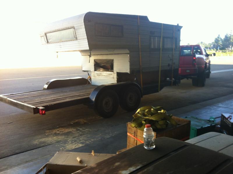

The camper made it home with me safe and smoothly, the trip went excellent and the camper did great all the way home. It didn't even move a inch lol thanks again buddy for everything and waiting for me running late as usaul:frown2: I am super excited to have it and start fixing up the little things in it. Its plenty big enough for me and my girlfriend:thumbsup: it would of been funny to video us standing around thinking uhhhh hows it going to fit on any thing lol but we got it:thumbsup:. Today after work cleaning begins:wink5:
I'm happy you wanted and were willing to come get it... Hope it is what you needed and can get it acceptably mounted on your IH.

I snapped a photo as you pulled away.

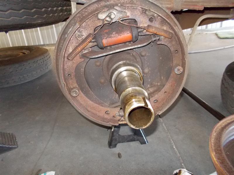

I tore in to t-ette's brakes, master cylinder was done and leaking so I got a kit and went about rebuilding it. A bit of pitting so I might need a new one if it still leaks.

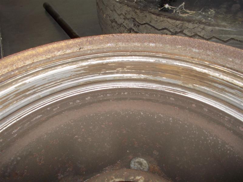

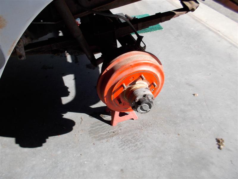

Pulled the wheels and drums (impact tool to loosen the 3 retainer screws on the drums. The brake shoes and cylinders are great no leakages evident. Drums measure a bit under 12" so they are good...
I like the orange drums. The last owner liked to paint things bright colors.

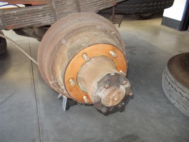

The rears are a different story. :( some one ran them to the rivets and the grooves are ground super deep and I'll need to source drums. Think I found a possible limited source (Ismail brother) but he needs to remove a few and check condition. I think he'll come through. Wheel cylinders are toast too. Have all of the parts I need on the way so hope to make progress this weekend..

If you need drum repair I can get it done for you, but shipping those suckers would be a bear! I hate finding neglect off service like that:sad: great picture by the way.:icon_cool:
Thanks for the offer king
I'm not sure I could trust a redo of the braking surface. I can see how one might go about replacing the missing metal but I don't se a commercially offered service to do it.. To me that means it is not super safe..
I think I have a source for used ones. Beyond that I also think I have a way to create new drums that will work.. Basically use a common and available drum and modify/finesse it to fit the IH application.. I'll see after I get my rig back on the road.

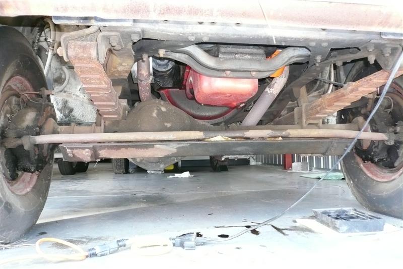

Two weekends ago I r&r'd the clutch master and bled it. Yanked the other rear drum. Took measurements on the 3 flex brake hoses (ends and lengths). Found that the hard lines on the rear axle were toast.
Wiped off the rear axle tag..... Read 4.89 gears. Glad it's a od five speed. I'll be installing 285/75/16 tires on it, which should help along with 16x8 alloy wheels. Haven't decided what style wheel, but I'll pick one soon.
Last weekend I drove the Scout to g&j aircraft in ontario to have the lines made along with replacement hard lines for the rear. Got home and found the fuel pump on the Scout was blowing fuel out of the blow hole. :icon_xp: luckily I had a new diaphragm so 1 hour later the Scout was back on the road and I was back at the airport to work on the t-ette. Got the rear brake plumbing mounted and ready for brake assembly.
Tackling the front brake lines next weekend. Not looking forward to being a contortionist getting to the frame end of the hoses. Should be able to get the front brakes and wheel cylinders rebuilt and back together...
Finished the rear brake lines and got the backing plates and small parts cleaned up... Wheel cylinders mounted and plumbed.

Got the front flex brake lines in, removed and fully inspect the front brakes, painted the orange away (fade to black).
Had the rear drums turned to the max. Surprisingly they had .050" left to take them to the limit of 12.09. We went a tad further 12.10. They cleaned up ok with only the deep rivet grooves still visible.
Went to clean the rear bearings and found that they were toast. Ordered them... Not cheap
