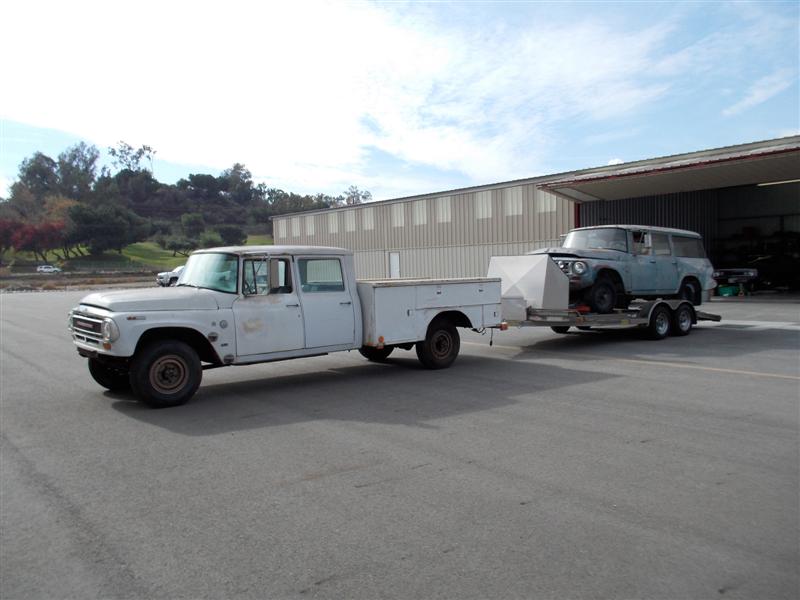

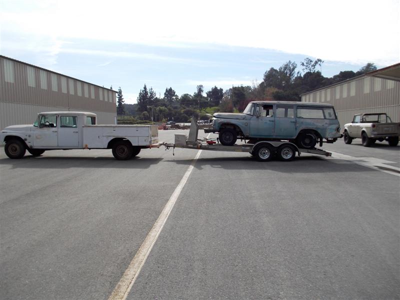

The t-ette is now my tow rig so I thought these photos were appropriate. Kinda a familly reunion of sorts.
I drove the package around a bit and I'll say the low 1st gear is nice on the t34.

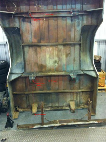

My new (to me) bed for my 1200c travelette was delivered last weekend. Now to recreate the mounting locations.
The middle front and middle rear appear to be where they should be. The front is a bit confusing. I measured some hole locations and the front bed pad needs to go almost exactly where the rear cab mount is..
The rear two (rear most not in photo) sit on the frame rail while the front two sit on brackets that sit just outboard of the frame rails.
I would like to see if any members with a travelette bonus load bed truck could take a few good pictures of the front bed/frame mounts. Only a 2 wheel drive could be bought with the long bed while the 4x4 was only available with the short bed. I presume the front short bed mount would be the same as the long bed so any photos would be appreciated.
A long bed standard cab would be good too from a mount location stand point.
Here is a photo or two of my bed. It's an 8 footer not 8 1/2. Mount width measurments added for ease of explaining the whole scoop. Also it's sitting front end down. Picture = 1000 words.

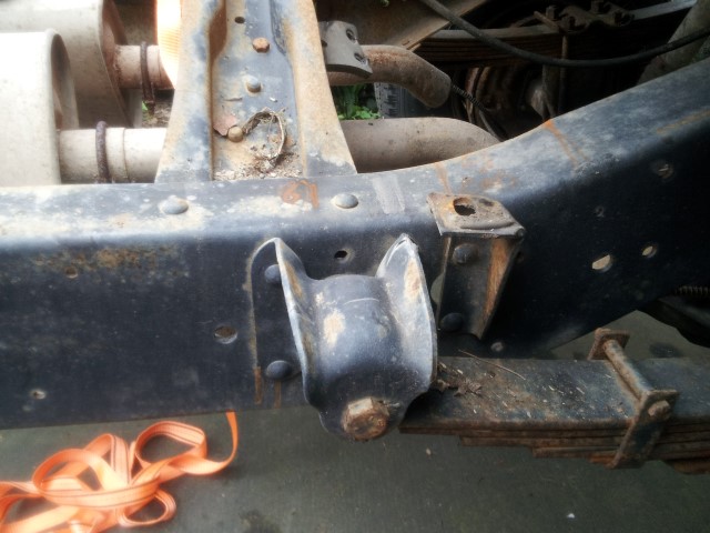

[/quote ]
would pictures of the bed mountings of a 62 travelette short bed be of any help ? if so, I could post a few pictures of the way my bed is attached . location measurements will be different, but the construction of the mounting brackets look the same on your bed and mine .
steve
Thanks guys for your help.
I have been given the photos that I needed.
I need the frame frame brackets. One in each side just behind the rear cab mount. Anf body have a pair or have a set they are willing to remove? I'll pay a reasonable price for a clean set.
Sounds like you have pictures but here is another. If you can't find them they are very easy to make out of angle iron and some plate:icon_up: I have a pair on my travelette chassis if you can't find any. Ryan

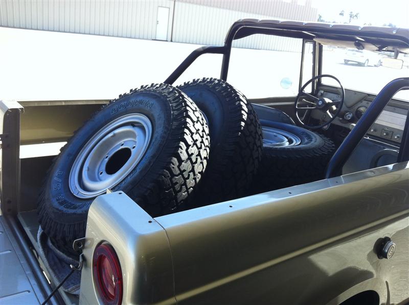

About 3 weeks ago I decided to recycle the original split rims. Just didn't want to spend the extra money buying new wheels.
Had the old tires removed, had the wheels sandblasted, primed them and shot them with paint. Black on the back, silver on the faces.
This weekend I went over to tucker tire and had new tires mounted. They use a remote service for the split rims. 100% hand deal.
Then balanced them. The tires are 255-85-16lt d load range.. 33.2 diameter.. Fit ok on the 5.5" rims..
Wow does the travelette drive nice now. I'm actually impressed by it's highway manors. 65 mph is 2600 70 is 2800. Good enough for me.
Found a nice set of oem hub caps which are on the way.
Looking great! Now to see them mounted on the t-all.
I have decided that when it is time to get new rubber for my t-all that I am going to be getting the exact same cooper tire.
I think your idea for paint--black on the inside and silver on the outside is a great idea. I just might have to copy your idea on my t-all.
The only caution is that when you paint split rims you don't want to get too much paint on the lock rings or lock ring channel or it will make the lock rings difficult to seat.
the only caution is that when you paint split rims you don't want to get too much paint on the lock rings or lock ring channel or it will make the lock rings difficult to seat.
Yup, masked the tung and groove after the light application of an etching primer.
