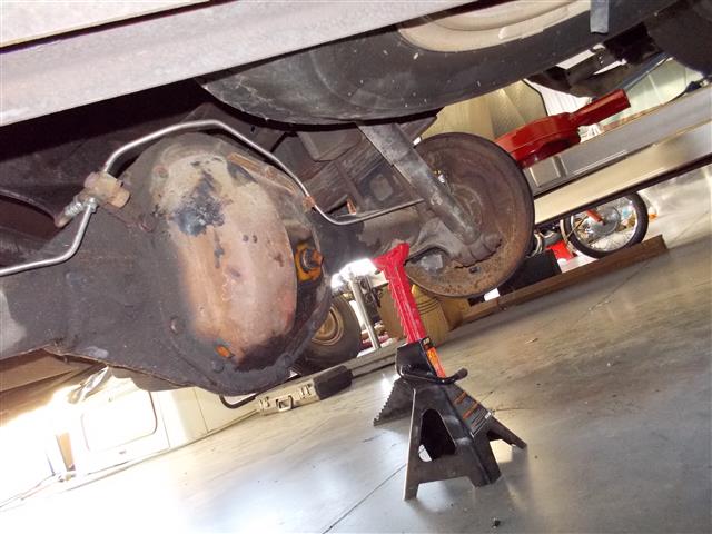

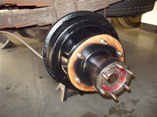

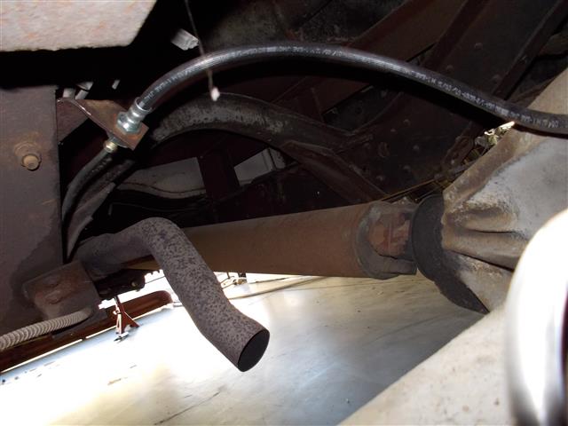

Got the new rear hub bearing races installed. Greased and installed the new roller bearings.
Hung the rear brakes along with a new spring kit.
Installed the rear drums set the bearing preload.
Bled the entire brake system.
Adjusted the brakes.
Fired it up and drove it to the local gas station and filled up one tank. I drove it around for about 15 minutes. Ran flawlessly. I'm super happy. Has fairly good power too.
I need to readjust the brakes and will probably re-bleed the brakes....
Other than installing the new correct bed and replacing the universal joints, replacing the belts and coolant and fixing a bug in the headlights it's a driver for a while.
Oh and I need a rear window, and along with that the front has a bit of fogging at the bottom so I May find a good replacement
I'll take some more Saturday when I go back to detail the job and look into the headlight deal.

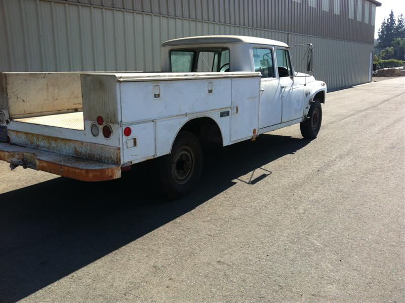

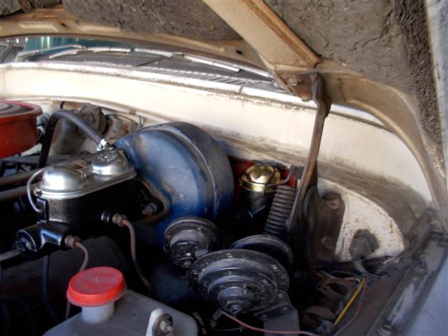

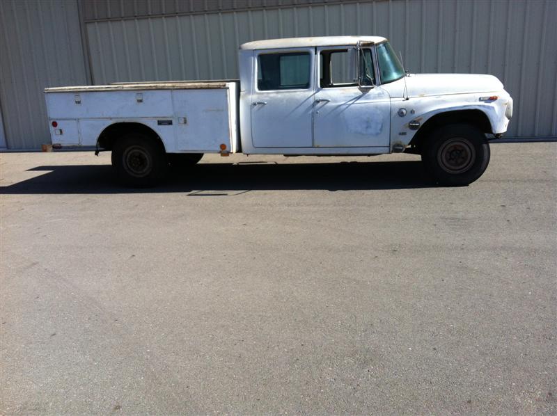

Till then here is what I have..
Ya, it has the optional load pack and aux. Spring.
Got the old girl out and put about 20 miles on her. Ran well. Developed an ignition miss at the end. The points look like the materhorn on one side. I knew about that when I got it so I bought a set of nos points and a nos condensor. Those go in today..
I also think I did not get all of the air otu ofthe clutch system after the drive and sitting while I greased it, the clutch would not fully disengage. Checked the master and the level had risen. I attributed that to the trapped air getting hot and expanding, pushing the fluid back to the master. I bled it a bunch more with my one man beeder and that seemed to fix that.
Chased the headlight nonop condition to the high/low beam switch. It was totally open in all positions. Took it apart and other than oxidation on the contacts it was perfect. So I cleaned it up and, walla we have headlights.

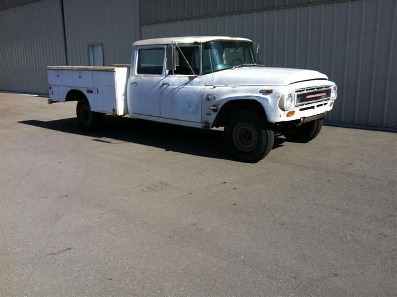

Her are a couple of photos of the beast and a couple ov videos of tooling around the airport and a drive out on the road. You can hear the thumping of the tire flat spots. Also me discovering the begining of the clutch problem. May even hear a few choice comments from the driver... :bag
1968 International travelette tooling around brackett airport
1968 travelette driving around

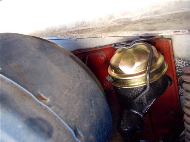

My plan on Saturday was to go fix the advance blockage issue. I get in the t-ette to swap it around ( back it in), start it and the clutch would not release. Fooky!! It never worked perfectly even after bleeding it to death but it worked.. So I roll under the trans and remove the inspection cover on the bottom of the bell housing and see the problem immediately. Some how the through out bearing collar had rotated and the actuator fork was out of it's grooves. After much fretting over the fix I figured that some one had disassembled the slave linkage and allowed the fork to swing back far enough for the collar to disengage. It must have turned and they put the slave back in. Amazing it worked at all. My fear initially was that the collar May have come out of place some time when the transmission was pulled and it would have to come out again..:mad5: luckily that was not the case. I was able to remove the slave cylinder and swing the fork back and re-engage the fork and collar... I installed a new slave, because I had it, bled it, and now it is perfect.. :winky:

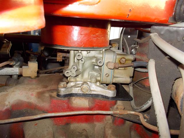

on to the carb. It turns out the throttle body was not drilled just above the butterfly as it should be with a timed spark advance system. Got lucky again. I took the other 2300 apart, removing the throttle body from it that was drilled and swapped it on to the 2300 I had just removed. Should be ok now. Will need to wait until the new advance actuator comes in.. More fun for a post turkey day weekend
