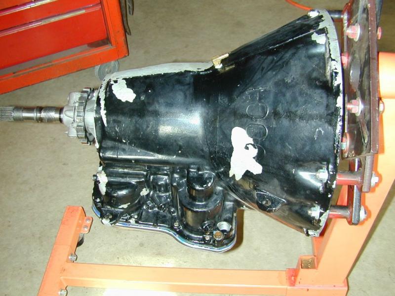

Installing the output side of a Scout II 727 into any chrysler (or amc) bellhousing is certainly doable without really any trouble. I've done several of these and have two more on the books for folks around here right now.
Assuming you have a true '78 cordoba 727 and it is not a "lock-up torque converter" version (iirc, the lock-up shitpiles were only used in the lighter weight chrysler corp. Econoboxes), then the swap is routine and should always be accompanied by a complete freshening of the wear and tear parts internally.
If you have read through this thread:
http://www.forums.IHPartsAmerica.co...t-407-tf727-variations-parts-differences.html
Then you see there are some things you must be aware of parts-wise regarding combining "early" and "late" transmission innards. In your case, in order to convert the cordoba transmission output segment to mate with a married d20, you must use the planetary set that is matched to the donor Scout II output shaft spline. There is a significant dimensional difference in the spline and if you don't correctly match the parts the planetary carrier and output shaft will fail. You could use the Scout II output shaft system from any 4x4 Scout II 727 as long as you use the entire planetary setup that is attached to the donor shaft as found (including the thrust washer found on the very nose of the donor planetary set". So the best way to do this is to have a complete sii donor unit in pieces, with all "pieces" coming from the same donor! That make sense??
In addition to the output shaft and it's mated planetary set, you will also need the intermediate/tailhousing for the Scout II along with the bull gear, bull gear distance piece/nut/washer, the "special" bearing behind the bull gear and the two seals.
The bull gear needed for the d20 is also used only on the Scout II 727 and it's pitch angle must match the intermediate gear in the d20. We've discussed that several times in other threads and posted part numbers to match up.
In our current inventory we do have at least two complete "used" conversion sets of Scout II output parts, one has a usable bearing, the other one needs a replacement bearing which we have custom manufactured exclusively for ihon and is not some rinky-dink crap chinee bearing with a piece of exhaust tubing shoved inside. These parts came from serviceable transmissions that I have converted to fullsize app units for a 2x4 or 4x4 which use a divorced transfer case.
So....this conversion is certainly fairly straightforward, the biggest issue is using a fully matched set of parts! This pic shows a converted very early (not pushbutton though) 727 that resides in major screwup's Scout traveler "mobinder" which is a real show piece under the hood and is twisted by a 383. It did get a paint job before it left the shop though!
The tranny in "pink" will be going into her third season of mud racing in the spring of 2011. That trans is a also a converted chrysler unit and has been through hell including dumping it's guts into the catch can on at least one occasion. But the pan has yet to come down for any work, though it is slated to receive a full manual valve body this winter since ihon is now on board as a sponsor for maranda and monte's ride, along with binder university. She's also gittin' a lightly warmed fresh 440 at the same time but the current trans is way more than beefy enuff to handle it:
