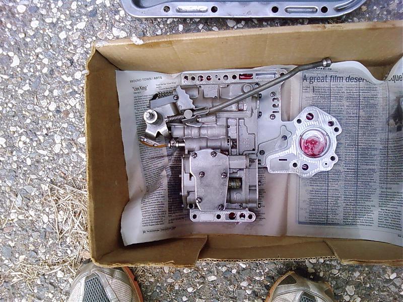

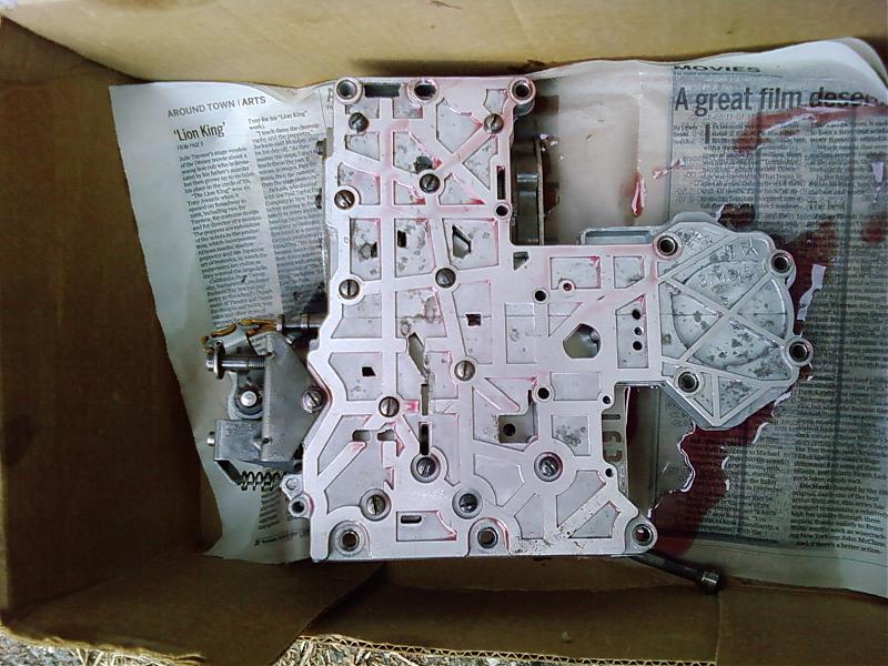

Didn't see this question (well, questions) addressed directly after a lot of reading, unless I missed it somewhere, so here goes...
I'm swapping a 345 for my tired 304 and figured since I was pulling things apart, I'd relocate the vent in the otherwise well-working, non-leaking 727 tranny too (excellent write up Mike!). The only issue I've had with this tranny is that it is sluggish to get going when cold. I figured it just needs a band adjustment (?)
anyway, while steam cleaning it, I had it right side up on a cart, I lifted the tail to get under it and fluid came rushing out the front shaft. I neglected to drain this puppy when I pulled it, but figured I could do that after I tidied it up a bit, so no big deal. Anyway, the oil is coming out the space between the oil seal and the shaft. Normal?
I later drained it and flipped it upside down on the stand to get better access to the pan etc. And it is now leaking a slow drip from the same area. Being a tranmission newb, I'm guessing that this is normal and is just where the torque converted usually rides?? Nothing to worry about? Haven't checked the end play yet if that makes any difference (though just a little wiggle by hand shows a little side-to-side play and very little in-and-out).
Secondly, in the vent write up, you seem to imply that the o-ring for the pump can be re-used (or maybe you were referring to damage to the o-ring on a previous installation attempt?). Cts says replace and that's my general rule of thumb, so I think I'll go that route unless you say otherwise. Ought be replacing some seals anyway, I suppose, while it's out. (oh, and methinks that 727 book you mention will come in handy too).
Lastly, (and dummy me forgot to take a picture - I'll learn) when I dropped the pan, there was some particulate matter in there, centered under the filter, just where it should be. Some fine sand-like organic and some metallic about the same size or slightly larger, but still sand-like. I'm assuming that this is fairly normal sluff? Oil was a little dark, but smelled good and had no water.
Thanks in advance.
The torque converter snout establishes the seal for the pump and input shaft. Without the tc in place, any oil inside will run right out if stood on end. Same thing if you turn it over on it's back with oil in it and the tc in place, oil will run out the vent located at the top of the pump housing externally (along with the dipstick hole/tube).
Anytime I remove a torque converter for any reason, the front seal gets replaced. And the pump bushing should be replaced also, that is standard practice and can be done from the outside without removing the pump from the case.
I never re-use any rubber component unless it's a dire emergency. But you'll not find individual rubber components anywhere unless some tranny shop has leftover stuff from soft parts kits. Seals are available individually.
Particulate in the pan is perfectly normal. It gathers there right below the "suction" point of the filter and drops out when the tranny is shut down. The surface area of all the friction materials is rather large in these units, so a considerable amount of debris can accumulate over time which does not indicate the frictions are worn out. That is exactly why the bands are adjustable (but not the clutches).
