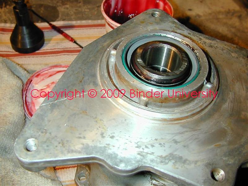

Here's a pic of the first seal going into the transfer case adapter. I know you are dealing with the output shaft sticking out so it's more tedious!
So the first seal goes in with the lip pointing towards the liquid side, just like you would install any other side to retain liquid/grease/etc. Drive through from the bull gear side, don't sweat rubbing the peripheral coating off, that don't matter!
Tap it in until the case of the seal just clears the vent hole...don't go too far!
Definitely use some type of driver, the one in the pic is a flywheel puller for a bevel gear-drive ohc ducati single motorcycle engine, circa mid-70's!

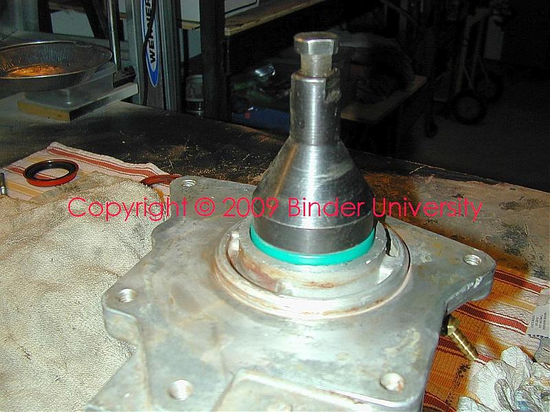

The second seal goes in upside down!
Drive it in until the case edge is flush with the bore chamfer. That will create the dead air space between the two seals that the breather hole "breathes" through!
Then lube the spacer with atf and insert carefully without tearing the seal lips, install the bull gear, and tighten the hell outta the nut and use loctite on the threads!
This pic shows the "upside down" seal driven in flush and the spacer re-installed.
