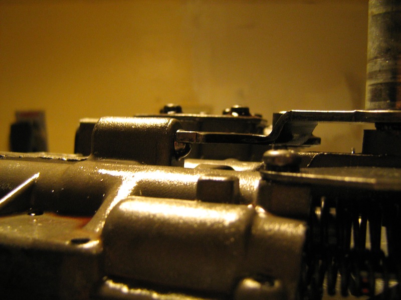

Looks like the washer under the e-clip at the end of the
throttle position shaft was too thin. That let the selector
shaft ride up, so the lever could slip out of the spool. A
thicker washer will be a decent fix. New seals, of course.

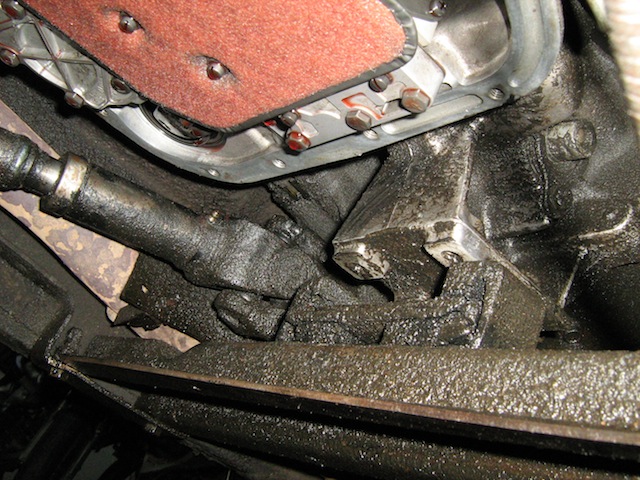

The "missing" z bracket has me very confused. From the
trans side of the crossmember it really looks like something
fell off, but on the transfer case side there is clearly a z bracket
installed. Here's the front side, is something missing?
With my profound thanks.
Bob prohaska
I haven't looked at the IH 727 mount in vehicle (lots of mopars and jeeps), but it looks to me like the bolts have fallen out and the mount is just moving around. The spring softens the shifts and many repair shops leave them out for a solider engagement.
Hi Jeff,
I spoke with the folks at IHPA, who told me that only
one z bracket is used and mine happens to be behind
the crossmember. It sure looks like something fell off
recently, but I guess not.

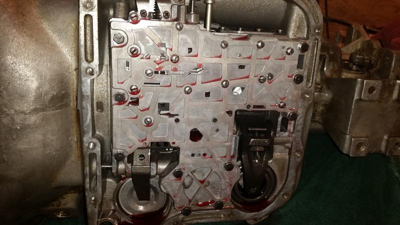

Hello fellow IH'ers, I have been gone awhile my 74 sii has been running so well I have not had to work on it for a while. Well as with all IH's the time has come; I have a tranny leak, 99% sure it is coming from the shifter shaft. I know no big deal but I replaced it and I still have a leak. I still think it is from the shifter shaft but the shaft must be worn or has a nick in it.
So my thoughts are to replace the shaft with one out of my spare 727. But having never had the vb out my question is what bolts do I have to take out? I thinking the hex head bolts are the one holding the vb in. What do I need to worry about? Springs, balls or anything else. Plus can I remove the shifter shaft from the vb or should I swap the whole vb? Condition of my spare tranny is unknown, it should be in good shape but it has been sitting for a few years.
Any advice would be appreciated!
Thanks

Yes just the hex head bolts, about 10 of them.
Now a few other things have to be removed first.
I suspect you have a manual. At least all the balls are inside the vb.
Don't forget to snap a few pics before and during
