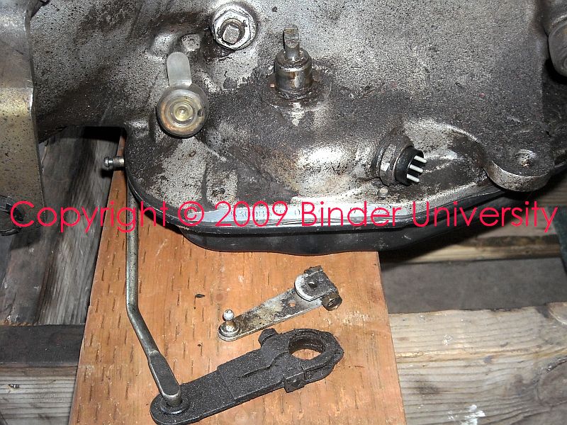

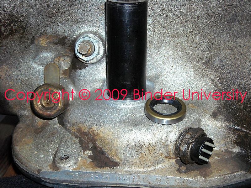

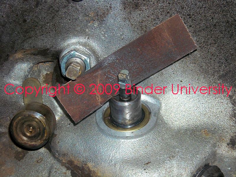

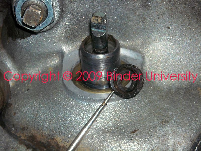

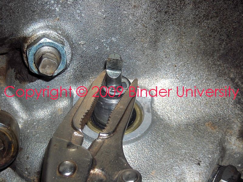

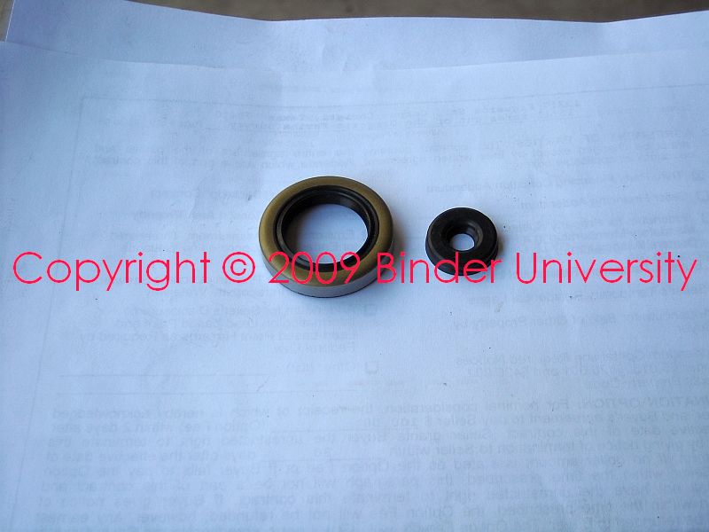

here ya see the two seals we're dealing with.
The larger item is a conventional single lip seal with a steel case.
The smaller seal is for the throttle pressure control shaft and is a single lip seal also, but closely resembles a grommet and has no case...it's flexible.
Identify the lip on each seal...the lip must point down towards the fluid reservoir when installed!

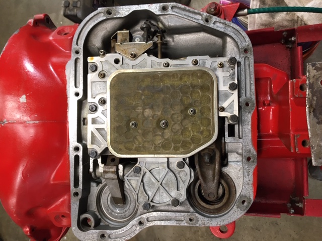

Your description and pics are very helpful. I have identified that I have a leak coming from this area. I also think my pan gasket is leaking, so plan to do both repairs. I took off the access panel on the hump to have better access, but it is really tight there too.
I read where you can access this area through the pan also. Is that true? Doesn't seem like that would help since the seals go up, not down for removal. I also don't know whether to be leery of removing parts of the transmission to get there.

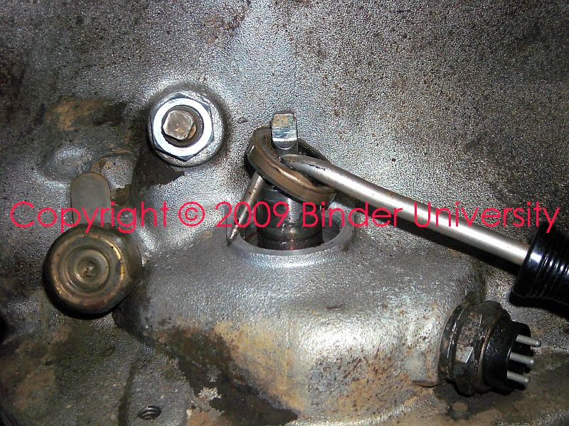

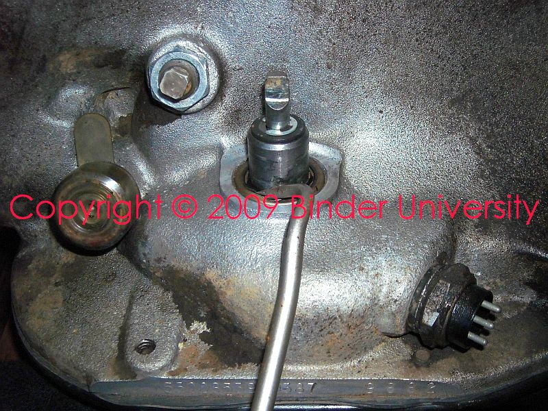

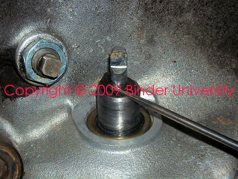

Always helps to know what the vehicle is to keep assumptions to a minimum. If it's a sii, then yes, access to the shaft seal is very restricted. If this is a fullsize pick-all, access is much more generous. It can be removed from above in an sii with an assortment of picks and hooks to jerk it out. It makes for an extremely tedious and cuss-laden endeavor. At one time, you could by a tool that was made specifically for removing these seals from above. It threaded down into the metal clad portion of the seal engaging the entire circumference. Then all you did was pull on that tool and the seal would pop right out with it. They were damn spendy for something the average person might only use once in their life, but worth every penny if still available. I think they're tough to come by these days.
Since you're planning on replacing the pan gasket too, that means the pan will be off and the fluid will be drained. Its a good time to throw on a fresh filter and verify band tension is within spec. With the pan removed, the valve body can then be removed, which would then allow you to pound the shaft seal out from below. This is much quicker and easier than trying to pry it out from above. The new seal would then get driven in from above. Now, vb removal has a few ticklish steps to it as well, so I can understand your trepidation, but having gone at this seal both ways, and having done several vb removals, its a no-brainer for me. If I have a failed seal to remove in a sii, I'm draining fluid, dropping pan and yanking vb to pop the seal out from below. But that's just me. You might try prying it out from above and land on just the right combination of picks and mini-pry tolls that you get the damn thing popped out in short order. That just hasn't been my experience.

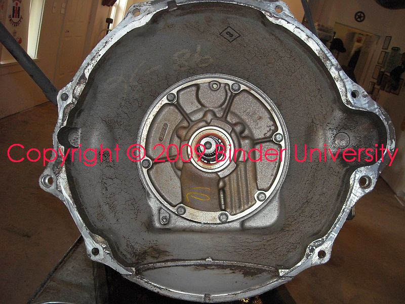

The input shaft seal has a metal body with rubber sealing lips. The pump seal is a square cut rubber o-ring. Those two seals are generally replaced as part of a comprehensive rebuild process rather than in onesy or twosey fashion for whatever reason. I suppose it might be possible to source those seals individually rather than from a rebuild kit from a supplier such as WIT (Whatever It Takes) dot com. Rubber can deteriorate over time even when stored in a climate controlled atmosphere and not exposed to UV rays. I can't tell you with any certainty one way or another whether your seals have been compromised or not. You're on your own path of discovery there. Personally, I would install the trans, fluid up and run it to see what I had, but I also wouldn't be too put out if I discovered it was leaking and I had to drop it to replace a couple seals. That may not be the place you're in. The input shaft and pump is located at the front of the case directly behind the torque converter. The input shaft seal should be removed with a seal puller and the pump has to be pulled with a slide hammer puller. You start getting into it that far, you should have a service manual at the least or the Carl Munroe A727 book as reference to guide you along.
hey there, appreciate to response. Yes I did swap out the front seal, the rear yoke seal, and the two small pressure seals on the left side of tranny. Yup, I am going to thrown it and get it running.

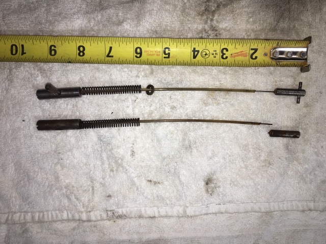

Thanks, now onto another question, maybe should be on another thread but: the below attached snapshot is of the "internal" cable of an automatic trans shifter. I have four of them. got two of them apart and one of them is broken. I guess rust won. Anyway, I was trying to figure out how to get the broken one back together. I know IHPARTS sell the entire shifter, but don't need it, just the cable inside. It's a pretty simple design, just gotta figure out how to fix.
