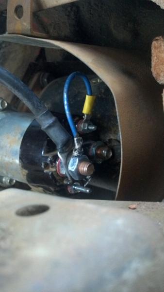

This is the new fixed set up. I started it and its running right now.

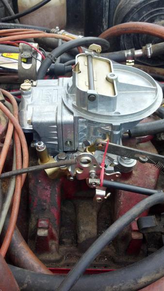

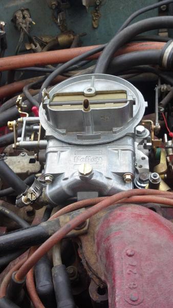

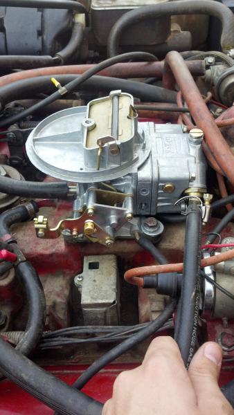

Pictures of the carb

We've got some issues here, buddy. You're carb has a manual choke, but you don't have a choke cable connected and therefore you have no way of gradually opening the choke up as the engine begins to warm. That big brass butterfly plate over the carb opening is your choke plate. It needs to be closed up like it is now when the engine is cold started, and then gradually opened to full vertical within a few minutes of running. What's happening right now is that the plate is staying closed. The cold engine wants to be choked, but as it warms it wants more air. With the plate closed, the air fuel ratio is way too Rich, which a warming engine doesn't like. I bet it spews dark smoke from the tail pipes and stinks to high heaven of Rich fuel right before it coughs, sputters and dies. I also bet that if you pull the plugs, they will all be covered in black soot and are now even more worthless than they were when new. So, add a universal choke cable to your grocery list and head on back down to the parts store. No sense in trying to run the thing any longer until we make some more adjustments.
I know what your saying about the choke needing a manual choke, I know I need that, the problem with what your saying is, that is not the issue. My father is out there working the choke as im starting it. And once I get it running, it runs. We pulled a spark plug wire, and connected it to an extra spark plug, we got spark. We then hooked it back up, we started the engine, and then it died. We pulled the same spark plug wire, connected it to the same extra spark plug, and there was no spark. Therefore it is not a carb issue, it is a spark issue.
The other thing, is it does not spitter and sputter and die. It just cuts out. Its as if I were to turn the key to the off position. It just dies, it just loses spark.
Okay. Good to know. Since I'm not there with you to hear, see, smell, taste what is happening...all I can do is point out obvious issues I see in the pics. I'm totally dependent on the information you either do or do not provide.
