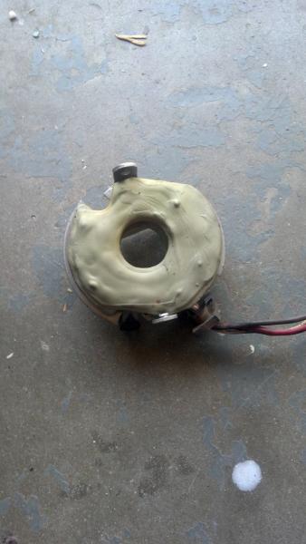

I was hoping to see either an lx 411 or an lx 412. The 412's are cheaper than the 411's. It looks like the 411's have a printed circuit board attached while the 412's do not. Can you flip yours over and post a pic of the bottom side?
Do you know where this would be printed? Posting the pic now.
No, but I think you're right in needing the more expensive of the two. That grey substance is potting material that encases the circuit board. The cheapest version of it I've seen is on rock auto
for $123 plus shipping. The other one is over a c-note more as you can see below.
rockauto parts catalog
In regards to that part, we are thinking of just ditching the prestolite. We're thinking of going with a little more power fullfilling hei dui distributer for the I.h engine. Whats your 2 cents?
