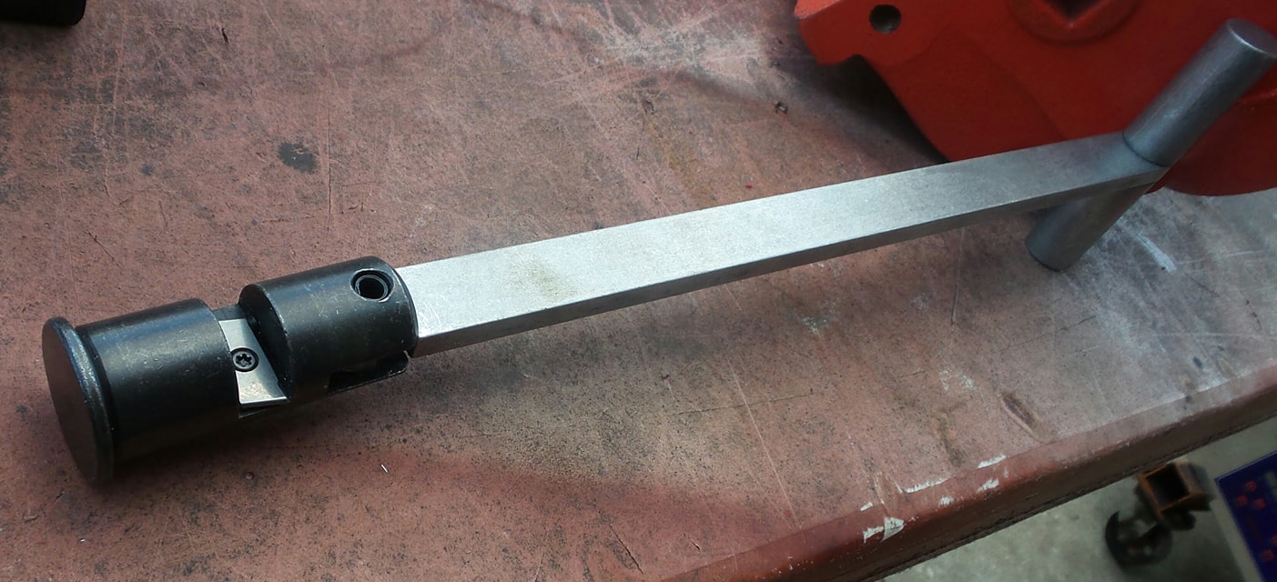

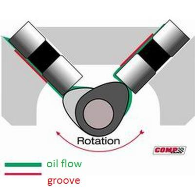

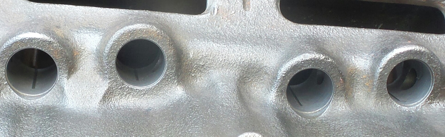

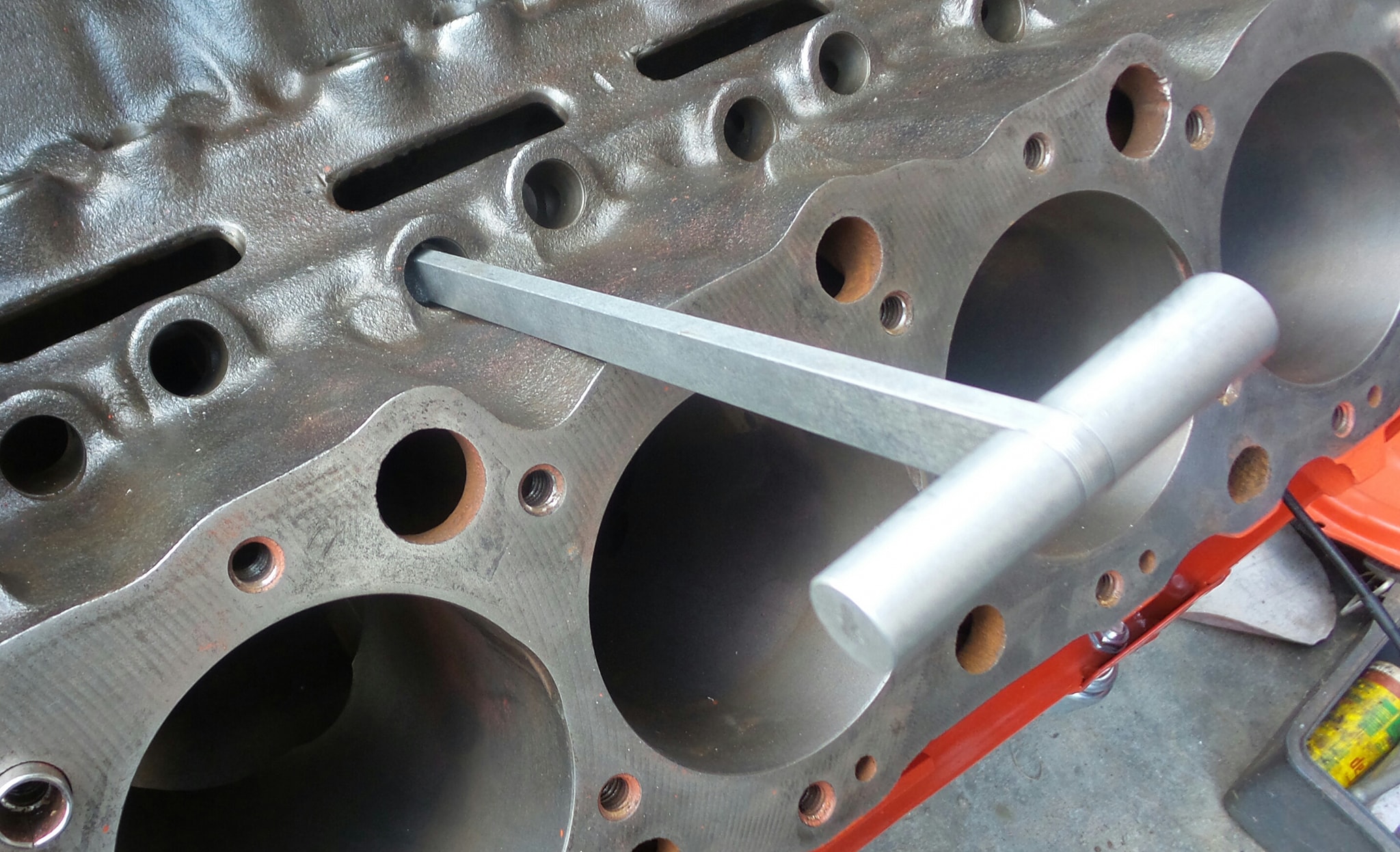

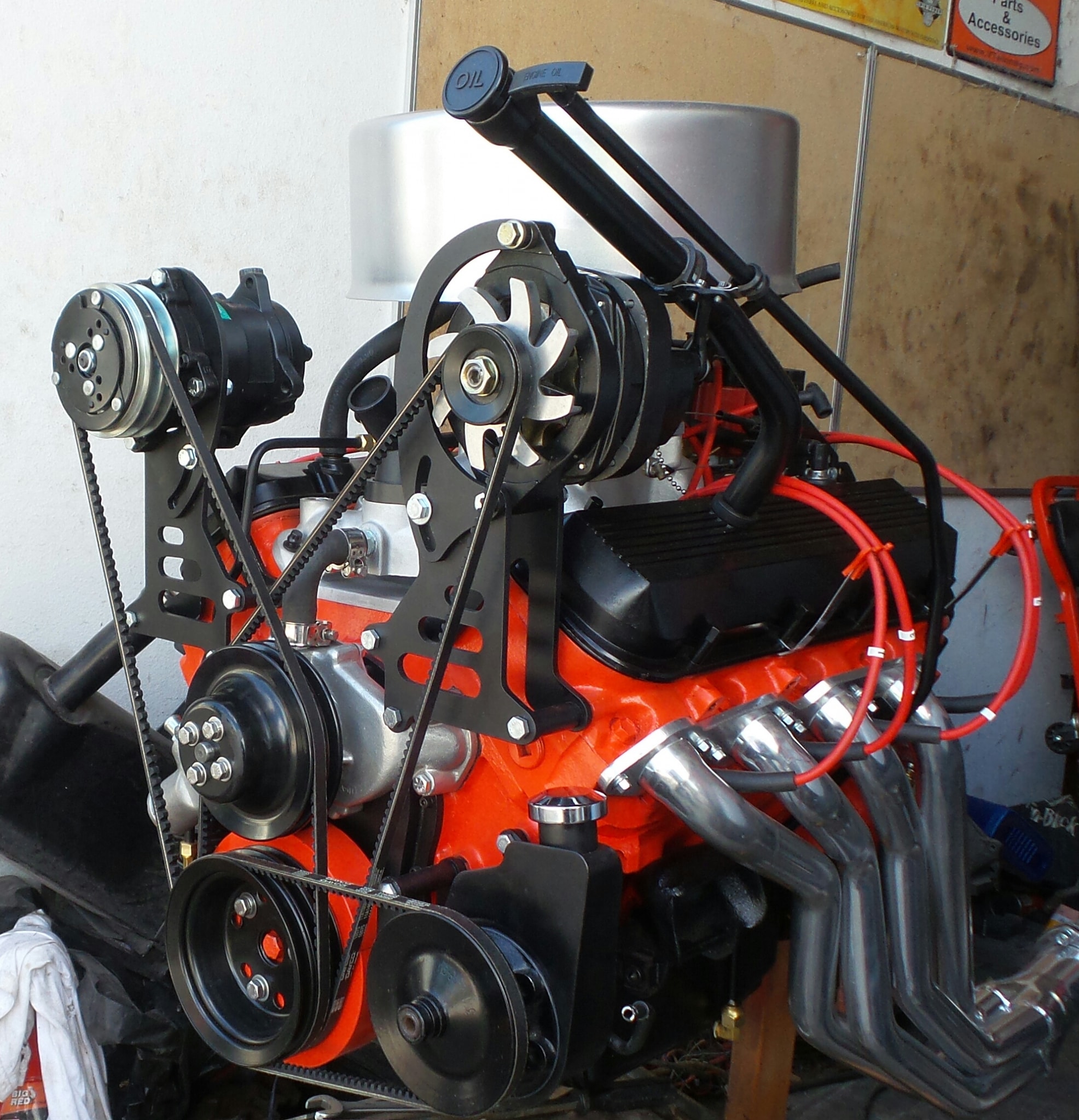

Tool came in for grooving the lifter bores ..
What this does is drops oil on the lobe right before it lifts the lifter ...
Most likely its overkill, but a good place for some overkill ..

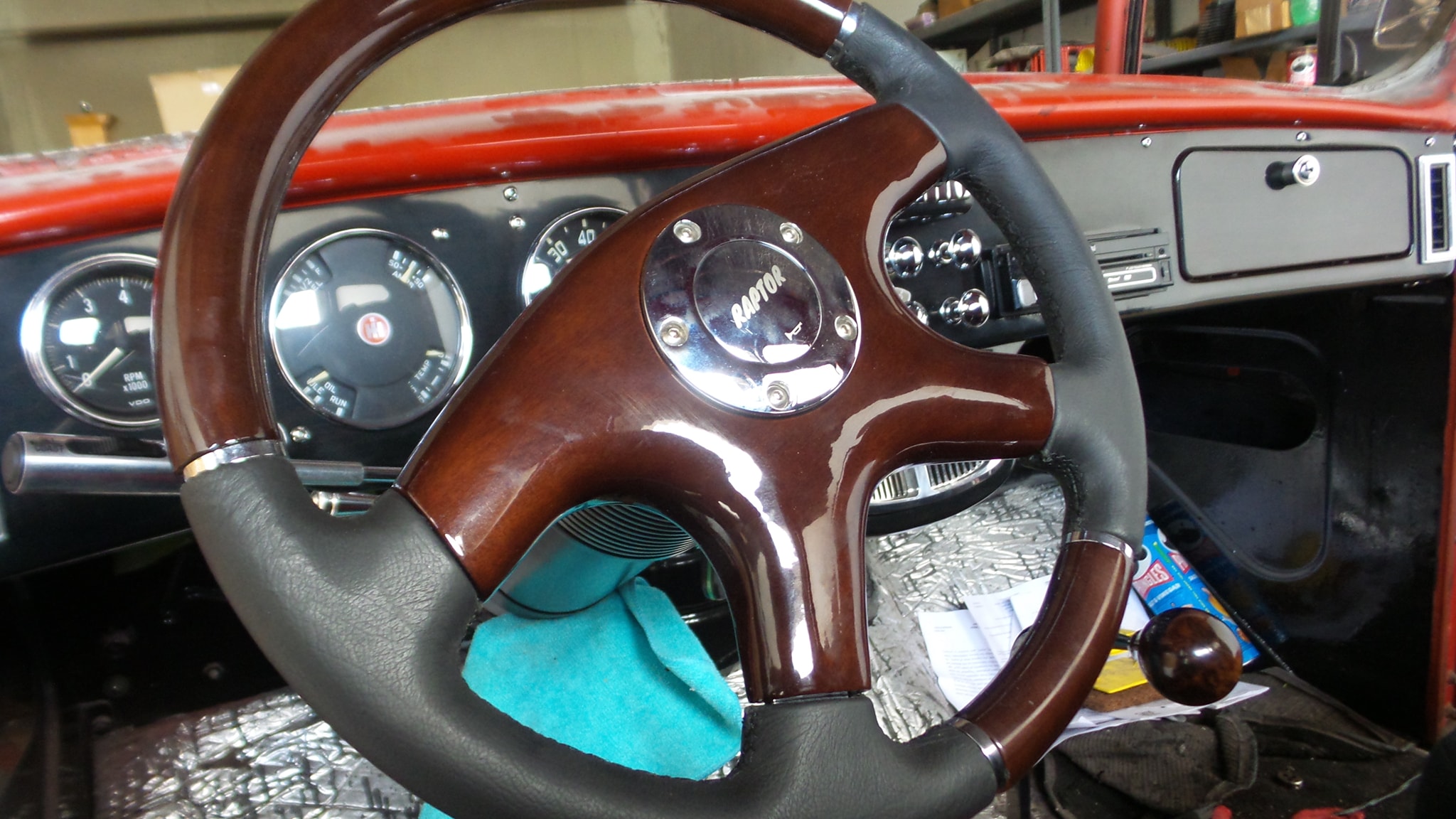

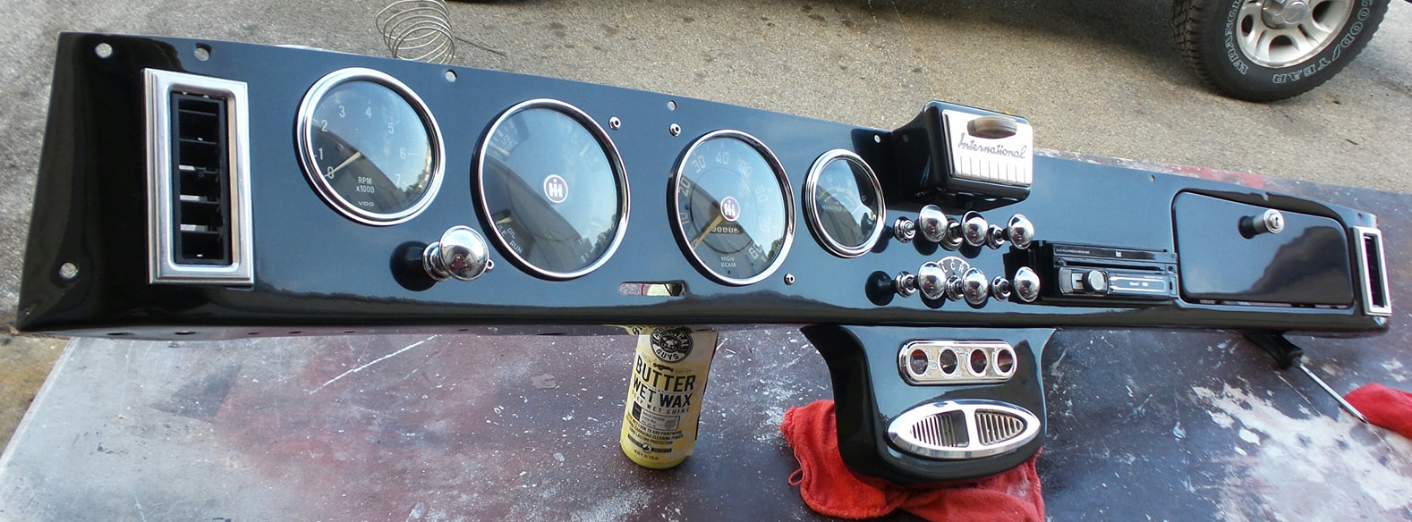

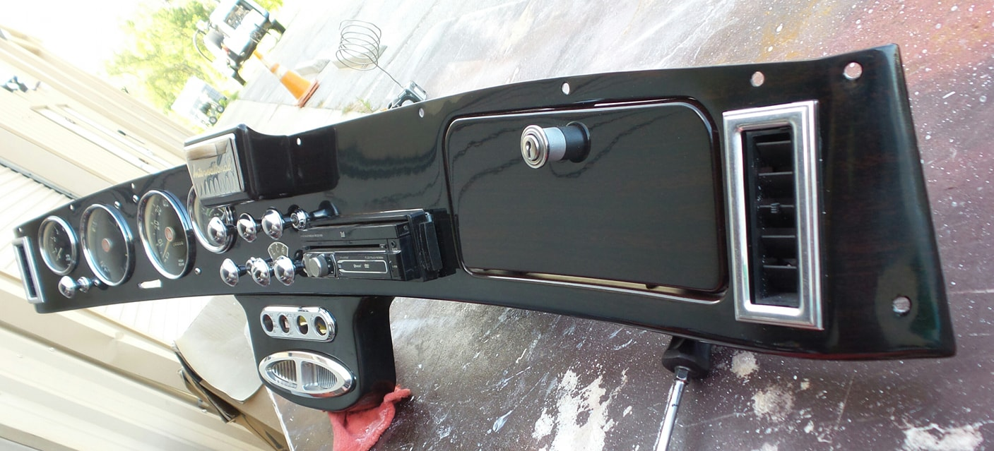

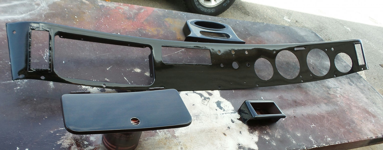

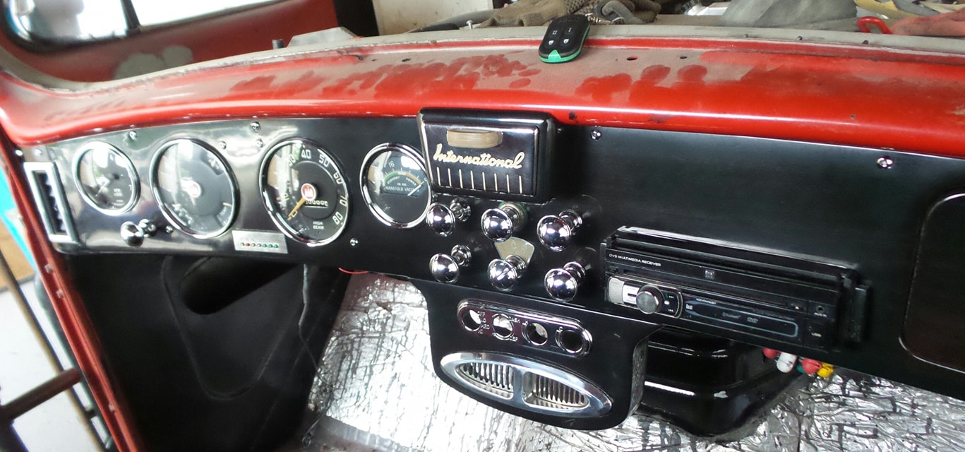

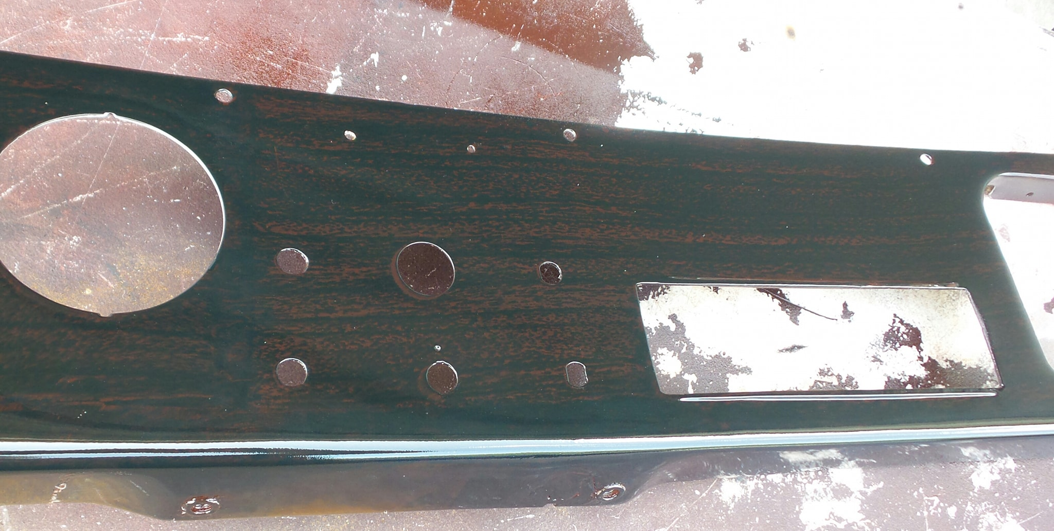

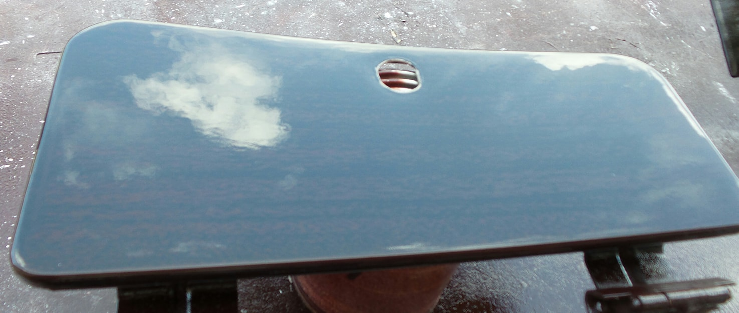

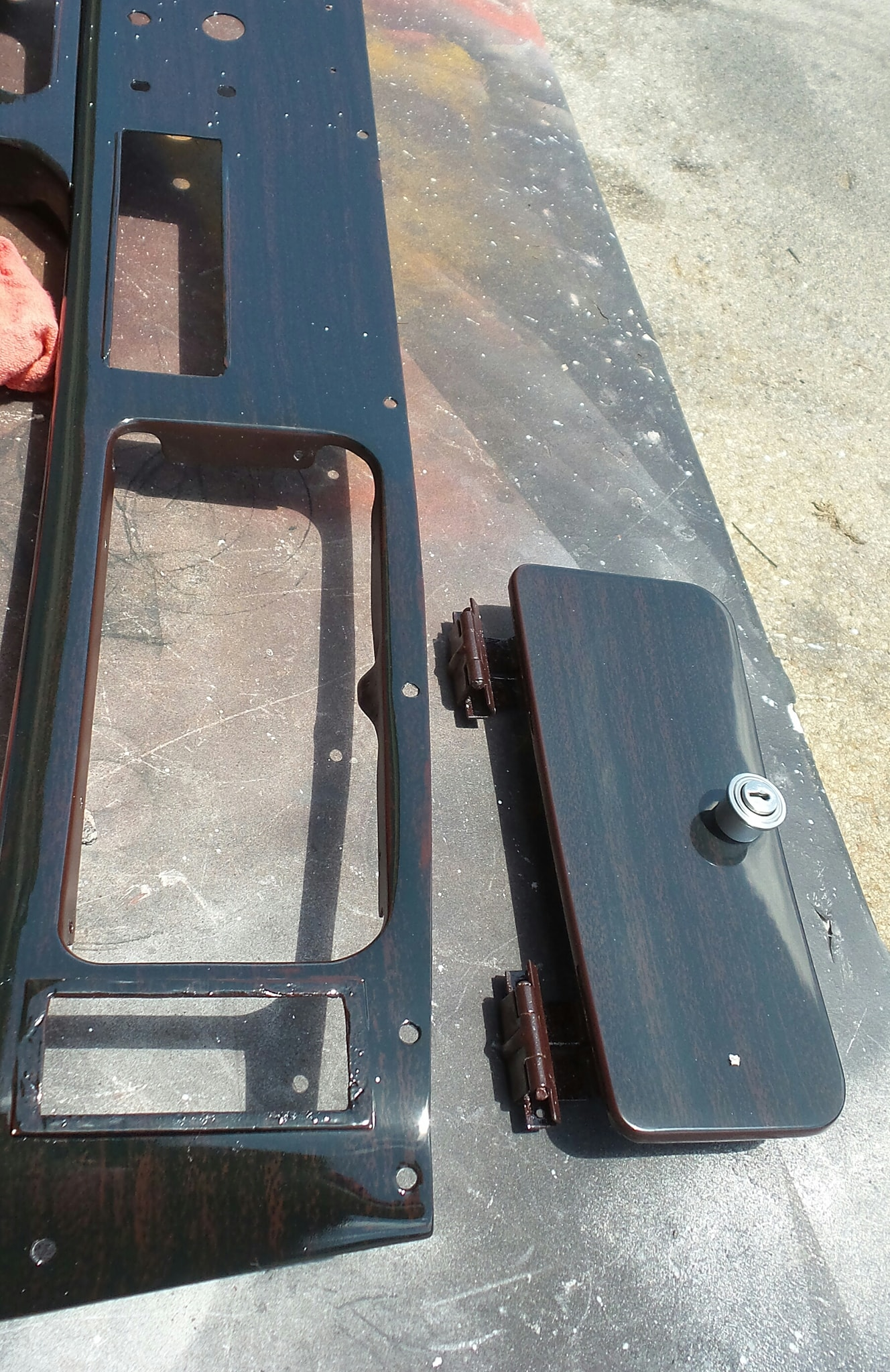

Far from a color match ..
But with the amount of work that it took to get the dash to this point, I'm going to fly with it as it is .

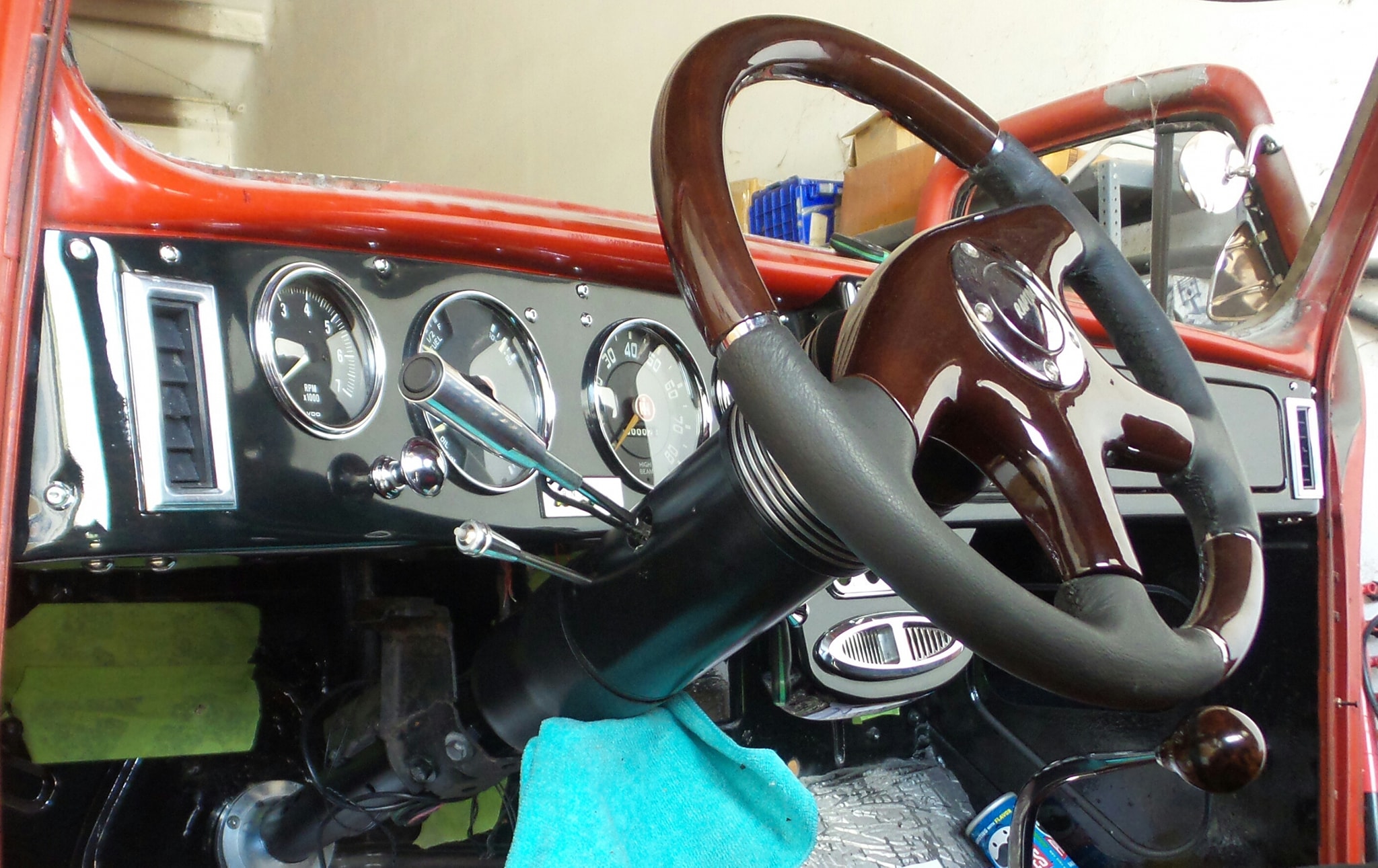

Later on in the day, going to install the dash in the truck with doing a test fit of the column ..
Since the lower column firewall mount was modified, pretty sure the upper mount will need some fine tuning ..

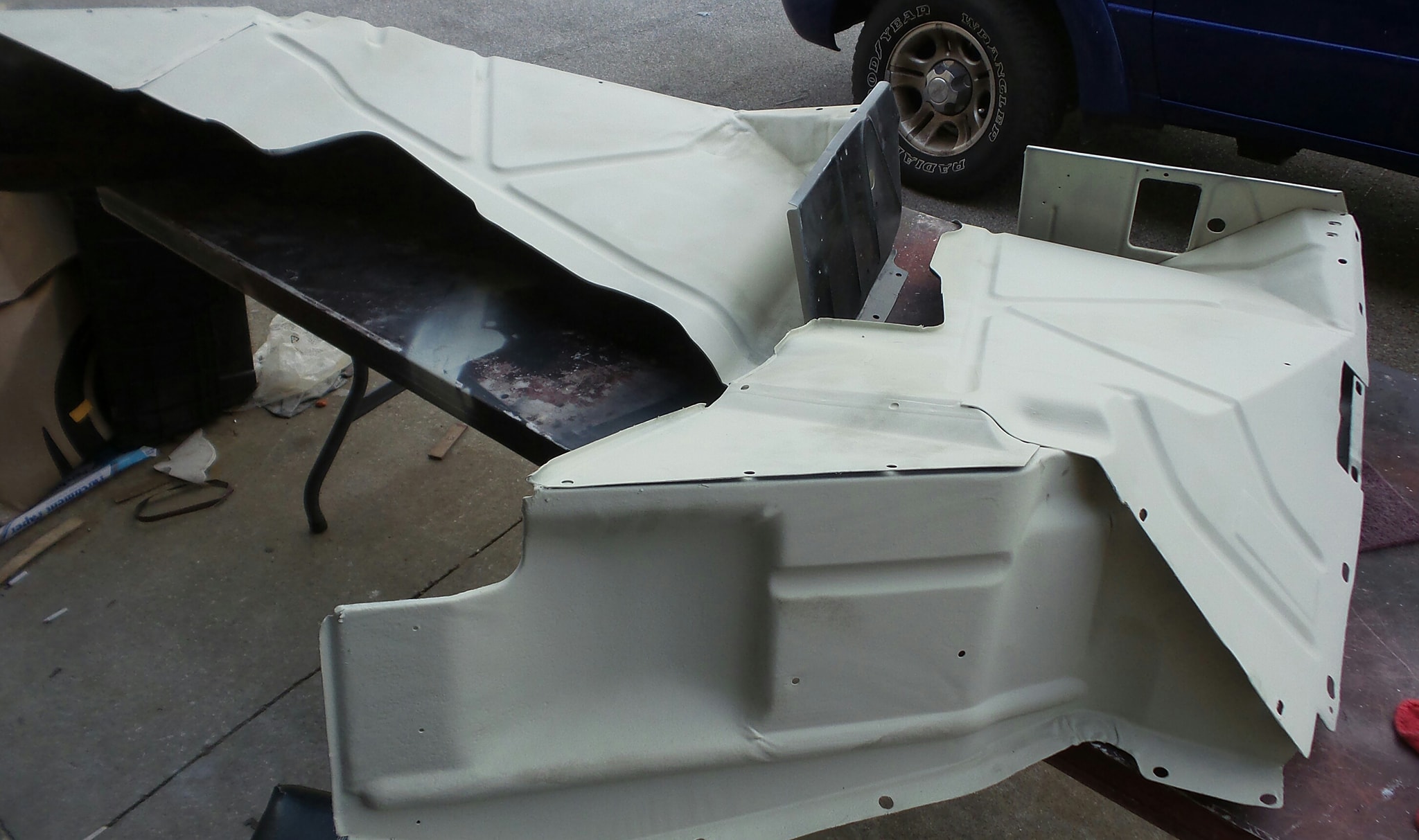

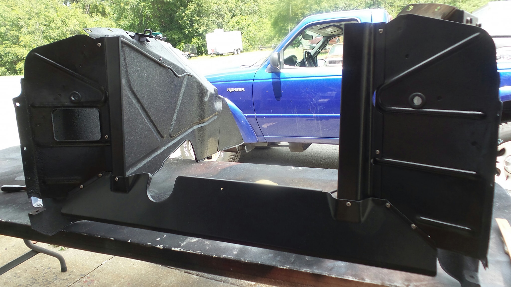

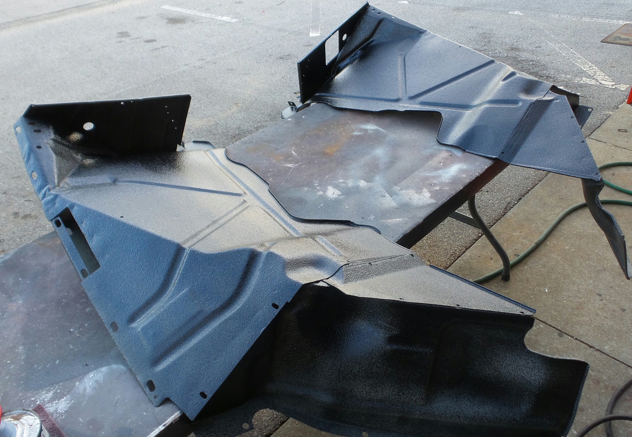

More body work ...
Welded up all unused holes and epoxy primered ..
Did the engine bay side with bed liner ..

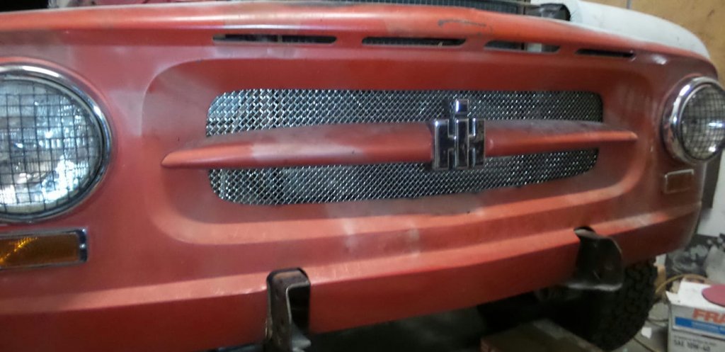

The front of the inner fenders and radiator tins seen epoxy Hot-Rod black ..
Thinking the Hot-Rod black might look better than the bed-liner looking through the T-Rex grill ..
That part of the doing is done and over, should keep the rust at bay for a long time to come ..

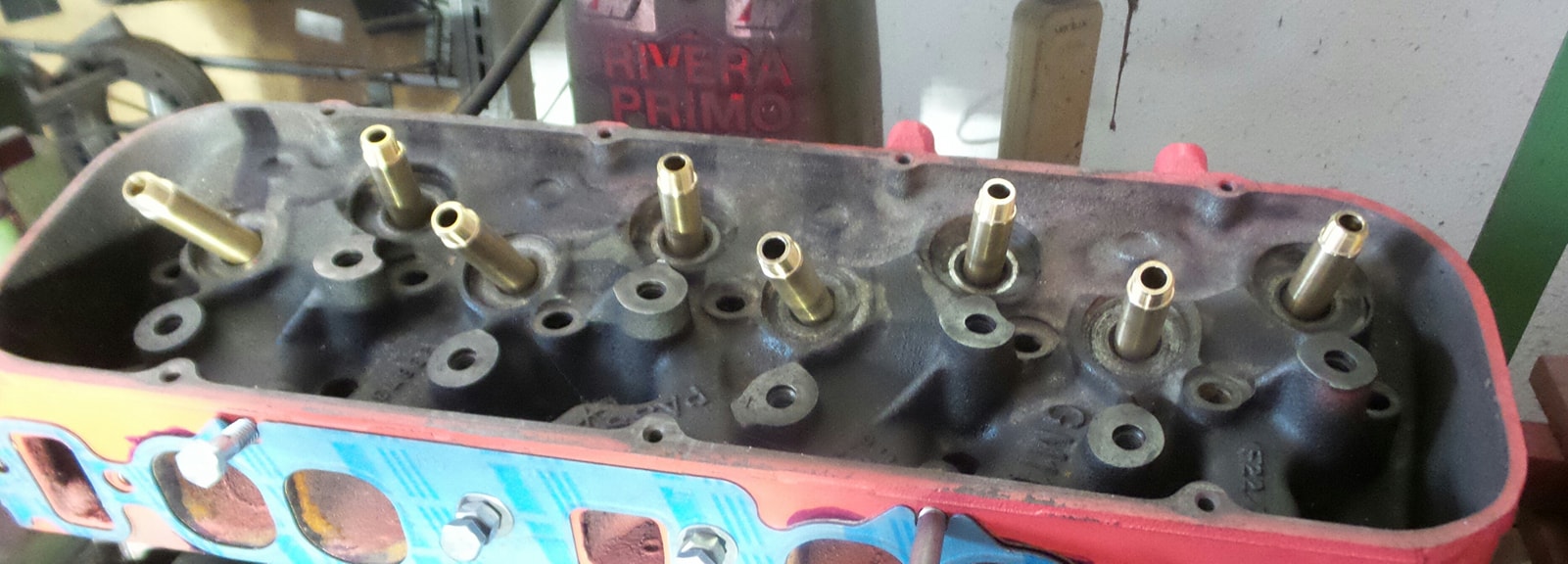

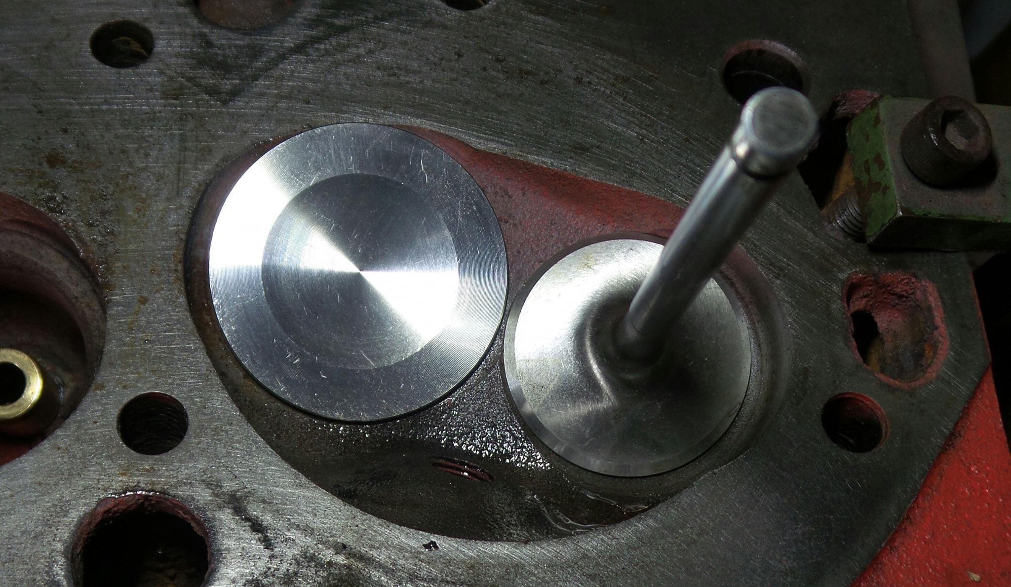

Bout that time to start in on building the heads ...

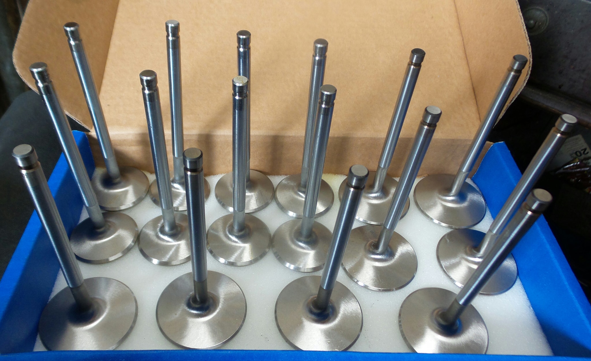

Oversize valves might net a few more ponies ..
Intakes are 2.250", exhaust are 1.880" with 11/32" stems ...

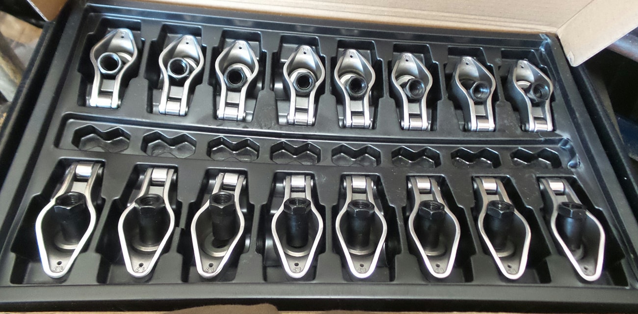

Been slow buying up the needed parts ..
Did nail down a set of semi roller rocker arms ..
Guides, springs, retainers/locks and seals are on the yet to get list ...

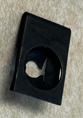

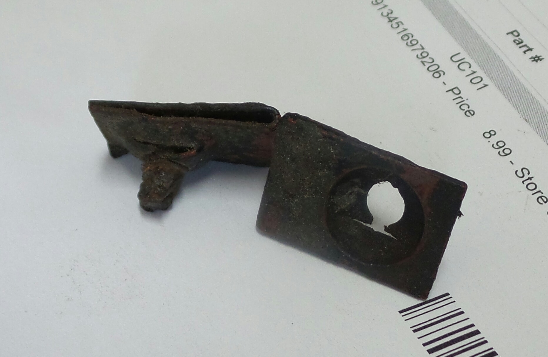

Was needing some body clips for the inner fenders ... IH had their own gig going on in that department ..
What came off the truck wasn't in the best of shape ...
71 years took it's toll on the critters ...
Called a bunch of companies with no luck finding these Bad-Boys, until ...
NOS are on the way ..
That was a stroke of luck finding 70 year old, new shi .. errr .. stuff !!

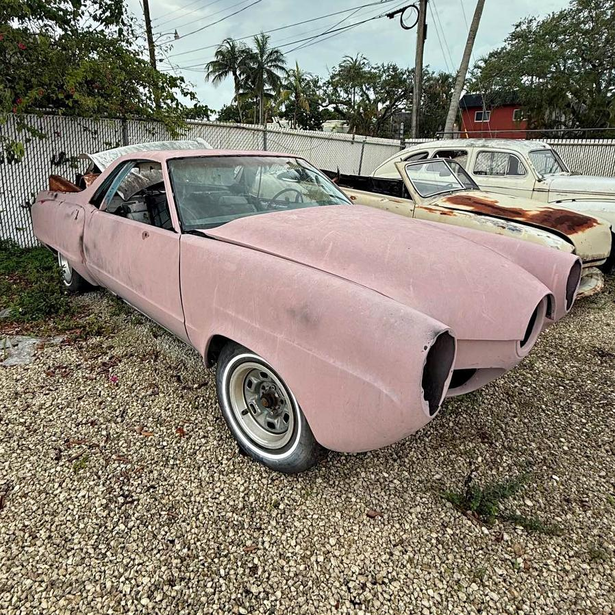

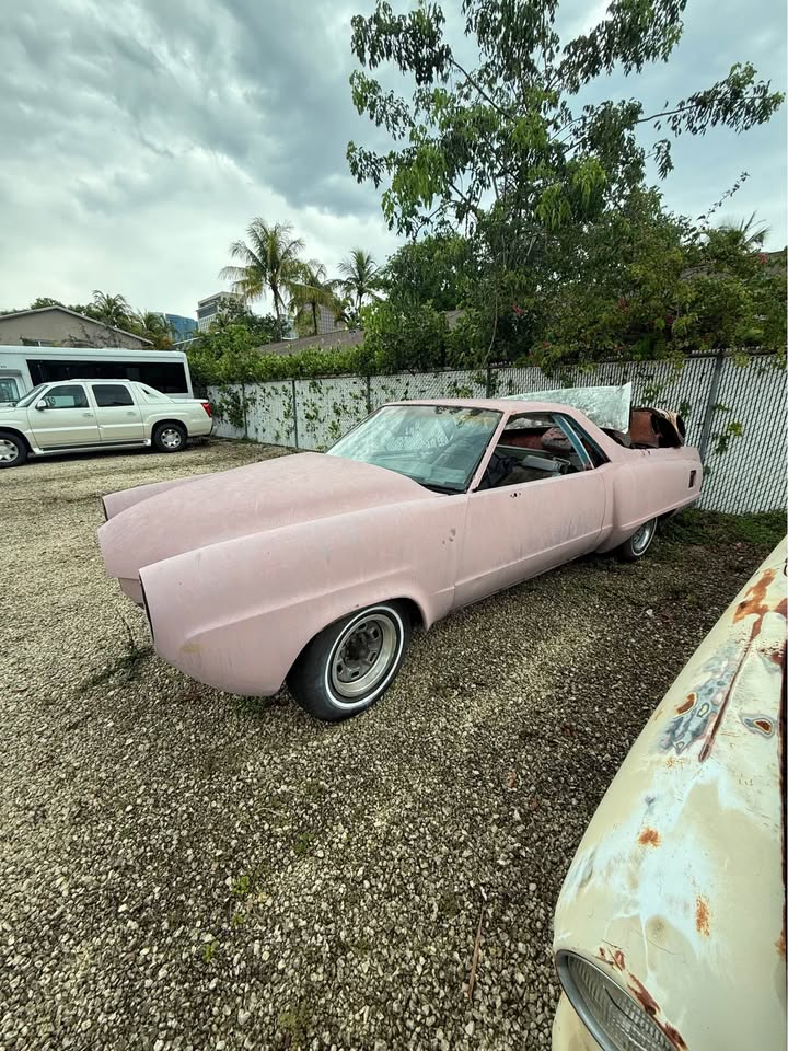

Just might be changing horses in the middle of the creek ...
I found a 2003 L-18 Gen VII 496 ci 8.1L big block ..
Photos shorty ..
That's an unusual one. Some serious sheetmetal work there. Are you concerned that the L-18 might be a little under powered for your International? ;-]
I participated in the build of a '78 T-bird/Ranchero, but that was an easy front clip change.

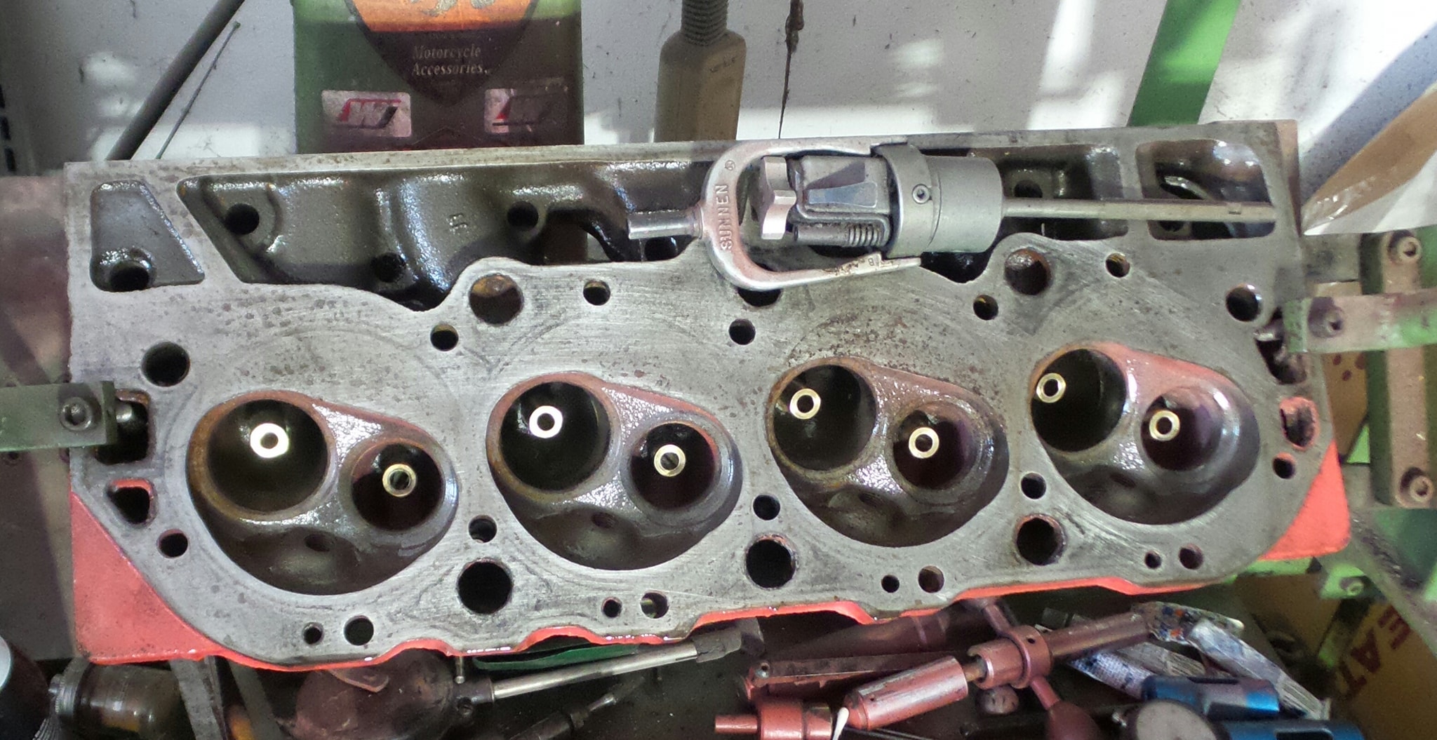

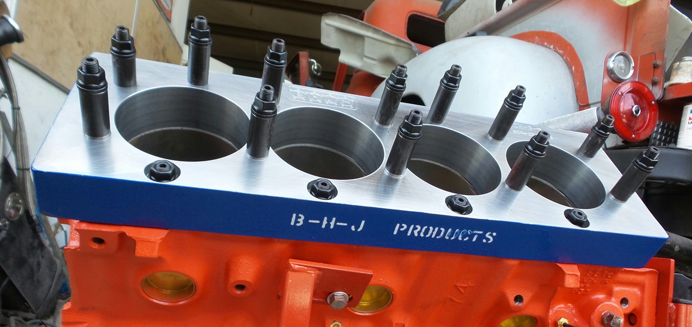

Guides came in, jumped too on installing them ...
These are well made by 'Competition Products'
Soon to size the I.D. and start chewing some meat out for the oversize valves ...
(Those puppies are huge)
