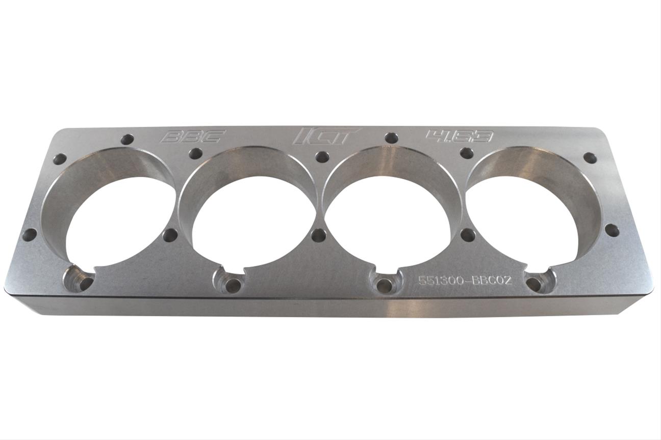

Made a lot of tools for having the ability to work Harley heads ..
The Pan's, Shovel's Sportster's and Evo's bolt to a plate that is clamped to the machine table..
For Knuckleheads had to build it's own fixture in order to clamp them into the machine ...

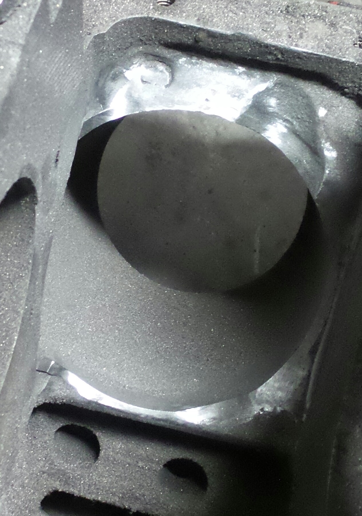

Cylinder notching is also on the table to do ..

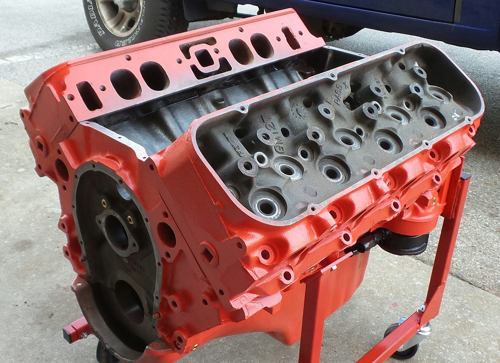

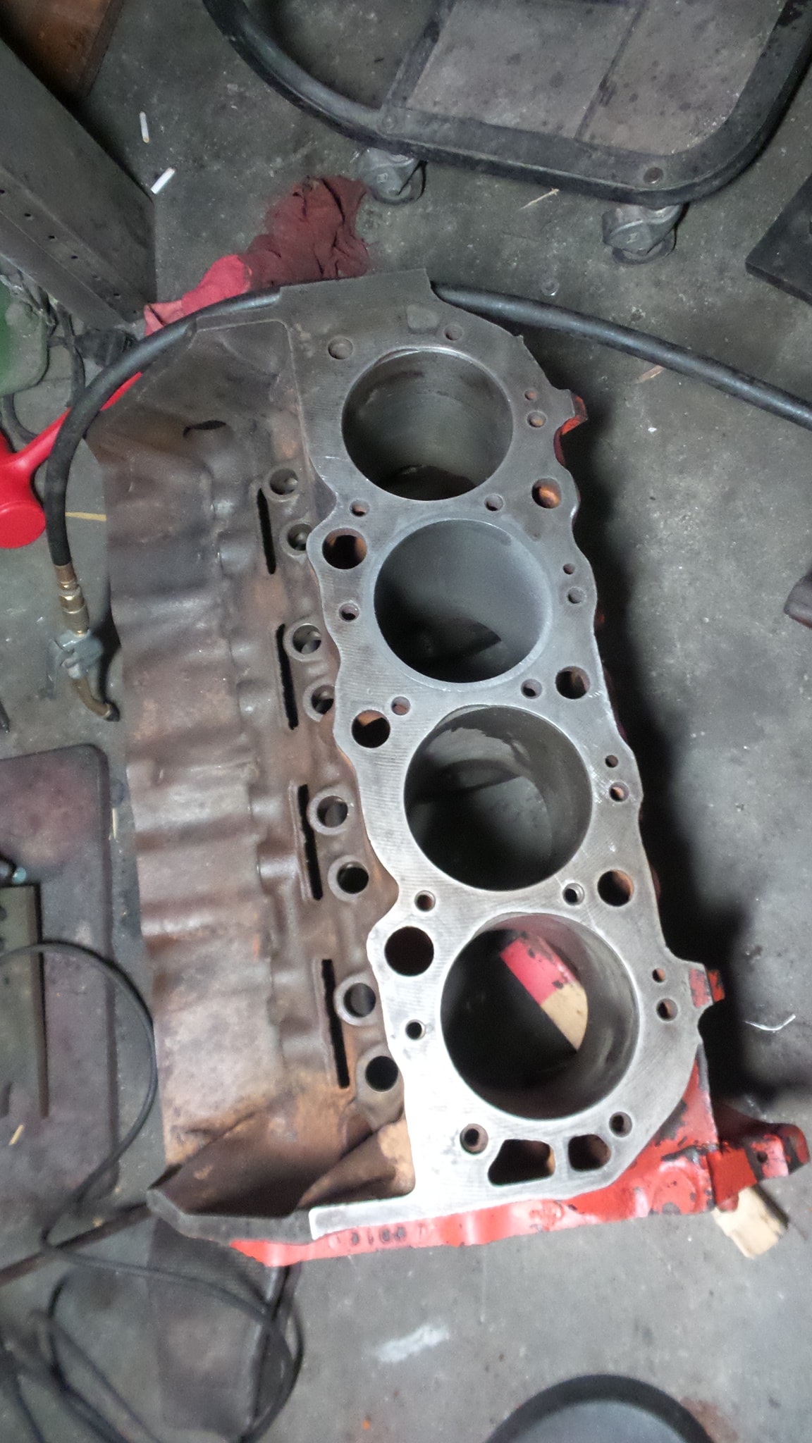

Found a 4 bolt main Mark IV block to replace the one I sold ..
Going after it this evening ...
Photos of it looks really good, soon to see it up close ..
It's also the last year for the Mark IV's .. 1990
Will be doing another 496 cid stroker with it ..
Been on the hunt for a 4 bolt for a long while, thinking I got super lucky finding this one so close to home ..

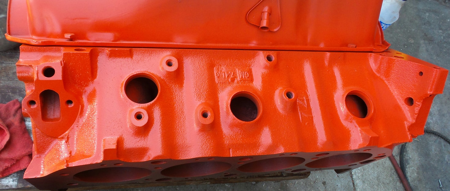

Cleaned up pretty nice ...
Deburring the lifter valley took some time, not done with that job yet ...
Hoping to get a shine in there like this oil pan has ..

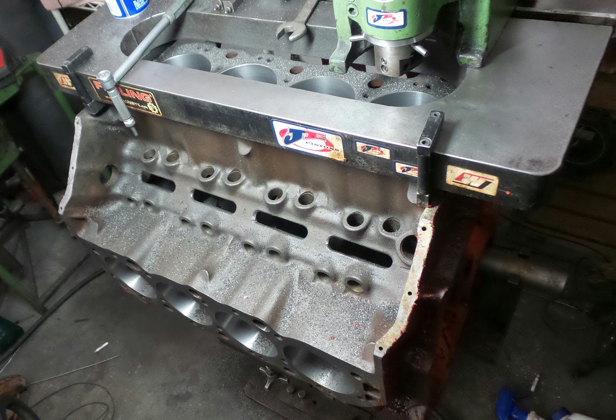

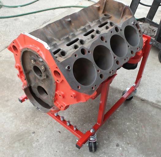

I'm going to put the block back in the boring stand ...
I decided to take out .020" more meat ... Finish bore will be right at 4.330", with the 4.250" stoker crank cubes will be right at 500 ...
