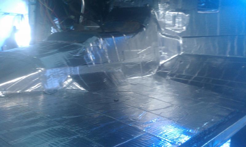

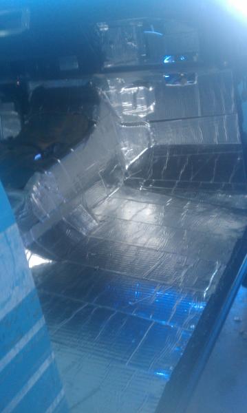

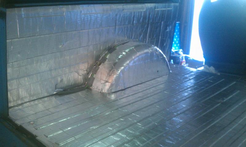

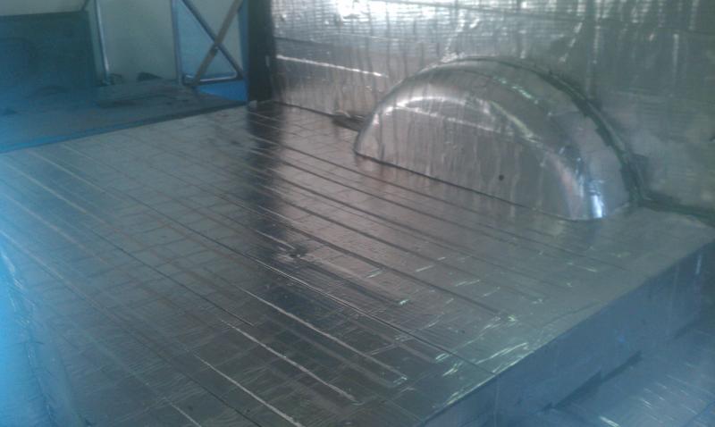

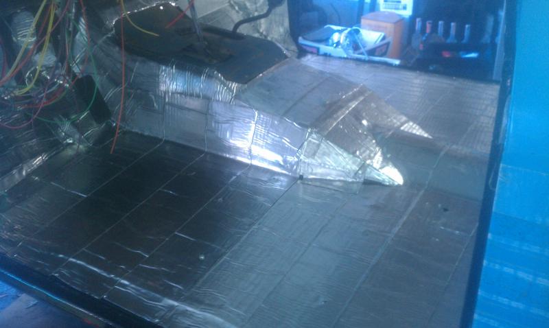

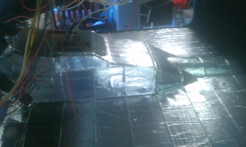

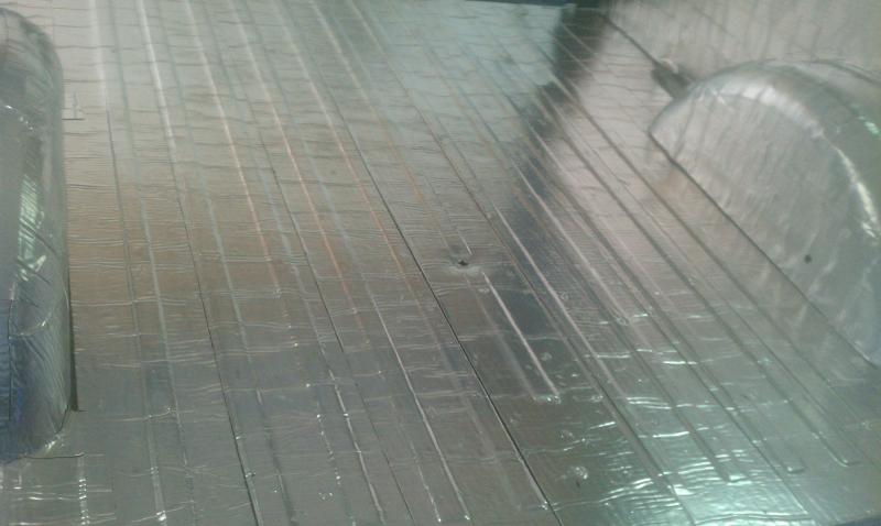

So for the time being I decided to start sound proofing the interior. I have an acc carpet kit waiting to be installed so now is the perfect time. Here are a couple pics of the sound proofing. I used peel n seal from lowes. I read numerous positive things about it and decided that I just couldn't justify spending $300 on dynamat. I will however end up using dynamat for the top.
attachment.php
attachment.php
attachment.php
attachment.php
attachment.php
attachment.php
attachment.php
Nice update and a great tip about buying the sound deadener form loews! I have been following your thread for a long time. Every time I think about taking a short cut on my rig, I read your post.

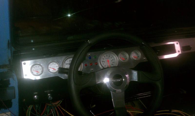

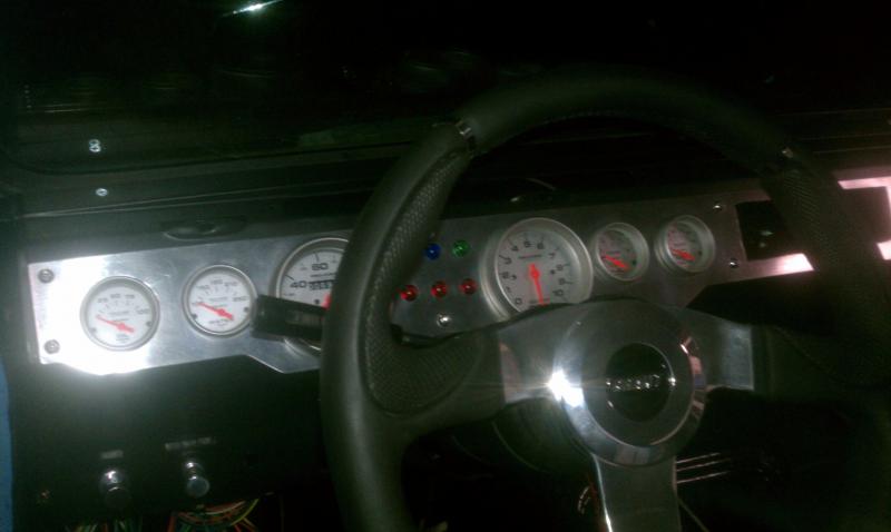

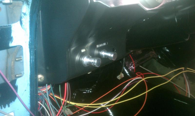

Current dash pics.
attachment.php
Here you can see the glove box door installed. It lines up perfectly.
attachment.php
Distribution box mounted on back of glove box.
attachment.php

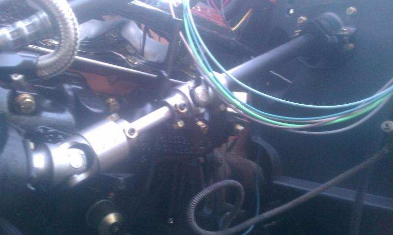

Also needed to install a pertronix that I've had sitting around for awhile due to the prestolite module going bad on me. Not sure why I didn't install this when I had the distributor out for paint. The install for the pertronix is pretty straight forward. Also picked up a new vac advance from IH only. Old vac advance was shot.
The distributor should be in great shape now. End play was measured at .038. Sensor to trigger gap was set to .008.
Original module
attachment.php
I was planning on running the wires underneath the base plate but reconsidered once the vac advance went in. They May or May not have been in the way. I decided not to take the chance.
Underneath route
attachment.php
Over the top
attachment.php
New vac advance from IH only
attachment.php
Pic of ground wire and trigger to sensor gap
attachment.php
End play of .038
attachment.php

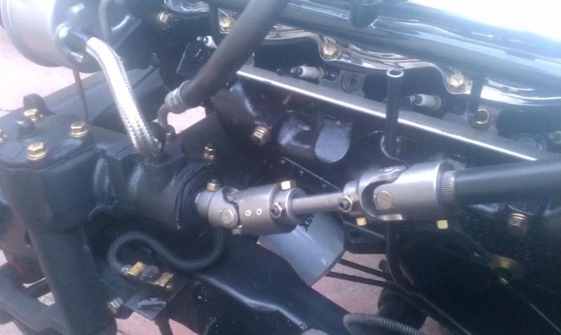

Extended front brake lines
attachment.php
attachment.php

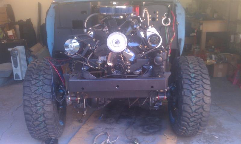

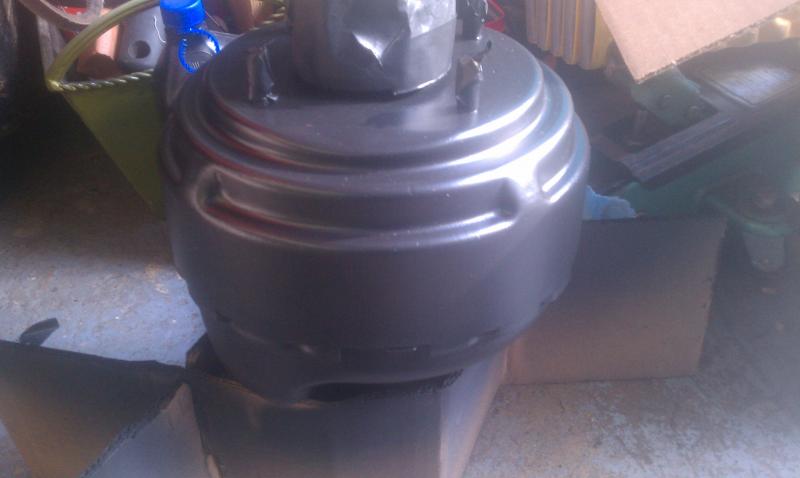

Booster and mc plus misc. Passenger engine shot
attachment.php
attachment.php
attachment.php

Lookin good man! Why did you not go for rear discs concersion? Just curious. Getting a lot of inspiration from your build.
lookin good man! Why did you not go for rear discs concersion? Just curious. Getting a lot of inspiration from your build.
Thx doc. I had originally wanted to do hydro boost and rear discs but after pricing out new components I decided it just wasn't needed. If/when I need to change the rear brakes in the future I May consider it but the costs were prohibitive at this point.

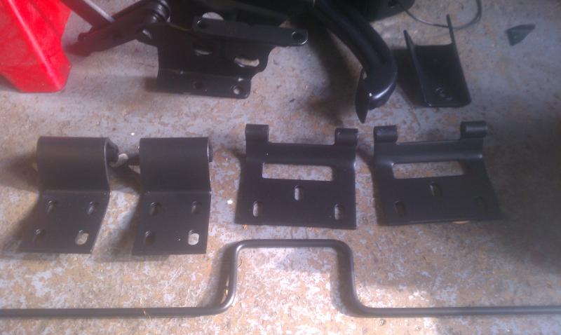

Put in some Energy Suspension poly shackle bushings. I forgot to do this when I swapped in the new springs and decided since the rear end was out now was the most opportune time. Using a ball joint press made getting the old rubber bushings out very easy. Also pulled out the rear driveshaft to clean up, paint, and replace the u joints. Here are some pics.
attachment.php
attachment.php
attachment.php

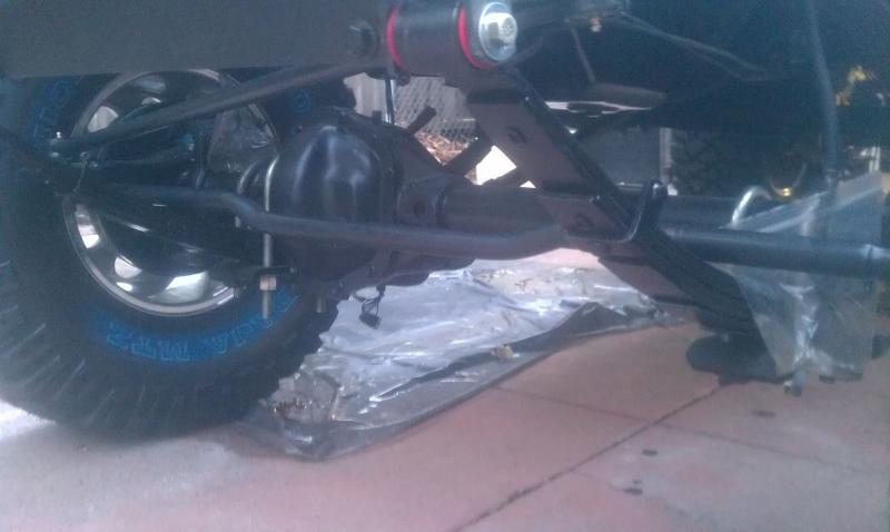

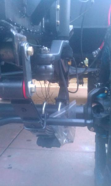

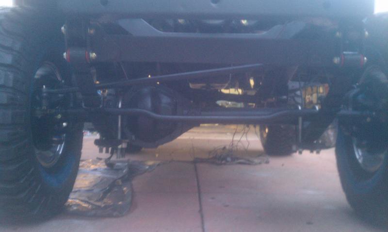

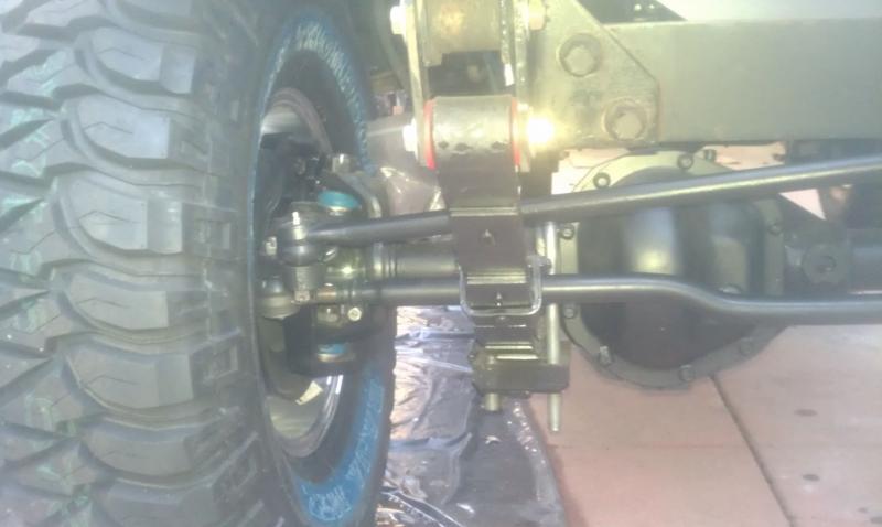

got the new IH only 5" shackles installed along with the new poly shackle bushings. The shackles along with the addition of the spacers has made the truck perfectly level. The old shackles were in pretty rough shape. The bolt holes had elongated by almost 1/4" in some spots.
Rear shackles
attachment.php
attachment.php
Front- swaybar yet to be installed
attachment.php
attachment.php

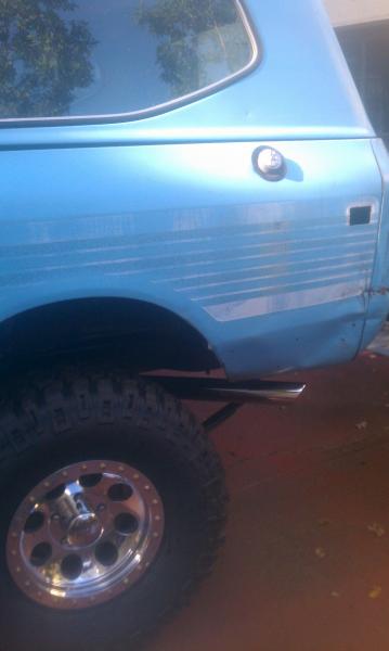

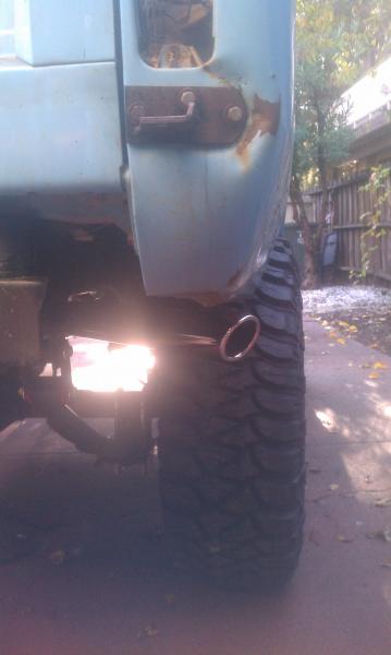

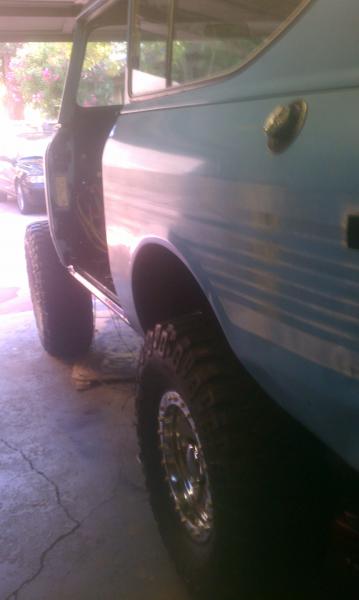

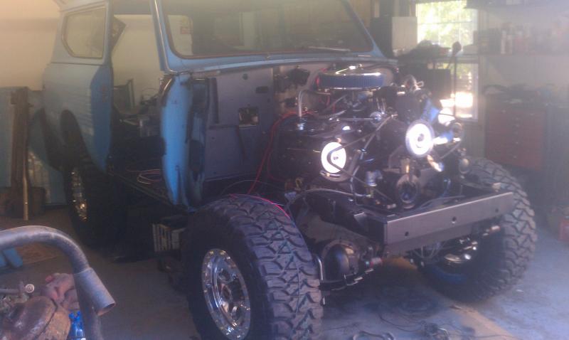

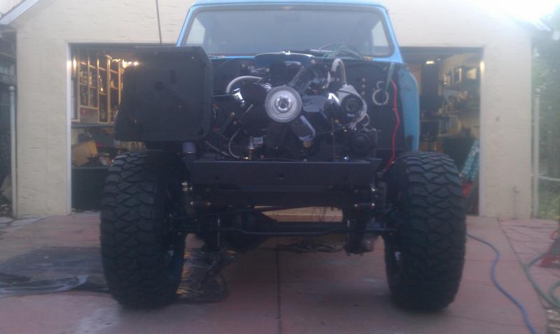

also got the front fenders installed and it's the first time I've seen the truck this way in about 1 1/2 years. You can get a good feel for the final stance. The suspension will settle a bit but for what I was going for I'm very pleased. I plan on driving this thing for awhile before I pull the body apart and do a major overhaul on the bodywork.
Front fender clearance
attachment.php
Additional shots of truck
attachment.php
attachment.php
attachment.php
attachment.php
