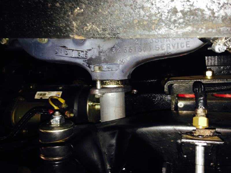

Finally got the donuts sealed up nice and tight. Took about three cycles of engine heating to get a perfect seal. Absolutely no exhaust leak now. The donuts are victor reinz f7395. They do not have the sleeve. Decided on these after reading a bunch of threads.

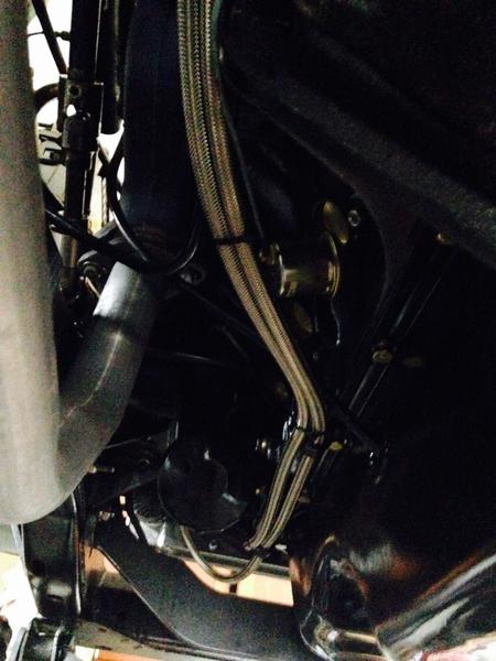

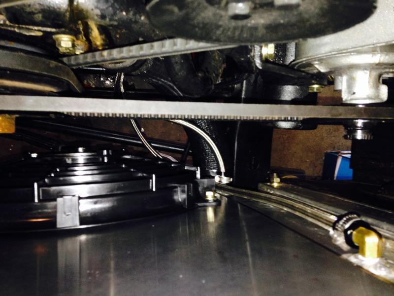

Have been having a slight leak at the trans cooler line fittings and finally got fed up with all the fiddling and decided to just replace the lines and fittings with 6 an stainless braided ptfe hose. Not a drip anymore. I ran them in the same position as the hard lines to keep them away from the exhaust.

All that is left before smog next weekend is to reinstall all the vac lines to the engine. Charcoal canister. Heat exchanger thingy on the passenger side. Will pop on an old air cleaner for the test.

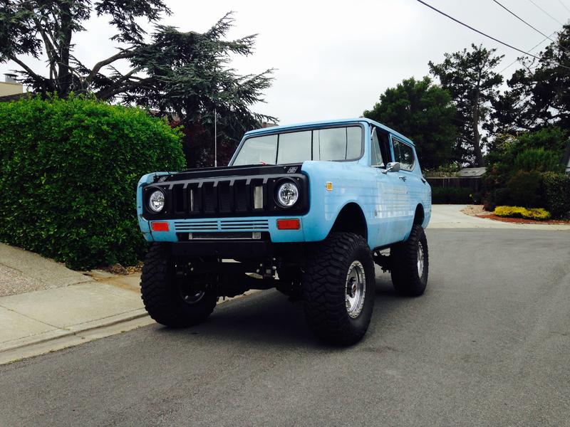

Here's what she looks like as of now. Still no hood.

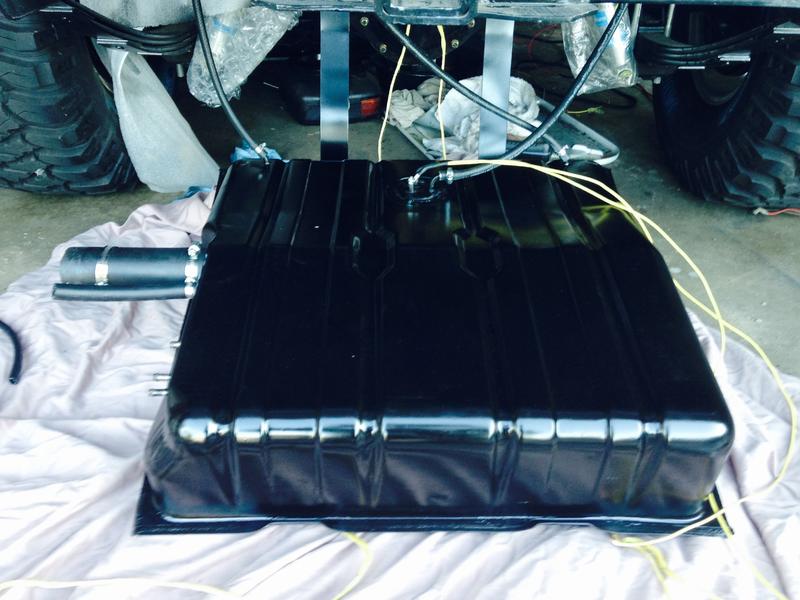

Failed the evap test so it was time to drop the tank and replace every hose that connects the tank with the engine, smog canister, and evap canister. Had to rip away my perfectly glued down carpeting to get to the access panel for the evap canister but there was no other option. Evap canister, after being washed off with water, was in pristine condition. There are a couple hoses that connect at the top, way up inside the fender, that are only reachable by removing the access panel. Bought 50' of gates barricade hose thinking I would have plenty (20+' left over). Replaced all tank to evap canister connections (5). Also replaced the 6th evap connection that runs to the charcoal canister under the hood. Replaced the fuel feed line that runs from tank to fuel pump. I ended up with abuout 3' of hose left over. My gas gauge hadn't been working and I was afraid the float was defective. Turns out the old wiring connections at the sender were the culprit. New wiring was run off the original sender and the gauge now works like a champ. Sanded down and painted very thing with eastwood chassis paint. Everything is new and tight.

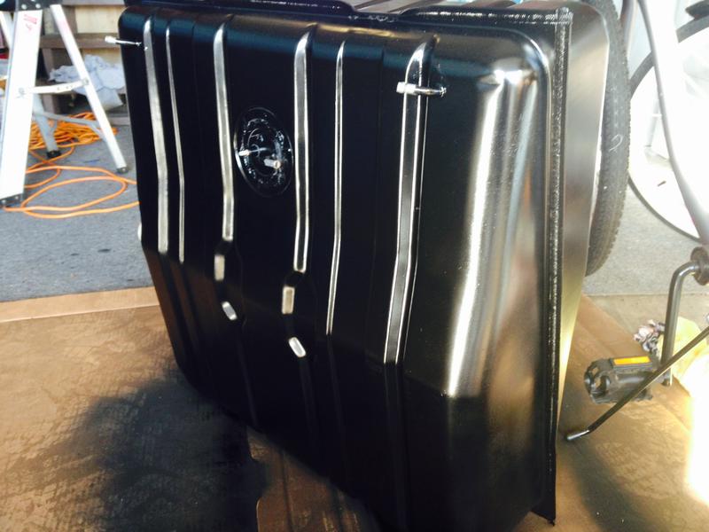

Couple pics of the tank process:
freshly painted tank:
attachment.php
Tank ready for install
attachment.php

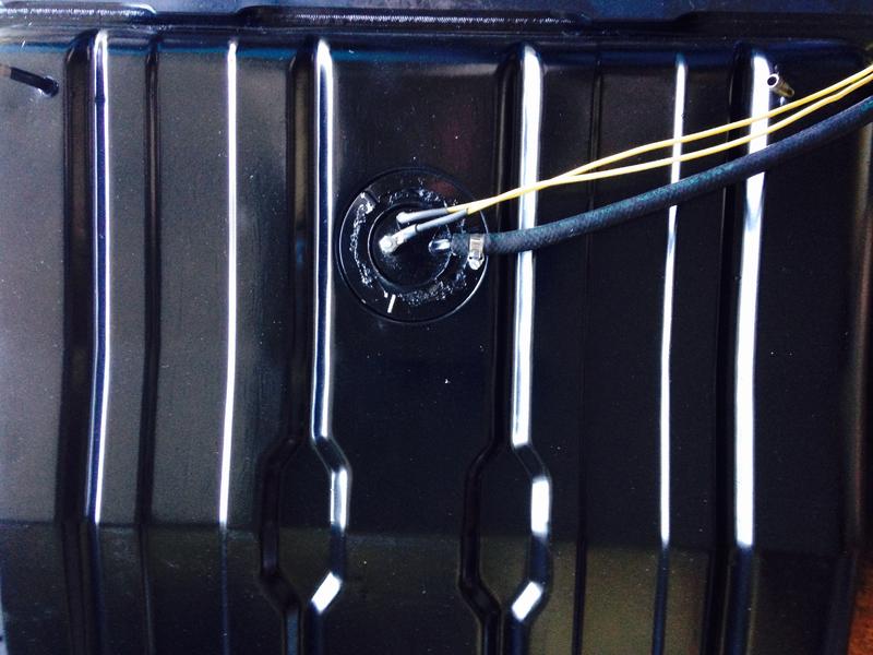

New tank wiring connections
attachment.php

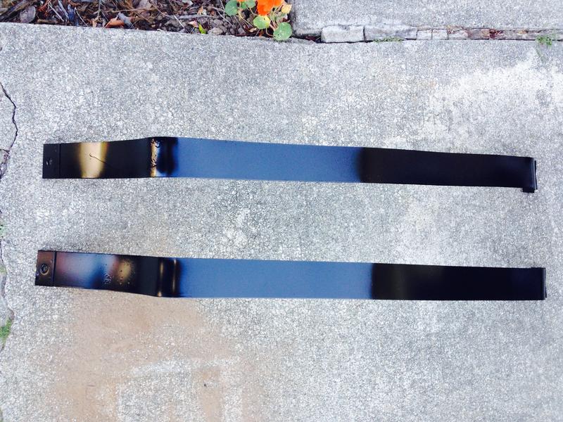

Is there anything more exciting than freshly painted gas tank straps?
attachment.php

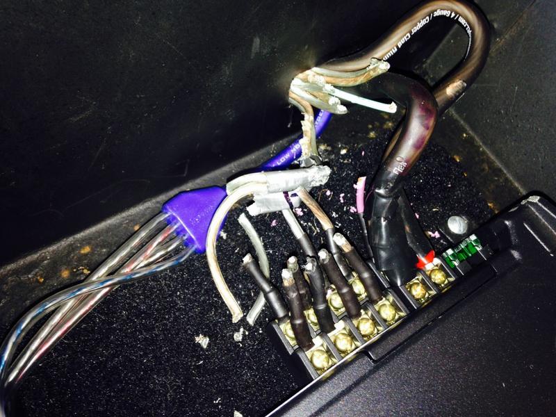

been meaning to get to the amp that the rat had chewed up the wires and see what needed replacing. Turns out the gigantic bastard chewed through every wire but 2. That's 11 wires at about 5 inches per all fully consumed.

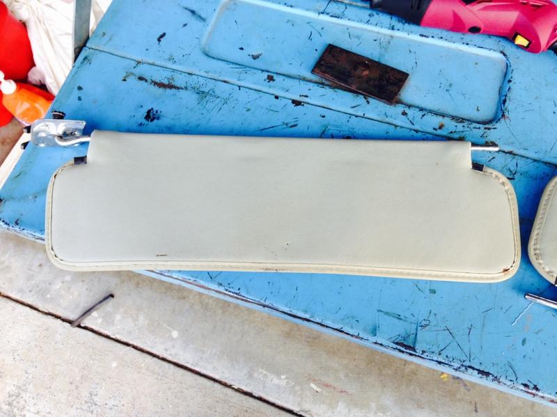

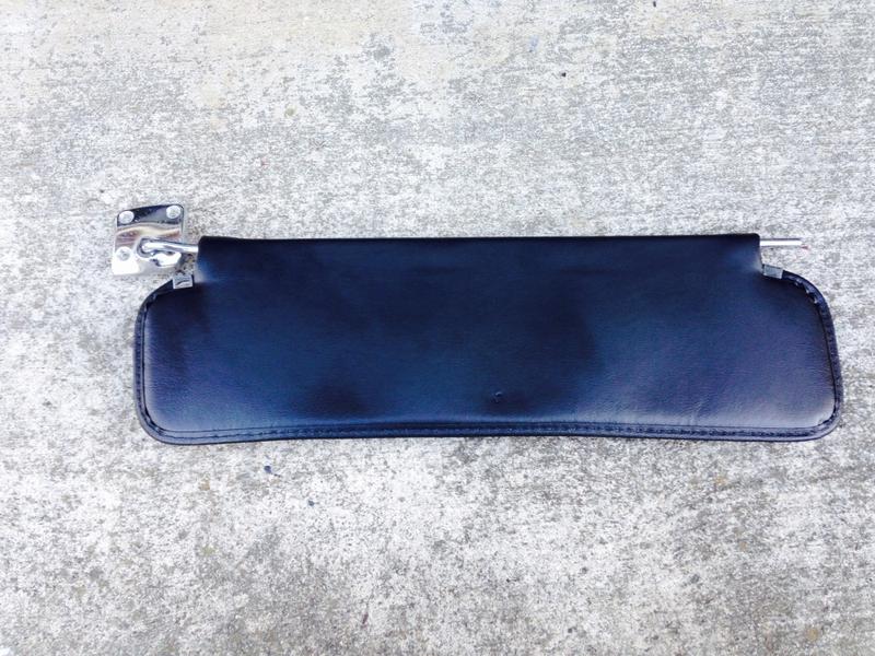

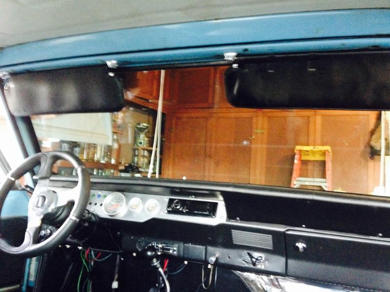

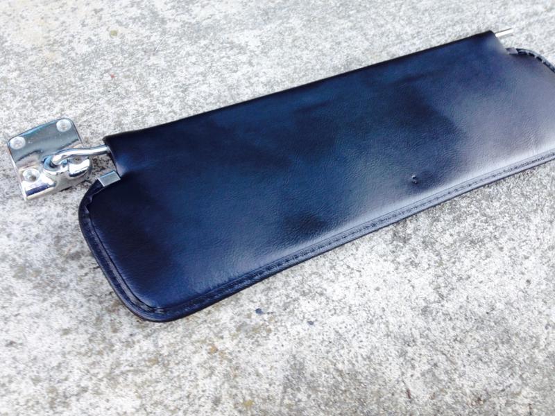

Also got around to cleaning up the visors. They needed a deep cleaning, the chrome needed polishing and I needed to dye them black. Boring but they turned out great. I'll recover them at some point but these will do for the time being.

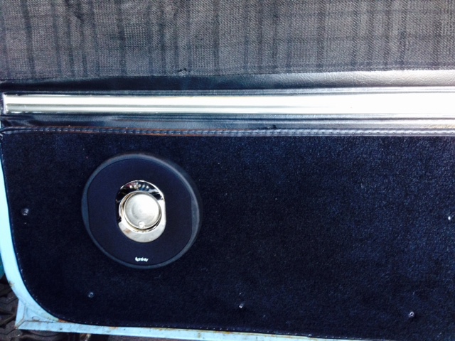

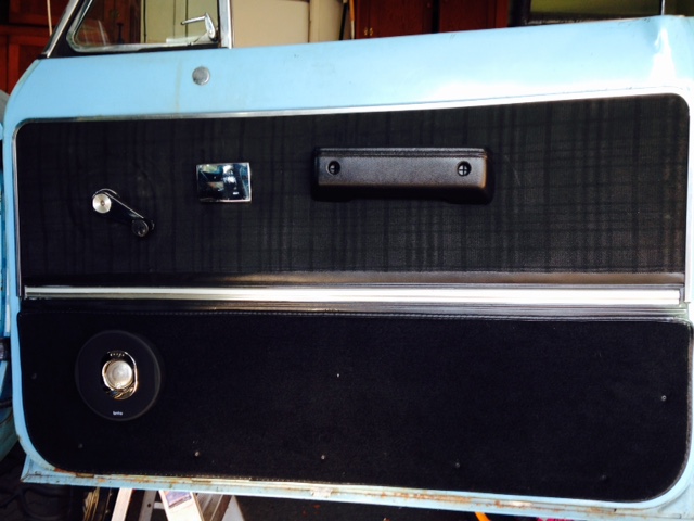

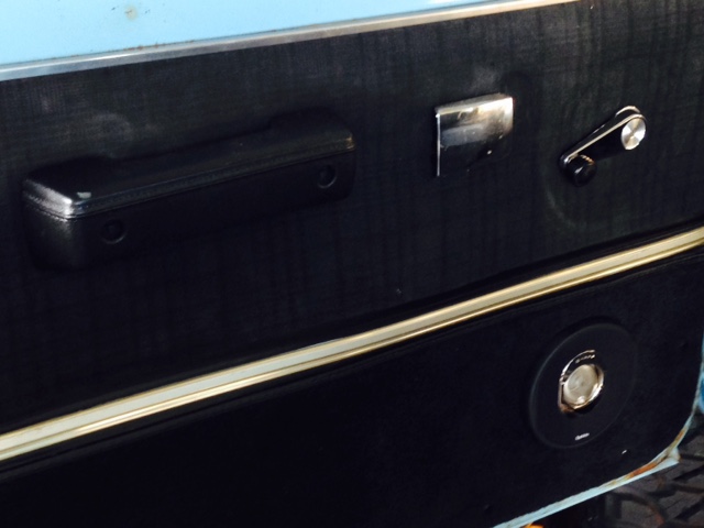

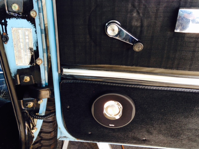

Finally got the front speakers installed also. They really solidify the door panels.

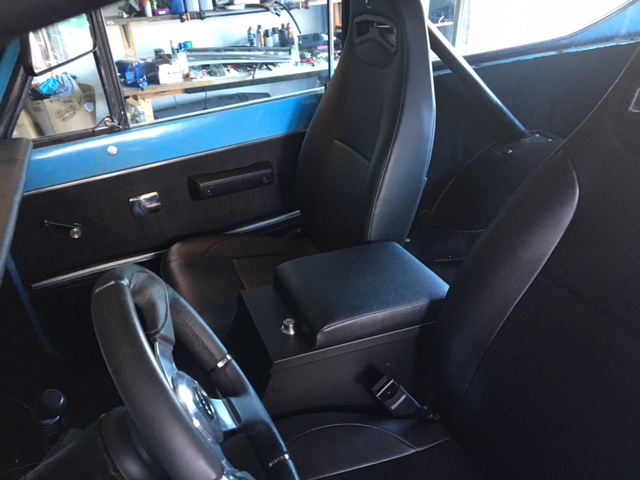

Got some more work done on the interior.
Tuffy center console
attachment.php

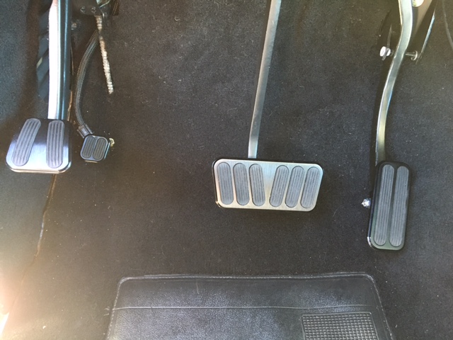

Pedals

The 10" console is in my Scout. To get it to fit the back legs were extended with some short lengths of 1/8"x 1.5" angle iron. Nice unit and real handy. Having drink holders really civilizes things.
love your build!
Is the center console the 10" wide version? Did you have to modify the rear base?
Also, where'd you get the new pedals?
Thx!
Picked up the pedals from summit. I think they're lokar midnight series pedals. I did have to drill new holes in the pedals to attach but it's pretty painless. Probably took and hour total. Console is the 10" version and fits perfect between the seats. The rear attachment of the console just needs to be slightly rounded out for the legs to reach the floor. Technically you could just put the two bolts in and I'm sure it would be snug as can be.

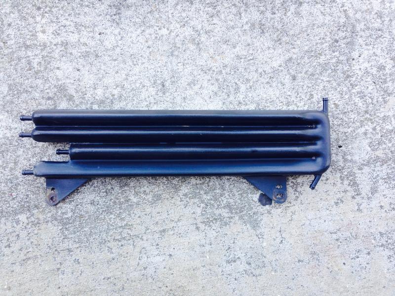

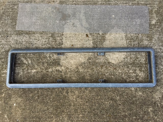

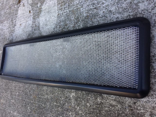

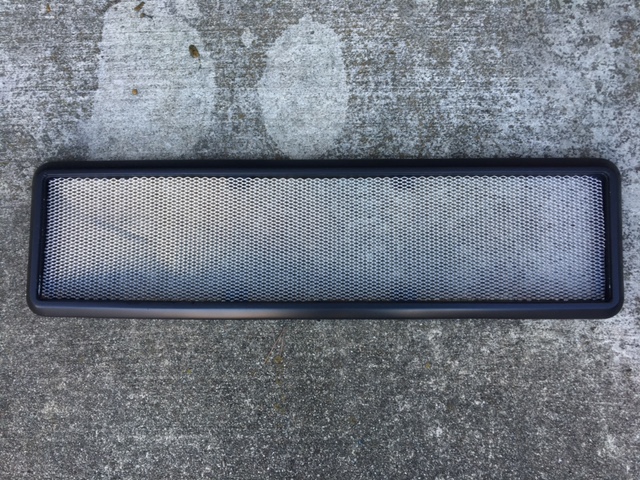

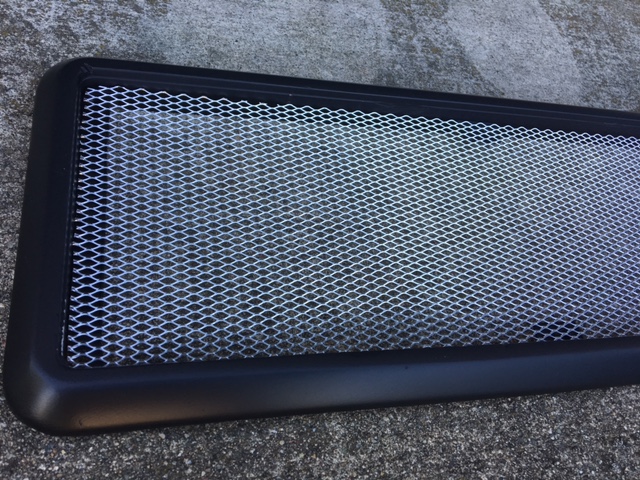

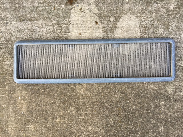

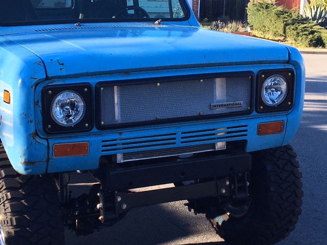

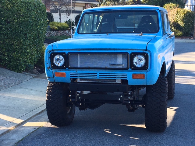

My original grille was in pretty rough shape so I went with the ss grille. I'm not liking the fact that it is very cheap plastic looking. So I decided to see what I could come up with for a custom grille built off the old one.
I sanded off all the chrome and cut out the center of the old grille. I've had some nice stainless mesh for awhile that I was going to put behind the ss grille but instead cut out a piece to fit in the center of the old grille. I painted the old chrome portion black and will put an IH emblem in the center when all is said and done. I was trying to emulate the style of the older 80/800 grilles. Haven't been able to put it on the truck yet but I think I might like it.
attachment.php
attachment.php
attachment.php
attachment.php
attachment.php

That's the exact mesh I've been looking for to put behind a ss grill. Do you know where I can buy some and what would I ask for?

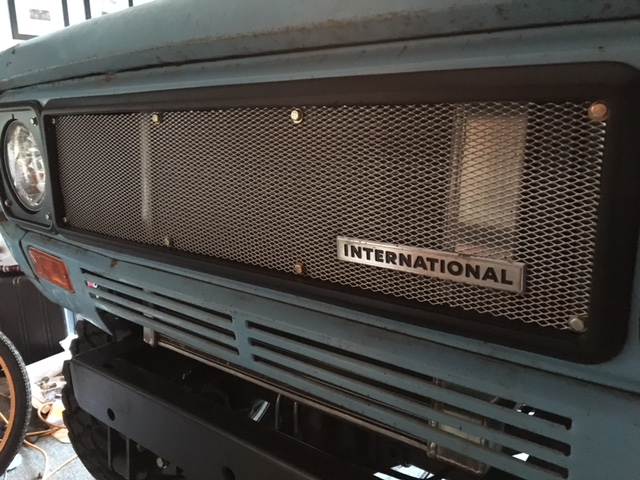

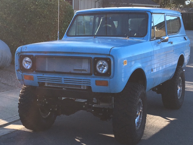

Finished up the grille and installed today. Extremely pleased with how it turned out.
attachment.php
