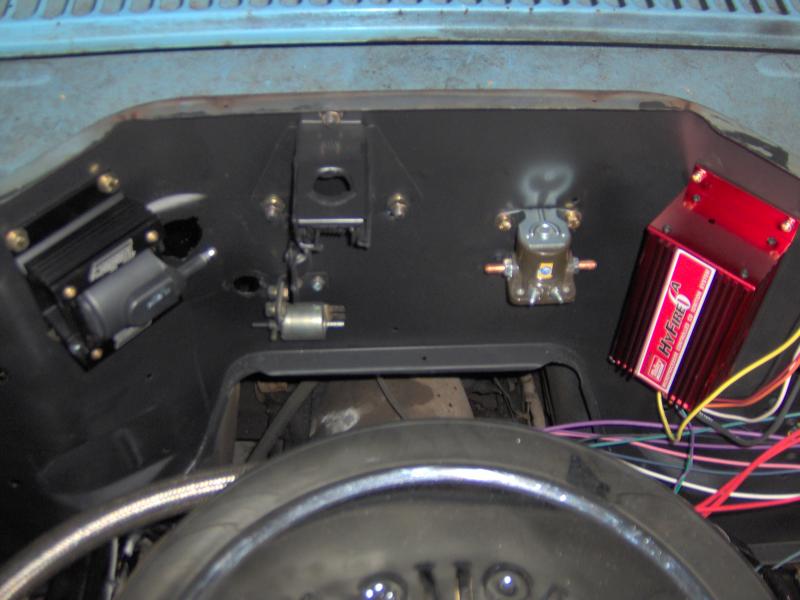

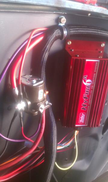

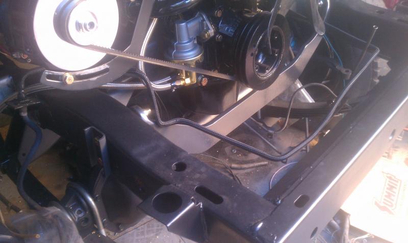

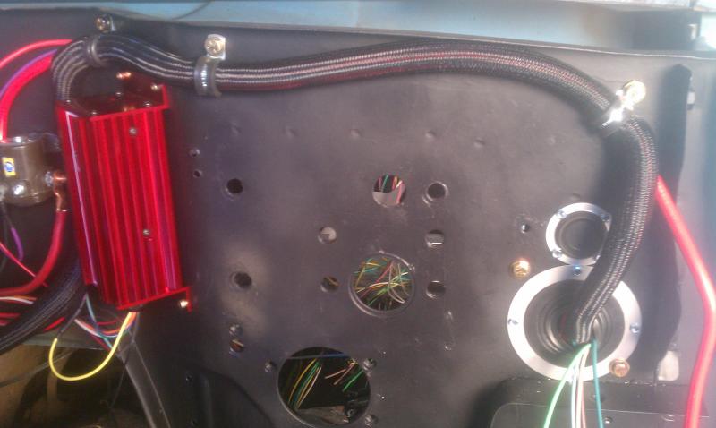

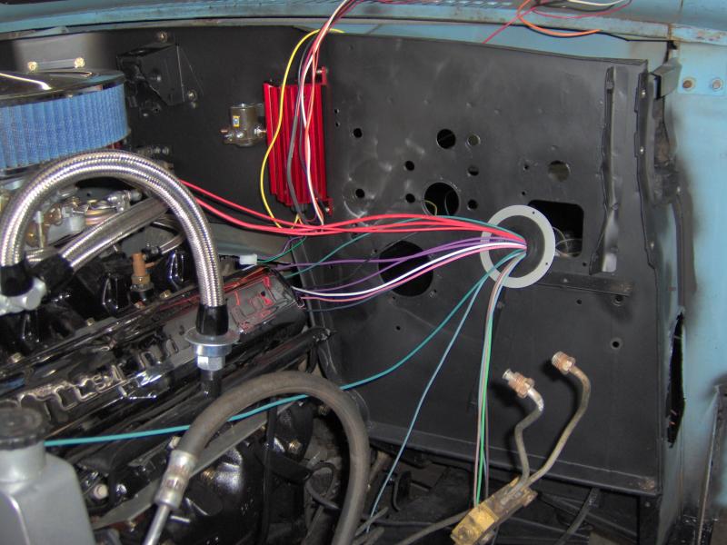

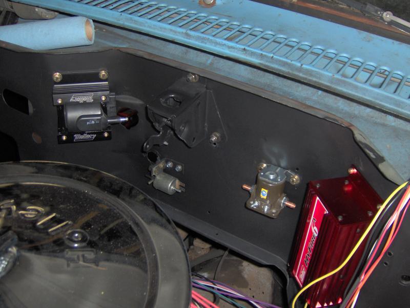

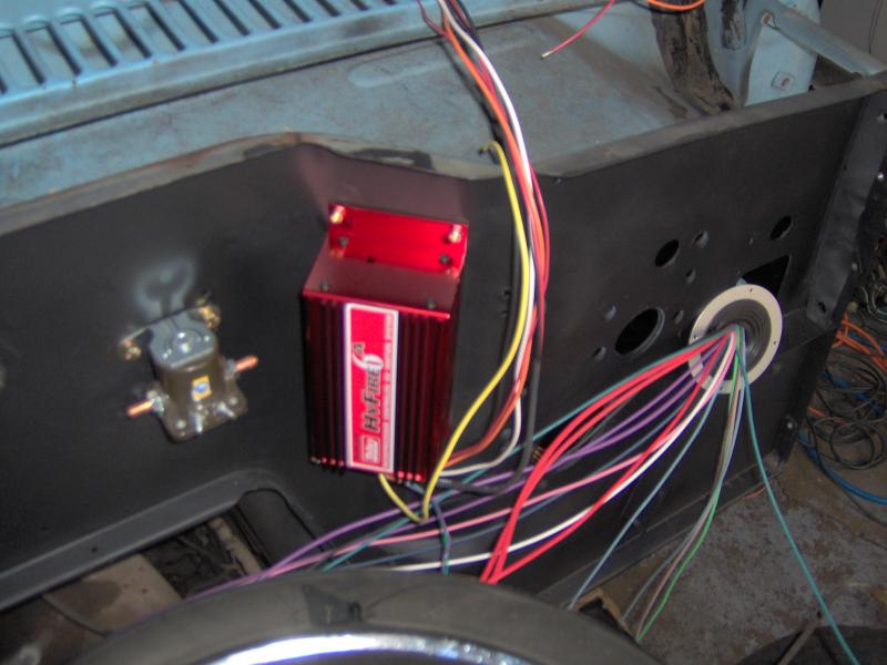

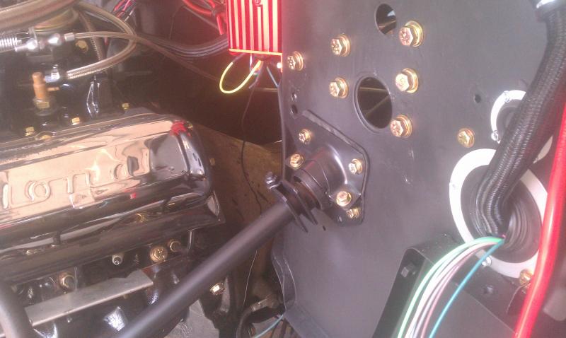

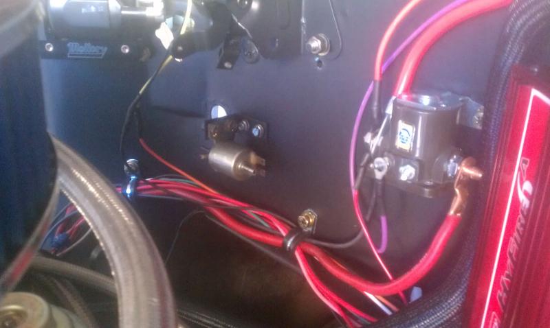

Got some more work done over the weekend and so far this week. Most of the engine bay wiring is finished. Heat shrunk all connections and will be covering all wire runs in split loom. Picked up a 100 amp alternator because mine needed a rebuild and I knew in the future I was going to need the extra amperage. Right now I'm running with the single pulley on the alternator. I have additional dual pulleys to swap on if I need to. We'll see if I have any slippage. Need to start on the dash and steering column wiring so I needed to get the steering column and dash cleaned up and painted. I coated them in eastwood semi gloss black. They turned out great. I also have an IH only dash panel and auto meter gauges that will be going in.
Here's a few pics of the progress:
alternator
attachment.php
Wiring for now:
attachment.php
attachment.php
attachment.php

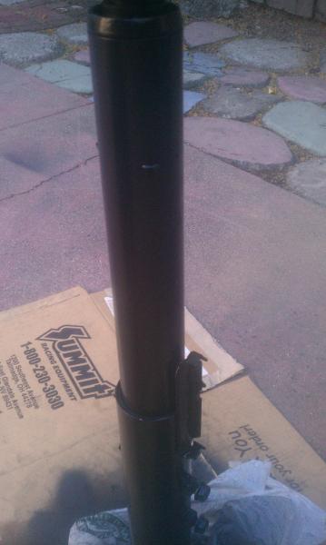

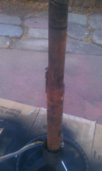

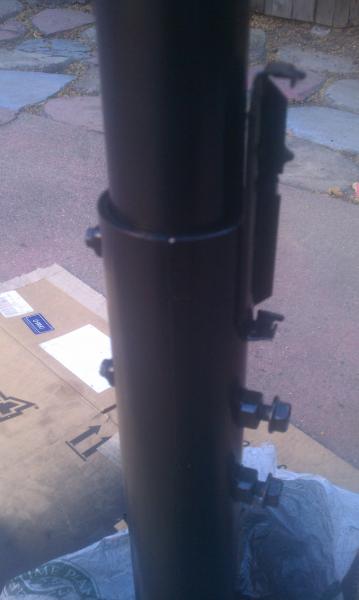

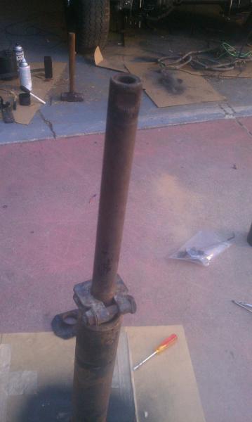

Steering column and shaft
before
attachment.php
After
attachment.php

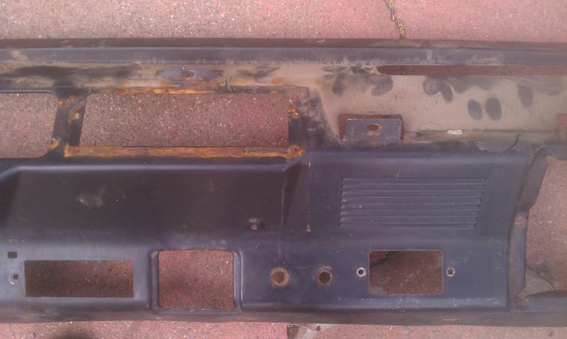

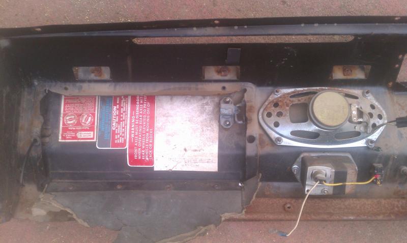

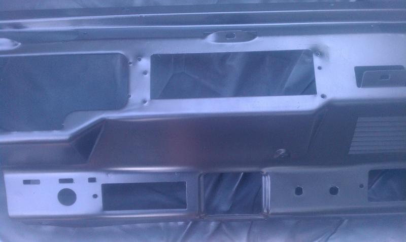

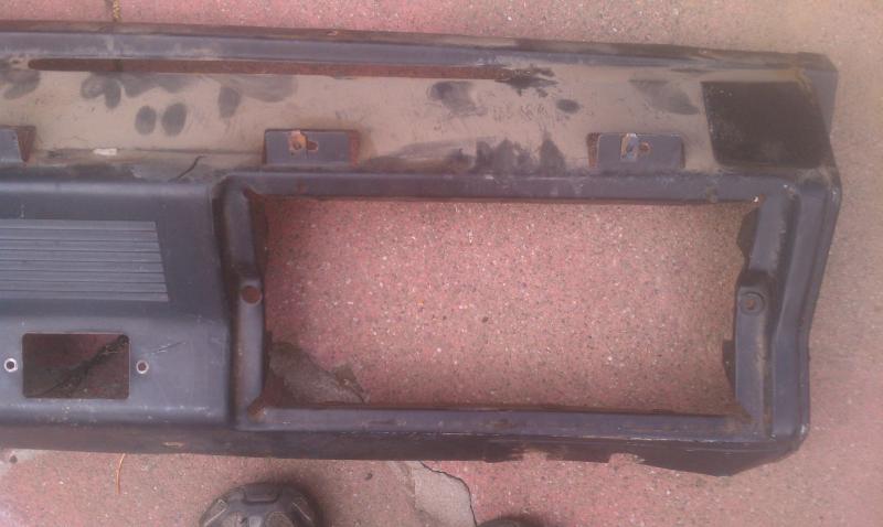

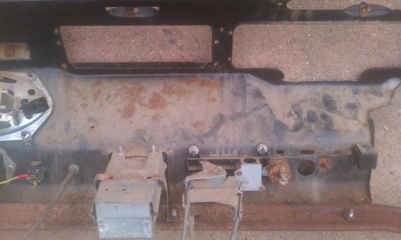

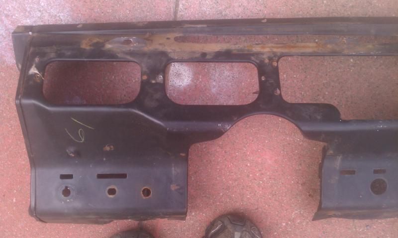

Dash
before
attachment.php
attachment.php
attachment.php
attachment.php
attachment.php
After
attachment.php
attachment.php
attachment.php
attachment.php

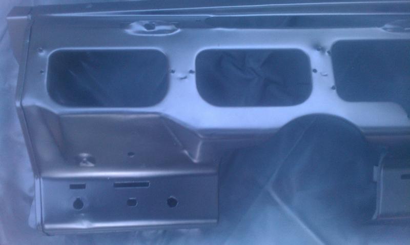

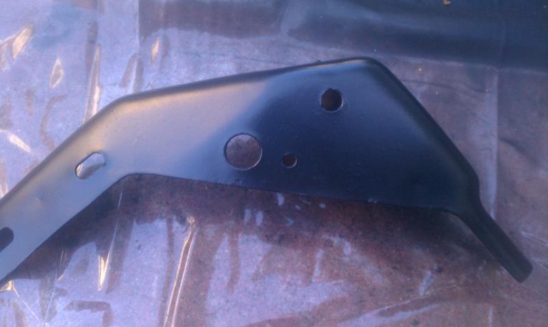

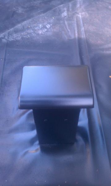

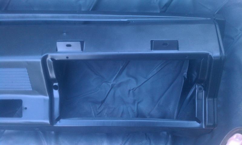

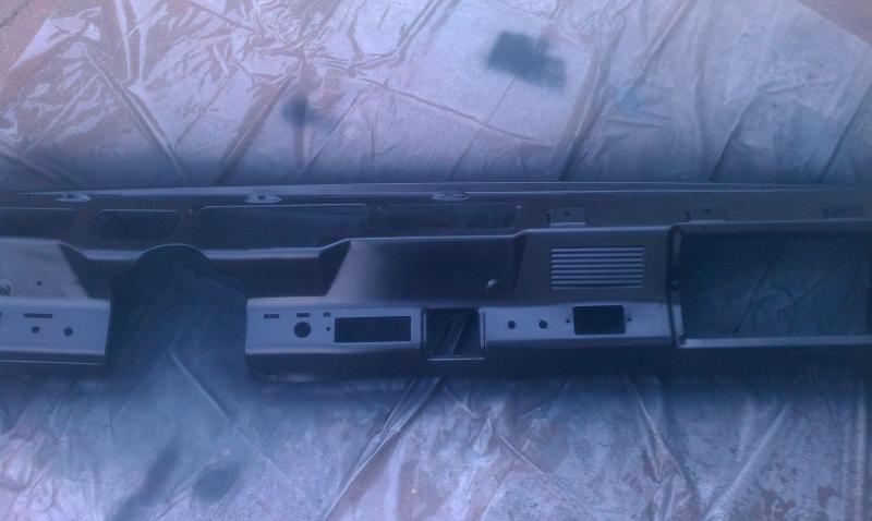

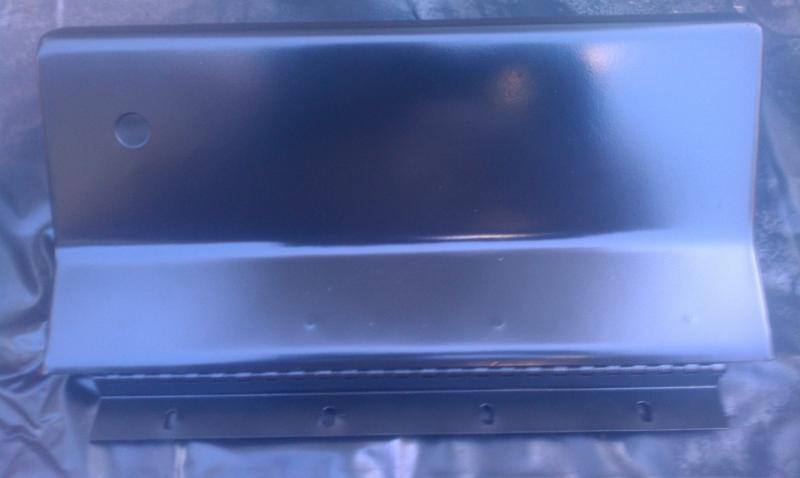

Boring post here but............ash tray, glove box, and dash supports are all sanded and painted up nice.
Glove box
attachment.php
Ash tray
attachment.php
Dash supports
attachment.php

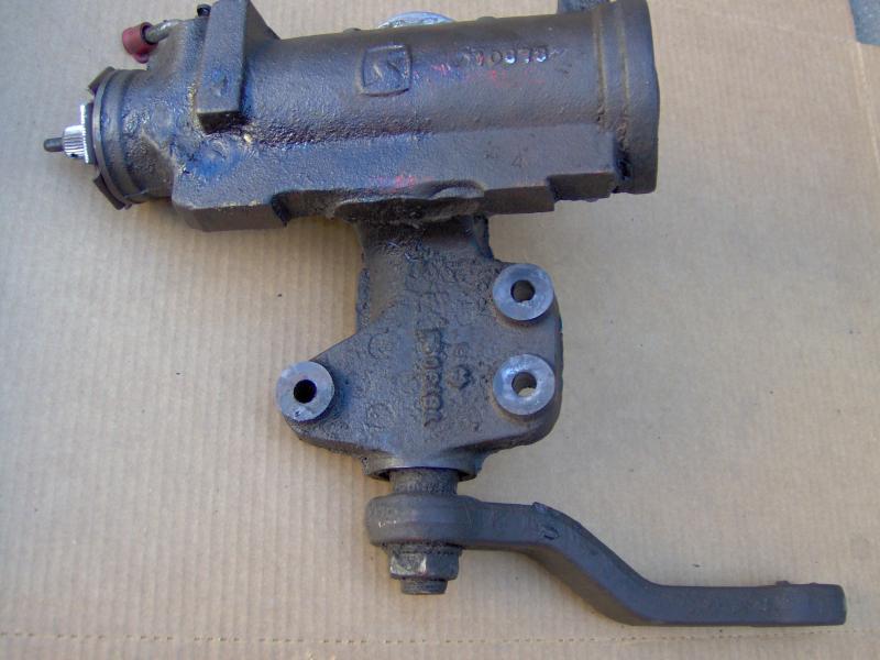

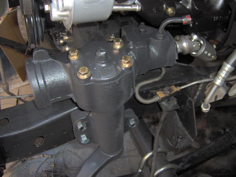

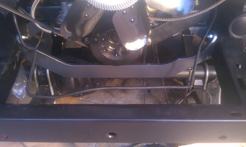

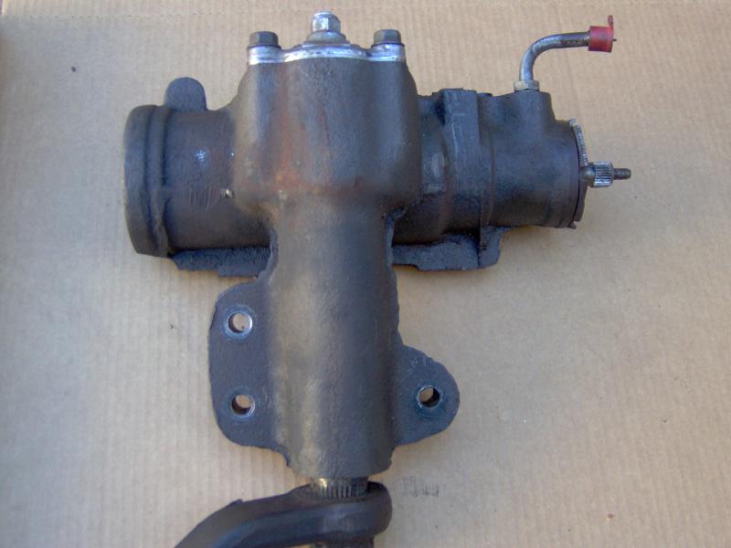

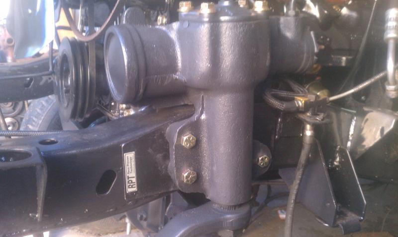

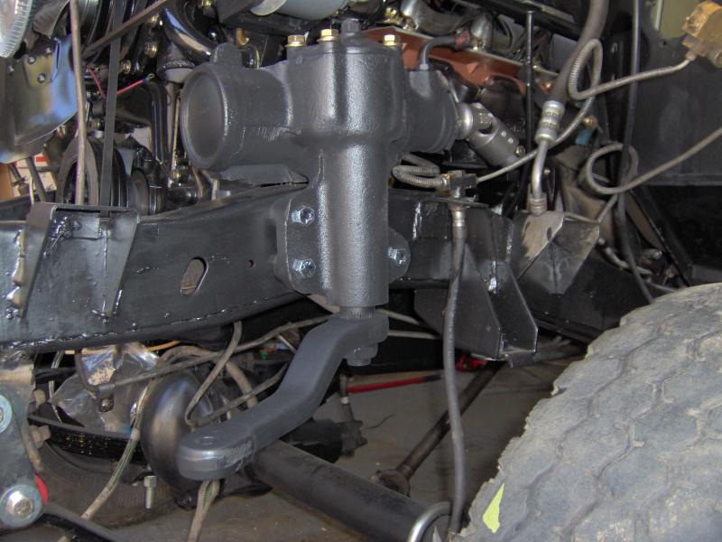

Got the IH only steering box plate and a straight steer brace put in today. As always the IH only products were top notch and delivered extremely quickly. Also stoked to find a new fastenal store has just popped up in san carlos about 3 blocks from my house. Very convenient.
attachment.php
Straight steer
attachment.php
attachment.php

Way cool. Looks good. Having that channel piece on the outside of frame on the passenger side helps too. I don't think that those bolt holes, on passenger side, are sleeved inside the frame, like they are on the drivers side frame. With what ya got there mounted you will be fine though. So no worries
carry on
way cool. Looks good. Having that channel piece on the outside of frame on the passenger side helps too. I don't think that those bolt holes, on passenger side, are sleeved inside the frame, like they are on the drivers side frame. With what ya got there mounted you will be fine though. So no worries
carry on
They're definitely not sleeved on the passenger side. Not sure if I was supposed to use the original drivers side inside channel on the outside of the passenger but it sure makes a lot of sense. Currently carrying on. :smilewinkgrin:
Man! Its looking good for sure. Ive been following this post for a while. I just wish I had the time and space (oh and money) to do mine. My 75' doesnt get much attention. Appearently my wife thinks buying a house is way more important. Psssh. Looks great though. Keep it up. Kcco:smilewinkgrin:
man! Its looking good for sure. Ive been following this post for a while. I just wish I had the time and space (oh and money) to do mine. My 75' doesnt get much attention. Appearently my wife thinks buying a house is way more important. Psssh. Looks great though. Keep it up. Kcco:smilewinkgrin:
Thanks!! My wife knows how much I enjoy toying around with the Scout so I don't get any flack for it. (knock on wood) she also really misses my old one so that helps also. With no kids and a rental house with ample space this was the perfect time to start building my dream.

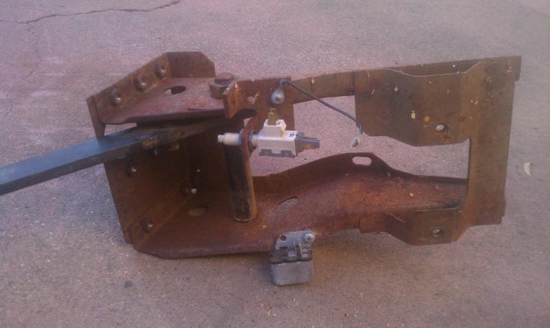

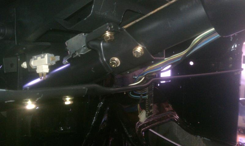

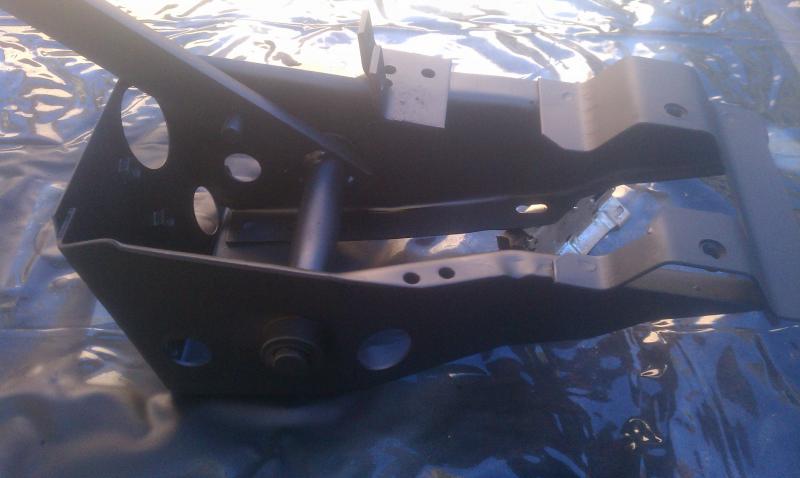

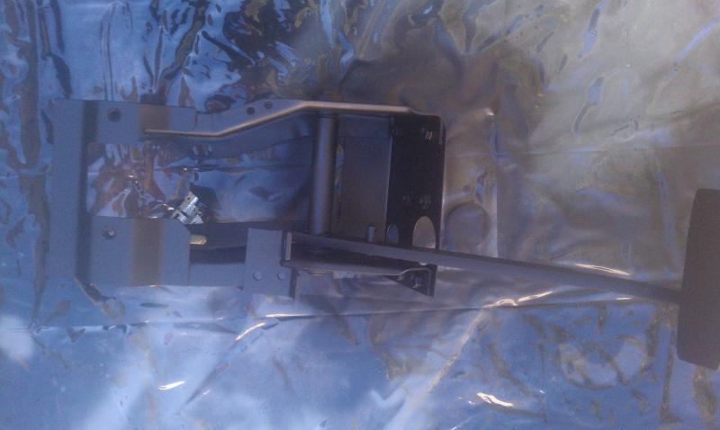

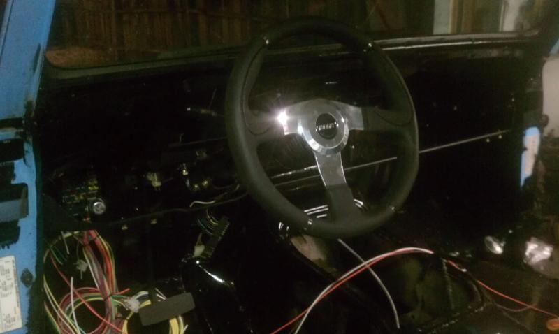

Finished sanding and painting the brake assembly, and steering column. Got them installed and am quite happy with the results. It's great to finally be putting together some finishing pieces to this ride. Oh, and I got some tires delivered. I love tires!!
Brake assembly all rusty:
attachment.php
Looking better primed and painted in eastwood satin
attachment.php
attachment.php

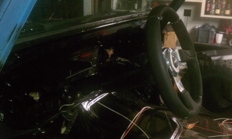

Under dash
attachment.php
Firewall look
attachment.php
Steering wheel
attachment.php
attachment.php

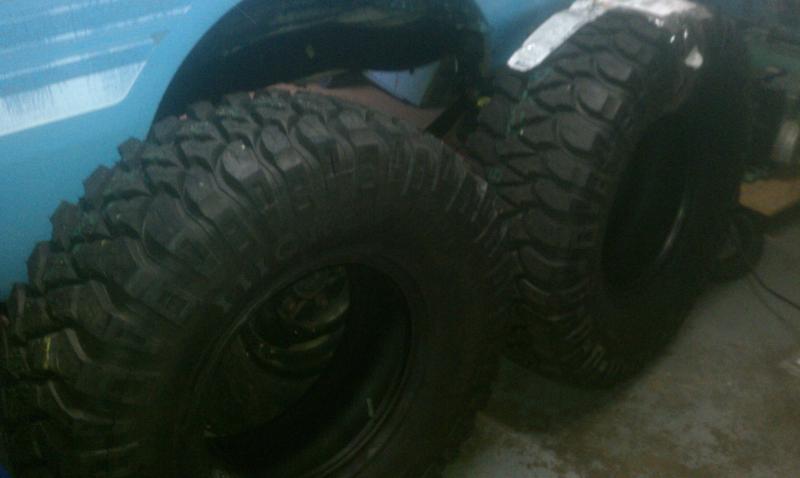

Shoes are on!!!!!!!!!!!!!!!!!!!!!!
35x12.5x16 mickey thompson baja radial mtz's
16x8 mickey thompson classic locks 4" bs
pics aren't amazing but they're all I've got right now
attachment.php
attachment.php
attachment.php
attachment.php
attachment.php
Rear wheel well opening. Front is to the right. There will be more clearance when the new shackles are installed. The tire also pushes to the rear (left in the picture) so clearance shouldn't be an issue. Full stuff is not an option with this tire choice though.
attachment.php
Here's a couple shots of the wheels:
attachment.php
attachment.php

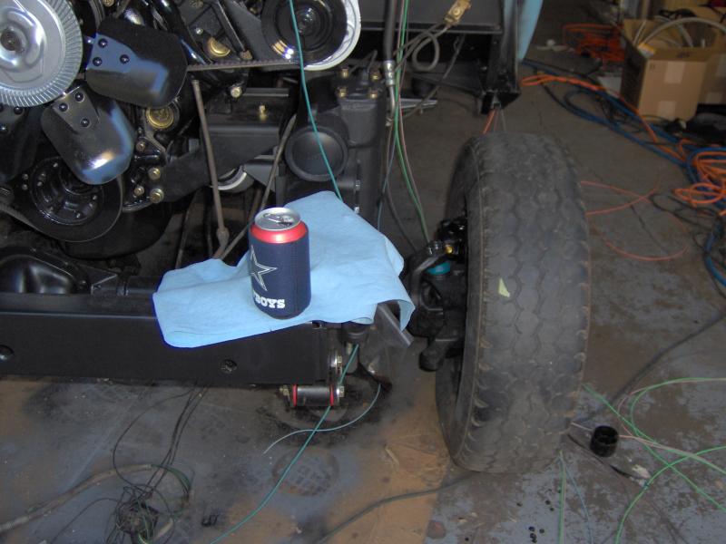

Man I can't stand these cell phone pics.
Ahh forgot about the emission stuff. Here in rural Colorado our national past time is make it louder. Looks clean though. Bet it gives it a nice throaty sound. One good lookin Scout.
So basically since he didnt do mandrel bends you're still gonna get that restricted flow instead of that nice reduced backpressure. Bummer
