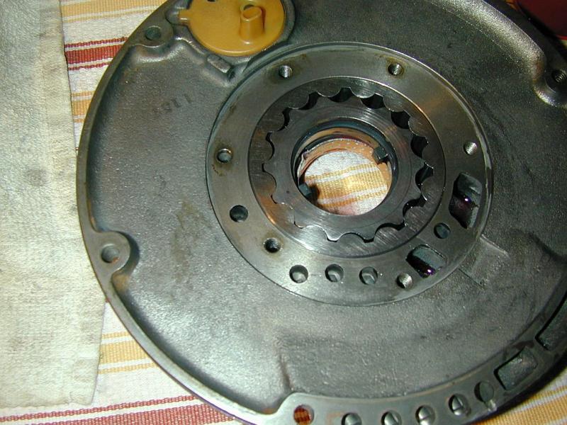

Here's a shot of what we be talkin'.

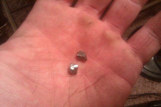

Good to know I'm not the only one. It's just damn embarrassing considering I just put this transmission in last fall and I spent almost an hour just making sure those tangs were lined up and that the t.c. Was mounted perfectly... Like I said, just too big of a hurry I guess.

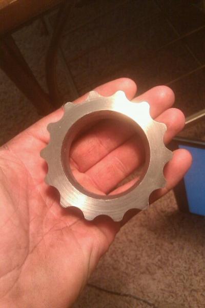

In case you're wondering what the problem is, here's a picture of the rotor I pulled out... Compare it to the picture that mm just posted and weep with me.
So the rotor just came in the mail and it's all back together but I'm having a helluva time getting the tc on all the way. It's making me feel a bit better.
One thing has crossed my mind several times and before I put this thing back in I would like to know what you think about the little tiny bits of metal floating around in my transmission now... Should I run it and then change the filter right away? Should I break down the tranny more and get it as clean as I can? I'd rather deal with making sure it's bulletproof now than getting 10 k on my new transmission and then having it fail! Or are the little bits of metal ok and are just gonna be filtered out?
Whatcha think?

Ben and I discussed his findings by phone, in essence, once he cleaned out the oil pump cavity and removed some tiny metal chips, the whole pump assembly rotated just fine.
It' always possible that some pump rotor debris made it's way through the system, but will be handled through "drop-out" in the pan and filter. The tranny should be serviced once the fresh motor is broken in and the bands re-adjusted, then the rig should be a dd!

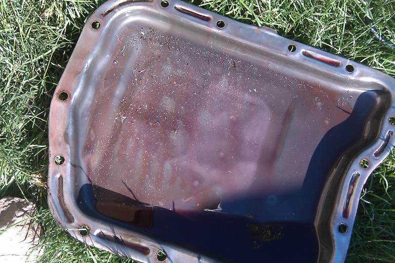

So my new deep pan came in today and I just dropped my old one... Kinda scary what's in there. The picture is not super clear but there are a lot of shavings. I'm pretty worried that running my engine at 2000 rpm for 20-30 minutes with a busted oil pump May have ruined the bands. I'm waiting on a torque wrench to come in tomorrow but just hand tight the kickdown band went in about 2-1/2 to 3 turns... Tell me what you guys think. If this goes much further then maybe I'll start a new thread titled "what happens when you eff up your trans oil pump during an engine break in." :incazzato:

That guapo in the trans pan is not a real problem ben. I've seen far, far worse on units badly abused and neglected. What you see there is kinda "normal" actually. The filter did it's job! Just change it out for a new one.

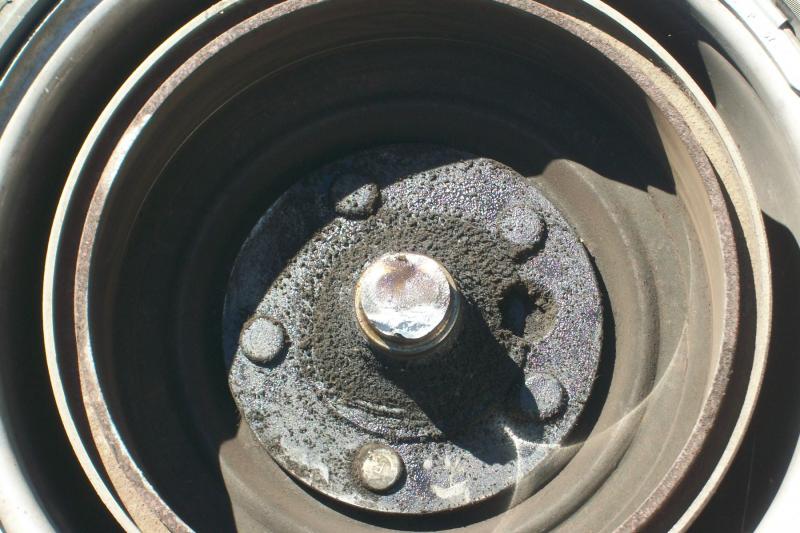

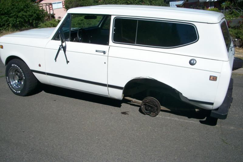

Long story short, this thing has more power than my old engine, and so I gunned it going up a small hill and what happens??? Bye bye drivers side rear axle. Sheared it clean. Amazingly I caught this on film. So here's some pictures, and I will post a link on youtube when I have a minute. I was gonna tackle the steering next but I guess I'll be doing axles first. Anyone have a good set of Scout II Dana 44's?
I don't know if you can tell or not, but the axle was already cracked and was only holding on by about 1/4 of it's original thickness.

My opinion...that truck had an encounter sliding sideways with a curb at some point in the past! Prolly tore hell out of a wheel/tire and was replaced but they did not replace the axle shaft itself. That fresh motor didn't tweek that axle, it was already scruud! Or...it's possible axle bearing set was fried in the past and grossly overheated, that can damage the axle itself, they May have just pressed on a replacement bearing/seal.
