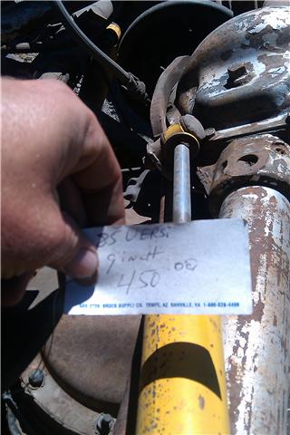

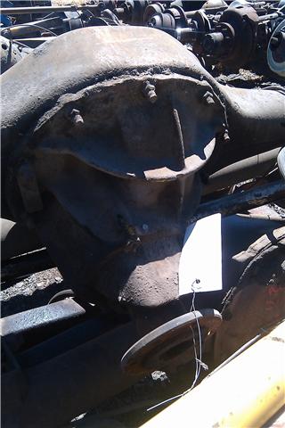

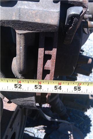

Ok tell me what you think of this? I think it would work for an SOA but it's 5 on a 4.5 bolt pattern, I think that's Jeep and Ford? This looks like an axle that I saw in one of dcextremes builds a while back. It already has disc breaks. The guys at the yard said he'd give it to me for 300 including the driveline, which seems like it's in good condition. I think it's a Ford 9".
The measurement is center of rotor to center of rotor.

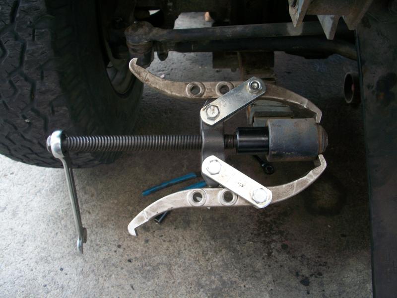

I was wanting to update you all on the status of the build. It's going well! I ordered up some tie rod ends and new spring bushings and got them installed tonight. What a difference in the ride!! I wanted to share how I removed the old bushings since I have heard of people torching, cuting, sawsalling, and driving them out with air hammers...
I used my large pulley puller and a 7/8" socket with my 3/8"x1/2" adapter inside of it to center my puller. I just pressed the bushings out and then popped my socket out with a hammer and driver.
Here's a picture if you aren't getting it.
It made this job take about 3 hours.
