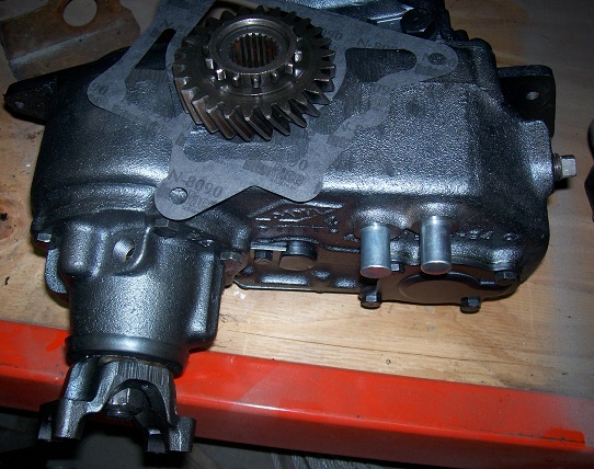

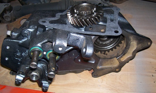

Just finished up rebuilding the d-20 transfer case a few days ago. All new bearings and seals, along with eliminating the two shifter rail pills for twin stick conversion. Currently stored on the shelf till I actually get to putting the 727 auto trans back together. Other financial obligations sort of preventing me from ordering the gear ratio change in the transmission. Once I get to putting the trans back together, I will tackle fabing up the two shifters for the t.c. Before I actually pieced the t.c. Together, I had a friend, who works for a powder coating company, take it to his work to cook and clean the t.c. Housing. Then he coated it with a zink coating of some sort to prevent rusting. Something they do on products like this to prevent rusting out from under the paint. I didn't find a need to actually get this one powder coated. It wont be a show rig, so I just rattle canned it before I stored it up on the shelf
attachment.php
attachment.php

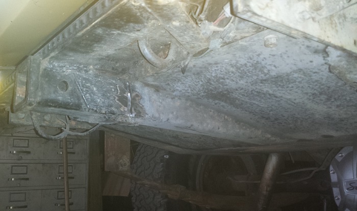

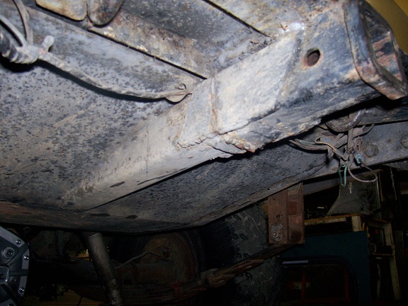

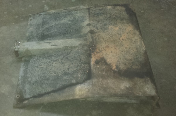

Sigh!!!. Got bit by the po bug. I'm about to beat these guys over the head with the fugly stick. Turns out that I needed to drop the fuel tank due to not getting fuel to the new fuel pump I just replaced last weekend. The sending unit pick up tube is plugged up.
But, in order to drop the tank, I end up having to deal with the po virus. The hitch welded to both the rear bumper and tank skid plate. What were these knuckle heads thinking? Got their heads up their butts.

If the po kept this Scout, I guess he never planned on dropping the tank to service the sending unit or the tank itself.:rolleyes5:

Sheeyit kimball...that's a pyur dee dam faktree traylur draggin' pakidge! That there was a Dad burned hi dollar opshun wut had to be checkd of'n the ordur sheet at purchus tyme. Dubble check yer daggum line set ticket and then tell me I'm full of it.:icon_razz:
it would be very difficult to convict the average po of being a long-term thinker in any court of law. That fine example of redneck injinooitee was born of necessity and zero budget. Whoever did it probably figured the rig would wind up in the scrap yard well before the tank ever needed to be dropped for any reason.
Gotta luv them chew chompen bubble gum welden gun slingers.
Pulled the tank with crusty hoses along with duct tape holding vent tube in place :incazzato::icon_rolleyes:
surprisingly, the sending unit looked to be in good shape. But since the one vent tube on top of the tank is completely broken free, I will be swapping tanks with a known good tank that I've got laying around.

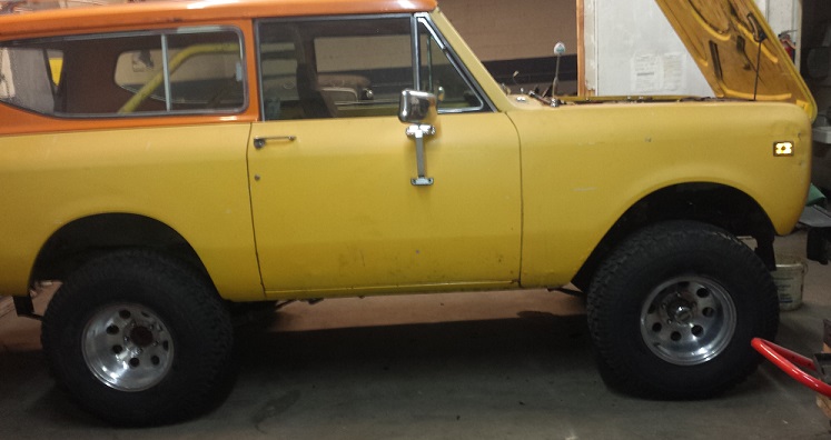

Finally, after clearing out the front half of my cave and finishing up the u-bolt, spring plates and leaf spring bushings for the front end, I was able to actually drive ole' yeller out and drive up & down the street. First time, since I have had this rig, that it's been able to have forward motion on its own power. The spare used transmission seems ok for the moment. The true test, for when I get it insured and registered off non-op, is to actually drive it around town.

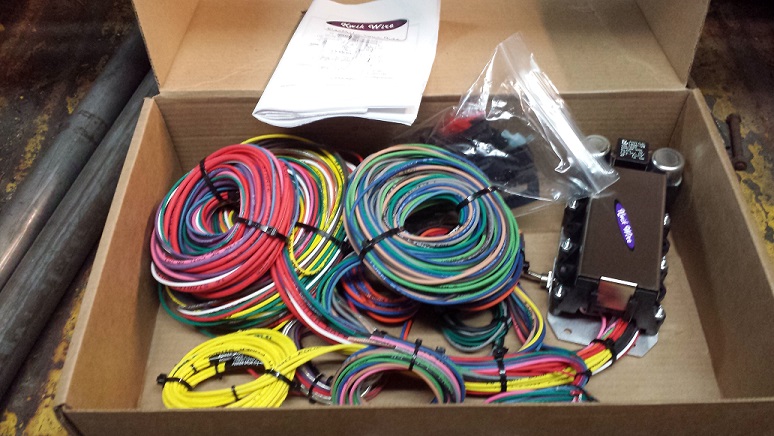

But, ever since I have had this rig, at least one of the problematic bulkhead connectors has been falling apart and refuses to stay connected. Along with some po virus hack work. Plus, I feel that replacing the 43 year old oem wiring is looking better all the time.

Thank you for the links and heads up. If my current oem wiring was in decent shape, and had atc blade style fuses, I would have considered just upgrading to the delphi style weatherpack bulkhead connector.
I have done a few complete re-wires over the years, including one with the kwik wire 14 circuit on a 69 Scout 800. And have incorporated some weatherpack connectors in several areas, depending on application.

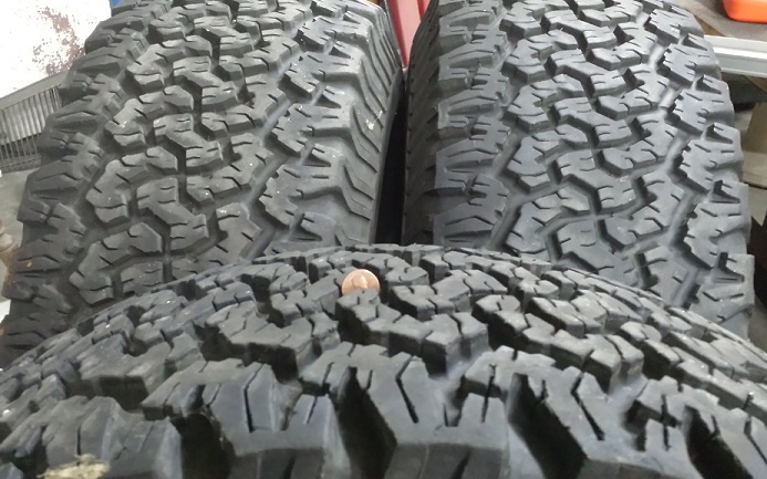

After spending the last few months, or so, of working on other members rigs, I'm finally getting a chance to get back to working on my own Scout/s. Part of the trade off of working on another person's Scout is swapping for parts or supplies. Thanks to silverscout, 'ole yeller' is getting new shoes. When I first got this Scout, it had two pairs of un-matching donuts, along with one having a plug in the inner side, wall causing a slow leak. Yesterday, I spent a better part of the day doing some tire/rim swapping. The rims ole yeller is sporting now came off an old '90 Bronco that I had 10 years ago.

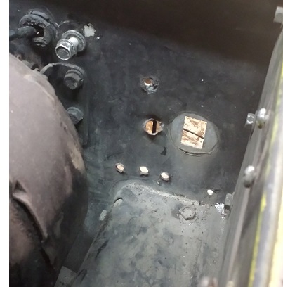

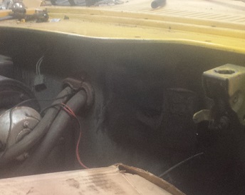

Finally spent most of this weekend gutting the old wiring and mounting new fuse box/wire harness. Also patched up the old holes left behind. Along with plugging up a few po hacked hole that wasn't needed.
Old holes:
Patched up:
Mounted fuse block onto the firewall under the dash. Just between the e-brake and other pedals. Saga continues next weekend when I have a 4 day weekend. Unless a side job gets in the way
