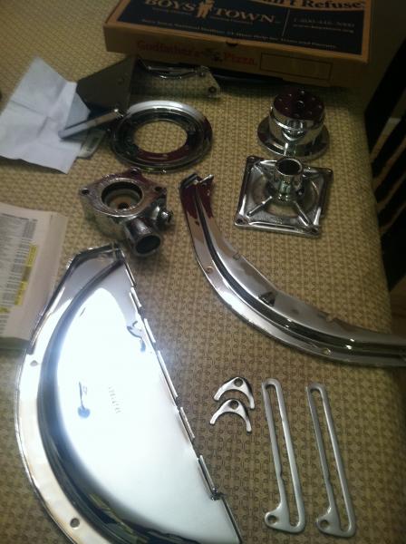

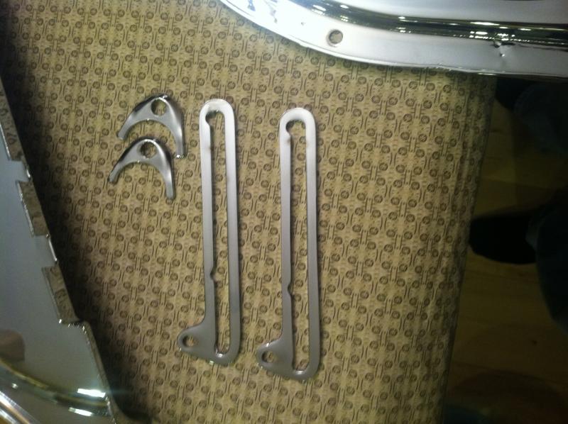

c'mon jetfxr, you only gave 3 minutes to be able to answer the q- I knew what they were when I saw them, but only because I own a 36 that had them on it. :thumbsup: what did you find for the t bolts/thumb screws to cinch them down? I had to create my own, but they arent correct- just functional.
Are you going to chrome the windshield frame? My friend has a 34 c-30 that had a chrome frame originally. It is beyond cool, but needs a complete restoration.
Great looking parts by the way. Wish I had duplicates of all of them...

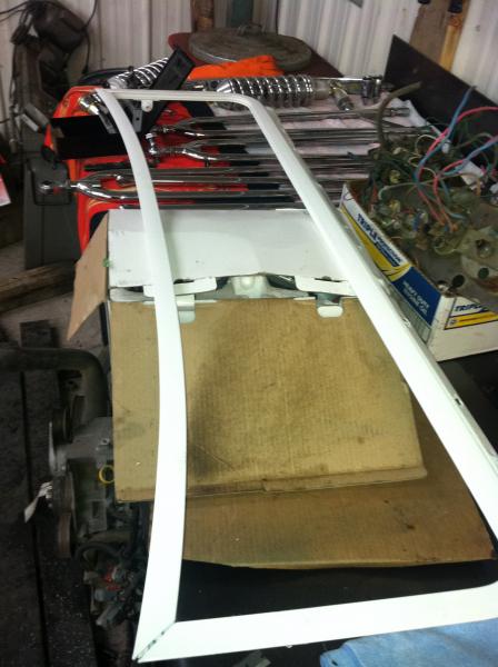

Here's the window frame, I will be dropping it off to have a glass fitted next week. I am also waiting for the seat to come back from upholstery so I can get it all fitted up before the cab goes to paint.
