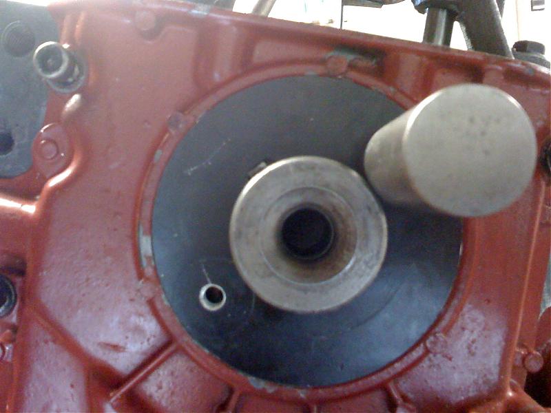

The rear main cap parting line is a possible source of leakage, so a very thin coat on a non hardening sealer ( aviation ptex) just before assembly. See picture.the red box is the location on both sides.

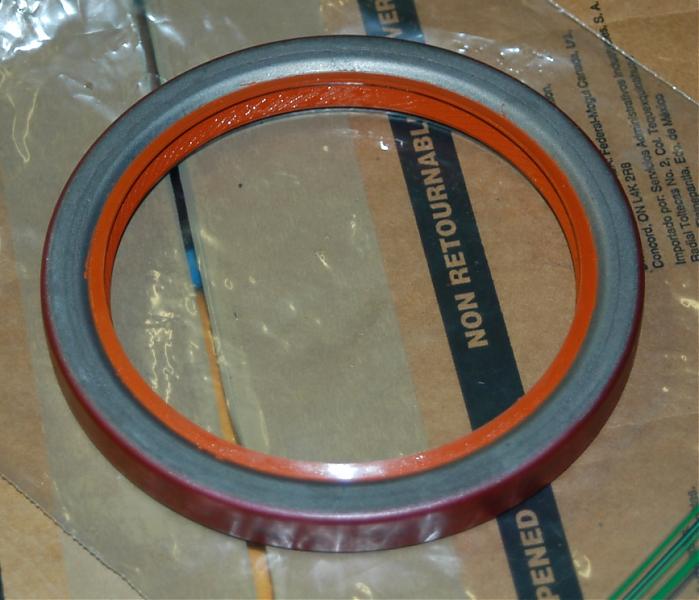

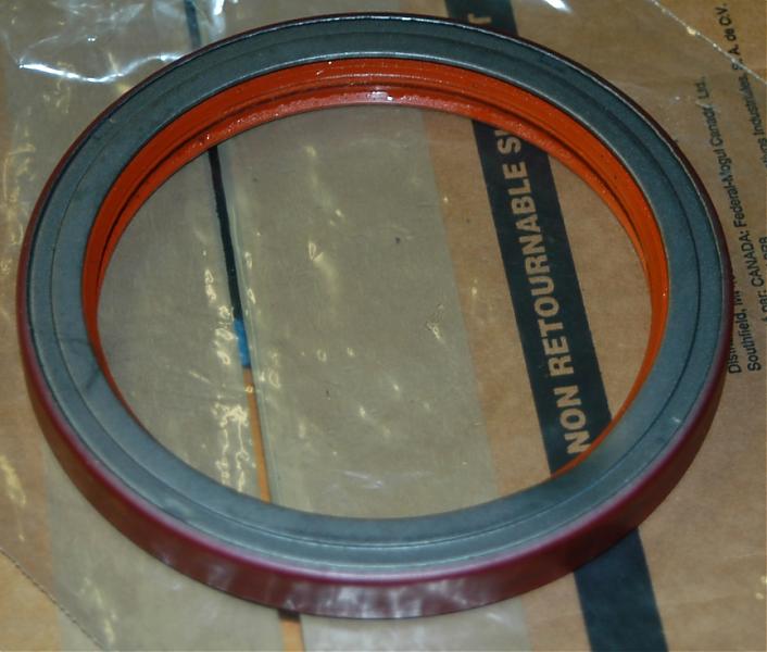

I want to make sure I get the rear main in correctly. Can you guys tell from these pics which way is out? I'm thinking pic #1 is the out facing side. Does that look right? I'm mostly going by the seam in the metal on the other side.
Notice the dent? I almost didn't spot it.

In your first picture, the visible side goes out.
Needs to be pressed in after the rear main cap is torqued. Don't install and then tighten the main cap. I mention this because the paint and pinched metal shavings will end up between the cap anc block causing screw up main bearing clearances. Seen it happen.
Another hint. Just barely get is started being pressed in and using a smooth pin or pick run the pick between the crank and seal lip so you car be sure it doesn't get bound and damaged while driving it in. Easier to show than explain. Sorry
