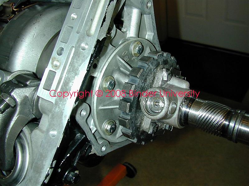

To service a governor, the transfer case and tailhousing must be removed.
The governor is then dissembled and removed. It must be treated when being serviced with surgical cleanliness!
If it's "stuck" that is because microscopic debris is circulating in the hydraulic circuits, same thing that sticks the other spools in the valve body.
When the governor is removed, there will be two "piston rings" on the support, those need to be replaced also. Along with the gasket between the tailhousing and the case, and the gasket between the tailhousing and the transfer case. And while the tailhousing is off, replace the two seals behind the bull gear.
When replacing the governor, all components must be lubricated with a lube designed for that application, that does not mean ya use atf to lubricate the components.
If the output shaft bearing behind the bull gear needs to be replaced, there is only one source for the correct bearing...that is here at ihon.
Here is a pic of the governor which also contains the parking stop.
I'd highly advise you find a copy of the munroe torqueflite bible before attempting a governor service.

I pulled the pan again on Monday and sure enough the pressure valve was not correctly positioned, once I adjusted that then everything went back to normal, I have all the gears that I should and the rig is runnning good.
Good deal jon! Ya stuck with it, found the problem and now yore a happeecamper! I'm so glad ya didn't rip into the gvvernor...we'd never heard the end of that!
