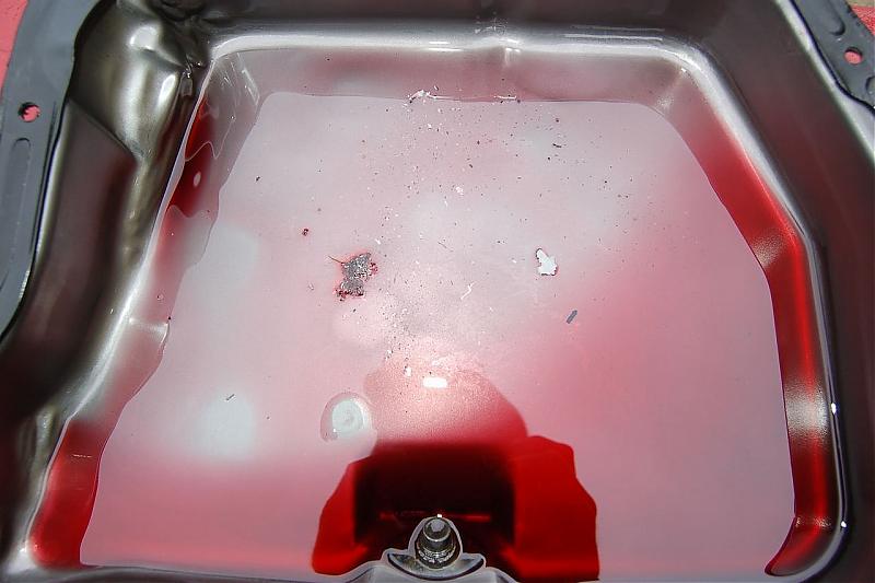

Since major screwup and monte started this whole slushbox tranny maintenance deal, let's see what's inside of a unit approximately 3,000 miles after a major overhaul.
This is mobinder's hybrid tranny, a very early 727 (circa 1963) tf 727 converted to Scout II innards and installed behind a chrysler 383 inna Scout traveler. That would be the "holstein" tranny I refer to in the pics. And this is terry's pic so I won't take credit for it, he did the tranny service operation at this point after setting up a really nice cable-controlled kickdown system of his own design!!!
Iirc this was the pan at about 3,000 miles of service after the overhaul. This tranny was meticulously cleaned internally during the repair phase after catastrophic internal failure resulting from a previous rebuild done by a "pro". And the valve body was converted with a tf-2 kit as well as several internal components replaced. Most noticeably a "bolt-in" overrunning clutch assembly. And the torque converter was replaced with a reman unit at the time of installation also, since this is an early 727, the input shaft is different from later versions and torque converter for these can be difficult to come by.
What ya see in this pan (a chrysler/mopar accessory item) is perfectly normal! The larger "flake" of aluminum is most likely sluff from a planetary carrier, a piece of casting flash. This kinda stuff is shed continuously in any autotrans, that's why they have filters that should be serviced! This the stuff in the sump of the pan, and it stays right where ya see it, causing no issues whatsoever!
This is exactly what one would expect to see onna tranny after 5,000 miles of service onna rebuild.
This tranny has a high flow brass filter screen supplied by transgo and is renewable by washing in solvent.

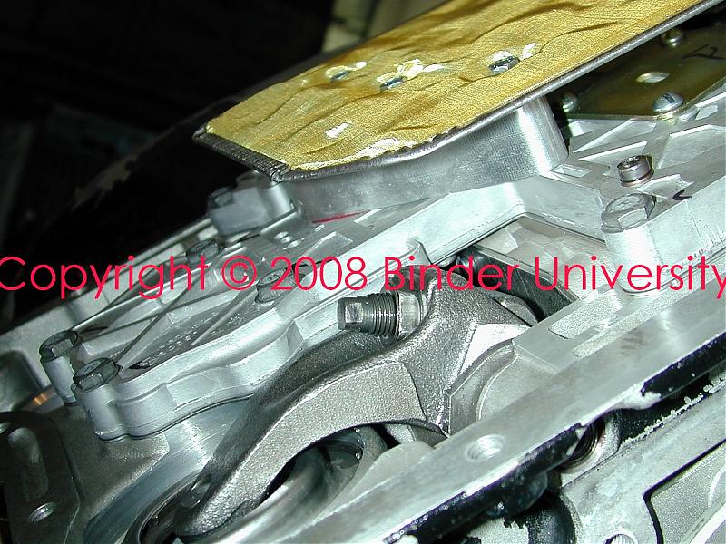

Here's shot of mobinder's transgo brass filter screen with the billet spacer supplied with the mopar deep sump pan. A very nice piece!

I've received several calls and emails regarding the "type" of kickdown control I previously mentioned...the "full throttle kickdown" system vs. The "part throttle kickdown" system.
More than a few folks think their tranny is "broke" because the kickdown system doesn't work as they think it's supposed to. Again...because ihc did not fully explain the differences in various t-407 transmission designs in appropriate service manual sections over the years, there is really no way to understand "what" is supposed to happen and how to service it just by depending upon those references. The cts 2313 ('78 and later sii) manual is the worst offender, while it does contain two complete service segments regarding the tranny variations, they did not point out the differences and in fact actually mixed up and transposed the illustrations so that no sense can be made of the valve body variations!! And the parts lists for the variations likewise do not contain definitive illustrations...just "frame number cuts" that mean nothing to a hobbyist/non-pro mechanic.
The most common kickdown system found in IH apps is the "full throttle" control. What that really means is that if the system linkage is correctly adjusted along with the throttle cable/rod, the loud pedal must be depressed near wot in order to "command" the tranny to shift back to second gear from direct/high gear at road speeds under say 60mph. And that is all dependent upon having the oem gearing and tire size!
That full throttle kickdown will occur at varying points, I'm just throwing out a "general" scenario, every vehicle is gonna behave a bit differently. And this information is only pertinent to a tf 727 (or a tf 904), it has nothing to due with a 700r4, a th350, a c6, a bw 11, etc. These trannys each have their own variation of how kickdown is controlled, ya can make no comparisons amongst all these boxes! And after 1973 or so production...the "emissions thang" reared it's head and many of the kickdown scenarios changed for all oem manufacturers.

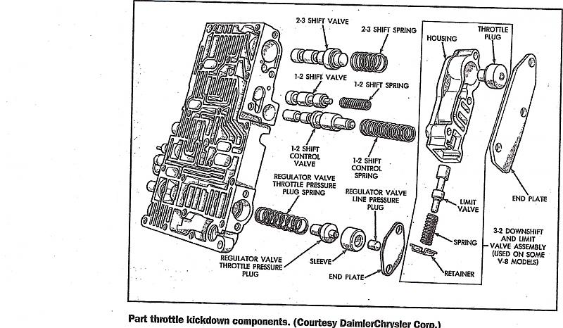

The "part throttle kickdown" module was added to the 727 valve body by chrysler beginning sometime in 1974. But not all oem customers received that setup, not all trannys received that setup, and it May have been somewhat randomly applied over the years.
What this means is that kickdown will occur at a lower road speed/engine load/throttle plate angle without having to floor the loud pedal. That serves to keep the tranny ratios more closely matched to engine load (primarily an emissions deal) and also reduced "hunting" of the up/down shift points under light throttle application. This would have been particularly noticeable onna Scout II due to it's extremely "heavy" stance vs. Engine output, one more reason why performance of those rigs is considered kinda sluggish when compared to similar vehicles with a much lower curb weight.
The only way to determine which valve body your tranny May contain...is to drop the pan and look!
If...you have adjusted the kickdown linkage correctly (and that will vary somewhat by platform and model year), and it still will only kickdown say at 48mph when ya floor the pedal, then ya gotta "full throttle kickdown" system. By far the most common found in IH stuff.
The valve body I posted in a previous post shows a full throttle kickdown system, with no "add-on" module mounted.
I don't currently have a part throttle kickdown valve body to take some pics of for illustrations. But here's some line art from carl munroe's definitive reference which shows the "part throttle kickdown" module added to the valve body as part of the governor control. That's the stuff in the bold outlined box to the right of the drawing.
