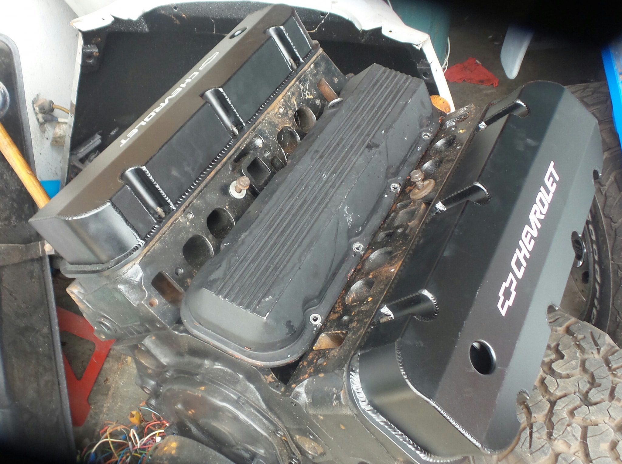

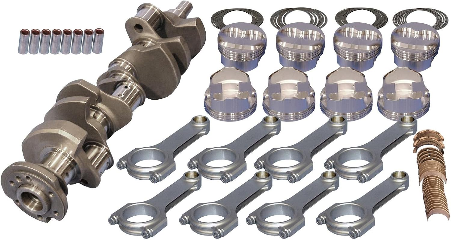

Been finding parts to build a 496 inch ...
The 781 heads will be seeing a bunch of work done on them (11/32" stems, OS valves, bronze guides) they will be used on this motor build ...
Also found a 4 bolt main block that's in a junkyard that's soon to be the foundation for the 496".
Most parts that's in the 454 will be going in this monster motor ..
Be awhile building it cause the stroker rotating assembly is up there in bucks ..
Must go after the block, hoping it's sound ...

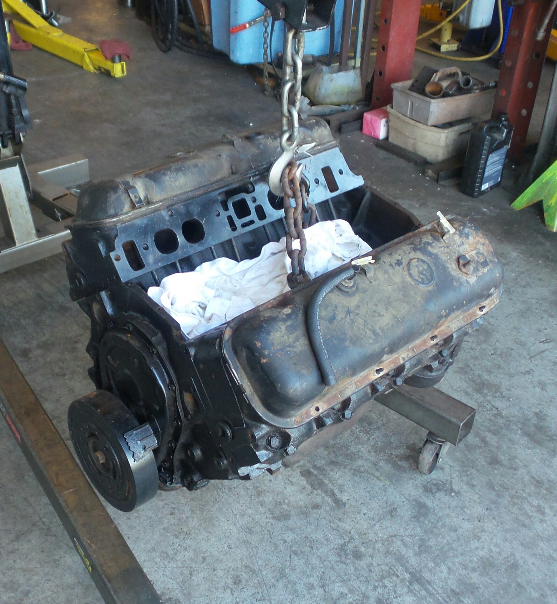

Whoa !!
Holy blowup piston, Batman ..
Don't look like the block was damaged from what I can see ..
Going to tear it down and wash it up for a super hard look at that hole ..

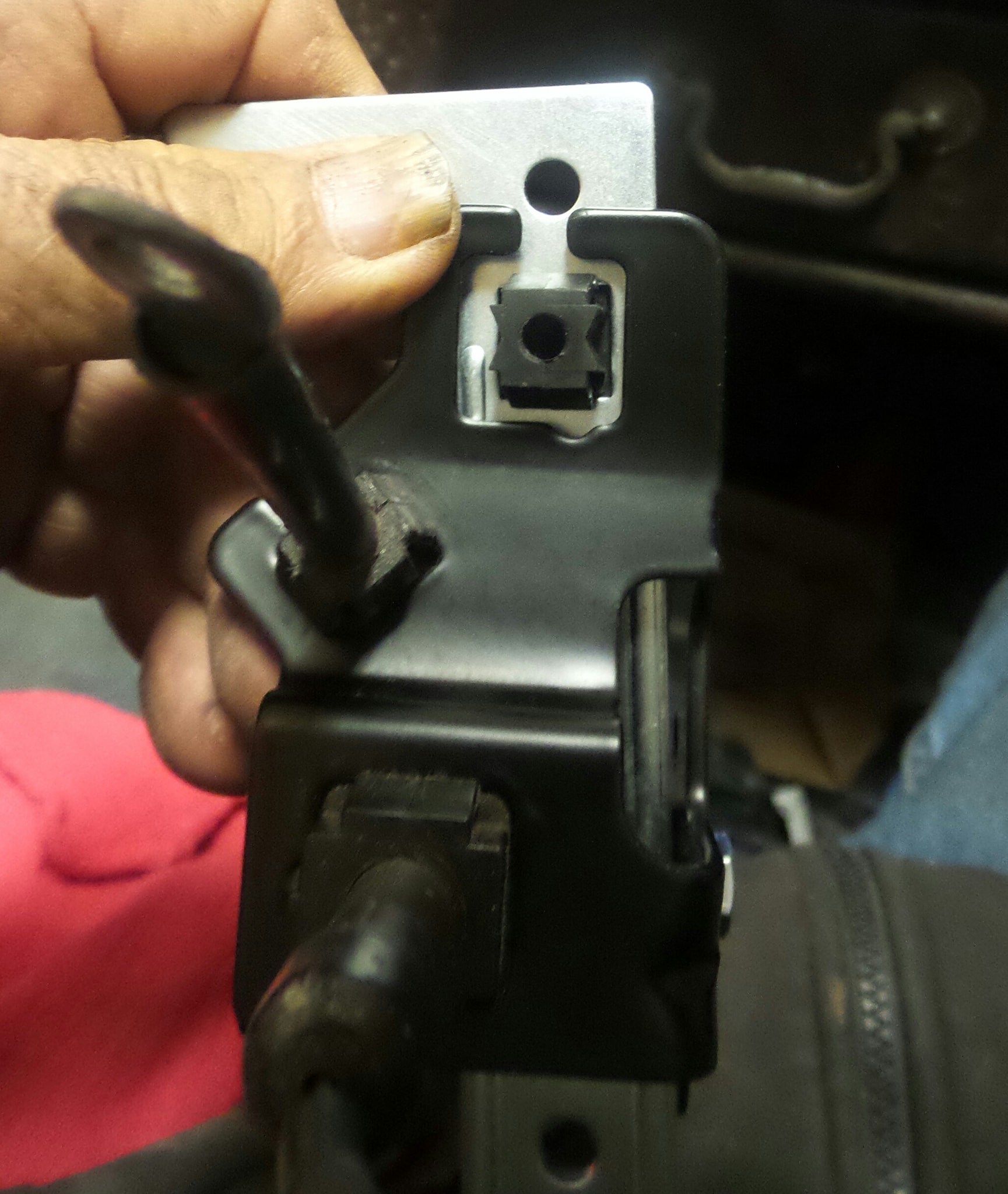

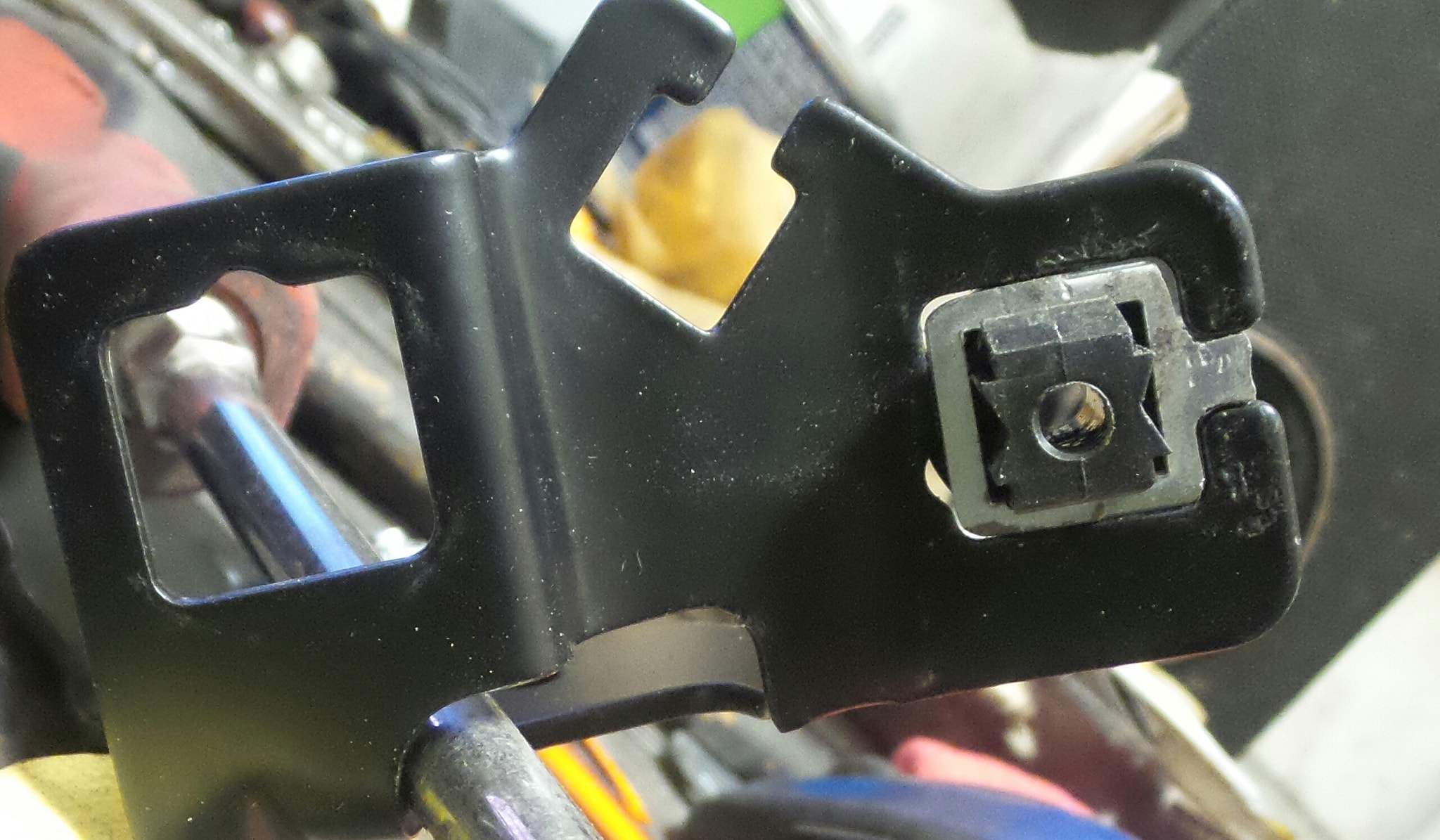

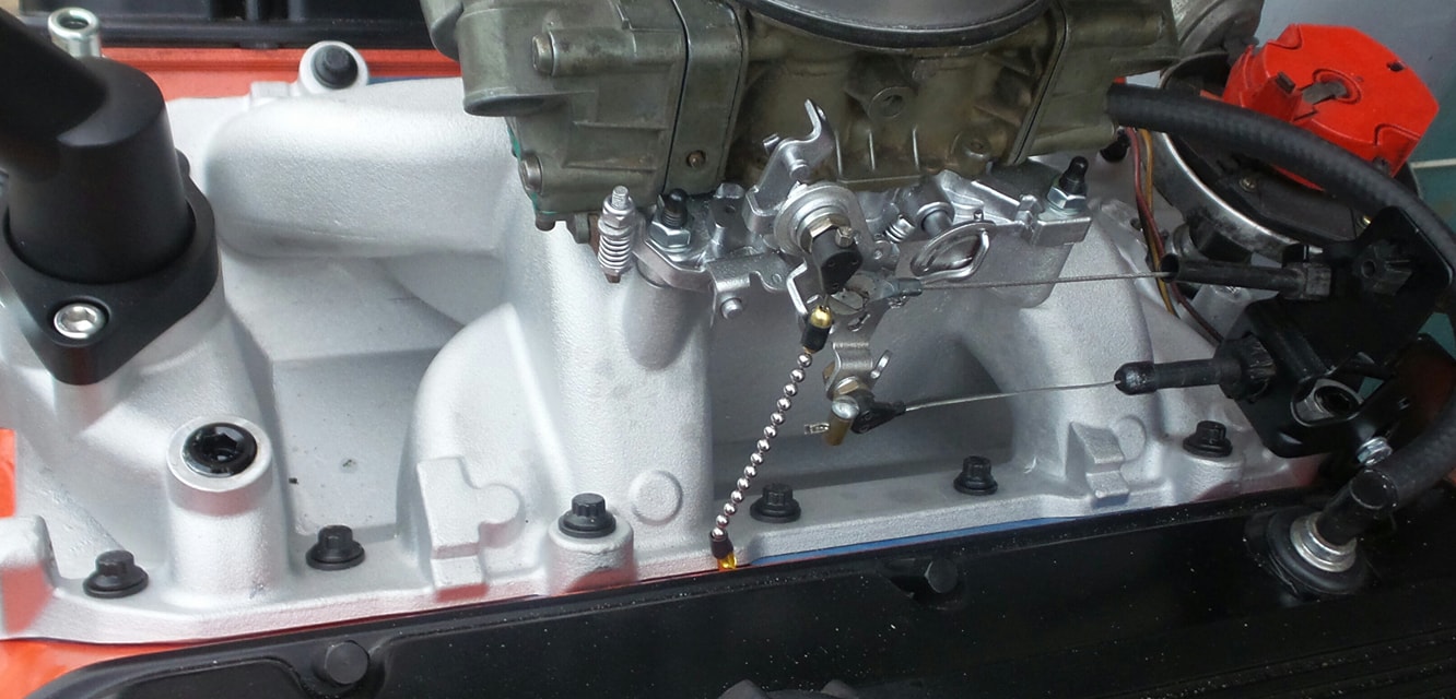

This return spring might work better than what I first had .. ?
Not all that sure it'll work better, but it sure does look better ..
Much cleaner look ...

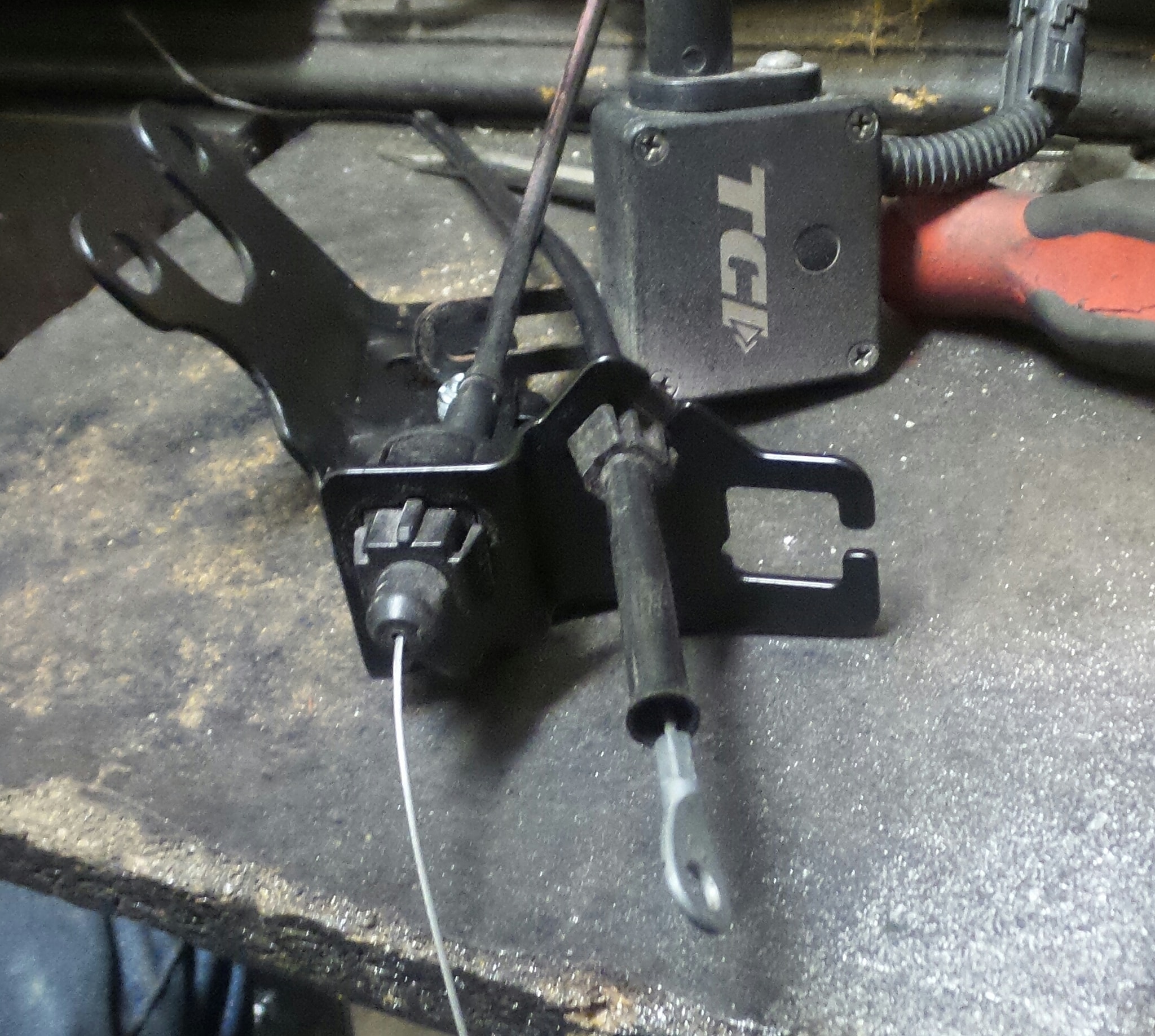

Found a great out of the way spot to mount TCI's TPS ...
Since the 4L85E transmission is electronic I had to get a stand alone control module ...
Got it tucked away inside the glovebox ..

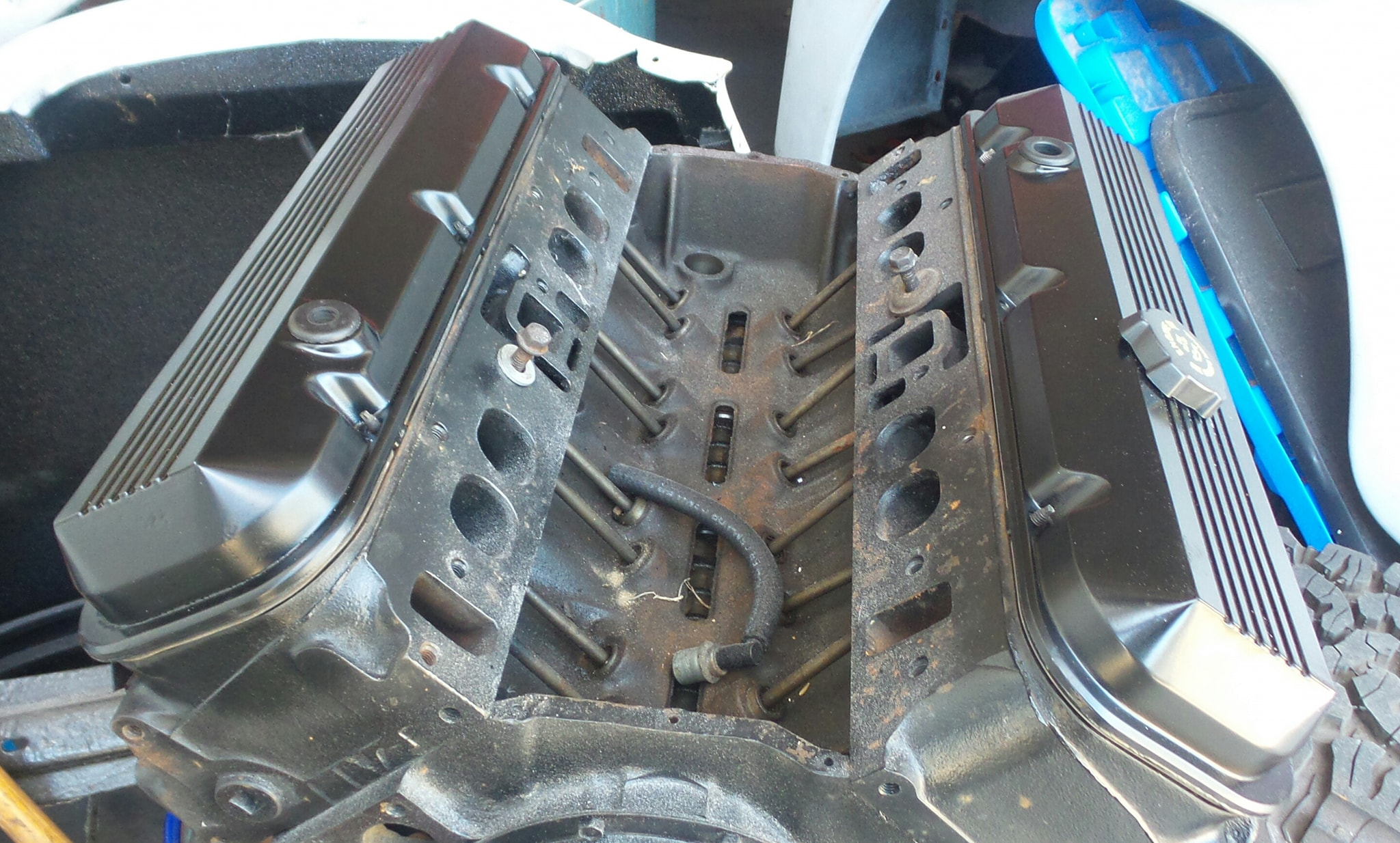

Somewhat of a chore to install a flanged sleeve ...
Most of the work was getting it out of the stand and on the floor ..
Now to get it back into the stand and bore all eight holes ...
Dressed in the sleeve to the block ..
Time to get it in the rollover stand and bore all eight holes ...
Going to 4.305" leaving .005" to hone to finish size 4.310"
That be .060" over the STD size of the 454 block (4.250")
Tis a bit of work to take out that last .005" from the bores ..

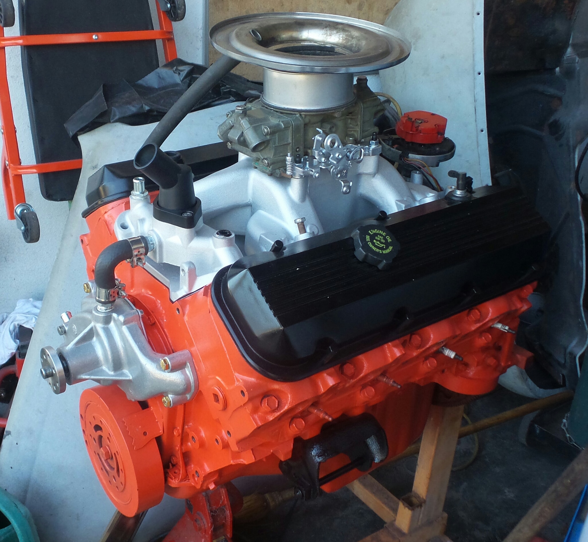

The 454 is close to going in the truck .. Lot of the parts it has will be used on the 496 ..

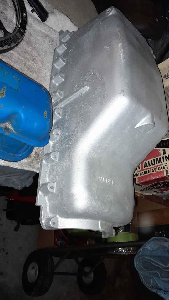

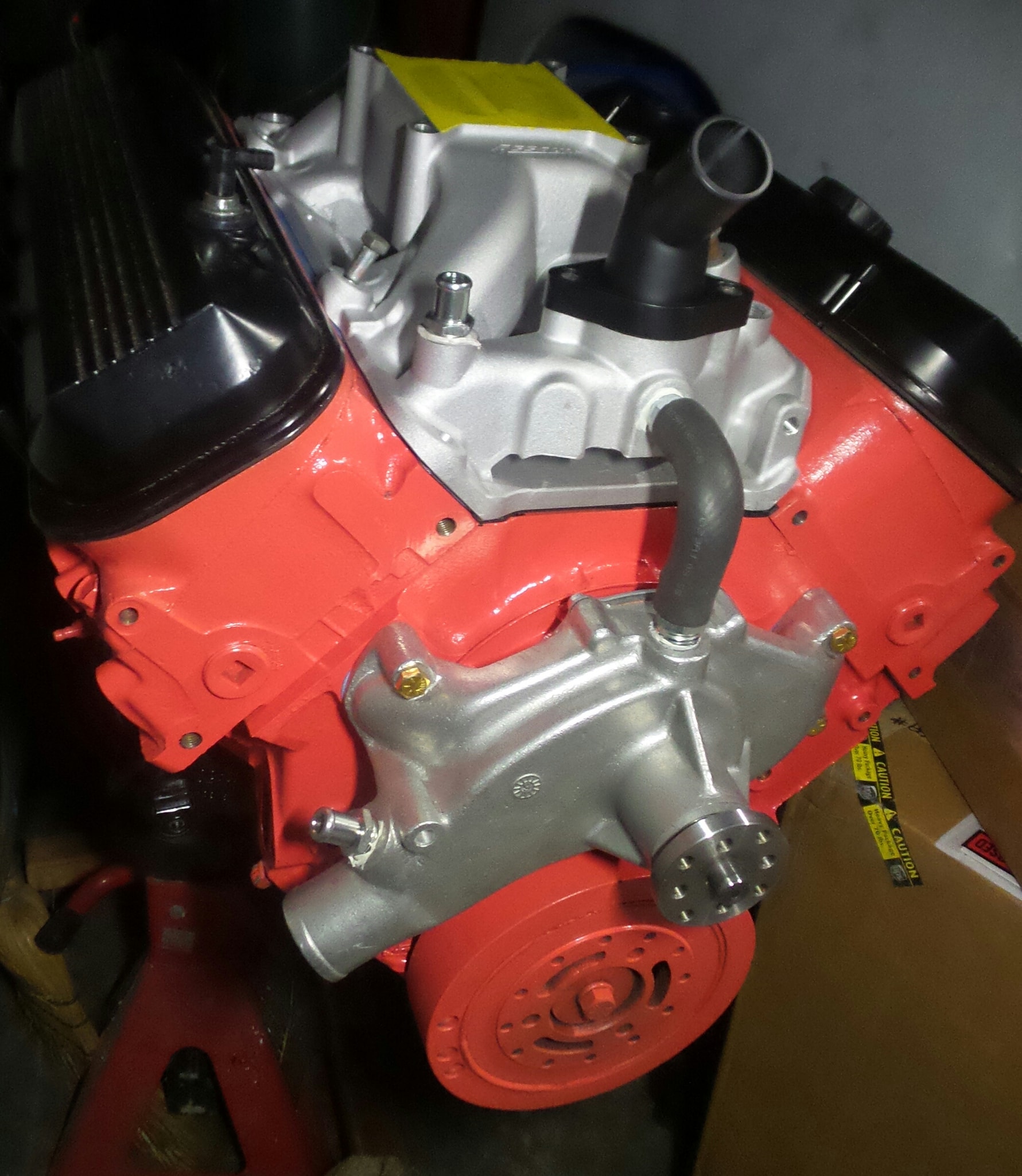

Installed a factory GM oil cooler adapter ..
Just in case engine heat becomes a problem ..
Hadn't got a cooler just yet ..
Do see a few spots to mount it in the wind ..
