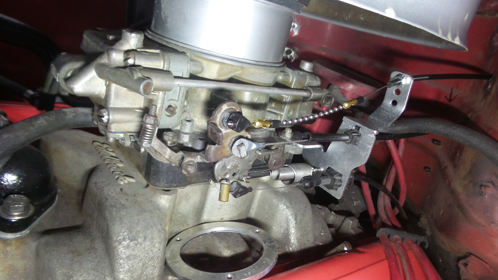

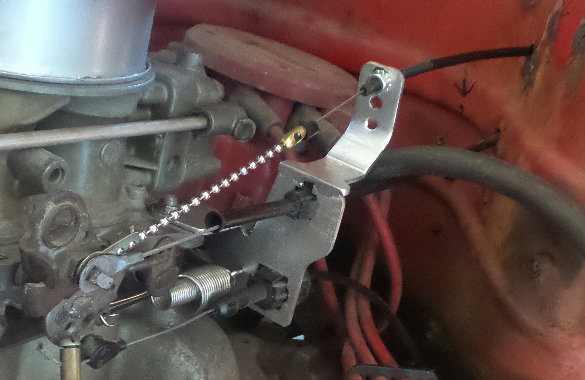

Three cables are in play, throttle, cruise and TPS ..
Found a aftermarket that got close ..
Cables worked out well ...

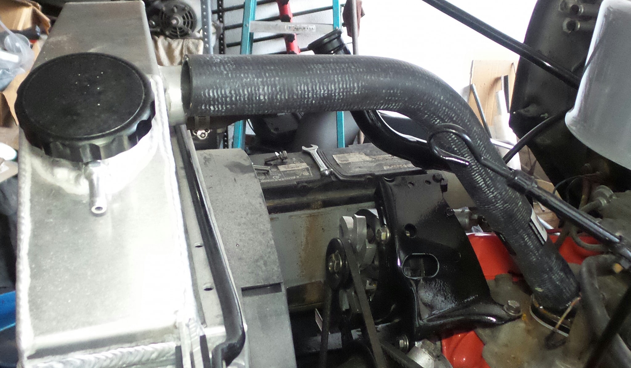

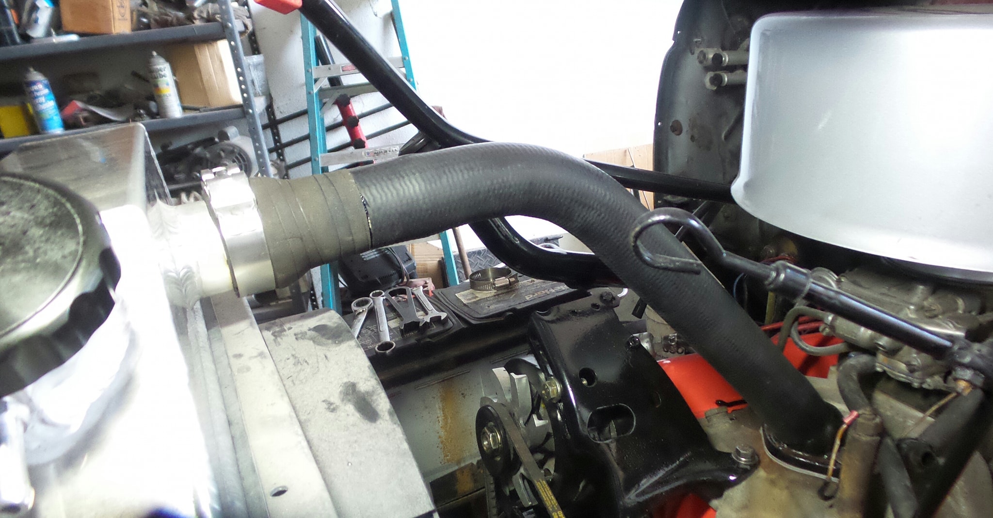

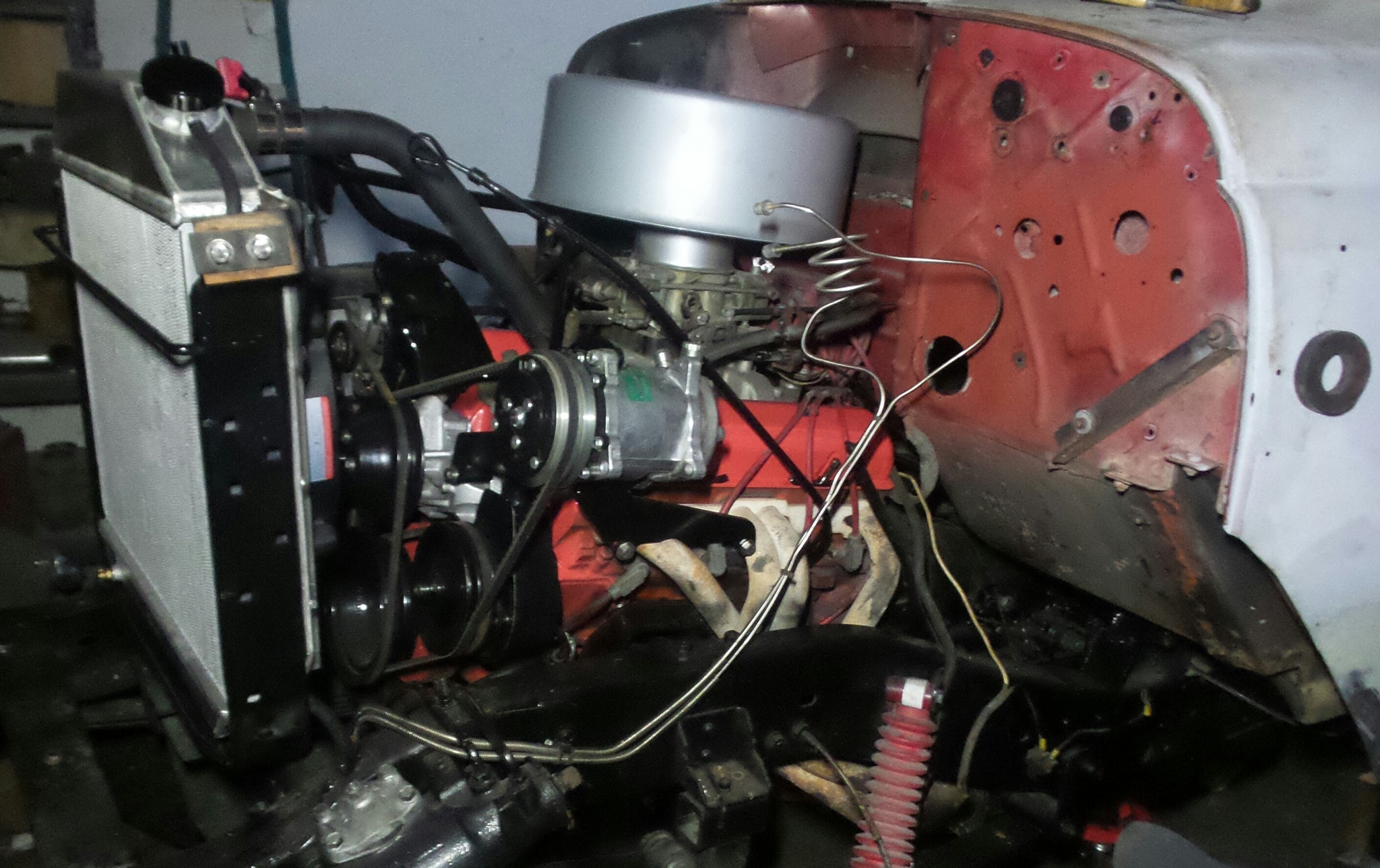

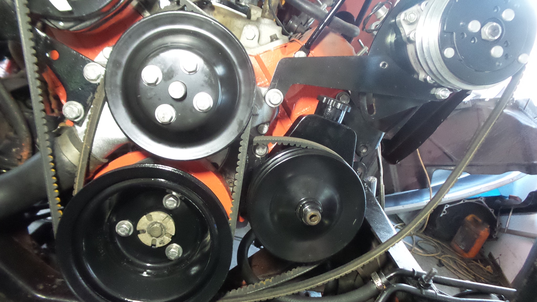

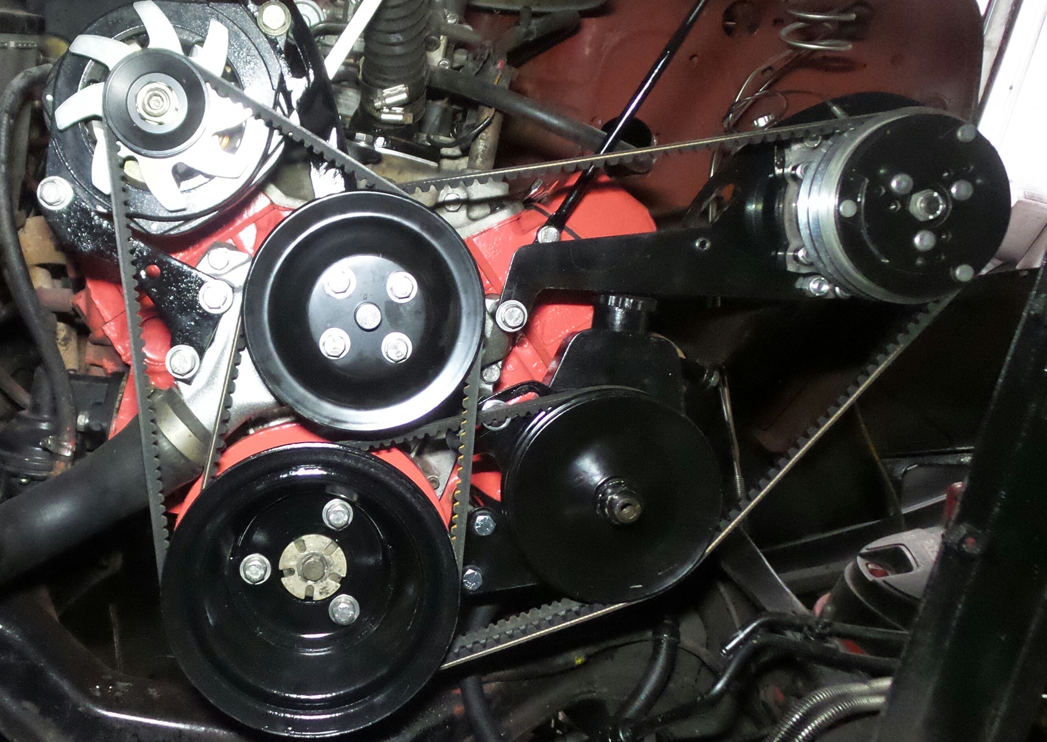

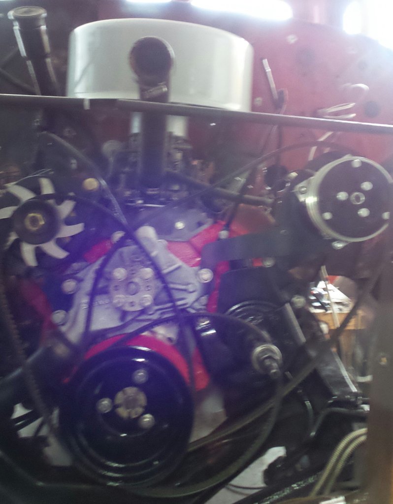

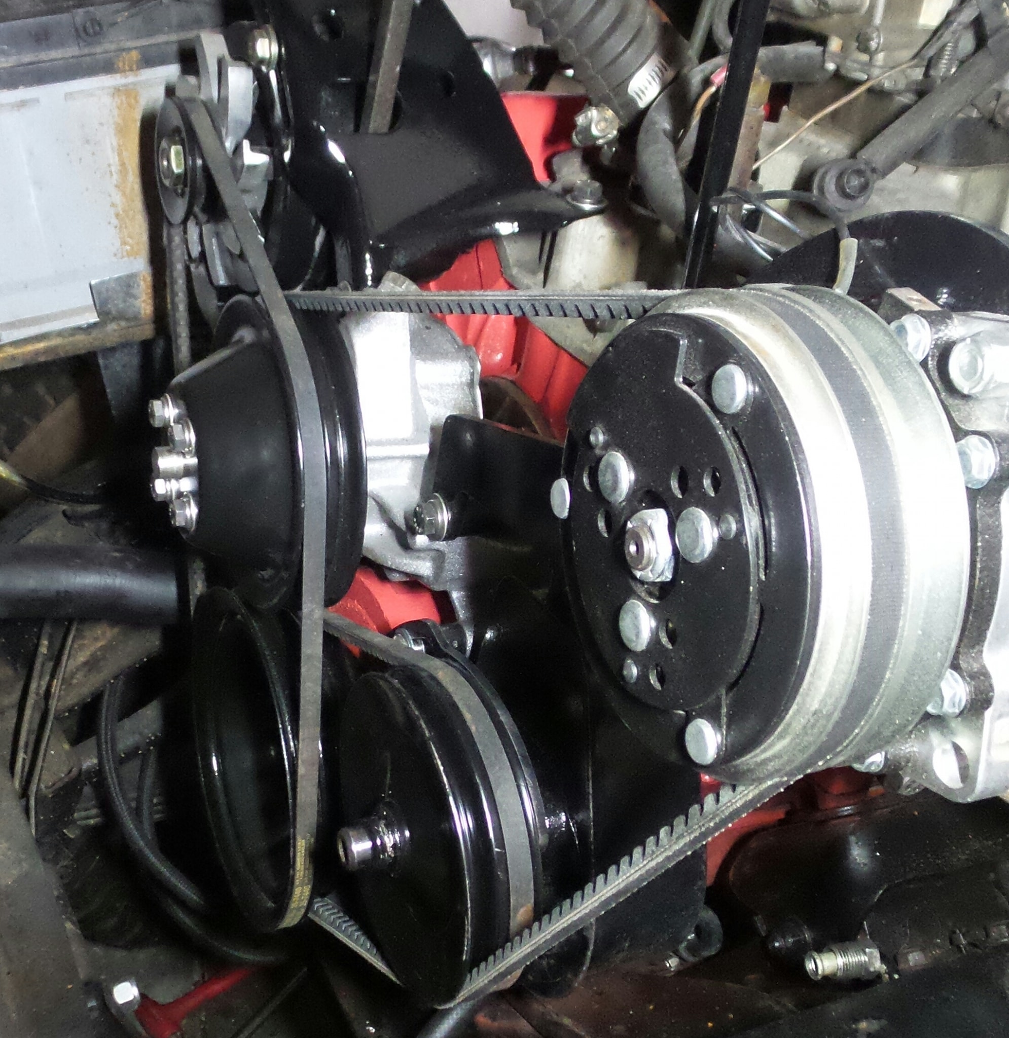

The GM alt bolted right up ...
I'm using a 200 amp Powerhouse aftermarket alt which has a bigger housing than the GM ...
Changed out the power steering pump ...
Cap is easier to get to ..

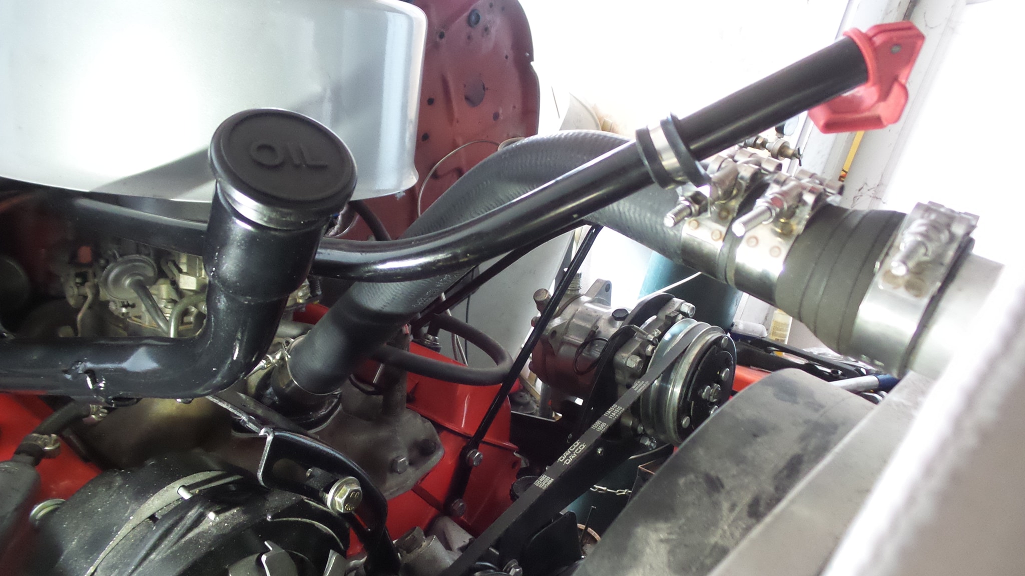

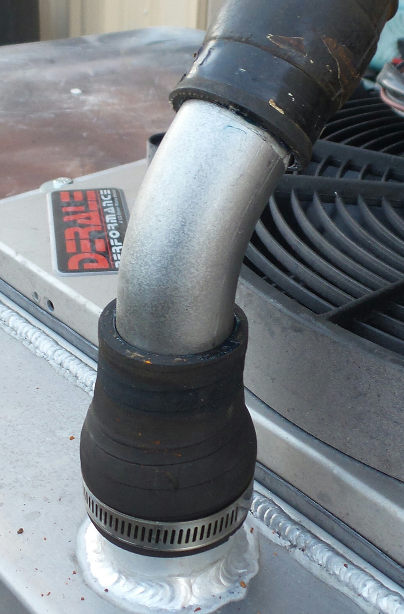

Had to rework the tube, way to sharp of a bend, added another bend in that area ..
That work out very well ..

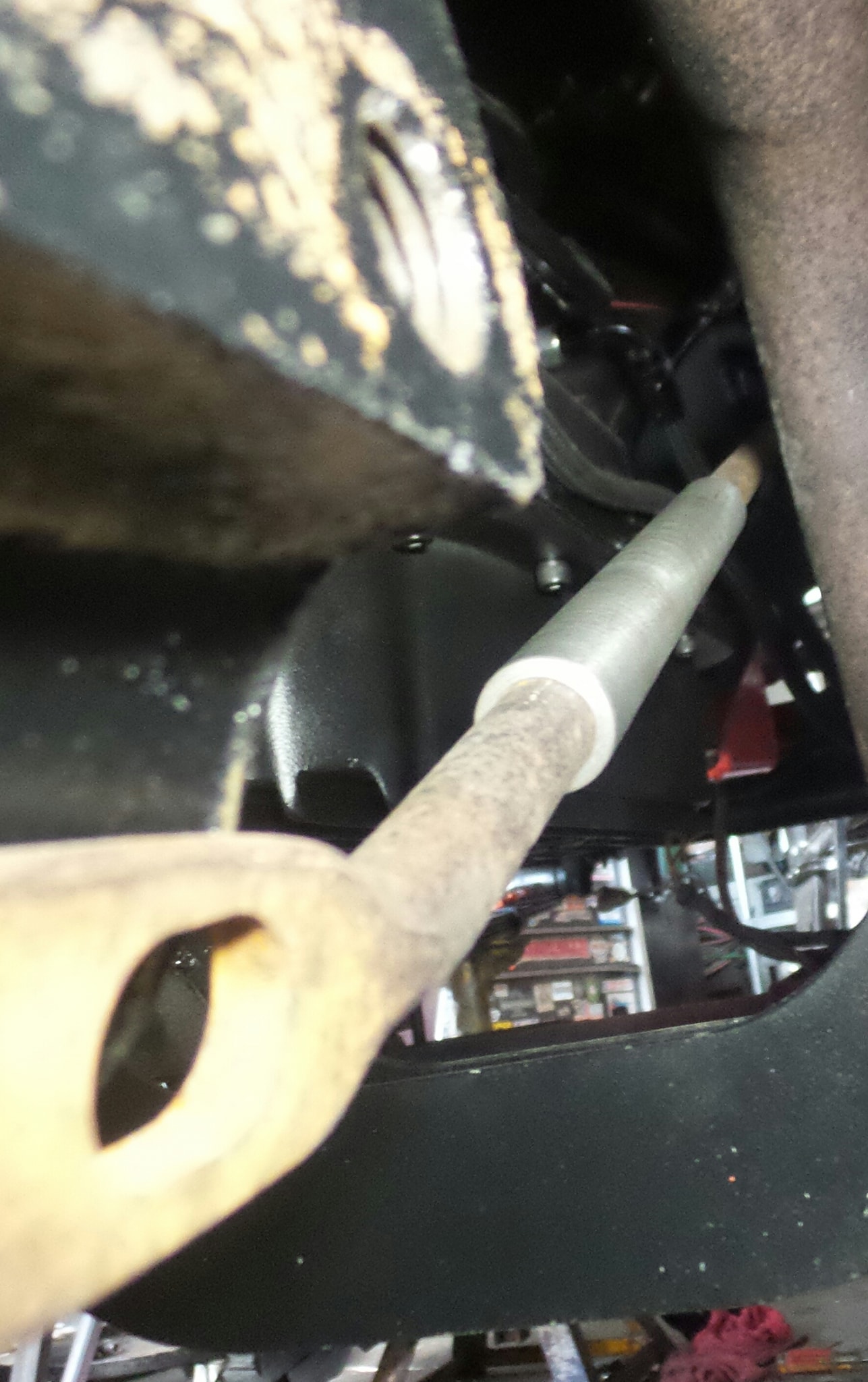

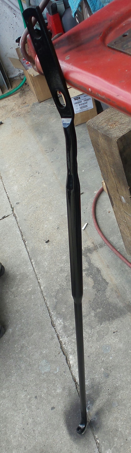

Next was to do the inner stick ..
Part stores had this uni ... It wasn't long enough ...
Found a fairly long stick for a Ford F350 ...
That got it in the ballpark, needed just a small amount of trimming to see the full level on the stick ...
Pan has 6 qts in it ...
Got real lucky finding that stick, for dang sure !!
