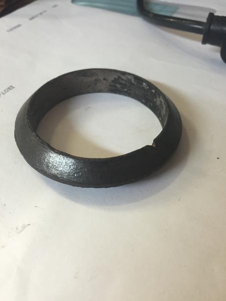

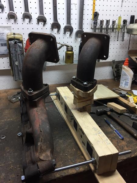

Shifting gears a little bit here...on a related matter, I'm working with a member of the bp board to make a mock up of the 3-bolt manifold and wedge so that he can fab a tubular header with a flange that will emulate the oem setup "in space" so that he can mount the 152t iron elbow, turbo, and intake elbow (carb adaptor). I have the wooden buck almost done - I'm no woodworker or pattern maker! - but am confident I will pull this off. The thorny issue is how to actually mount the elbow on the new header. The original, special metal donut is unobtanium but I have a chipped and cracked one that's allowed me to get the dimensions. From the pics you can see that it is symmetrical (either side can mount up or down), about a 2.1" bore, 2.640" od, 45 degree bevels, and 0.093" band between the two bevels. A while back at IHPA, they had an odd metal donut hanging on the rack. While not the same part, it had the same bore, general shape, and enough meat to machine down to produce at least the "upside" bevel. So I'm machining this thing to give an upside bevel and machine the down side for a shoulder. I'm recommending that the member have a matching bore in the outlet bore. This metal donut is fairly hard and has already dulled my cutter. Wonder what metal they cast these things from...

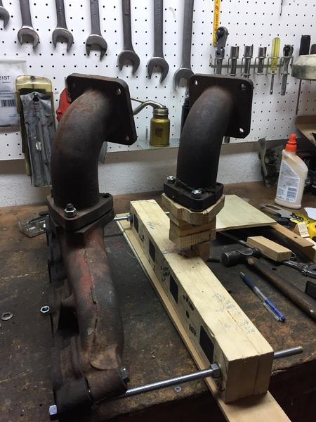

It's been a while since I've added any new information, mostly because of the never ending rain and cold weather here in the sierra foothills, and I don't have a suitable man-cave. The Scout is outside, uncovered. Attached is a picture of the wooden buck I put together for another member who is going to have an exhaust manifold fabbed using the orientations of the original 152t wedge and upturned 3-bolt manifold. He has the original iron elbow, turbo, and carb adaptor. You can see how I used threaded rod to key off the original end bolt holes. Crummy as this thing looks, the "orthogonality" of the various planes is within probably 1 or 2 mm, which ain't bad! I really want to see this guy succeed with his plan.
