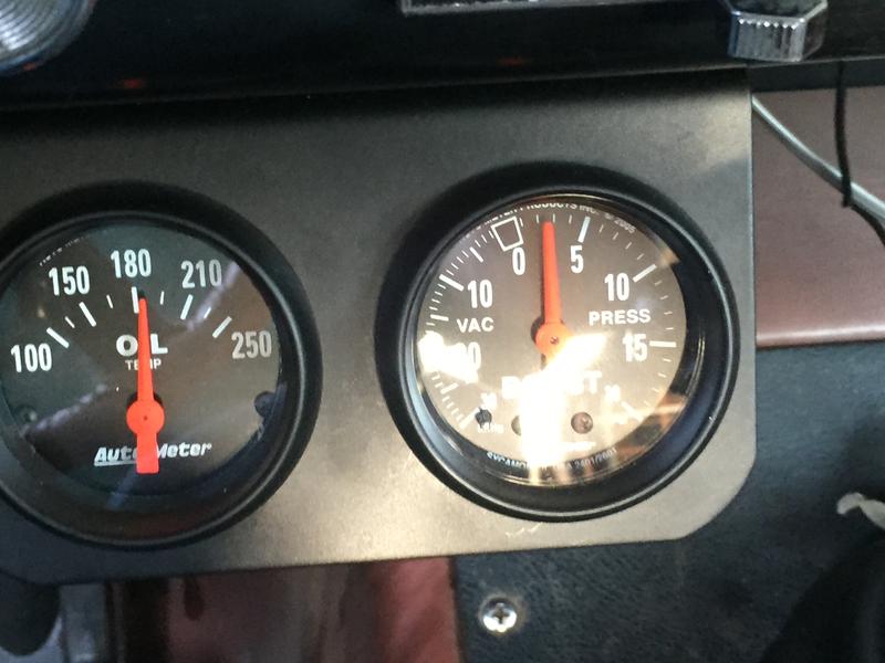

Hooked up the a/f gauge and went for a drive. Idle a/f is around 16.5:1. This is a hilly area so the following numbers vary but in general when I'm at 9" hg, I'm at 13:1, level cruise 14 or so (varies a lot), but when I hit boost I'm immediately down to 12.5 or so, heavier throttle 11.9. I again pulled 7 lbs. On a short, but steady grade and it held at 11.9-12.3.

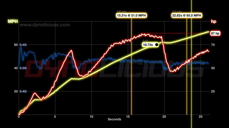

On my favorite grade (driver's flat) I'm pulling an easy 60 at the top of the grade in 4th, 6 lbs. Boost. Before it was 3rd gear, floored, 45-50 mph.

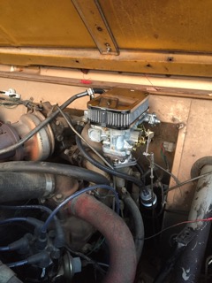

This thing is still Rich, in my estimation. I'm going to try the original rod/jet combo. What's in there now is a modern duplication of "original" jetting but a +1 rod (Rich).
Got the choke set right. Starts right up and warms up fast.
