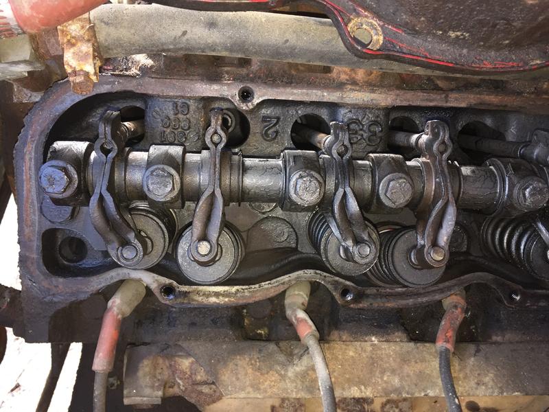

Roger that, I was kind of looking for an all in one package on the oil pressure gauge but I'll work with the local guys to make something work...I need a gauge, tube and fitting...I'll have to look at the block and follow your instructions on which is the right one to open to put this gauge in. Can I not just find the OEM one and use that hole to put my test gauge in to make it easier?
Makes sense on the two person job for sure. I did look down the openings on the heads and there seems to be oil around the lifters in each hole as well.
When i took the VC off last year when I got the truck it was a mess inside and the returns were all clogged up. I have since carefully cleaned them out and took as much of the slug off as I could. I know long term this is a rebuild but for now I'm assessing the viability of the engine before I spend to much money on the turd :)

Be aware, only one head will get oil at a time.
The #2 cam bearing feeds the left head and #4 cam bearing feeds the right head.
The cam bearing holes do not align to feed oil at the same time.
So rotate the crankshaft slowly by hand while pressurizing the oil system.
As you get one head to receive oil, let it run for a minute or so, then rotate the crankshaft slowly until the other head gets oil. Then lube it for a few minutes.
