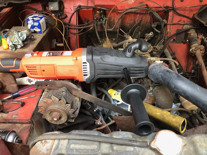

6). Reinstalled pre-filled oil flter.
7). Spun oil pump for less than twenty seconds at around 800 rpm's until oil pressure gauge needle started moving. Increased rpm's to around 1200 and gauge showed 28-ish. Had my friend turn the crank pulley bolt a few times a little bit until I saw oil. Rev'd her up to maybe 2200 rpm's and saw 50 psi-plus.
