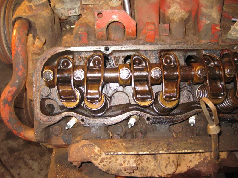

I took some photos when I was replacing the valve cover gaskets last year. Looked at them this week and wondered if something was amiss or ????
I did run the engine with the covers off to verify oil flow & it was good on both sides. All four drains were clear also.
Thanks for the confirmation that it is a correct configuration.
