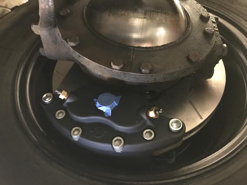

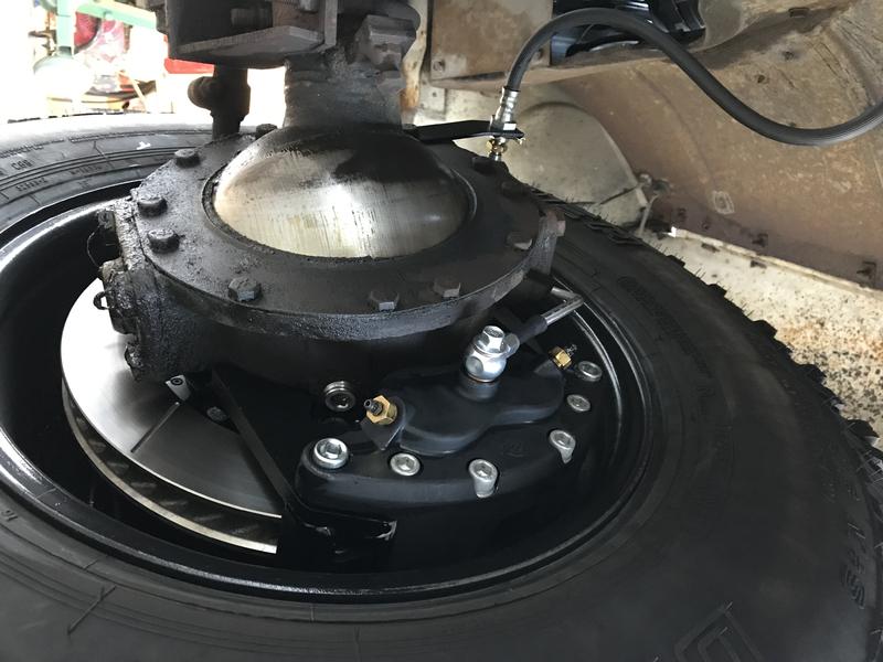

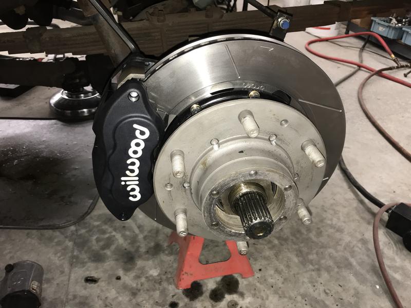

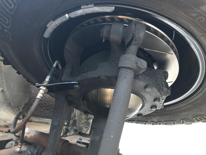

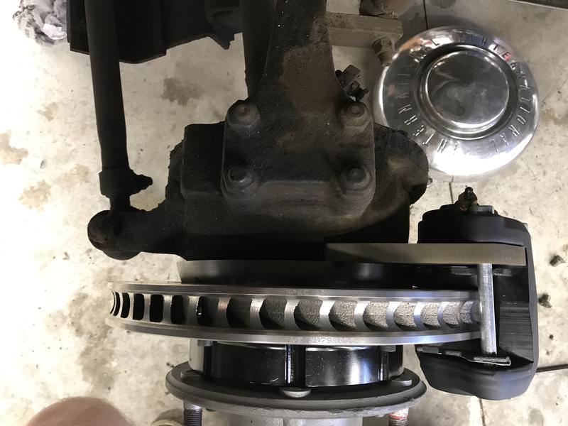

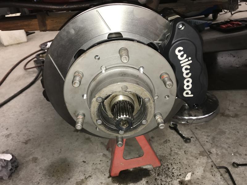

I have a fairly rare IH that is 99 % +/- a bit original IH. It drives great, runs great hauls great, even with the non lock ring wheels it will look original, and I've put a lot of effort and money into it to keep it that way. While this brake mod may look expensive, it is way cheaper for me to do then the other easy way and I'm enjoying it so.![]()

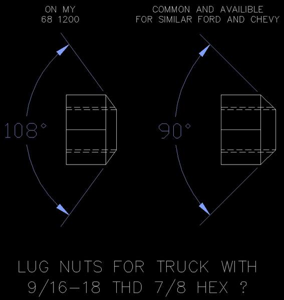

 I included a drawing of mine and the common available ones. Is this normal for the big 6 International's? Everything available as far back as I can find would use 90 degree seats. I hope they are not modified. It is hard to tell from the wheel, what they are.
