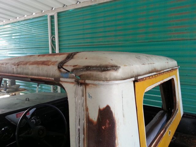

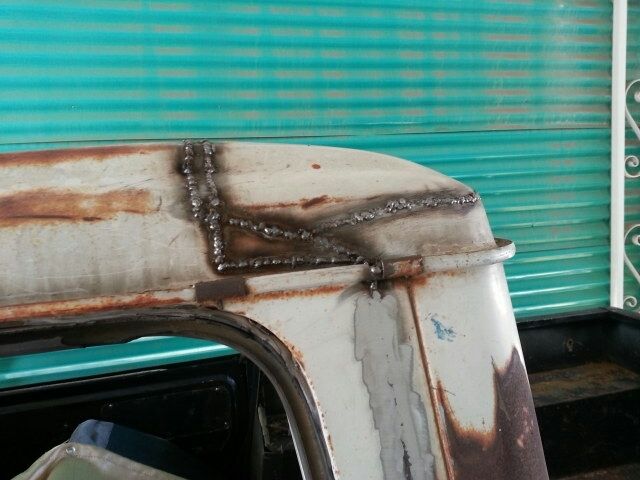

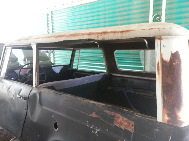

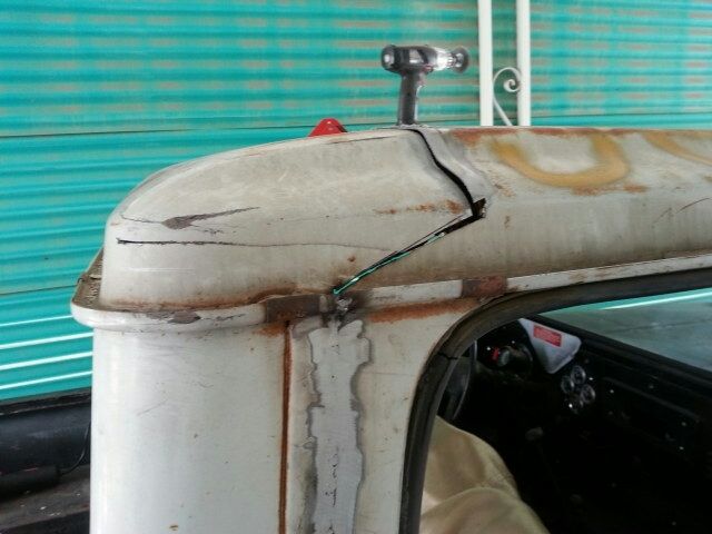

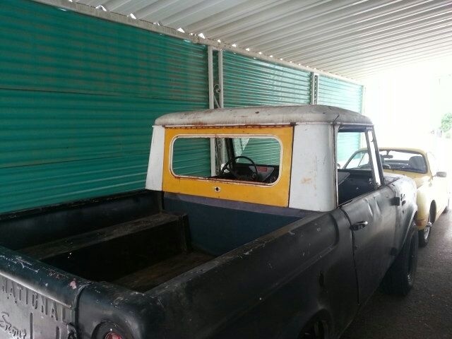

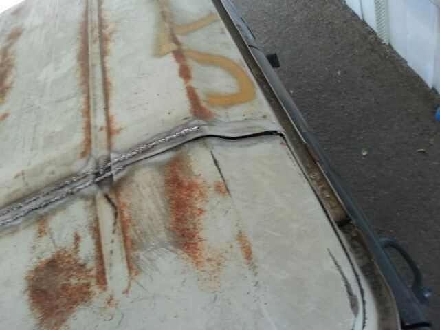

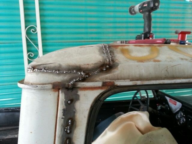

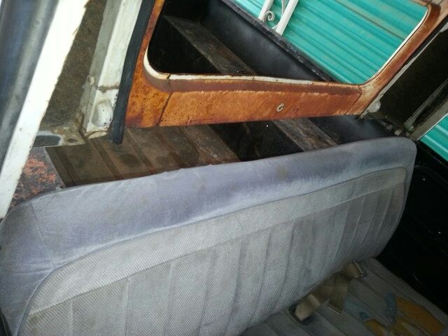

Worked on the p/u top again today, I guess I should measure 4 times and cut once.....lol. I was 3/8" short on the top of the roof so I had to improvise, I welded the piece I cut off of the front section back on. After that I cut a notch in it the 2 pieces from the bottom and sawed them out. By having to do this the 2 pieces didn't match up well, the rear section sat 1/8-3/16 below the front section of the roof, if I had cut it correctly the first time I don't think it would have been an issue. Then I had to do a relief cut to the back corners so that I could get the top edges to line up. Got most of it welded together till the wind got to heavy to weld in. I'm by no means a body man, and this will never be a show truck, but.....the top will serve its purpose by keeping me dry and somewhat warm when it needs to.
Its getting closer.

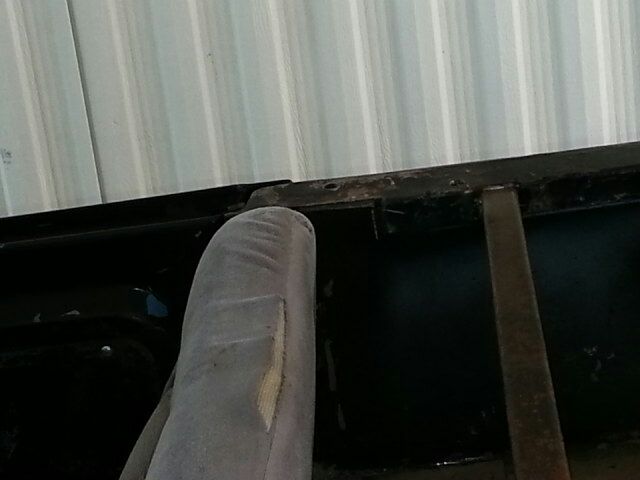

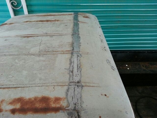

the stitching

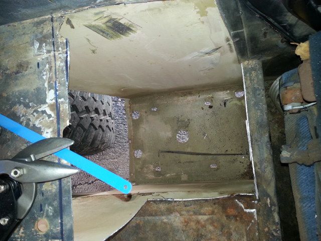

the reason for the relief cut

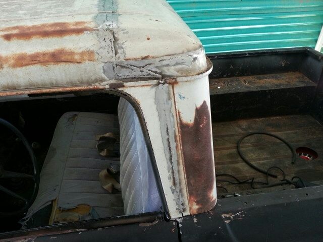

the end of the progress, called, due to wind....I miss a garage!

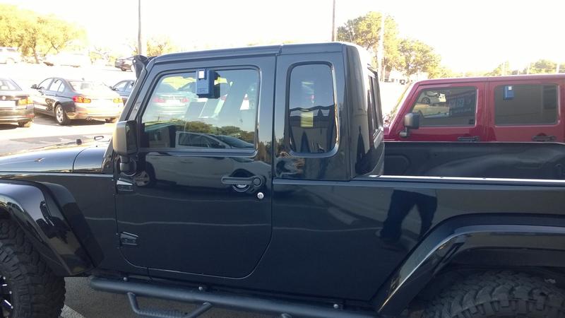

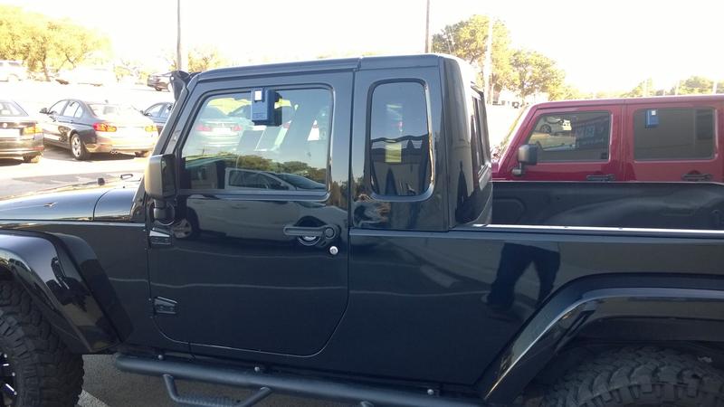

Yours looks great! I like the thought of an extra few inches and May try that. Saw this Jeep 1/2 cab and May use it as the model. Could retain the 800 full cab window (reduce the length). Our 800's bed will not be that big but for me it's just to throw misc. Stuff back there. Although - I have to find a 800 full cab first.

yours looks great! I like the thought of an extra few inches and May try that. Saw this Jeep 1/2 cab and May use it as the model. Could retain the 800 full cab window (reduce the length). Our 800's bed will not be that big but for me it's just to throw misc. Stuff back there. Although - I have to find a 800 full cab first.

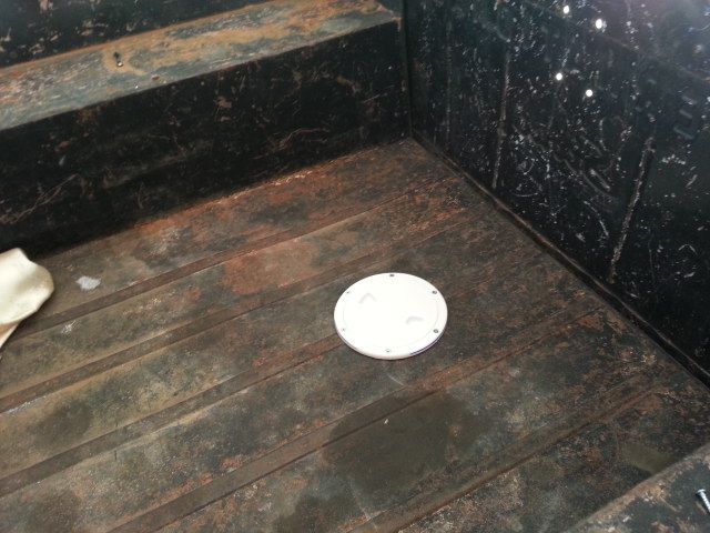

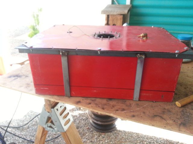

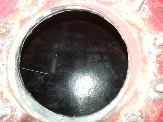

My hatch cover came in today, its a boat hatch and is rated to walk on, just didn't want an open hole in the bed so.............. I also found out that this filler doesn't work very well, a bunch of dirt and whatever end up in the crack of the lid, then falls into the fuel tank when you open it. So I will be changing it over to a raised filler and add a vent to it.

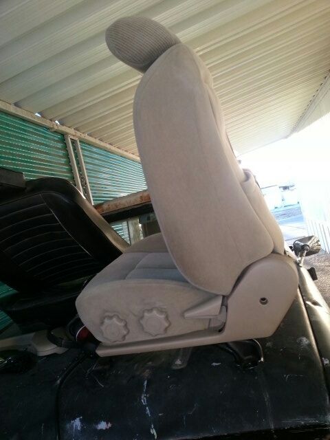

It's been awhile since I've done any work on beater, been working on other vehicles getting them ready to sell to make more room and fund other projects. So today I cut out the step behind the seat to add more room in the cab. I have found a set of fuel tank access panels and will be installing and sealing them so that water cant get in to the area from there, I will also weld up all the holes that are in the bottom plate for the same reason. At this point I haven't decided what I'm going to do with the fuel tank area that I've opened up.....make some kind of doors and use it for lockable storage or just leave it open. Either way it made it so I can move the seat back another 2 inches and be able to recline the seats for comfort. I picked up a set of Nissan maxima bucket seats for cheap that I will be mounting to the bench seat base that's in it now

the new seats
