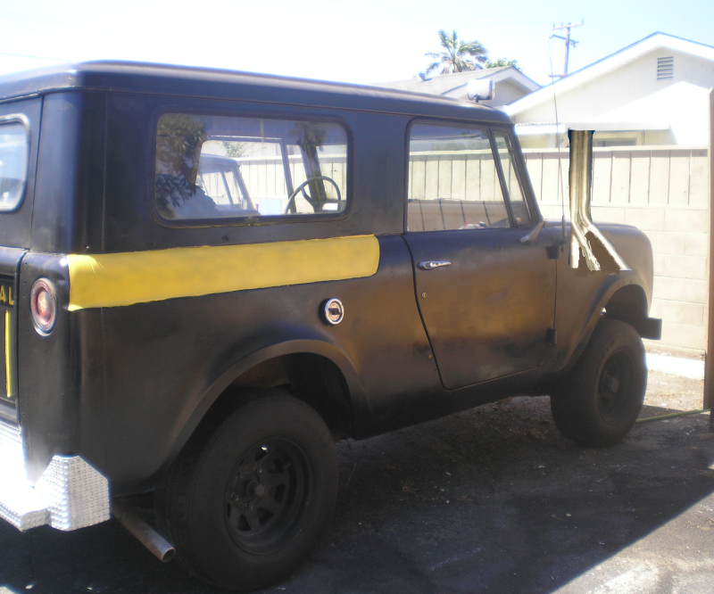

Off and running. Ron's little baby Scout is now rolling around on it's own power. Again, lot's of thanks goes out to Danny for the donation of this used 304 motor. Above and beyond what I would have expected, with getting this project going. Major "thumbs up". Motor runs real smooth so far and no hick ups. Getting ready for the official test drive in a few, once we get the hood mounted. Ron is all happy, like a little kid in a candy store lol
It's alive!!!!! Scooter and I just took turns test driving her around the block. Omg this motor is fantastic. Smooth, quiet, and tons of power. My Scout has balls on balls now. Danny thank you so much. You will never know how much this means to Scout and I. It was a long anxious time but the way shes kickin' is so worth it all. Ofcourse thanks to scooter and his shop who put this all together and made this motor swap possible.

A little hiccup tonight took her out to dinner and had to be towed home. Leading suspect is the electric fuel pump, not motor. Thanks again Danny
Yea talken about a buzz kill, huh? Motor was running good till it ran out of gas. Once we put a gallon of go-go juice in, it would not wanna start. The electric fuel pump seemed to be the week link. Crap happens. We'll get'er done

All the local parts stores had to special order the mechanical pumps and this electric one was the only one that they had on hand. Could not wait. I have other projects that will be rolling in soon. Plus I need to take time to be able to work on my own rig.
The new used motor that Danny droped off had a mechanical pump mounted on it, but the diaphram May have dried up and cracked just from sitting for a long period of time. Which is why we bypassed the mechanical pump and ran what ron had already been using, which ended up craping out last night. Who knew. Any number of possibilities could have been the culprit as to why the electric pump failed. But I'm leaning towards to much contamination from the tank/s that clogged the filters and what not. The new clear plastic fuel filter at the carb, that ron installed from his old motor looked like it had been on there for 30 plus years eeeek.

New electric fuel pump and two new filters are now installed and we are back in bizness.

So new fuel pump installed, fine tuned the carb and a slight clutch adjustment and she is running like a $10 hooker on $100 night.
