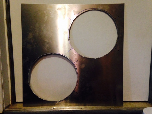

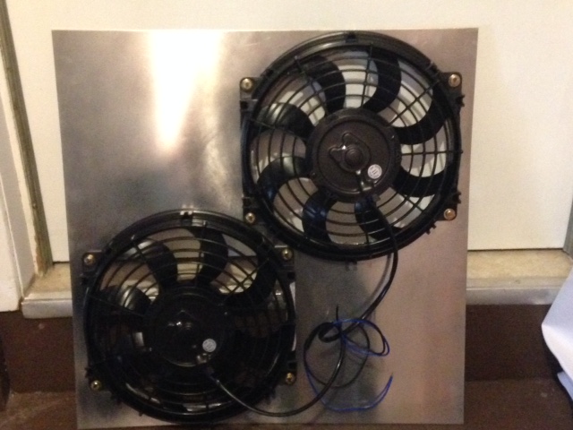

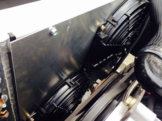

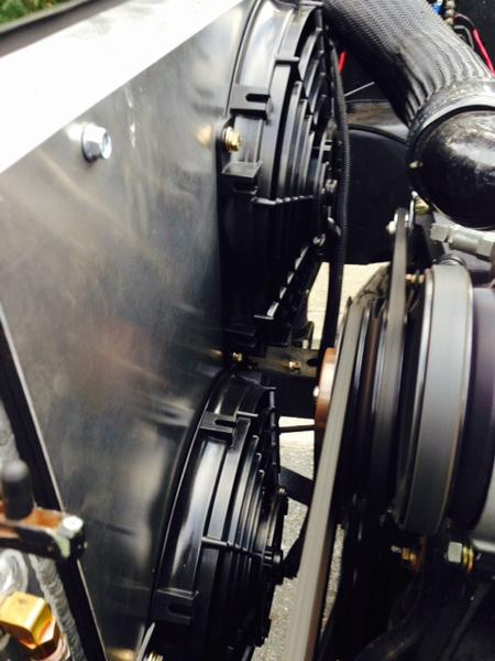

I can't keep the truck cool with the engine mounted fan without a shroud. What a surprise. So instead of buying an aftermarket/used fan shroud and trimming it to work with my body lift I decided to go with an electric fan. I started with getting a taurus fan but the depth of the overall fan turned out to be too much. I just couldn't make it fit without major modification which I decided wasn't worth it. So I then switched gears to dual fans. I went this direction because I wanted a high and low fan setting and they were just as good as a larger, dual speed fan. Picked up two flex a lite curved blade fans that I installed on an aluminum shroud that I cut to make them fit. Love that the fans say "made in the usa" right on them. They claim about 900cfm apiece and I feel that will be plenty to cool the truck.
Here's a couple pics of the fans mounted to the shroud. I will be using a jegs dual fan controller to run the fans.
They're not the best cut circles but who cares when they're covered with fans.

Fans are all dialed in and working great. Truck stayed right at 185 while running at 3k rpm for 20 min. Excited to be able to start tuning and working out the kinks since I can run the engine longer then 15 min. Pics of fan install coming soon. Lighting was no good tonight.

The fans are flex-a-lite 392 s blade 12" fans. They just barely fit, width wise, over the radiator. Could have easily gone with 10" fans. I am having absolutely no cooling issues anymore.
Radiator is a champion radiator. No issues with it either.
My cooling issues were mostly due to not having a shroud for the engine mounted fan and some air trapped in the system. Due to my body lift I decided that going with the electric fans was a better avenue for me. I am controlling them with a dual speed fan controller as well.

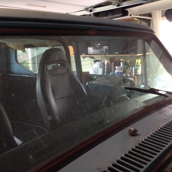

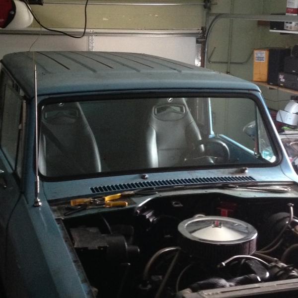

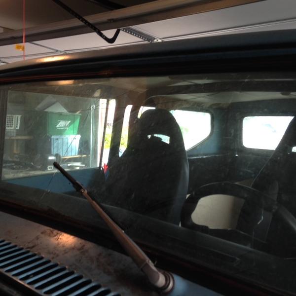

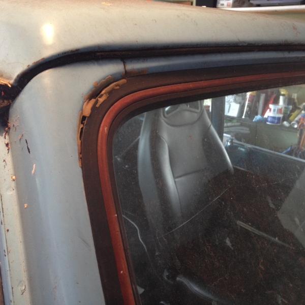

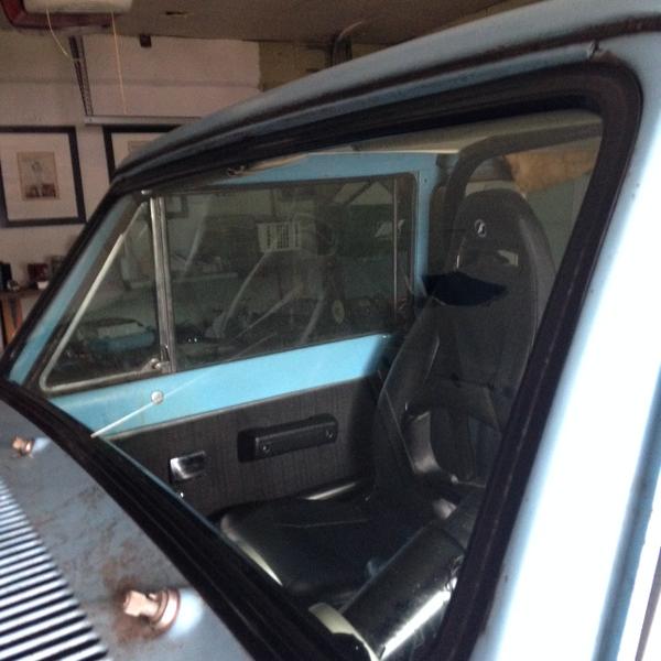

Got a new windshield installed this morning. Seal was from IH parts, non chrome locking version, and the installer was very impressed with its quality. Seal is tight as all hell and that's a good thing. The list is becoming very short to get this thing registered.
Here's a couple pics:
old
attachment.php
attachment.php
attachment.php
New
attachment.php
attachment.php

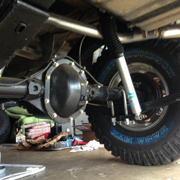

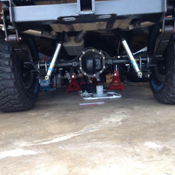

Finally got around to installing the shocks. Been driving it up and down my block a bunch lately and realized that it would be nice to see how it rides with some shocks. Unfortunately I sprung a leak at the water neck gasket so I didn't get to take it for a spin. Easy fix though. I don't think I replaced the lower gasket last time I swapped out the thermostat.
Rear view: I installed them body down because I was told it technically won't matter and I didn't want to look at the scrunched up shock boots.
attachment.php
attachment.php

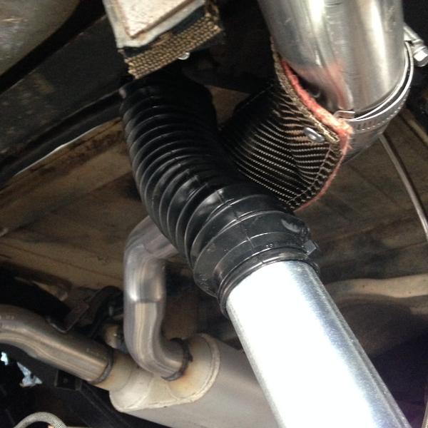

Here you can see how close the boot comes to the exhaust. I've ordered some heat shields to make sure that the boot doesn't melt and that there won't be any other problems associated with the proximity to exhaust heat.
attachment.php

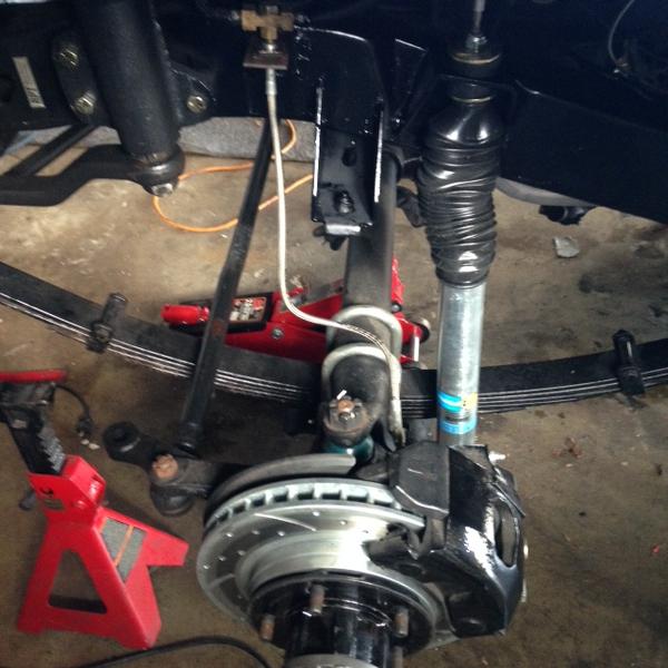

Here is a look at the fronts installed.
attachment.php

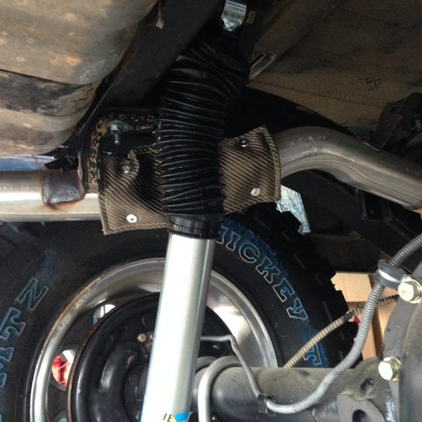

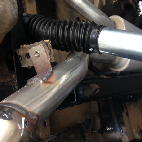

Picked up some titanium heat shield for the shocks to protect them from the exhaust pipes. Truck was having a real tough time idling after it started today and after shut down I noticed that gas had pooled in the secondaries. I could also feel gas leaking out somewhere around the vacuum secondary screw as well. Going to pull the bowl tomorrow and check the needle and seat to see if it has stuck open.
attachment.php
attachment.php

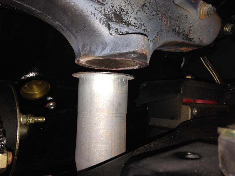

Had decent exhaust leaks coming from the collector and manifold attachment on each side. Replaced the cheap bolts the guy used with some grade 8's and some lock washers. Still a decent amount of leakage. Figured the guy must have screwed up the installation of the donuts. Turns out he didn't use them at all. 2 on order.
