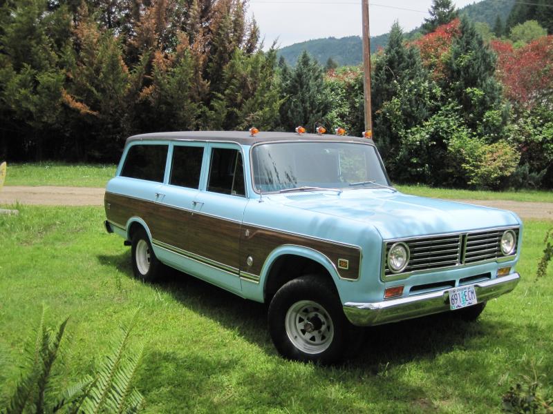

I just bought the 14th of my IH's, which I have been driving consistenly for th last 19 years. They are awesome vehicles, as you all know. Somehow, though, I can't seem to settle on one and continuously have the wanderlust.
I found my latest one on craigslist in myrtle creek, or. Even though I live in se ga, for some reason it is the 5th of the last 7 to have come from or. It will be heading up to mm's for some exploratory in the next few weeks, and hopefully it is not terminal. The po stated that it ran rough. Michael was kind enough to drive down this week and take a look at it and said he was pretty surprised of the condition. The engine and engine compartment are just about untouced except for plugs and wires. The po bought a nos grille, had the bumpers rechromed, and the 3m wood vinyl applied. The roof was also bedlined. Both tanks work, as does electrical. He said he's never checked out the a/c. And, the front brakes were switched over to disc since the lockheed parts are getting harder to find.

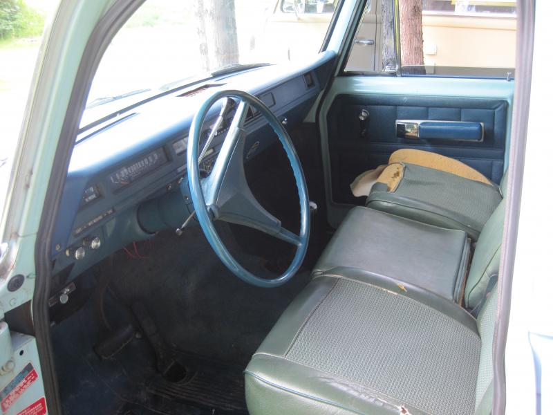

Interior isn't too bad, but is missing the front two panels of headliner, and he swapped out the blue front bench with green low back/console variety. And, it does have the obligatory rust through in a few spots on the rear tailgate sill. I haven't seen one yet that didn't have something going on there.
Overall, it looks like it was worth the $1,000. But, we will soon see!
I will slap on some pics as soon as I can load up some software on my pc to reduce the size of the files. Too high a resolution right now.

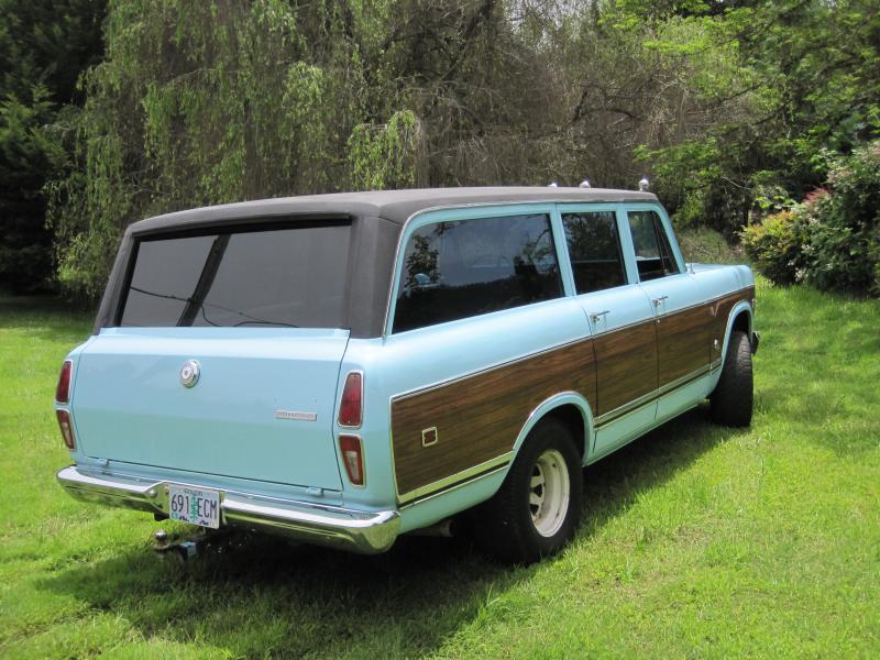

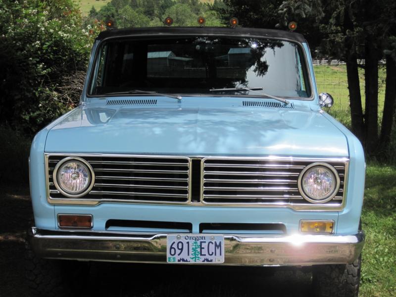

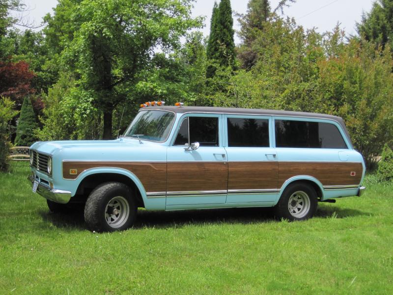

Here are pics.

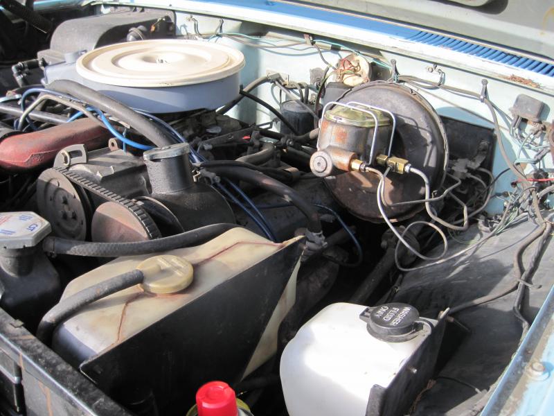

Nice t/a...

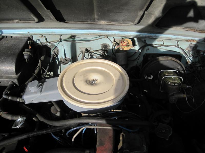

The power brake booster / brake master cylinder (Scout II?) were changed as part of the front disc brake conversion. At least they do not look like mine on my 73 1210 t/a.
Yours has a smog pump, but I do not see the flame arrestor in the driver's side valve cover. There are "variations" in the "smog setups", but my t/a (CA smog) has a flame arrestor in the driver's side valve cover with a hose running to the air cleaner -- might have michael check if there is an open "hose connection" on the air cleaner. Not a vacuum leak, but it does allow potential dirty air into the carb ("bypasses" the air filter...)
also, there should be a vacuum line running to the "dashpot" on the top of the air cleaner airhorn. Need to check the "running" of the vacuum lines...
You are right about the master cylinder. That was replaced when the mechanic did the conversion. Maybe the other hose issues you mentioned around the air cleaner and smog pump have contributed to the rough running of it? Open vacuum lines aren't good!
Hey, thanks for your input. I think it is a good buy for a grand (but, unfortuately, I have not seen it in person)!. My hats off to michael for making the drive down there to check it out for me. I am surprised it was still available on craigslist after having been a month on there before I called.
The carb is an aftermarket Holley swapped on, which is a good thing! The entire pcv system is present and functional, the air cleaner connection is simply not connected in those pics furnished by the seller. And the vacuum/emissions stuff is all present, but running some of the stuff with the aftermarket carb presents challenges that will have to worked through.

The pushrod between the booster and the master cylinder is also butchered, that is another reason the rig has been parked. The shop that actually performed the disc conversion never really completed the job as the owner was basically stranded at some point and had to lay up waiting for the brake work to be completed. The actual spindle/hub/rotor/caliper conversion was done correctly using new parts.

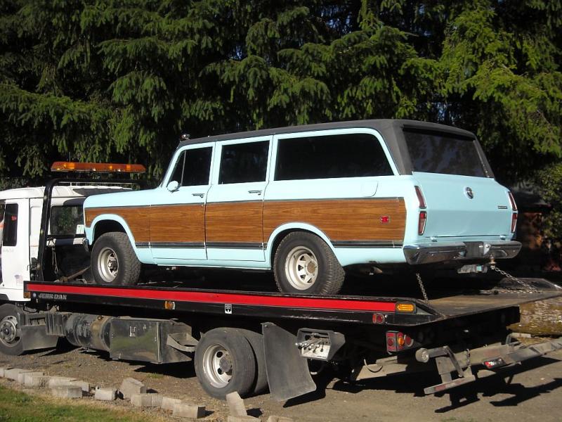

Froggy done come and gone.
Buck drove it onto the rollback but left the key on so the battery was dead when it arrived. Got it charged and the motor fired right off.

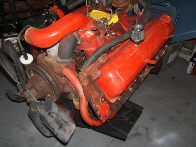

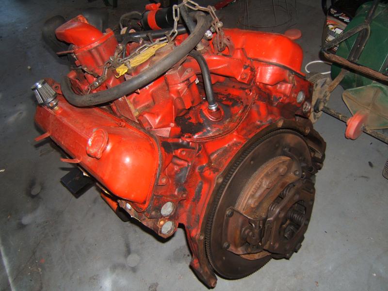

Malcolm and I discussed the project again by phone today, all the ducks will soon start lining up.
Since the donor motor in the pics is a sii pullout, then the pan, dip stick, and oil pump from the 392 will have to be swapped over. And the distributor also.
The flexplate assembly from the 392 will be installed on the 345 along with the starter spacer. I'm going to fix him up with a carb that will drop onto the 345 so the intake doesn't have to be changed.
The power steering pump/mount will need to come over from the 392, but he's gonna loose the a.I.r. Pump in the process. The charcoal canister will plumb right to the fresh carb just as it did in the donor sii.
Seems the 345 crank pulleys gotta hickey in the process, so the pulley stack off the 392 will move over and allow for the a/c compressor to drive.
The po butched the ignition switch but that's an easy fix and the wiring can be corrected once the engine is out of the way. The rest of the work is mostly details and cosmetics which has already been started.

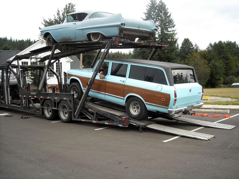

Here's another pic of the loadout...it's going up the ramps under it's own power but it's tired!
