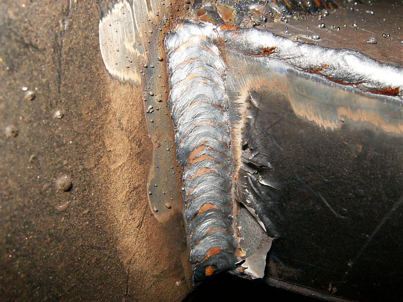

Went on a 300 mile trip on Saturday driving the travelette and hauling a trailer the whole way. Went up to newberg, picked up a Dana 70 and auto/tcase combo for terry's 6bt diesel and then cruised down I-5 to leaburg to drop off mayben's new axle and the trans for a rebuild. Picked up my engine less Scout and hauled the Scout home, offloaded it, took the trailer back to the neighbors, and then loaded the saws in and headed down the road for some firewood cuttin':icon_twisted: now that the Scout's at home, it'll get some attention to a dual mc conversion, sound deadening, swapped t-cases, and touch ups, while the engine rebuild is put off until early summer. Hopefully it will be ready for the Binder Bee!...... Have the travelette to do as well, so when I get tired of one, I can work on the other.:icon_gonk:

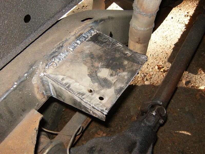

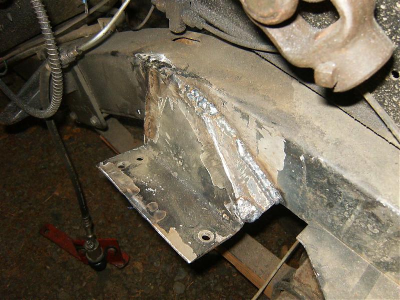

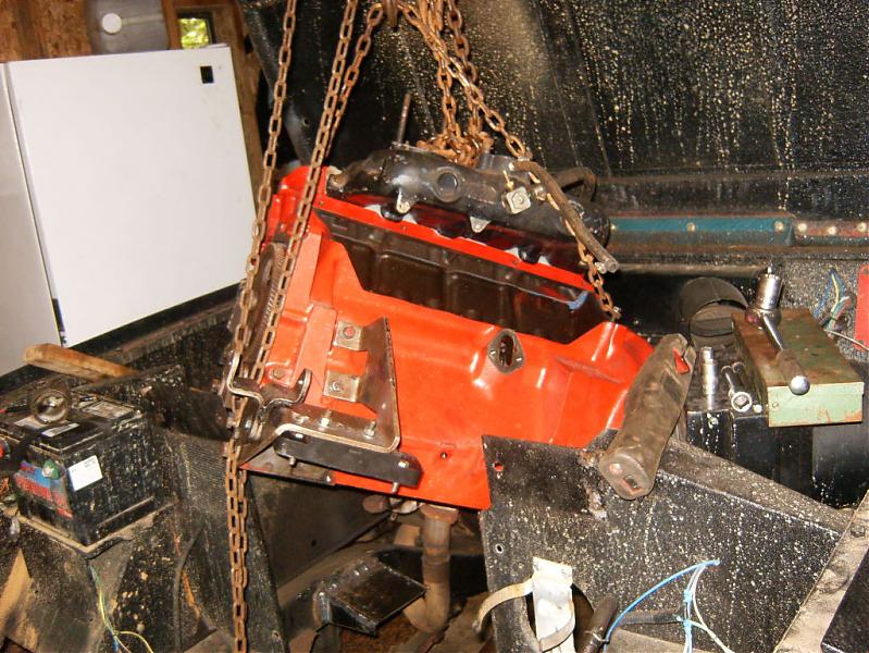

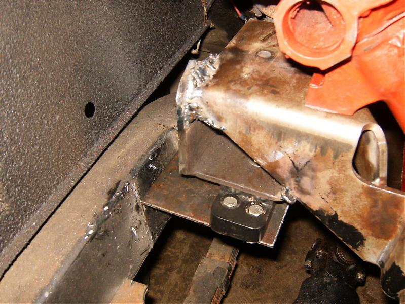

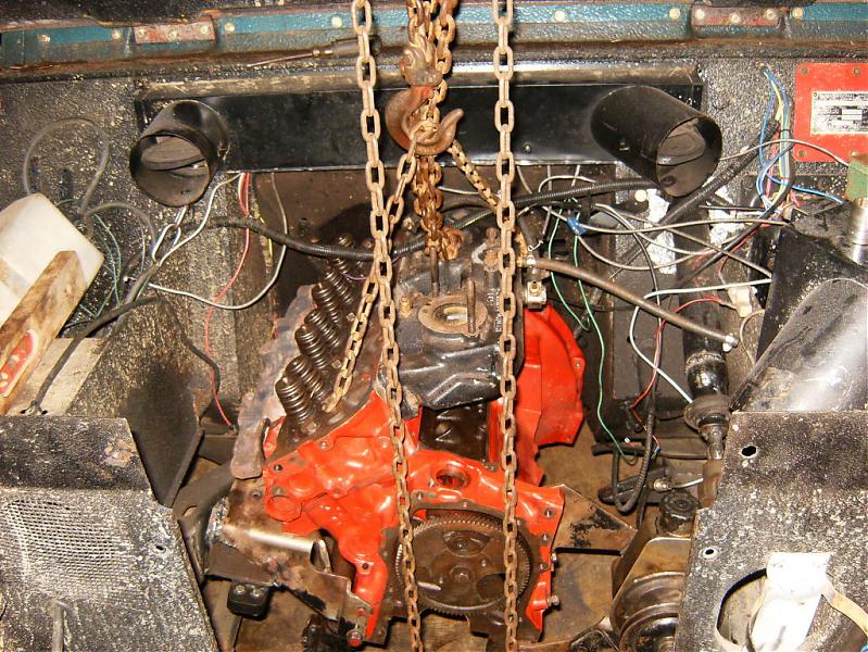

Then engine should be in southworth with a list of machine work to be done thanks to mr. Mayben!:icon_up: the cam is getting sent out to be ground as well. In the next couple weeks it should be all assembled and ready to drop back into my Scout. So I got to work on the engine mounts this weekend and started/finished them. Took a while but in the end I'm satisfied. Also, I found a power steering box that is almost a perfect bolt in for an s80 that it is ridiculous. Only shortening of the column is required. I decided to make a 2 piece shaft using a pto shaft coupling. While I was getting the engine into the Scout I managed to cave in the nose of the hood!:yikes: :sad:. Didn't get a pic, but it matches ian's Scout now....:hand: character building I guess.... Got the correct spacers for my highsteer arms thanks to Jeff, picked up a turbo from major screwup that will go on the engine once it's broken in, and some dom for the waggy 44's. Just need a little more work to get the axles ready for install. Then I will be SOA with some negative caster! No positive for me anymore!:ciappa:

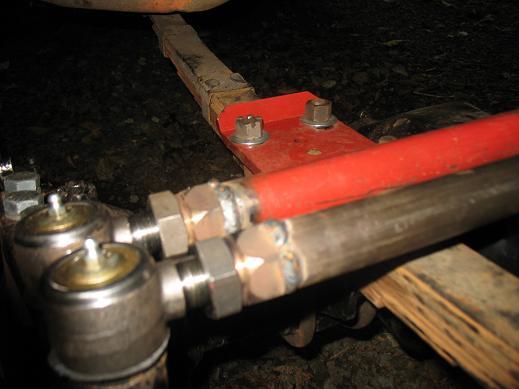

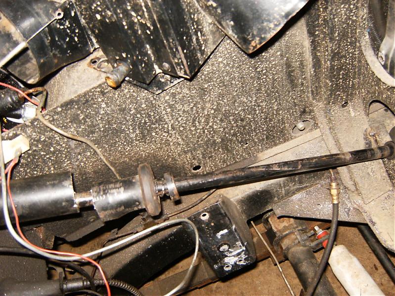

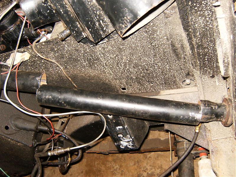

I got a fair amount done this weekend. Thanks to terry, I was able to get the dom that I got from him bored out accordingly for the 7/8"-18 bungs and appropriate tre's. Metal lathe's are awesome! Welded them up when I got home as they were a perfect fit. The only problem now is the pitman arm is an inch too long and interferes with the tie rod. Well, I have some clearance, but not enough if the axle moved forward. So now I have some sourcing to do. Took out the old axles, and swapped in my waggy Dana 44's and am really pleased with the results. The added width seems like it will make me a little more stable than the narrow s80 Dana 27's... Also, with the 35's and SOA, I'm a tad taller.:yesnod: we'll see how the 3.73's do. With the 4speed, 3.73's, and 35" tires I'm just a tad lower gearing than the 3 speed, 4.27's, and 31" tires. With the lower gears and larger tires, it'll be like I'm in od in 4th comparitively speaking to a stock Scout. I was going to go with 4.88's and a warn od, but that May never happen. Having 8 possible forward speeds is pretty tempting though!:hand: just is more money that I can't be spending!:yikes: the engine rebuild is good enough for 1 year...

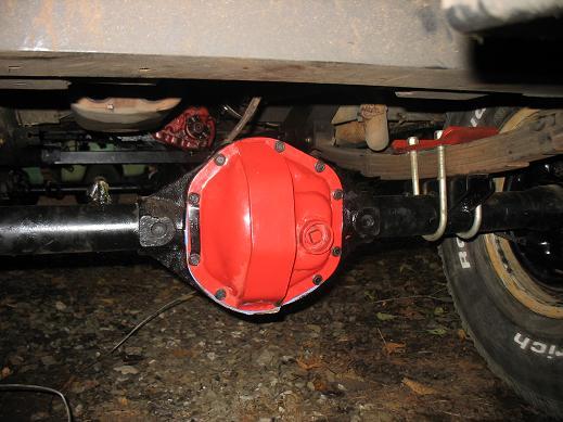

Nice michael!
I can't tell by the pics, but would a wagoneer pitman arm help?
Might be too short and too straight (save the jokes), but worth a look.
That's how we went on the girl Scout.
Must be nice to be young and full of energy:p
nice michael!
I second that, I went to a waggy pitman arm on pink.
nice michael!
Shorter and straight would do the trick. In this instance anyway...:hand: my pitman arm is currently about 7" long from center to center. Something around 6" would work. If you happen to have an extra lying around and would like to sell send me a pm. Now I just have to fill the other end of the box with a steering bell coupler..... The power steering boxes are different from the early scouts manual steering boxes. The bell's splined end is larger then the small splined ross box, smaller than the large splined early ross box and has a flat master spline. Might have to steal one off of the orange truck again.... Whatever. Does anybody know if chryfordlet's used steering bell couplers on their saginaw power steering boxes? Cause then I could go junk yard scrounging.
looks good! You going to make the next wheeling trip?:icon_up:
I wish, but considering the engine is still at southworth and the cam is probably still being worked on, I doubt I will get it all put back together this weekend. Then, I doubt I would want to take it wheeling before it was at least a little broken in.... When is the next wheeling trip going to be? Right now I still have to go cut up some driveshafts and shorten them for the Scout as the SOA made the old driveshafts too short. I will steal the rear shaft from the 68 1300 and use it for the rear. If it vibrates, then I'll have it balanced. But until then I'm going at it redneck style!:ihih: at this point I'm just hoping I can get it put toghether before school and winter starts! Having this thing for 2 1/2 years and only driving it for 6 months is starting to really get at me. First it was the 152, then the t90 went out, then the 196 went out (or it was already gone when I put it in!). So right now I have new axles, trans, and an engine soon!
Nice work, michael...
An observation -- I think you need longer u-bolts on your axles. I think there should 1/4" - 1/2" of threads showing above the nut. Not good to have a torqued nut at the top of the threads..., I think.
I am sure the other responders can tell me if I am fos :crazy: or not...
