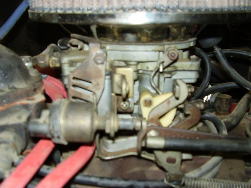

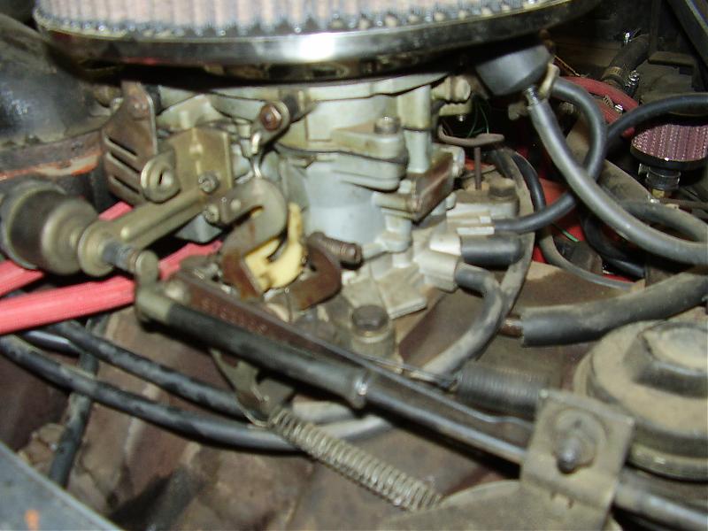

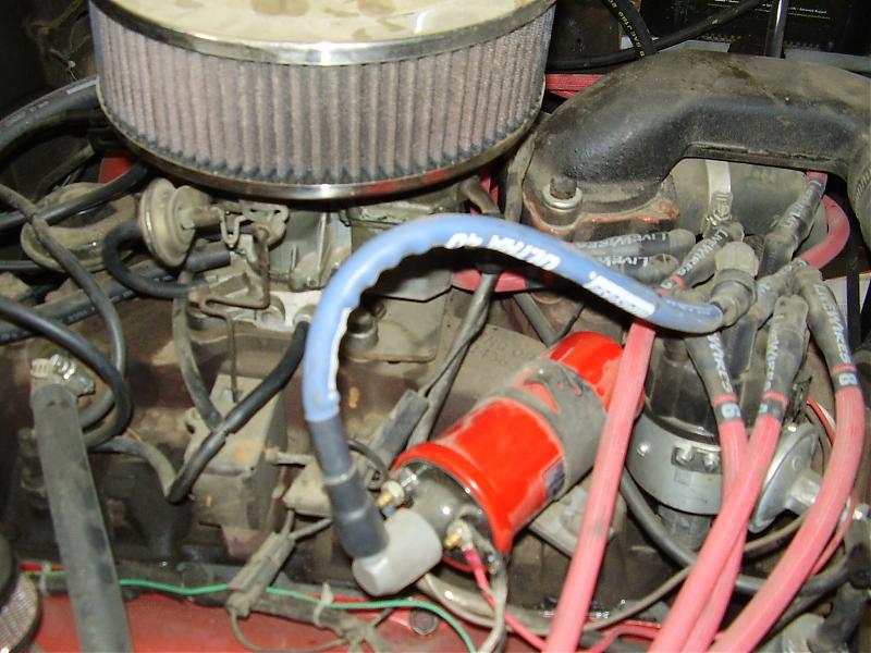

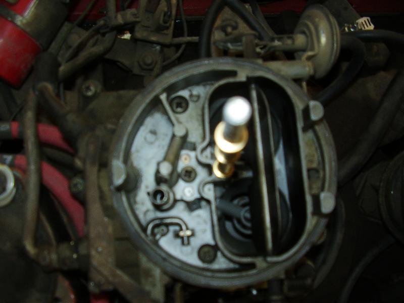

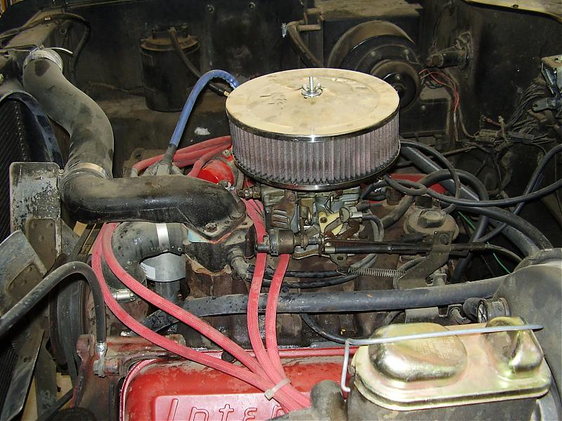

Thanks for the replies. So here is what I have.
Numbers on carb.
R 6828-1
151911-091
2033
I do not have any emissions stuff on the engine...at least I have pulled off most of what I know about. The dist. Is a prestolite with a msd blaster 2 coil from IHOnly. Timing was set per what Jeff had suggested at the time...not sure what that was. I do not know the vacuum or dwell. I have the old air cleaner setup, but what you see is what came with the truck when I bought it. See attched pics.
For the most part I am open to just getting a new carb set up and then I can have it taken to a competent carb person, to put the finishing touches on per your suggestions. I have the name of a person nearby that sets up alot of vehicles for our area. Thank you.

Ok got, I'm back...late nite last nite!
The carb referenced is a '74 edition 2210 oem onna 345 "light duty" truck (meaning Scout II). The IH p/n is actually 451911 c91.
That mixer should have #53 main jets, the power valve has no "consumer" designation, that was determined in the emissions lab during development. It's only a single value. Remember, this is an emissions carb and as such has little if any "adjustability"! And "if" the vehicle was originally delivered to the end-user by an IH dealership located above 5000ft. Elevation, it would have had a selling dealer-installed "kit" consisting of different jets, power valve, timing spec, choke setting, etc., etc., so that it was "smog legal" at the customer delivery altitude. Common practice for all light duty new vehicles back in the day.
So the only way to know what main jets it has is look at 'em!
Because of the severe loss of engine performance at altitude, in order to motivate, ya gotta open the throttle bigger! Doing so, drops manifold vacuum to nearly zilch. The power valve "opens" at an approximate 8"hg at sea level, that is it's calibrated setpoint and can't be changed. So when manifold vacuum hits a nominal 8"hg, then the power valve has the effect of increasing main jet size to approximate #59>#61. That is an increase in "richness" of about 15% and couldn't come at a worse time when the mixture is already super-Rich due to altitude. Thus...your perception of "flooding" which is not what is happening.
What to do?
Open the carb and kit it! At the same time I'd replace the #53 jets with prolly #47 to start with. Ya haven't stated what the altitude is where the truck lives...so I'm "assuming" around 5kft.?? If so, the #47 jets should be very close. If ya normally drive below 5kft., then tha bitch will be pretty lean and get worse as ya go down tha hill to the point of lean surge and lean misfire. The jets used in that carb are the standard Holley "gasoline" pattern hanging on the wall in most parts houses and sold in pairs. However, those very small jet numbers May be difficult to find in some markets since no "normal" chryfordrolet Holley performance carb application uses jets that small, they typically run in the 70's>80's. And ya never "drill" on Holley jets, they are not "drilled" at the point of manufacture, but are carefully "broached" very precisely, then each is flow tested for "grading" before packaging. And common number drill bit sets are not the same as the Holley jet sizing system, no relation! So there is no practical way to change a Holley jet to a higher fuel flow value, ya just buy an assortment and swap 'em out...that's called tuning!
The aftermarket Holley 2300 centerhung carburetor "upgrade" we push is infinitely tunable in all circuits! It's a performance carb, not a smog carb....major difference!
When one of these carb setups is ordered, the internals are changed out for whatever altitude and use the owner describes to us. And after the sale, we give unlimited tech support to get it to play nice with your application. There is no charge for that, ya don't take it to someone else to make it play nice! You can change the jetting in it if need be, very simple to do and we step you through that...same as we're doing now.
In the meantime...forget the use of a timing light...power time it! Those motors can run up to 12*btdc static timing at sea level, even more at altitude. There is a limit though...no more than 14* at altitude unless the camshaft was "degreed" at the point of installation and you are using the "straight up" timing gear set with the suffix "r1" on the part number on the gear set.
The msd blaster II coil has a spec'd primary resistance of 0.7ohms, very low. I've not installed one of those in conjunction with the prestolite electronic distributor but I know Jeff has had great success with that. Did you use the msd coil "kit" ballast resistor in that installation?
That distributor/coil setup cannot use the oem "resistor wire" feed from the ignition switch in the "run" position, they require a full b+ feed. Since your '74 rig was originally equipped with the resistor wire ya need to take a look at that, it May be that you don't have the ignition system properly set up, just an idea I see repeated over and over! And...the proper coil "match" for that unit calls for primary resistance of 1.2>1.4 ohms at 70*f.
These electronic trigger ignition systems are very demanding in having proper installation, same as for a breaker point system!

For determining the blaster II ignition coil resistance...simply use an accurate vom and place one probe on the positive terminal, and the other probe on the negative terminal. Then write down the resulting reading! A digital instrument is far more accurate for doing this since the resistance value is extremely low!
Do exactly the same thing regarding the ballast resistor you have. Those items do not have any kind of "polarity" so just check between the two terminals. Write down and post that figure also.
There are several different oem wiring configurations that were used in Scout II from inception through about 1977. Some of the differences are not shown in the wiring schematics in the service manuals! But I can talk ya through exactly how to wire the system properly if in fact it currently is not. Your wiring harness May have been configured to use both a point-distributor system and an oem gold box system, obviously yours was since it has the gold box connectors you describe. And some sii rigs were config'd with the prestolite electronic sparkmaker oem also, some had gold box...wiring is different for each!
And you need to verify that currently the coil feed to the positive terminal is or is not a resistive wire element. The oem resistive wire element will be an "ivory" color vinyl insulation on a "stiff" inner twisted conductor (iconel-type material, not copper wire), with a woven fiberglas overbraid for heat protection. Strip back the outer wiring loom material and verify that wire all the way back to the bulkhead connector!

If you can post some wide and tight pics of your engine bay, it would really help to see what all ya got going on! The "gold box" ignition system has exactly that...a "gold" (or maybe silver!) electronic module (about 3" x 5") mounted on the firewall near the hood latch system. Has a harness with several wires coming out of it. That is the control unit...the pickup/trigger system for it is mounted inside the distributor, under the cap and rotor.
For several years, the actual engine bay wiring harness had both wiring for a breaker point ignition system (the resistor wire) and the "gold box". The prestolite electronic distributor came much later in the production cycle, around '77>'78 and was not used on all Scout II versions, thus we find the three distinct types of ignition systems! There was much carryover however in the wiring harnesses themselves, just several "unused" connectors that allowed for several scenarios.
